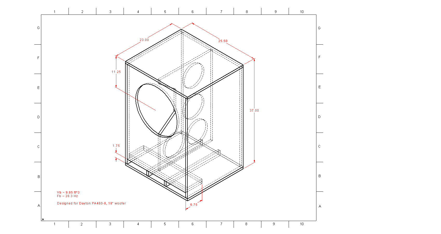

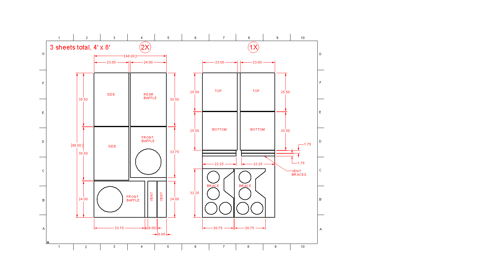

Here is my cut list, for anyone interested.
A few notes-
1. Ply or OSB is nominal 3/4" thick, 23/32" was what I found at the store.
2. I had 2 front baffles cut so I could make them double thick, 1.50" - but the 3/4" OSB felt solid enough that I opted for just a single layer, so in this case you only need qty-2 front baffles.
3. Relating to the baffle thickness, the vent depth needs to remain constant, so the width (depth as installed) of this vent plate varies to keep the port tuned correctly. MY port was only 19.50" wide (24" - .75" - .75" - 1.5" - 1.5" to account for OSB strip braces and also 2x3 cleats at the corners), so my total port length is 6.75", so the width of the vent plate is 6" (6" + .75 thk baffle = 6.75).
4. Internal brace plate is cut to fit, add ventilation holes to suit. I haven't made this piece yet, but will probably just jigsaw out a lot of it. The thing to remember is to leave support front to back, and for the woofer. The cut out for the woofer magnet should just clear the magnet, then add a bit of foam or insulation between magnet and brace so that the brace damps the magnet and basket.
5. I used 2x3 cleats at all corners, glued and screwed.
6. I glued in the rear baffle tight and made the front baffle removable, your choice on that - it's big enough you might not need to make anything removable.
7. Woofer cutout is listed as 16.73, I went 16.625" and it's a nice tight fit. (16.75 test hole was pretty loose).

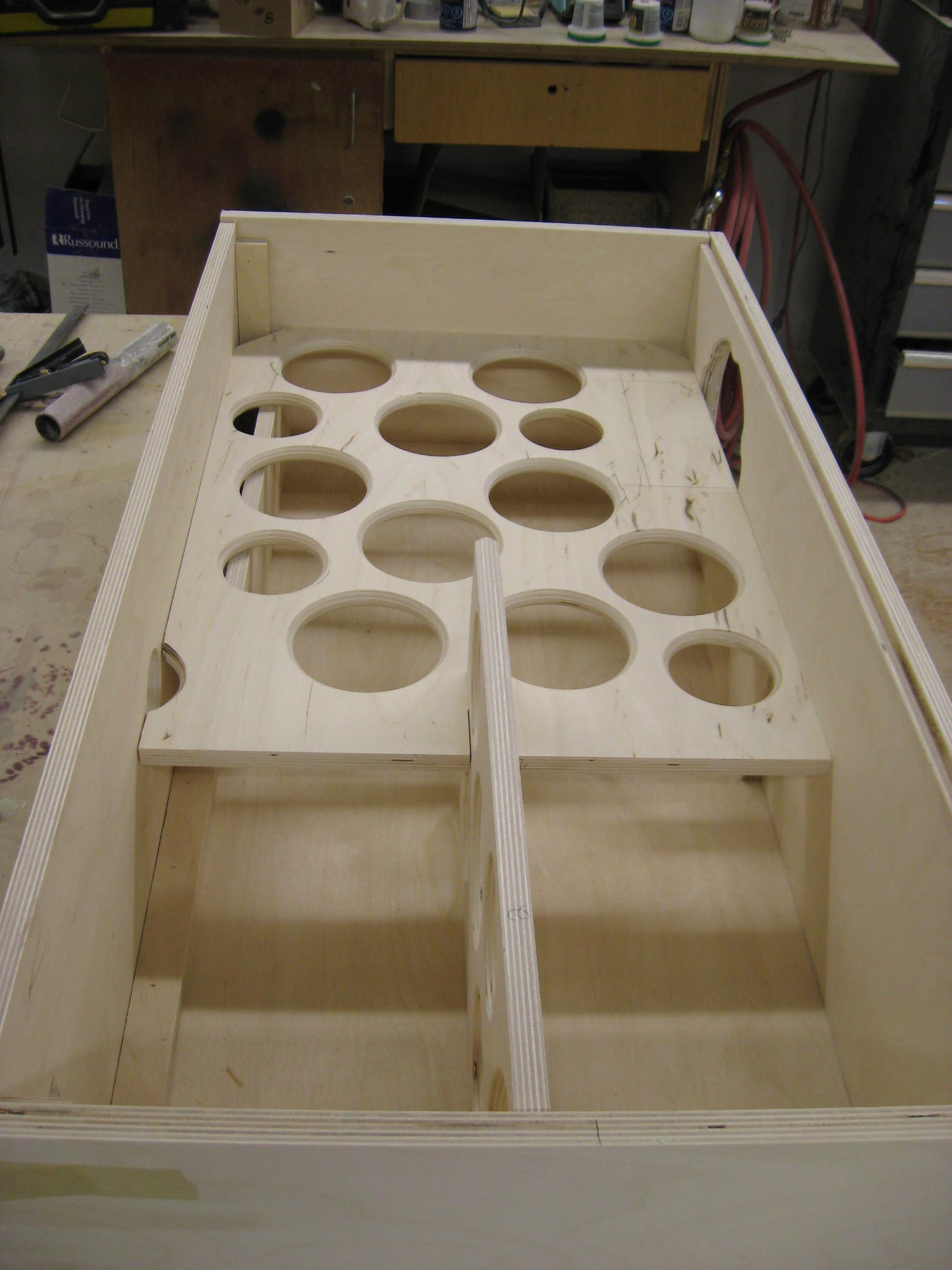

Re: significant panel flex, I'm not sure how much is really acceptable... ideally there would be none, but surely there will always be something. If I can feel them moving or they buzz against a hand laid on them, I will certainly be adding more bracing. I'm intending on adding that center plate brace, then probably a few boards going across as well. That at least breaks the unsupported areas up to spans shorter than 12". A 12" piece of 3/4 OSB feels pretty stiff - but we'll see.

MDF, yes, just wear good eye/nose/throat protection; OSB can potentially shred sanding belts, so another thing I've been reluctant to try since I got a nasty cut from a cheap one that quickly snapped at its seam when 'grinding' on a car panel.
Yeah, a high Q driver in a large cab generally doesn't require bracing other than a driver mass loading one as any 'breathing' helps damp the driver.

I'd always suggest good quality plywood over any other materials for speaker boxes, but if you definitely decide to go with the OSB, I'd highly recommend cleating and cross bracing between all opposing panels to be of solid wood - even ripped from 2x4 studding (not finger jointed), or hardwood dowelling. Do not locate them on centrelines of panels, and it definitely doesn't hurt to couple them together, although it can be less elaborate than on attached photo.
And nesting at least one of the braces to support the woofer's magnet motor assembly and couple it to the rear / side panels does take some time to get just right - often the single most time consuming piece in the box, but is also worth the effort

At any rate, a "driver mass loading brace" is which part here? The center board of OSB intended to support the front/back panels at the midline as well as help support/damp the woofer magnet? As usual, you seem to be a step or two ahead of me...

Don't locate the braces on centerlines? Because the resulting 2 unsupported spans that you just split have the same distance and thus same resonant frequency? So by offsetting slightly, you'd spread out that resonance? That's an interesting point. Thanks!

Qts is .33, vas is about 14 cf, fs is 28.3 hz.
Box is 9.85 cf, tuned to 28.3 hz.
