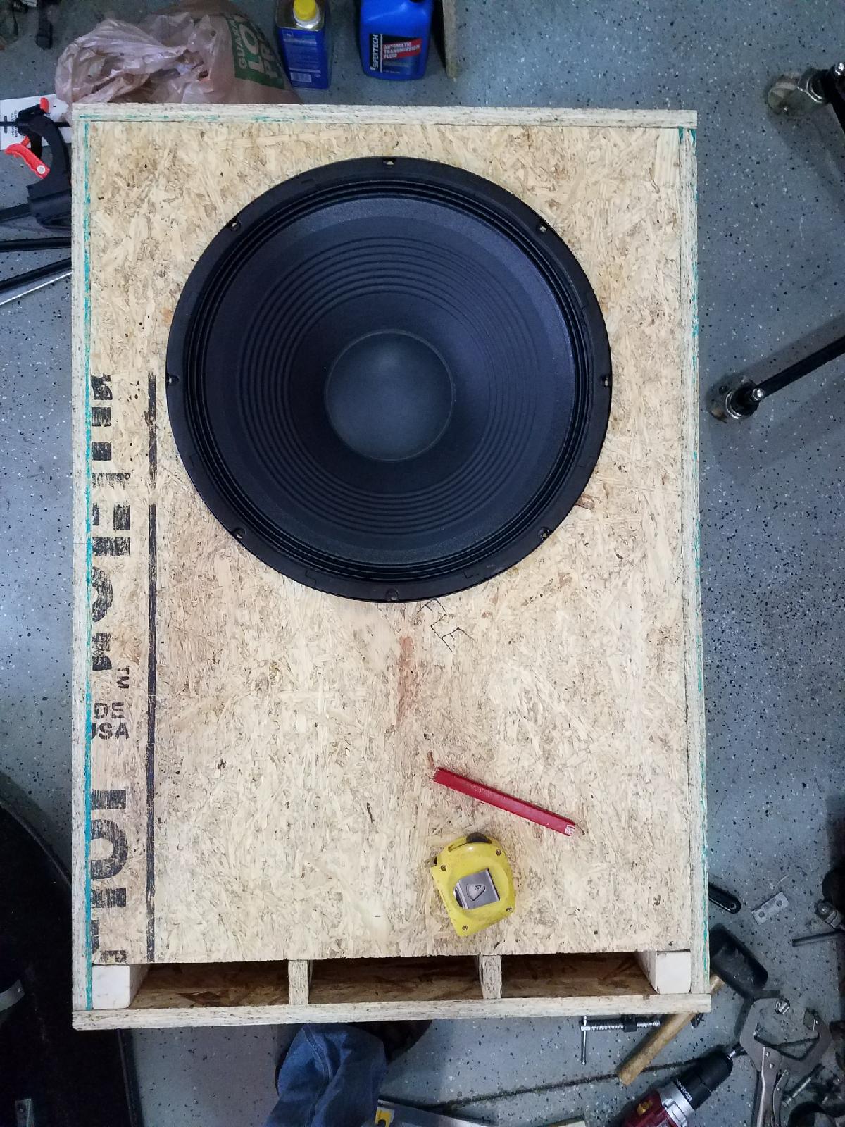

Box volume was GM's recommendation, Vas/1.44. Smaller would certainly be nicer to deal with, but it raised the f3 and raised the box q as well. Of course all the wood is already cut for both boxes... i guess i could try backfilling this one to test reducing internal volume. My insulation is supposed to be here this week, so i'll reserve judgement til then...

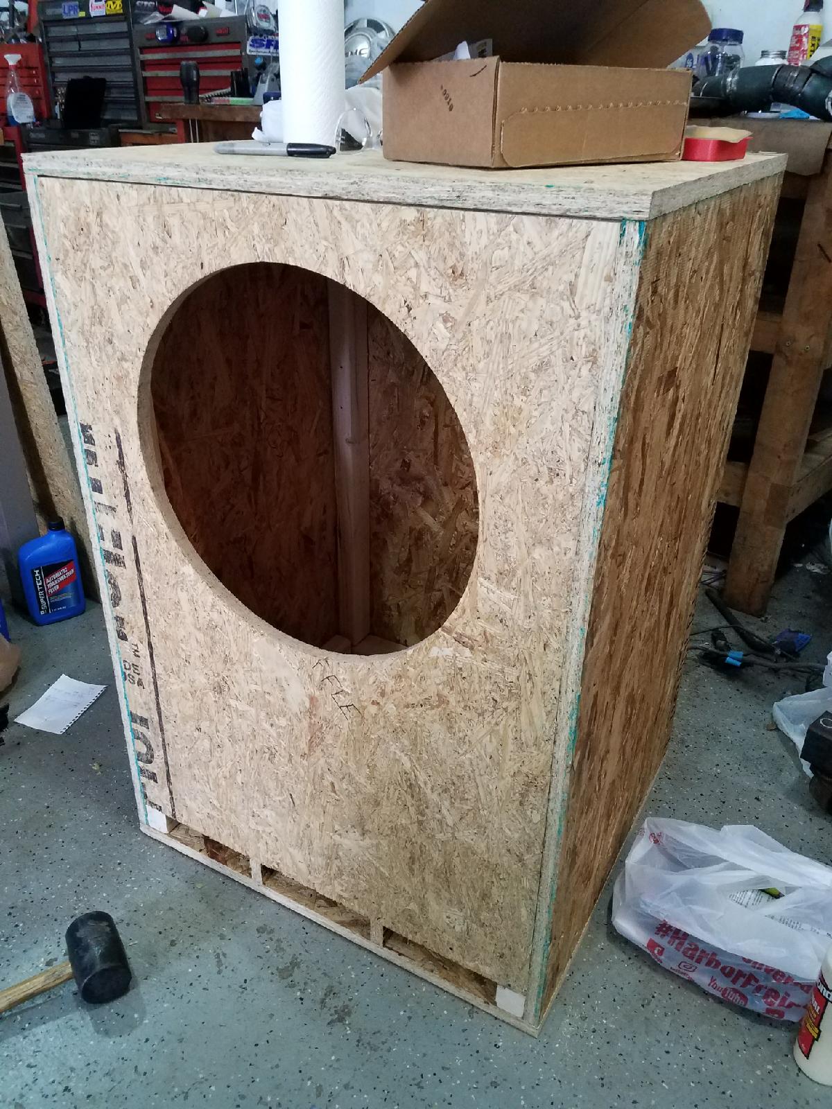

Update: Swapping to one of my receivers as an amp cleaned up the sound considerably. "Braaaappp" noise is gone, thankfully. Still quite boomy, but with some thump to back it up with at least. From the house, it sounds like someone has a car subwoofer going parked on the street (testing in detached garage, maybe 30 ft from my house).
is it just the acoustics making it sound "boomy"? it might be difficult to judge the woofer box alone as opposed to having the Fane box on top with crossover. Can you feel the OSB flex much?
Hmm, is your blade rated for OSB/plywood?

Thanks Freddy, it looks okay i think, not great though. The acoustics in the garage are certainly different than living room... thats why I'm trying to reserve judgement.

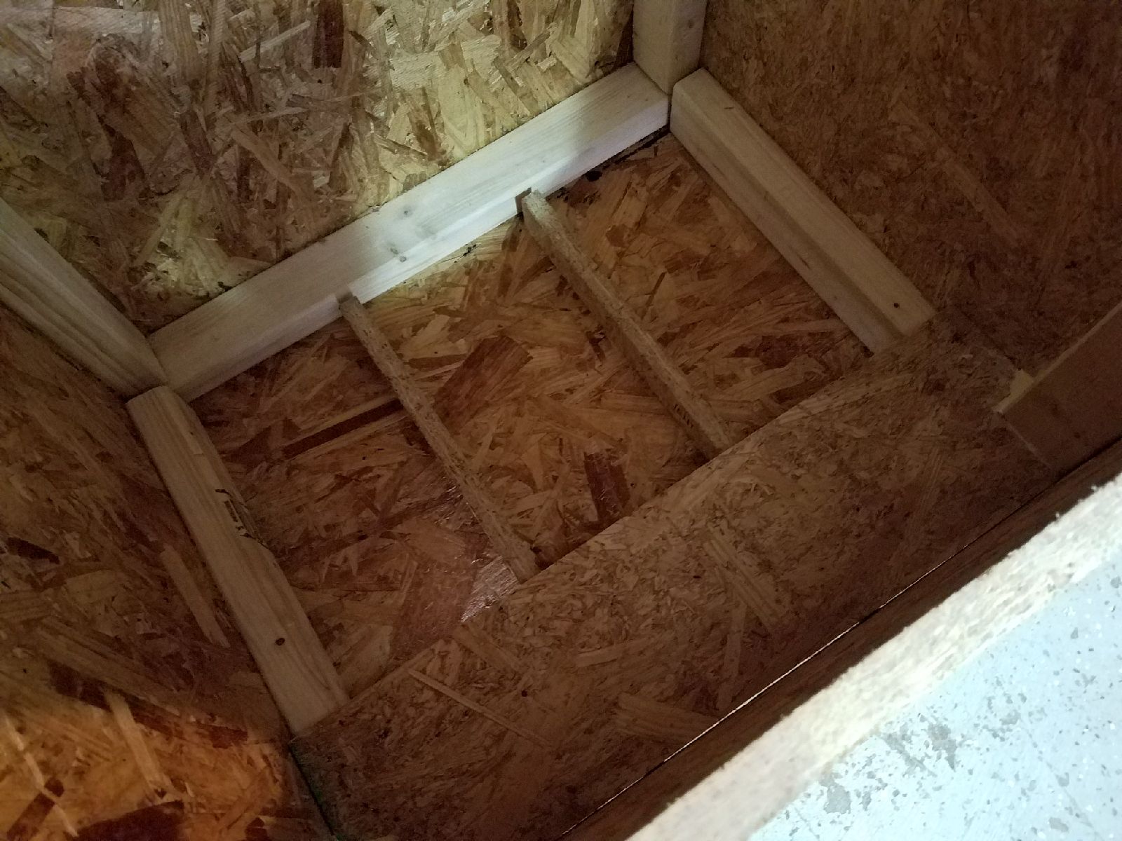

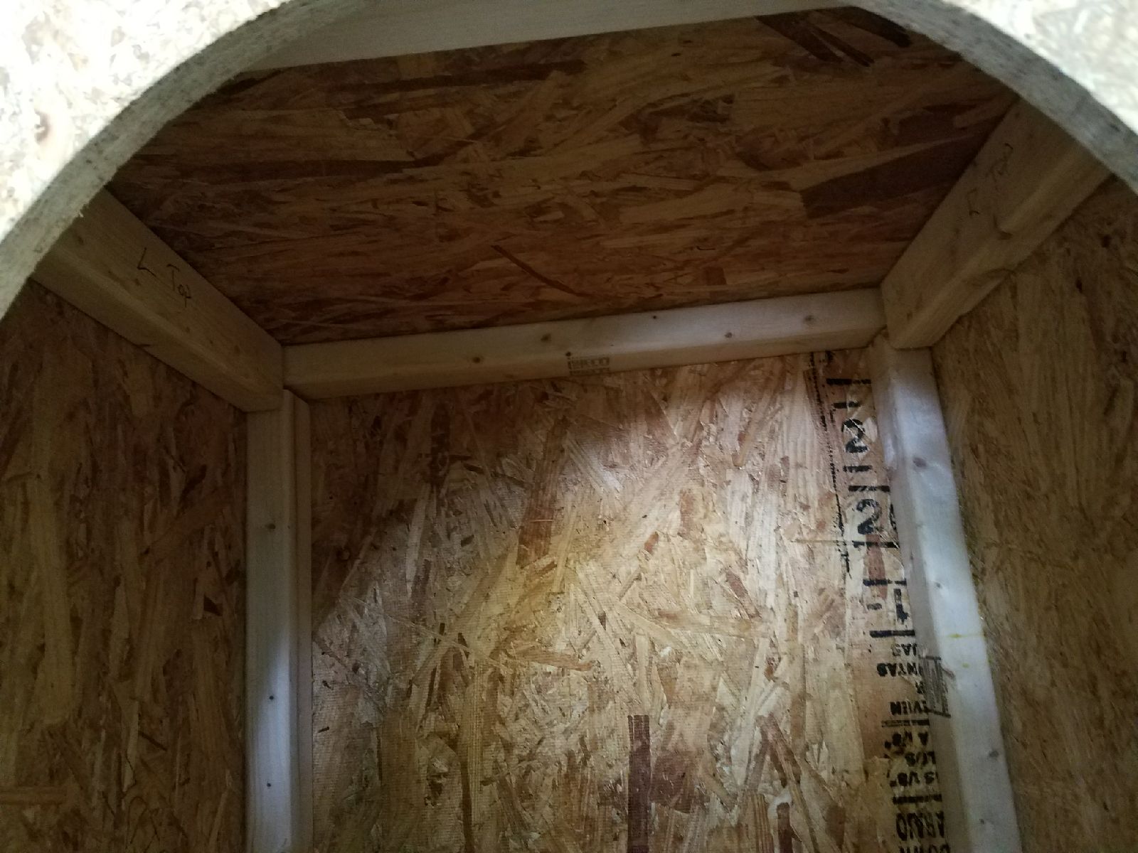

The OSB is flexing a bit on sides and front/back, definitely needs bracing.
Another interesting note, the router with 3/8 roundover works fine on OSB, no chunking on test pieces i tried, went way smoother than expected. Cutting in the normal direction worked best.

the box isn't way out of line, and yea, get the fane and sub together (flipping polarity to see which is better).
4th order (Standard ported)
vb 7.22 ft3
f3 37.88 hz
tune 34.76 hz

Garages are normally high tuned reflexes due to door leakage, so combined with hard surfaces, tend to be boom boxes all by themselves.
If OSB is obviously flexing, the driver is pressurizing the cab enough to probably be flexing too, so a double 'whammy' of conflicting amplitude modulation distortions.
Hopefully, stiffening the cab/mass loading the driver and properly placed in a decent room will smooth it out to perform as well as the sim implies.

Thanks fellas, I'll be working on the bracing and insulation on the test cabinet this week and hopefully will get the cabinet into the house after that for some real testing with it in-room and on the active xo.
