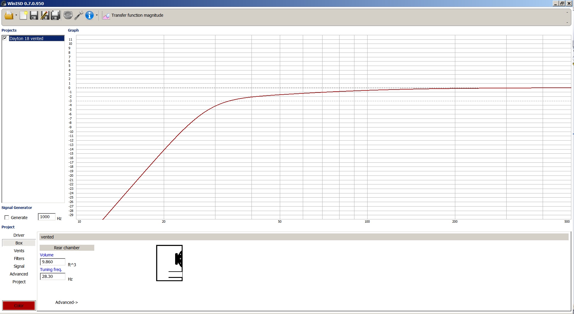

so, Vas = 402L = 14.196 ft3
14.196/1.44 = 9.858 ft3
tuned to 28.3 hz...
Looks pretty similar, but better. Only thing worse is excursion gets out of control a bit higher, so a 20 hz highpass is definitely needed... Cool beans, I'll get these guys ordered tomorrow!

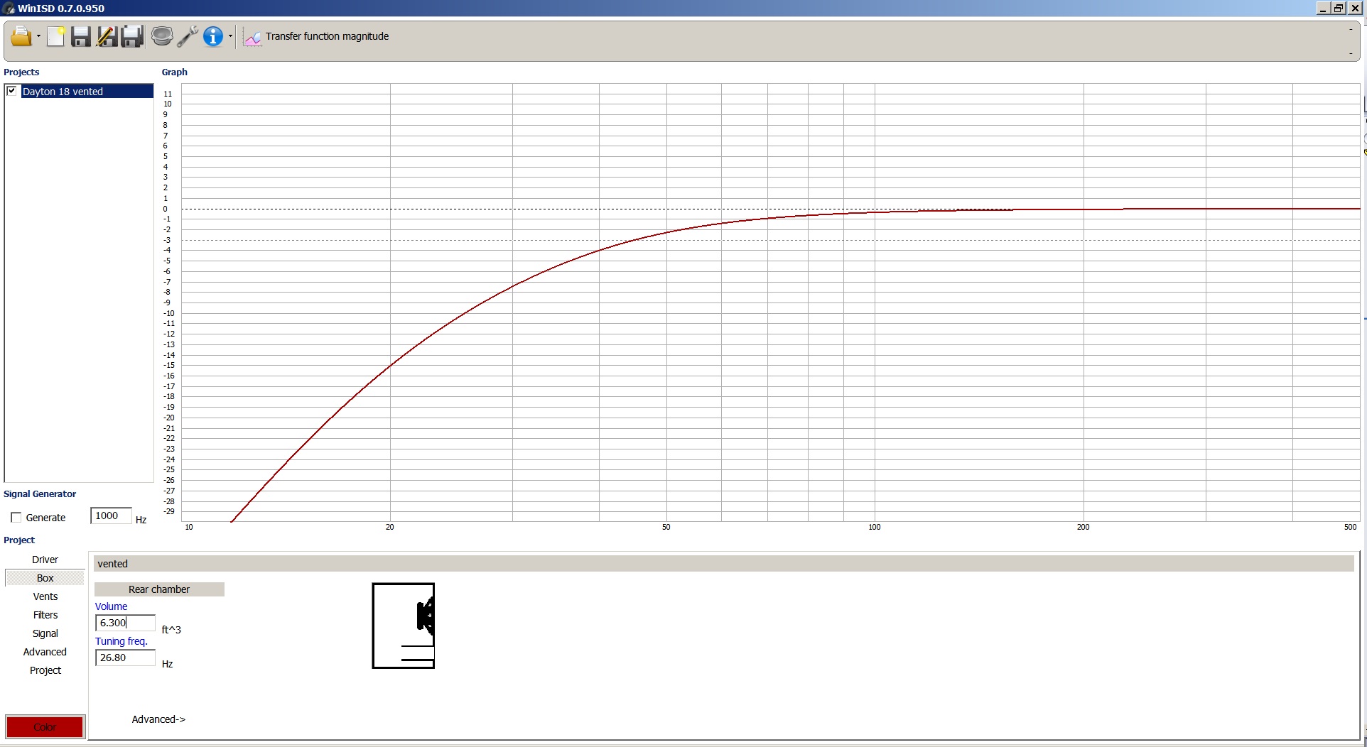

Brings the f3 up to about 45 hz, f10 26 hz, shallower roll off, still looks pretty good to me.how does it look with Vb=6.3 cubic feet and Fb=26.8?
(@ 9.86 ft3 and tuned to 28.3 hz its f3 is 34 hz and f10 is 23 hz)
Agreed! I just meant that it exceeded xmax sooner/@ slightly higher frequency.Trust me, with 6 mm Xmax, if one needs it, then the other does too

9.86 @ 28.3hz vs. 6.30 @ 26.8 hz, per Freddi:

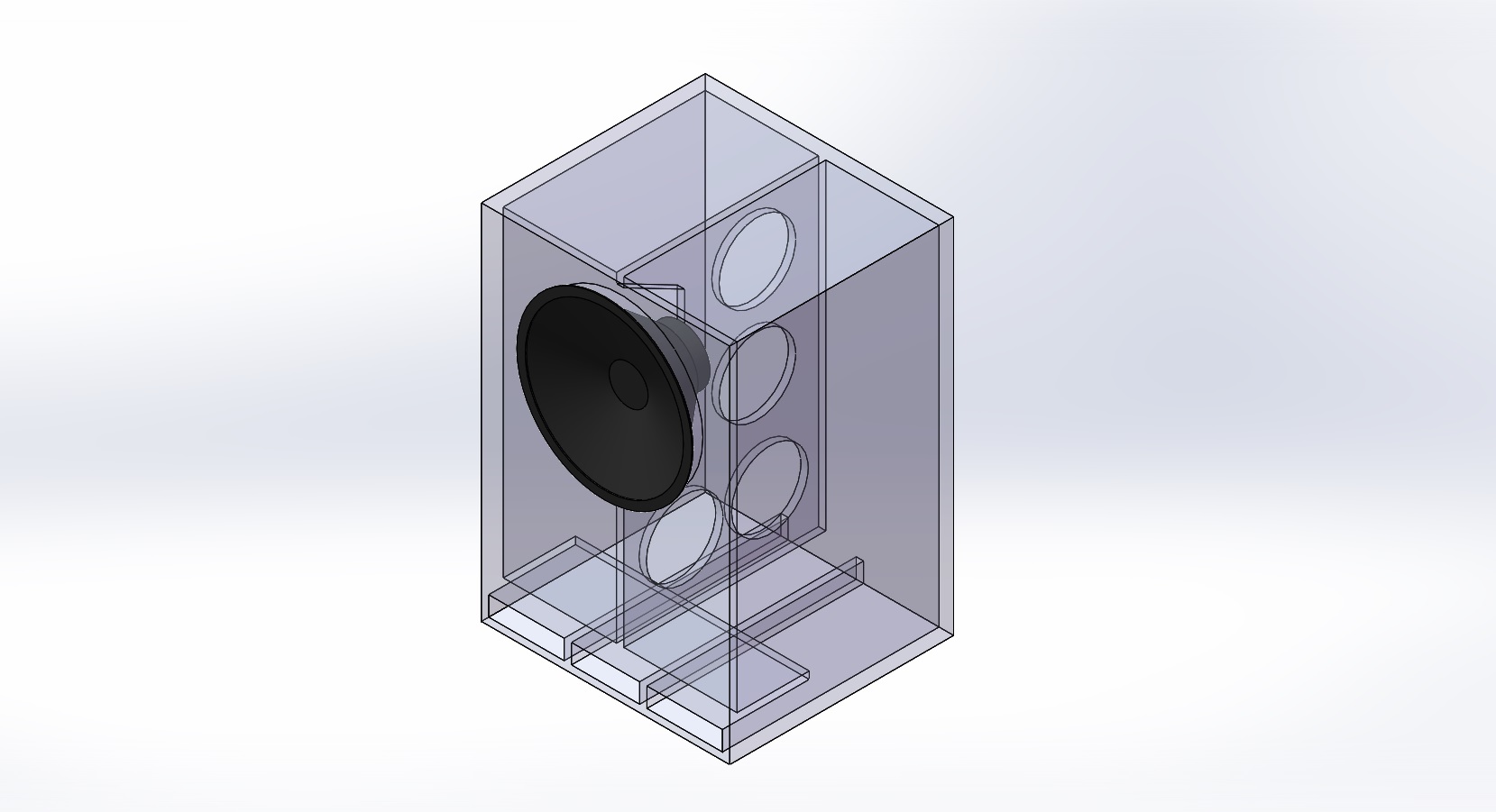

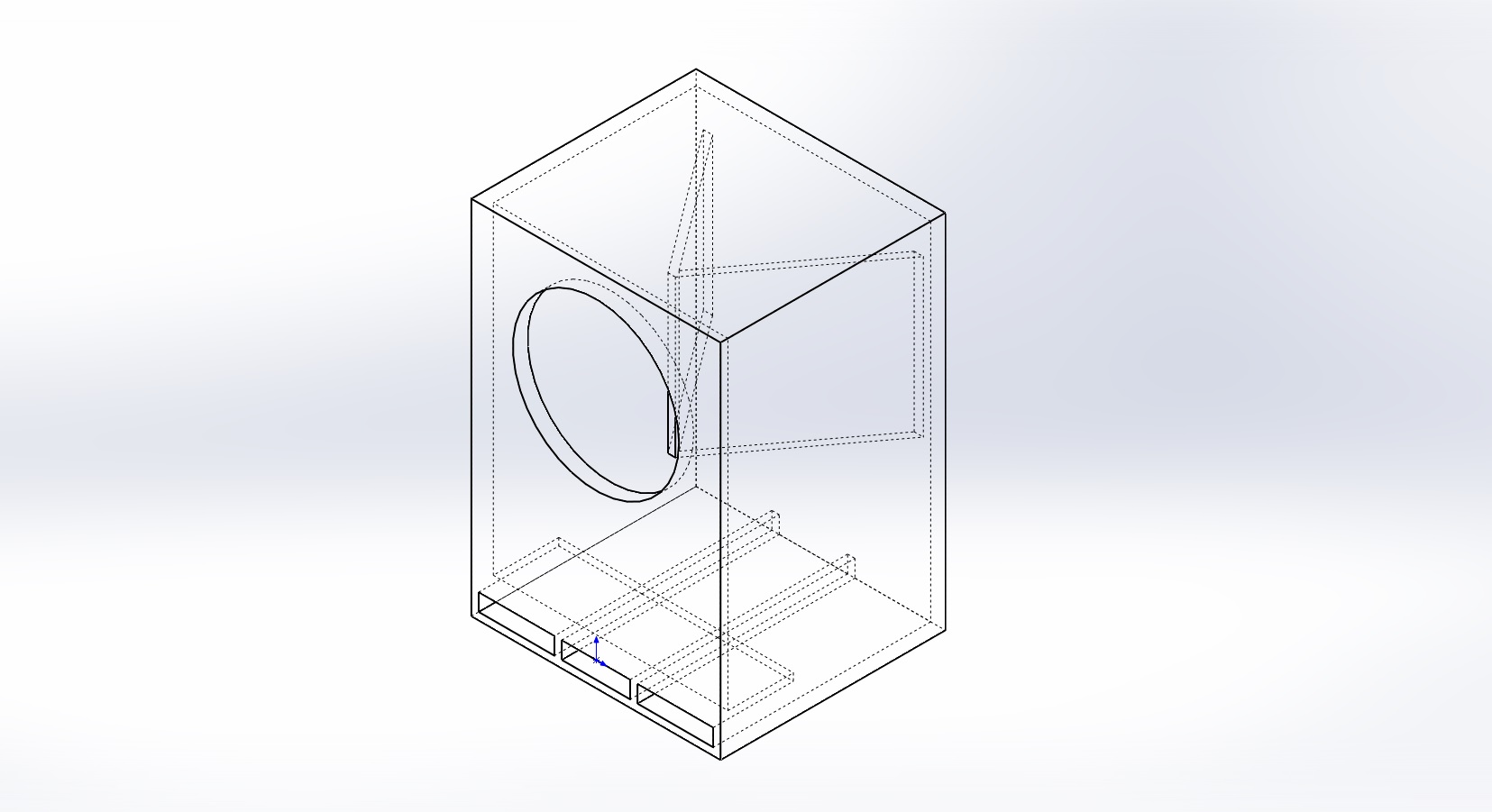

Perhaps something along these lines. 26" wide x 20" deep x 33 high (measured above vent). Vent is then 22.5 wide x 1.75 high (after subtracting for stiffeners), for port resonance of 825 hz and port air velocity of <11.5 m/s.
I'm not sure if it would fit in the room better with a wider or deeper cross section... Either way, trying to keep the top of the box around 35" high so that the full range 12" driver stacked on top is at ear level, ~42" or so.

Tried a different approach with the driver support combined with a backwave deflector... More bracing needed in either case, but might this be a good way of reducing backwave effects? The volume inside the triangle shape is left open, so it should still count as interior volume...

I thought about adding holes to them... but then they don't reflect away? Though probably as effective or more so anyway... The brace is open top and bottom, so shouldn't be any strange TL effects there...
