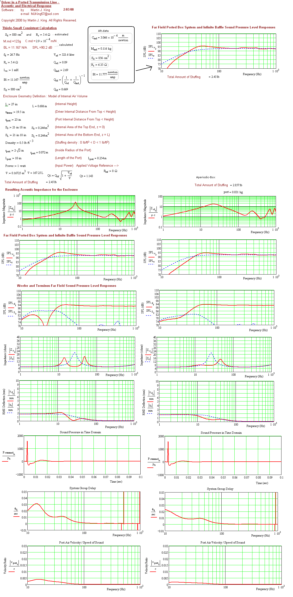

Found this in an old thread in reference to PPA15 specs, but no other detail, must have come from an even older thread, apparently circa 08. It would seem MJK treid the PPA15 at one point.. but no word on whether he or anyone else took more accurate measurements of "real" specs.
167548d1271606199-enclosure-calculations-pyle-ppa15-gif
here's a real rough 1pi kluge of a 0.91 scale 115bk with Kappa12a vs PPA15 in a 100 liter box - dunno if the little Karlson is really that hot (?)
