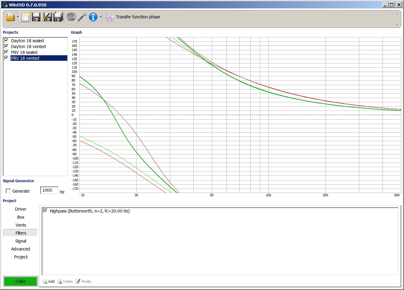

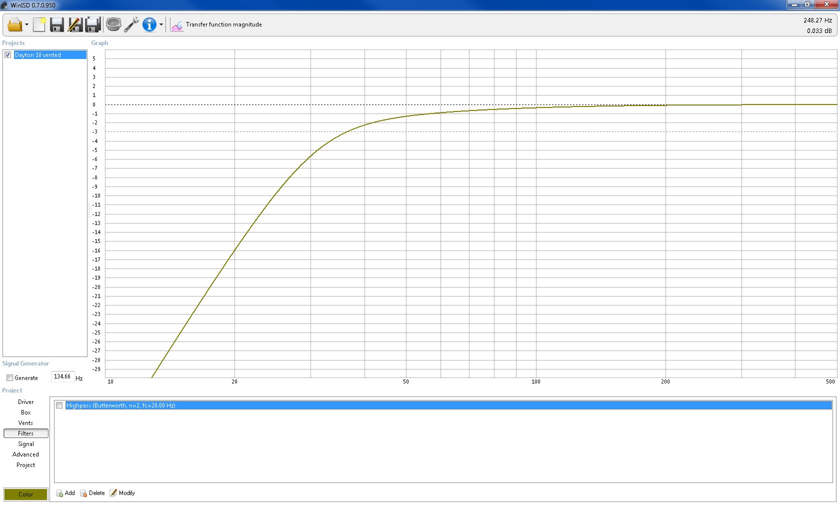

I also realized I could add in the highpass 12 db/oct 40hz filter that can be engaged on the active xo, so I added one in the filter tab of winISD and it cut things off way to high... So I'll get one of those line level high pass filters instead to use in-line before the xo, 20 hz looks much better and still keeps the drivers from exceeding xmax.
One thing I don't understand on the filter option though is the Q - it comes up as .707, so I've left it as this... but is that what it is typically? This is damping that the filter adds? This is the filter I'd use:
Harrison Labs FMOD Inline Crossover Pair 20 Hz High Pass RCA
Edit2:

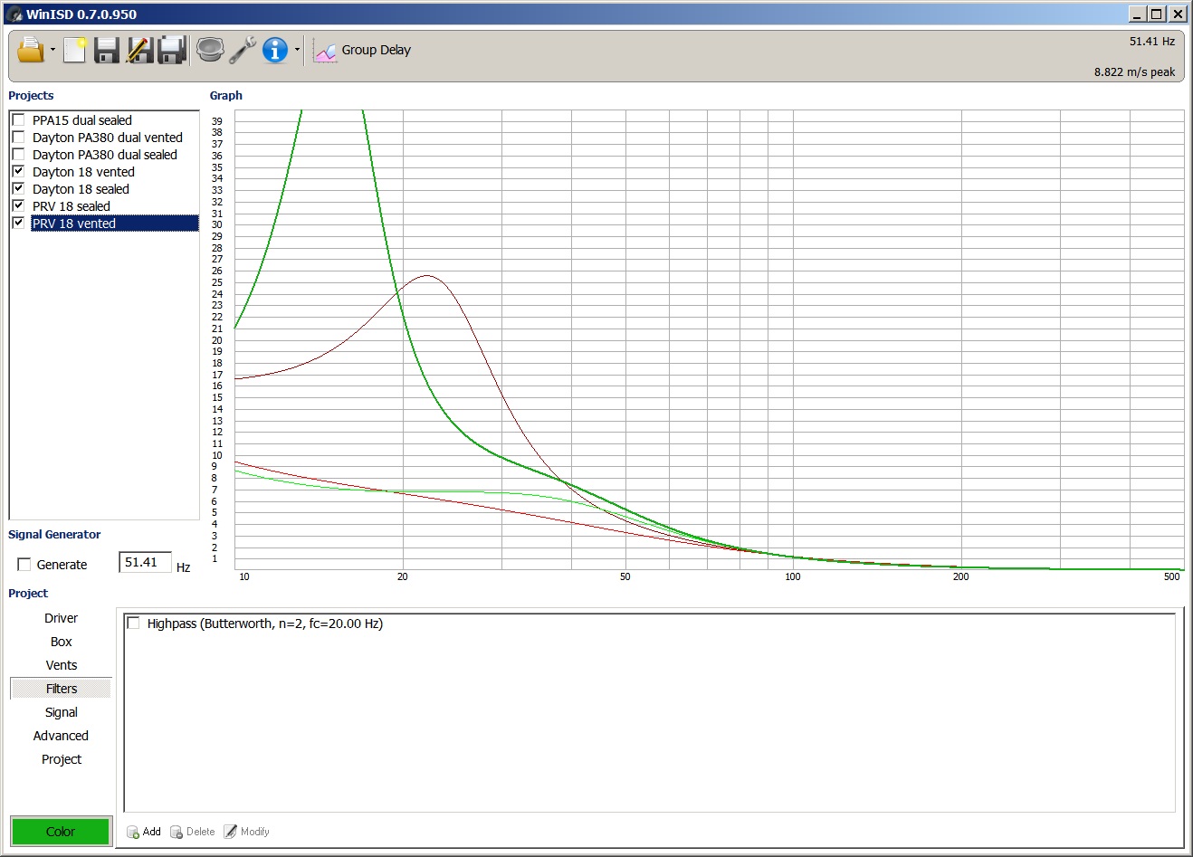

I also noticed that adding this filter really messes with the group delay graphs - makes everything worse! Also messes with the phase plot, but I guess that's to be expected. I'll get some plot screenshots up soon.

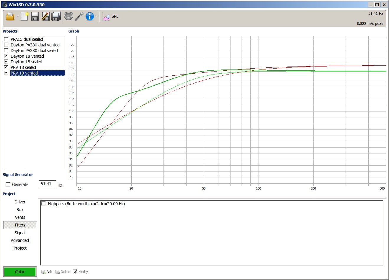

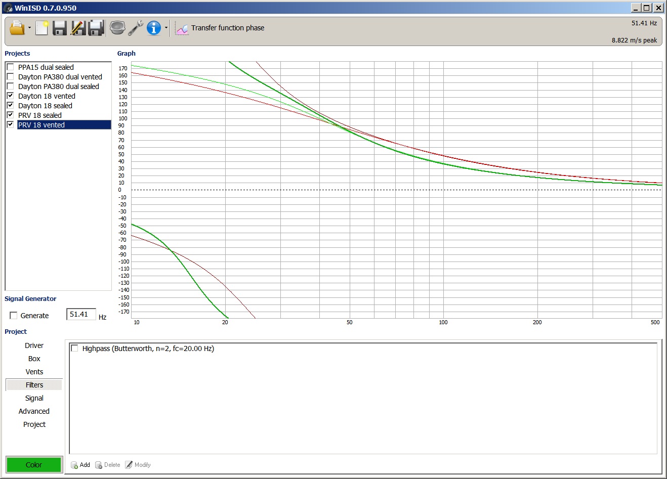

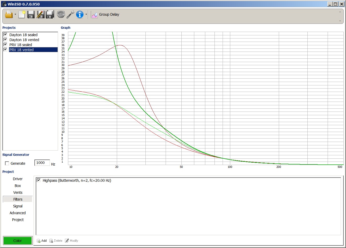

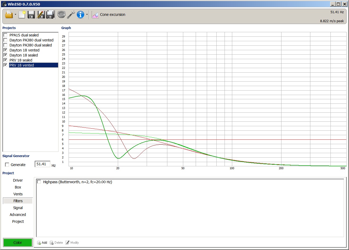

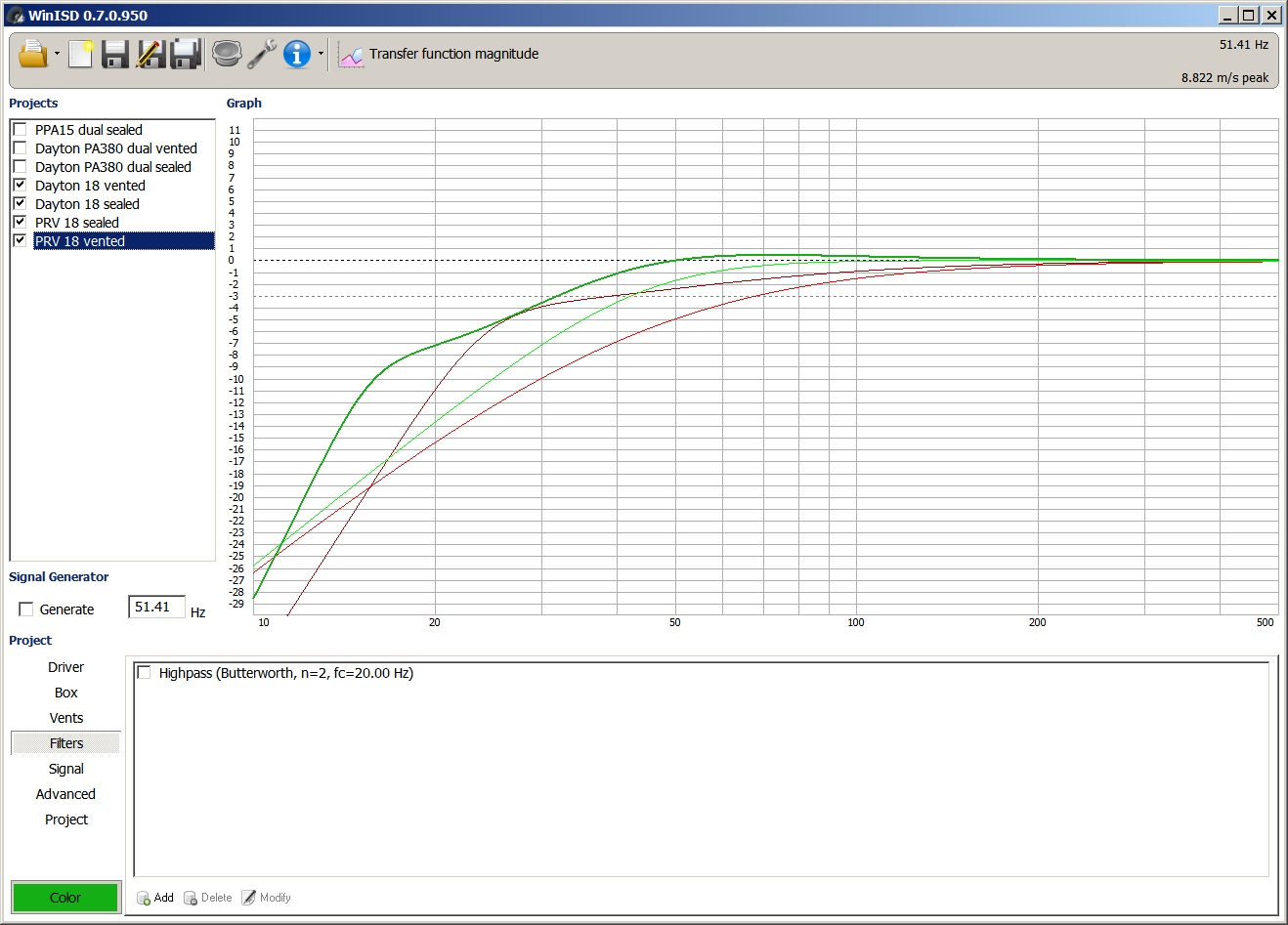

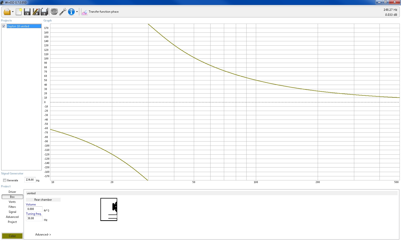

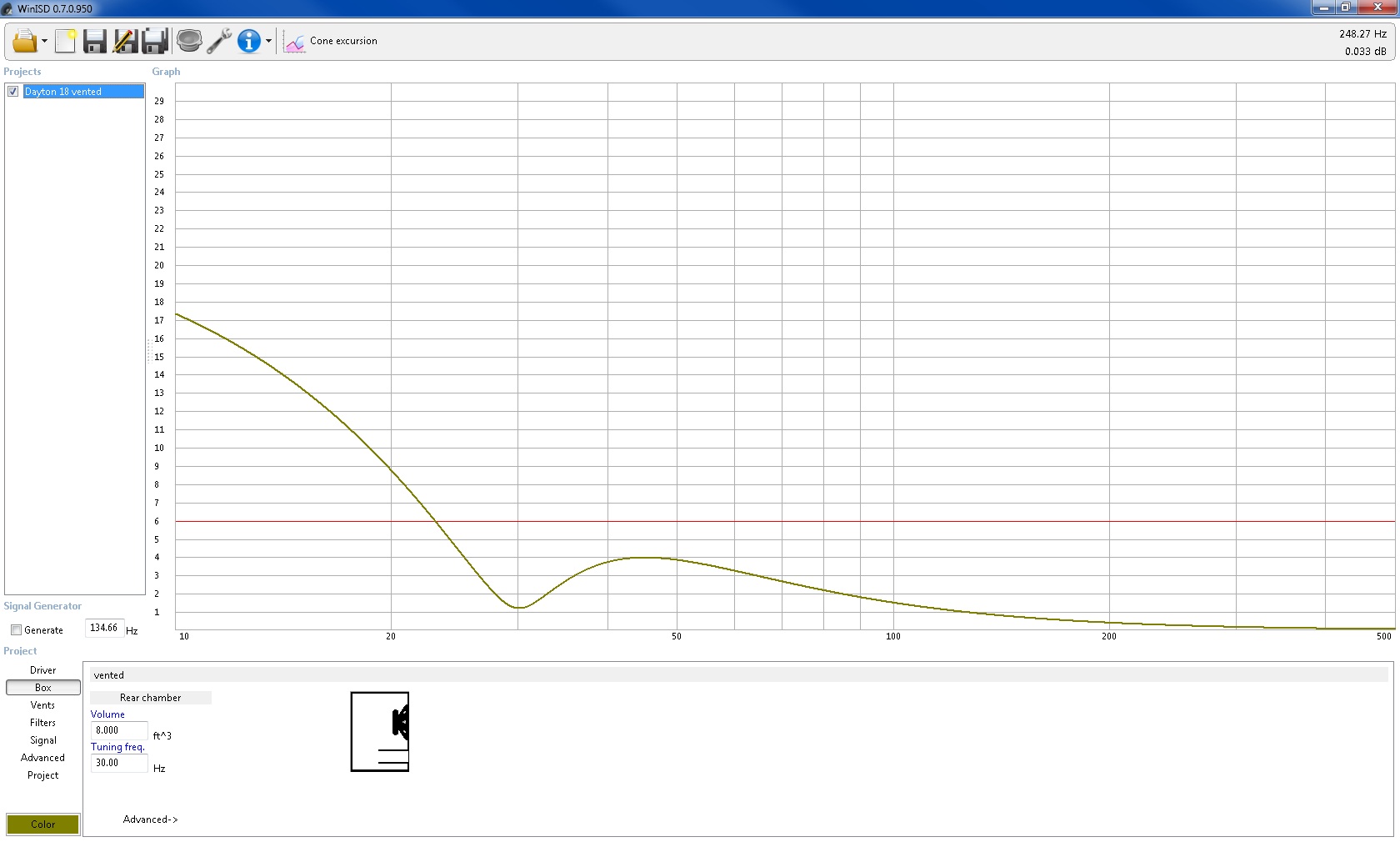

Here are plots for the 18" Dayton and PRV drivers, without high pass filters. The vented boxes do appear to need that highpass filter.
dark red - PA460 vented
red - PA460 sealed
dark green - 18SW1000 vented
green - 18SW1000 sealed
red - PA460 sealed

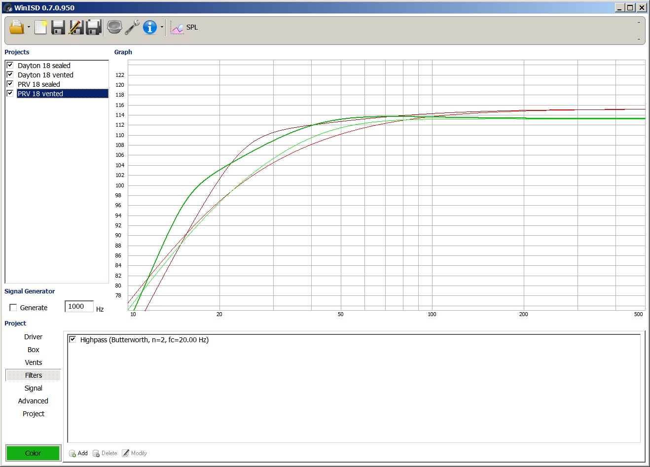

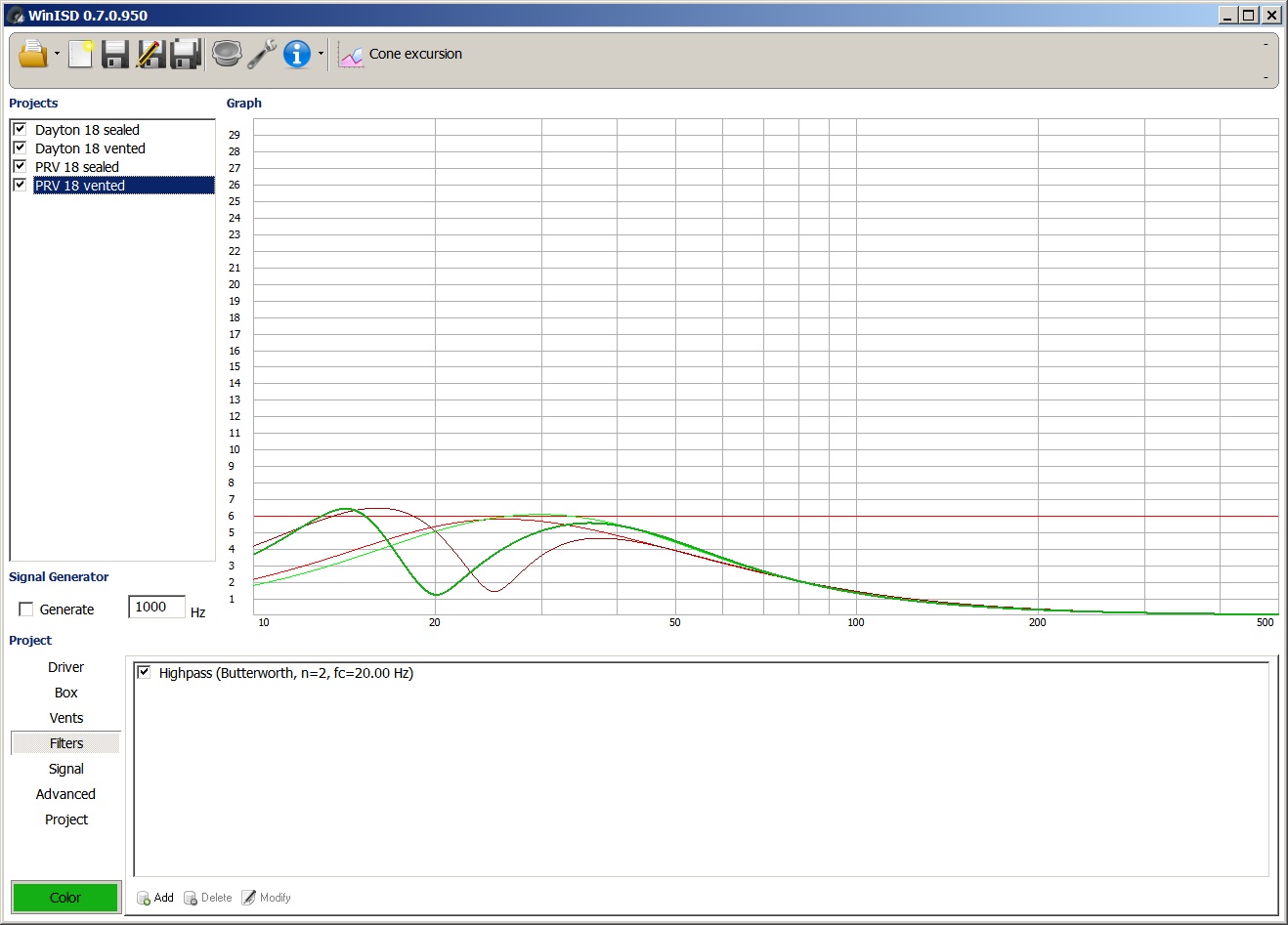

Same drivers/boxes, but with 12 db/oct highpass at 20 hz....
red - PA460 sealed
Any thoughts? Lots of people seem to be using the PA460, but the 18SW1000 vented has more area under the curve (with many different vented designs, not just the one shown), has a lower F3, less phase variation (more gradual change), and similar but lower group delay as frequency gets down to 30 hz. Seems odd then that the PA460 has a higher BL than the 18SW1000 (22.3 vs 17.3). Plus the PRV does okay in a sealed box to boot...
The 5 year warranty from dayton is certainly more confidence instilling than the 1 year warranty from PRV though.
red - PA460 sealed

Okay, let's see here... I'm still not sure on 15s vs 18s, sealed vs vented.
I'm also not sure if tuning it low like that ruins the punch and/or transients... I had tuned it low to control the excursion and group delay numbers. It's going to be a compromise I guess between punch and low end extension. I do seem to recall having a large excursion car subwoofer way back when in a small sealed box, and it didn't seem to do all that much - it probably wanted a vented box or a much much larger sealed box.
I'm also not sure whether or not there isn't some sort of optimum driver based on the relatively low wattage that my receiver amp makes ~80wpc rms. Dave @ P10 has explained that wattage ratings given for speakers are largely useless, and are usually thermal limits not mechanical limits. This much, I get now. But with only 80 watts to push the woofers, would I be better off with smaller drivers like 15's or even 12s? IE, would I be driving the smaller speakers, with smaller motors, harder and thus "punchier", rather than trying to push a bigger heavier cone but not putting enough energy into the voicecoil?
The PA460 has a Qts of .33
The 18SW1000 has a Qts of .55
From my sims, the dayton PA460 definitely would need a vented box. The pro of the PRV 18SW1000 was that it seemed to work well in both ported and sealed boxes, so I could try both options. I'm not sure about djk's posted efficiencies, I seem to get plenty of SPL for both the sealed and vented alignments - though I'm not really looking as low as 30 hz, I believe 40 hz was my reference or target. Well, maybe he's right, I see a 6db difference at 30 hz, and 4db at 40 hz for the Dayton.. but the PRV is only about 2db difference at 40 hz.

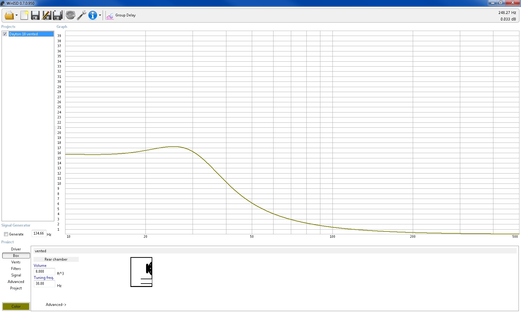

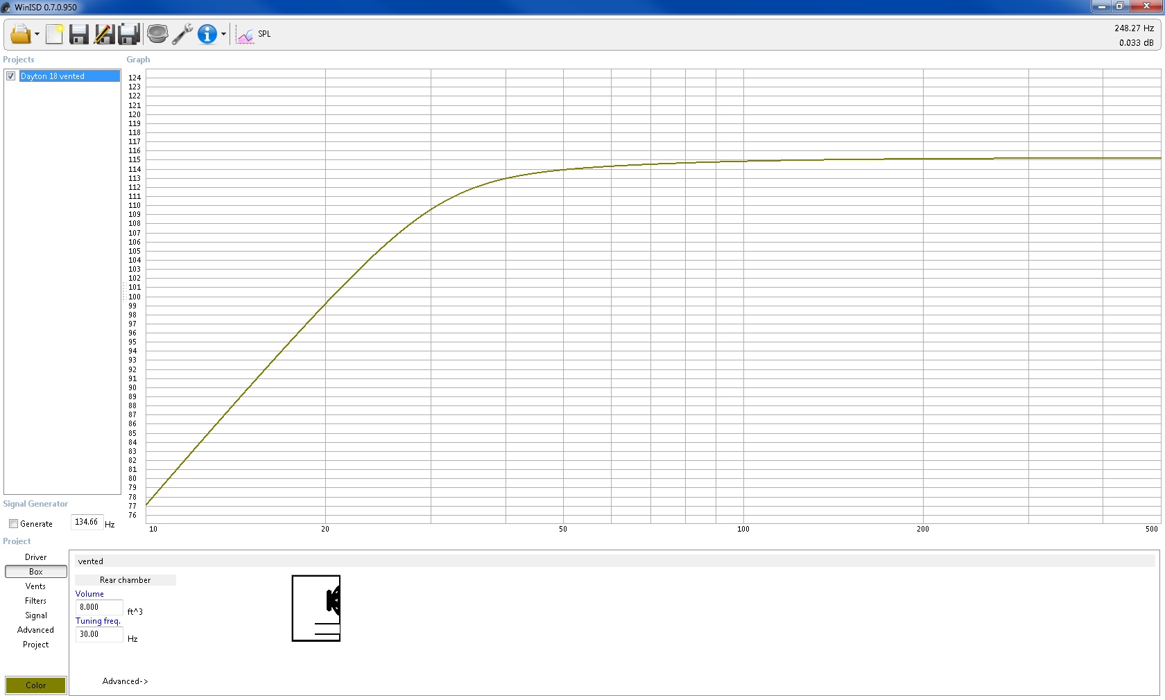

For right now, I'm about to click the "buy" button on a pair of dayton PA460 woofers, unless theres a reason not to. Seems like lots of people are happy with them and they will work well with a reasonably small ported box. Hope I'm making the right choice, sealed vs. ported... we'll see I guess.
Looking at something around 5-8 ft3, tuned to about 30 hz, slot ported. Looks like I'll then need a 20 hz highpass filter, unfortunately. I don't like how it messes with the group delay and phase in the winISD plots, I hope none of this is audible. Rumor has it that this particular driver just doesn't bottom out excursion-wise, that the VC leaves the gap before anything hits, so it effectively can't exceed that particular excursion (something beyond 11mm one way, if memory serves)... so maybe I could get away without the highpass.
The 8 ft3 box, 21" wide inside, slot port 21" wide x 1.5" high x 7.11 long looks pretty good to me.
I guess an ML-TL with this big of a driver would be monstrous, eh?
