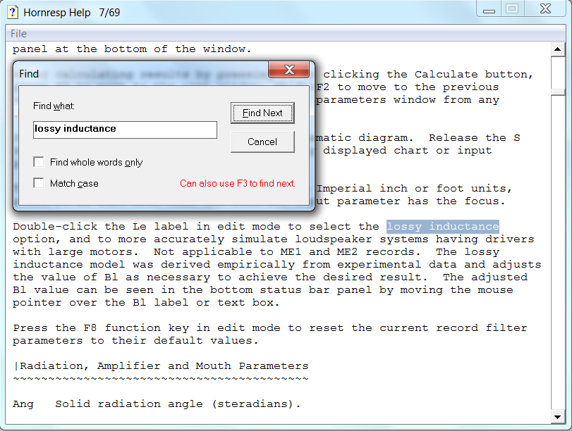

according to hornresp and depending upon tuning, max excursion occurs around 45Hz. (see the last two graphs with lossy inductance model)
'Lossy inductance'?! Where is this in HR's HELP file?
The PA460 sim is very misleading! Its super high inductance will cause a prominent mid-bass 'hump' just like he heard and realistically bass limited to ~80-100 W/1pi.

to invoke the lossy inductance model, double click the "Le" - it will turn red to Le and there will be text below to indicate its "on" . Yeah - one can get a peak with high Le
hey GM - re: reported boominess, here's my sim from above on the 460BR - did I do something wrong on the input side ? it has no damping material.
Use the File > Find menu commands in the Help file to search for references to lossy inductance.
hey 007 - check this thread Need Advice For One Pair of PA Speakers - Techtalk Speaker Building, Audio, Video Discussion Forum
Lossy Inductance is over my head, but I do get a peak instead of a relatively flat graph in winISD if I check the "simulate voice coil inductance" box. But it's only a broad 1.5 db peak centered on 120 hz. But, If I also check the "use transmission line model for port simulation" box, I get a double hump with a little 1/2 db peak at 45 hz and the peak at 120 hz. But wait, there's more.. If I check only the "use trans line model for port sim" box, I get a 1 db peak at 45 hz. Curious.
Thanks! Don't recall ever knowing about this being added.

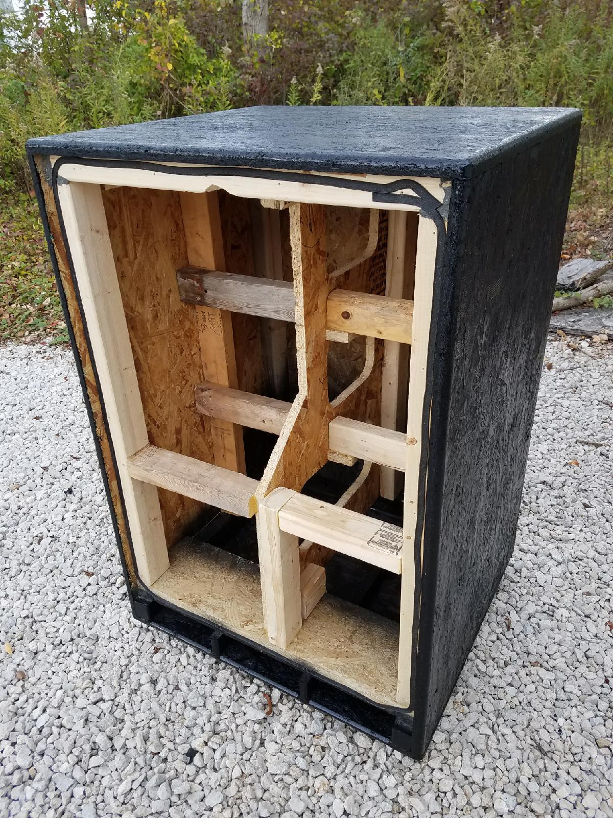

Still working on the first ported box. Added windowed center brace, then lots of additional 2x3 bracing to break up all the panels.
Tried to do some "pre-painting" of the interior visible thru the port from outside so it would look less awful later, in case anyone wondered. 🙂
Smart move! I learned the hard way that I had to do that! Does your box design account fdor so much bracing though? You're losing a lot of airspace.
Thanks, hard to think ahead like that sometimes.. haha 🙂
This box is so big I don't think it's going to matter much, but no, I don't think I accounted for this much bracing. The response in winisd looked pretty similar from 9.85 cf down to 8 cf from what I recall, so hopefully the reduction doesn't color the sound too much. I went overboard on the bracing after thinking that maybe it was all the panels resonating in my preliminary test that was making it sound so boomy and muddy.
Jesse
Edit: this thing also has to weigh around 100 lbs now.. without front baffle and driver. Craziness!
