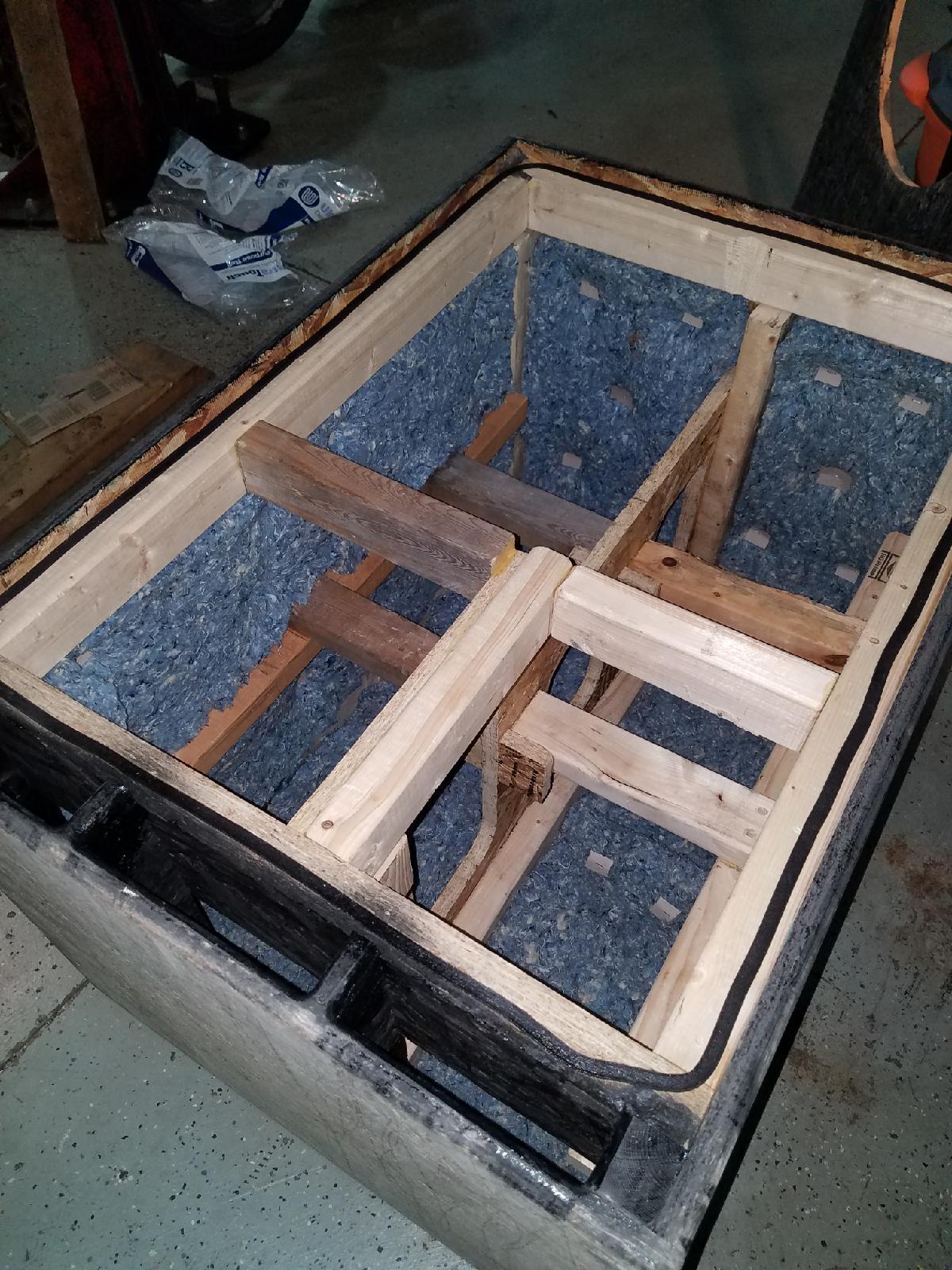

Almost ready to reassemble and bring the first cabinet back in the house for a listen. Installing the damping insulation today/tomorrow, then just need to put it all back together and move it from the garage back into house (not a trivial exercise).
I think I'm going to still try a sealed box too with the same PA460 driver. Low end response will be lacking, but if you guys are right about that being the source of the boom it might sound better for music anyhow - most of it anyway. I came up with a target of 4 cf for that, looks like 5 cf - bracing & driver puts it right about at 4 ft3. Now to just find some time to build it...!

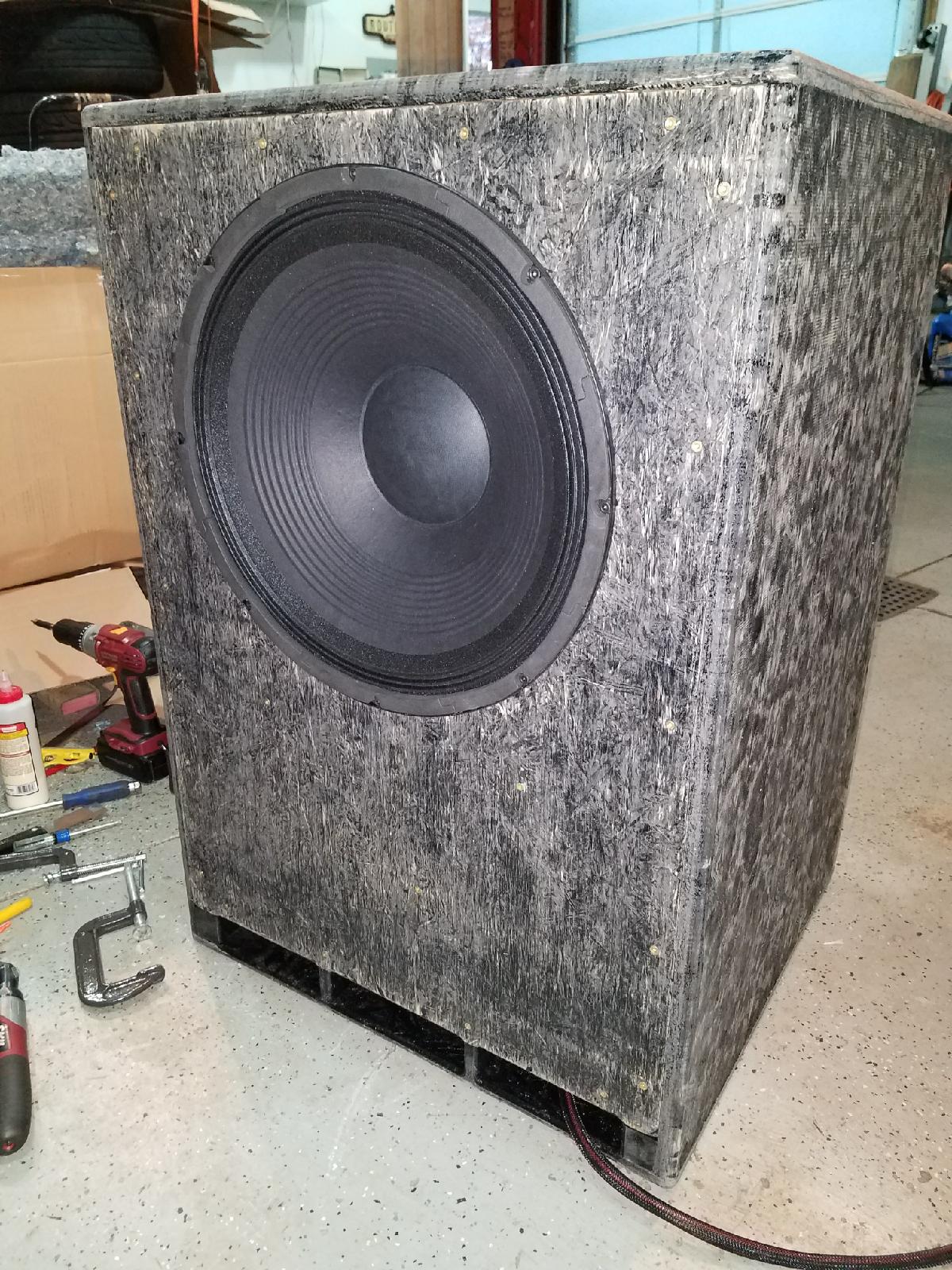

Well, after a thick coat of oil based paint... the OSB is now grainier and more splintery than ever - frustratingly so. May need to actually sand the damn thing and repaint it just so it's safe to bring in the house with the kids liable to touch it every chance they get.
Denim insulation going in well at least, it's nice to work with and cuts with a razor blade. Cut to fit between braces, hold in place, then staple in place. Using some thin cardboard scraps as "washers" so the staples don't pull thru. I'll post a picture when i'm further along.

Update:
Added damping, cabinet fairly well braced, all reassembled and brought back into the living room, and...
Its a different animal altogether now. Does not seem boomy, does not resonate, no "one note" subwoofer type bass anymore.. thank goodness. I wouldn't say its particularly tight or punchy, but at least the boom boom is gone! Seems to subjectively have good reach down low, but haven't done any frequency sweeps yet or anything. Sounds ok with the xo turned up all the way to 700hz or so, but I seem to favor 140-200 hz. Interesting is that cone excursion is now way less - the cab seems to be loading the woofer much more effectively now.
I suspect it was mostly the cabinet flexing and producing sound from the sides/back/top panels that made it boomy prior.. but theres no telling how much the damping insulation helped as well, as i didn't try running it with just one or the other.

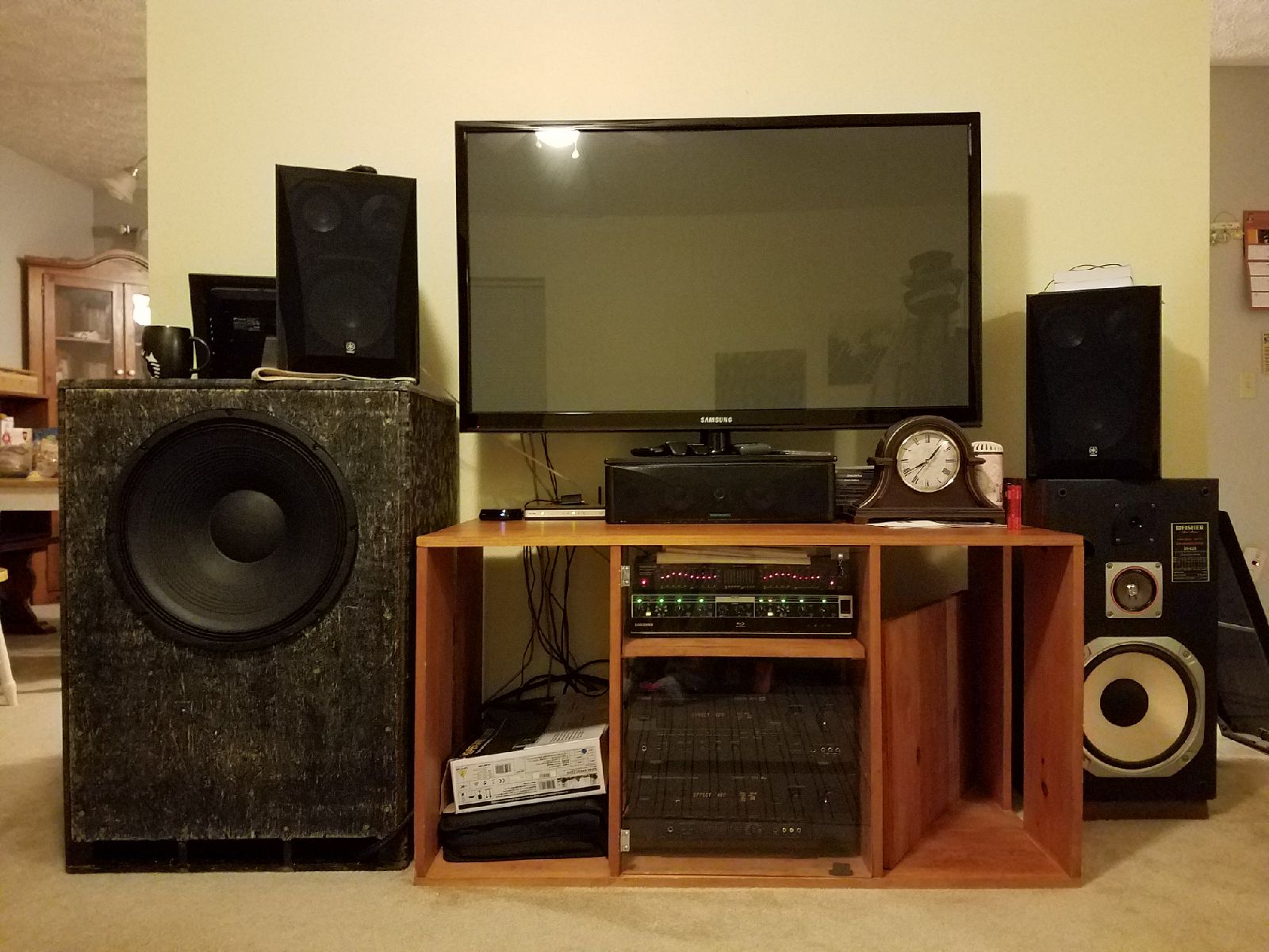

It certainly does dominate the room in terms of appearance. Sound is impressive compared to my old fisher woofers, but perhaps not as impressive as one would expect given the sheer size of the woofer and cabinet.

Thanks Mr. Bates, I need to get those Fanes in cabs soon, just need to find the time... I'm not sure I followed your above post, you moved your dual 15s to the corner and the bass got better, not more boomy?
As you can see in my last picture, theres a doorway to either side of myy stereo setup, so LF bass reinforcement is probably even less than just up against a wall.
