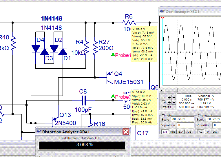

Wow! I just took the time to model DX's amp and it's one for the books. THD over 3% at 1KHz. I think I'll pass...
MJL21193 said:Wow! I just took the time to model DX's amp and it's one for the books. THD over 3% at 1KHz. I think I'll pass...
Sorry going OT, but Carlos designs his amps using a simulator as well and I'm sure he wouldn't be happy with > 3% THD either. So I wonder what's happening?
It is the first version that I modeled. Oops. The second one looks better, but I haven't modeled it yet.
Sorry for the mix-up.

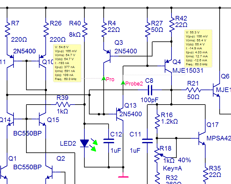

I'm not sure hat you are referring to. Look at this latest schematic and comment in relation to the components on it. For example: put a 5K resistor between Q56 and Q78.
Updated schematic. How many now? Not much similarity between this one and the first one, except the output stage.
OK, let me suggest a better way of doing the transistor clamp. The diff pair is current limited by the emitter current source or resistor. So, it is best to clamp the base drive to the beta multiplier, we want the transistor off and a high impedance until it turns on during overload. The collector is a high impedance so you want a PNP transistor with the emitter connected to the positive rail through a resistor to allow adjustment of the current limit point. The base goes to the base of the VAS to sense the Vbe drop. Here's a picture where I tested it in the 990, I lowered the VAS emitter resistor to 20 ohms which I think is probably a good value for your design. R24 in the collector provides a bit more protection:
http://baselaudiolabs.googlepages.com/990_clamp.PNG
So, I've been meaning to suggest some emitter degeneration in the VAS, keep it small so that you do not loose positive swing there.
Base stoppers on the output devices might help stop local oscillation there.
I like the idea of 10 ohms to isolate the front end supply rails from the drivers/outputs.
I see you upped the diff pair degeneration to 220 ohms, I think this is a good idea, helps keep the front end linear, but you'll want to check distortion performance as you add degeneration which will lower your open loop gain.
You really should have a look at the loop gain and phase margin and perhaps make some adjustments for stability. Look at low frequency to see if your bootstrap cap is large enough.
I'm always looking to eliminate electrolytic caps, don't know why Self called out a 47uF across the Vbe multiplier, 1 uF or even .47 film should be fine.
I've been meaning to say that you might run the VAS at 10 mA, then looked up the part and see that it is an 8A 50W part, where it's beta begins to be spec'd at 100 mA. You could up this to 20 or even 50 mA which would be unusual for an amp like this but might work out better given how large those devices are. You'll want a good heat sink on that part at these higher currents. I would not go higher than 50 mA due to SOA considerations and the high supply voltage that you're using.
Yes this is more effective. It eats some power (down 4watts to 147W into 8 ohms), but it solves both the >20KHz clipping and keeps the current through these devices down.
I adjusted the resistor values to give the best distortion, while keeping an eye on the VAS current.
Thanks Pete. 🙂
Here's what I did:
A simpler way is to replace Q3 with a series string of four 1N4148's to clamp the negative swing at the base of Q13.
I took your suggestion, increasing VAS current to >12mA. This allowed me to reduce the emitter resistors in the differential pair, thereby reducing distortion even further (presently it's at .036% THD at 20KHz at full output).

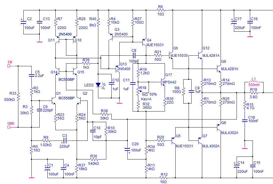

Here's the latest schematic update. I have changed some values and moved the clamp base. There is a definite trade-off with this clamp - higher distortion. I did my best to compromise.
VAS current is now ~15mA. I tried higher but the distortion level went wild, and >20 KHz clipping shows a big jump in current flow.
Quiescent current is sitting at 88mA (best distortion at this setting).
I have added the 10 ohm R's on the rails to isolate input stage from output and I will ad base stoppers to the output devices.
Look it over and let's see if we are getting close to a decent amp.
At risk of starting WWIII;
This is completely wrong and it simply not work in the real world. The operation of your VAS over-current clamp is entirely dependant on Vbe of both the VAS and clamping transistor.
This is why the THD goes through the roof when the VAS current is increased - Vbe of the VAS transistor rises and the clamping transistor is biased on, even when the amp is just idling.
The clamping transistor must NOT be biased on during normal operartion otherwise it will introduce distortion. The purpose of the clamping transistor limit the VAS current ONLY during clipping.
The way you had it connected the first time is the correct way - with the base of the clamping transistor connected to a emitter degeneration resistor for the VAS transistor.
Your emitter degeneration resistor was 20 ohms, giving a VAS current limit of approximately 30mA. The VAS clamping transistor will begin to turn on with about 0.6V at it's base - which happens when 30mA flows through the 20 ohm resistor.

I actually agree to some extent. The very large emitter resistor is making your clamp operate in a highly linear way, when you want it highly non-linear. Any sense point will do, you could split the 100 ohm load and go closer to the rail. Or you could go back to the 20 ohm and sense at the emitter, I was thinking of the JE990 where 30 mA would be too much. You've got an 8A VAS transistor - LOL. If you up the VAS bias to 15 mA you'll want the clamp up around 40 to 50 mA so that it can swing to the rail.
You could try the diode string but you don't get a lot of adjustment with it.
Also your VAS R load of 4K+4K with a 56 V supply yields 7mA not 15.
I think that you're close, it's a lot of work, but we've identified a problem with beta multipliers and it's going to take a bit of time to find a good solution.

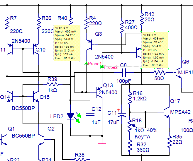

OK, I did a more complete simulation of a very similar power amp, more based on the 990, but very similar to what you have. I was also unable to get the best performance with the transistor clamp, so we should step back and take another look at the problem. The simulator was giving some very strange results with the clamp that did not pass a sanity check in any way what so ever. I don't usually see this with LT Spice. I did not try altering any of the simulation controls to fix this, because I just don't have the time.
Back to the current limit issue. The other front end transistors do not have a problem because they either have a resistor or current source limiting Ic. The simple solution, and it works fine in my simulation is to put a 5.1K resistor in the collector lead of your Q13. With normal signals only a very small signal is produced at the collector. However under clipping conditions the current is limited to about 10 mA, (300 mA without the resistor) the key is that there is a large drop on the resistor under this condition and so Q13 does not see the combination of high voltage and current as it does without the resistor. It is an excellent solution.
I get .002 ish THD at 20 kHz just below clipping into 8 ohms, and .001 ish at about 46 Vp out.

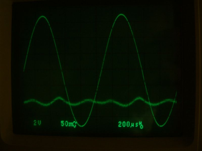

When you initially suggested it, I tried the string of 4 diodes to replace the clamping transistor. It worked effectively but it had the current going through Q4 too high and as seen in the graphic, distortion was big and the waveform is visibly distorted.
Any ideas on fixing this?
Also, I'm learning that I can't trust the distortion readings or the oscilloscope when these measurement "probes" are in the circuit. Somehow, they corrupt the output.

MJL21193 said:
No problem Glen,
I have a few fields of knowledge where I consider myself well versed; basic electronics is not one of them. I'm learning though, with the help and incentive I'm getting here.
OK, unfortunately that wouldn't have worked at all because the diodes need to be the other way round. Also, the diode clamp must be used in conjunction with emitter degeneration of the VAS transistor, otherwise it wont work either.
Connect the diodes the other way round (anode to the positive rail), get rid of R4 and put an emitter degeneration resistor on Q4's emitter.
Start with, say, 30R. By adjusting this value, you can set the current at which the VAS is clamped.
