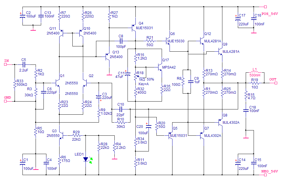

PB2 said:I'd add a Baker clamp as seen in the 990...Check to see what your design does when driven 20 - 50% into overload at 20 KHz. Like it or not you will probably hit some clipping from time to time.

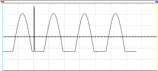

With just .3Vpp it turned nasty. Took a while to educate myself a little on what a Baker clamp is, but I think I've got it.
Look at the attached pic. I don't know if this is exactly it, but it seems to work, doubling the clipping limit.

Sorry, I should have mentioned that it goes on the VAS, no not on the diff pair. Take a look at the JE-990 schematic, see page 3 here CR4 is the Baker clamp:

.3V? I would have expected 3V in for a typical amp. What you should hope to see is clean clipping.

G.Kleinschmidt said:
I’d omit C19 and R28, connecting C12 directly across the LED.
You are using a bit of a big transistor for Q14, which has high collector-base capacitance. With the high voltage signal swing at it’s collector, modulation of the bias voltage (and LTP tail current) via Cob at high frequencies could be an issue.
A nice, low ESR capacitor for C12 would in order. Maybe even another one from the base of Q3 to the negative rail. At 22k R9 is a bit large too. Drop to around 1k or so.

The circuit you decided to pick on and take the hatchet to was a days work to get right!😱
First, C19 is innocent, not hurting anyone. Second, the rest of this circuit has a magical ability to tame startup transients. Changing any value here and the trouble begins.
No, I don't have a clue how this is, but it works.
Originally Q14 was 2N5550, but it would run too hot (too much current?). I then tried boot strap but abandoned it and went with a tougher transistor (boot strap is a true POS).
How is the high capacitance a problem? Stress the input stage? Would it be better to cascode a couple of BD139?
Remember, I'm working with what I've got.

I have input sensitivity at 1.2Vrms (3.380Vpp) for this amp. Above that, clipping starts. So at 3.780Vpp, there was complete wave deformation (at 20KHz). This doesn't happen at lower frequencies.
Now that I look at the schematic that you pointed to, I see that it was suggested in an earlier post. X-pro, in post #5 recommended it. I tried it with the device he mentioned, but it caused the output to go to rail voltage.
Now I have tried it with 1N4148 and have the bottom of the wave clipped and get some brutal spikes happening.
Is there a more suitable diode or is this indicative of a bigger problem somewhere else?
Here an image of what the clamp is doing:

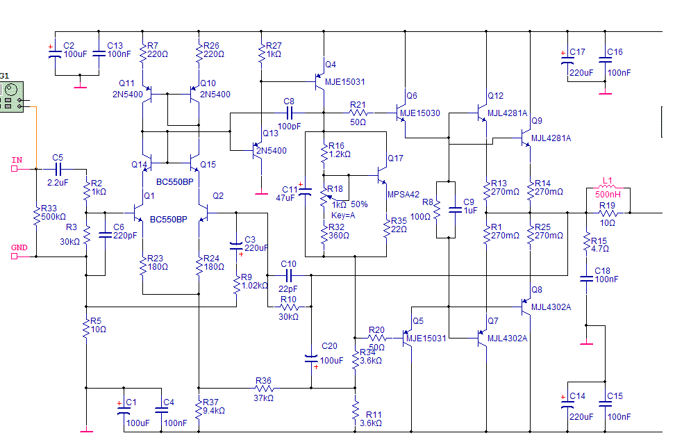

Well, I eat my words, because I'm back to boot strap for the VAS. Working with different values, I found it to be working now as good as the current source.
I have abandoned the idea of a clamping diode in the EF. In real life, I'm sure with the correct device, the results would be worth it. This amp (if running as predicted) would have to be driven pretty hard to start clipping (excess of 150Watts into 8 ohms). I know, why take the chance?
Update of the schematic where I have made a few changes. Most notable is the switch to boot strap. Also, I've changed the Vbe transistor to MPSA42 (gives better distortion?). Changed Q13 to 2N5400 as this will not see a lot of current.
A few other things here and there.

You linked to the jcx schematic earlier and I tried it out, with an input cascode using higher gain (lower voltage) BC550. Results were very good, low distortion (not as low as the other) and better high frequency clipping behavior.
I will do some more work on it but here it is. See if I did anything wrong or configured the cascode correctly.
Comments, suggestions always welcome.
No, that's not it, I think you misinterpreted me.
Isolate the bases of Q14 and Q15 and then duplicate jcx's D1, R19, and R20. where you would use 1K for R19 and 30K for R20, the diode can be a 5V LED or a zener to drop 5 to 10 V or even 20V since your supply is so high.

Here's the resistive divider method that I just tested out in the JE-990 with a referenced to ground. That 5V LED requires too much current to turn it fully on, just find a decent reference. The reference voltage is not critical at all:
