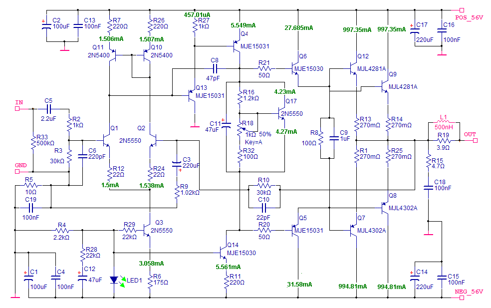

Help with this amp? A patchwork product of simulation
Nice, clear Lin-toplolgy amp design, I like it!
I'm sure your design should work and perform good but I've some comments:
- I would place a resistor in series with R18 for some protection purpose, because when R18 adjusted 0 Ohm then output stage would blow because of enermous bias current and thrmal runaway. A serial resistor could solve this problem.
- R20/21 seems to be too low. For OP devices 1...3.3 Ohm is correct value but for drivers I rather use 22...220Ohm.
- R9's ground need to be the signal ground
- for 4 Ohm speakers I would change C18 to 150nF, preferably FKP
- I would fusing the rails, say 6.3A/F
- what about placing a terminating resistor on the input terminals? 100k...220k will do the job.
- C8 Miller cap seems to me a bit high, I wolud try 68pF or even 47pF.
Dzsoni
Hi Dzsoni, thank you for the encouragement. 🙂
Series resistor with this pot is a good idea - I'll do it.
No problem changing R20 and R21 (I don't have these 1.2 ohm values anyway). Testing with 50 ohms.
I'll route R9 to signal gnd.
I most likely will not be using this amp for 4 ohm load.
Fuses yes. Will add after.
What do you mean "terminator resistor"? I don't know what that is.
Miller cap - I have some nice monolithic ceramic 100pF caps but no 68pF or 47pF. I will make the change on the schematic, but unless I get others, I'll use the 100pF's.
Also, my earlier offset problem at the base of the drivers can be cured by changing the forward voltage drop of LED1 from 1.66V to 1.54V. Now, I know an LED is not adjustable, but is there another way to do this?
Thanks for the help.
About terminating resistor see attachement.
Decreases noise and using it will not allow C6 to form a low pass filter with a series resitor that is on the output on the source.
Now R2 and C6 forms the filter, but let's think about what happens when say there is a 4.7k resistor on the output of the preamp. Then R2 will be virtually 5.7k...
Most designer omits this resistor but for example John L. Hood and others are always used them (see Naim).
Sry I almost forgot to attach the schema about that resistor

Schematic update.
I have included the improvements recommended by Dzsoni: Adding a 160K resistor to the input, a resistor in series with pot R18, increasing base stopper values on Q5 and Q6 and I have changed the miller cap to 47pF.
Also, recommended by Andrew, I have changed R19 to 3.9 ohms (forgot to do on an earlier update).

did any of those changes make any difference to the sim report?
How does the sim react to changes in C10's value?
Have you checked that each of the currents through all the components make sense yet?
Are all the voltages making sense?
How about increasing the LTP degen values to 100r or even 200r?
What about changing that EF to a low capacitance type, eg 2sa1360?
and adding a protection transistor (To92) around the VAS/EF?
I make r33 much larger (2M2) to ease the load on the source and make r22 larger (300r), but this is only my preference.
Stability compensation cannot properly be assessed in the sim. You will need to fine tune the final PCB values.
I widely used 100k as terminating resistor, in my latest design I used 470k as I remember. I have never had any problem with these values. The input impedance of MJL21193's amp will be enough higher (about 30k) then the "standard" 10-20k.
But I trust AndrewT so you could use a resistor with a value somewhere between 100k and 2M2, say 500...800k
You mean R23/R24? As I know R=26/I(mA) is the right formula.
Good point, Andrew. I agree 100% here.

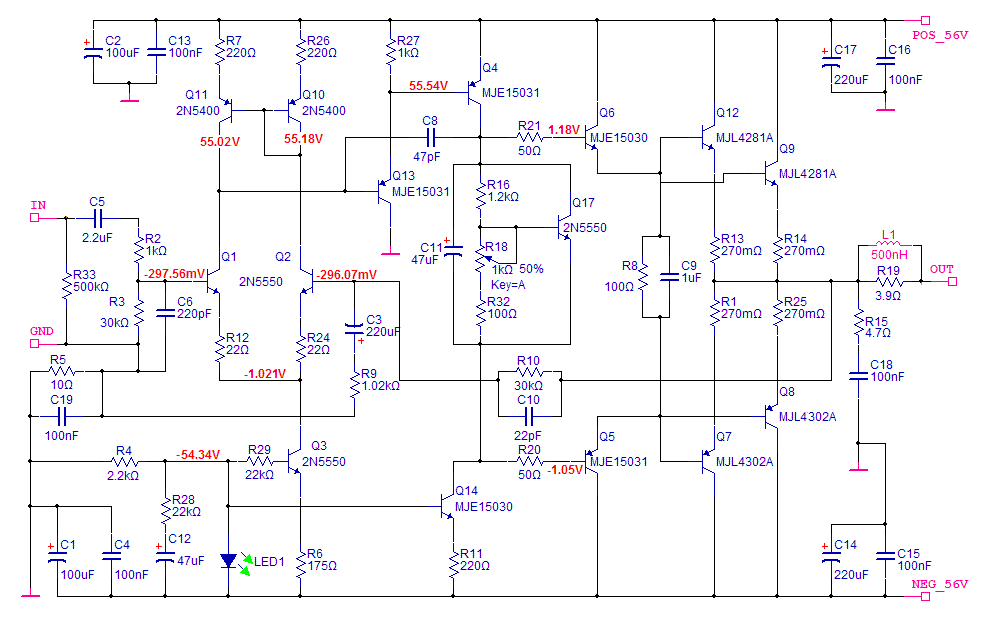

The changes had subtle results, total of all is now I'm getting .000% THD consistently. That's at 1KHz at 152W into 8 ohms. Something must be right. No other amp I've modeled has come close to this (as mentioned before, the SymaSym was the best at .008% THD at full output)
Changing the emitter resistors higher results in higher THD. 22 ohm seems to work about the best here.
I'm working on a schematic that will have current and voltage readings at different places. I'm still not 100% sure what these readings should be.

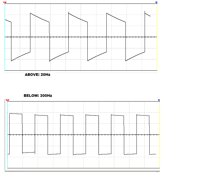

I have a couple of square wave plots to show. The one on top is at 20Hz and the one on the bottom is at 300Hz.
Any explanation for the sharp down slope at 20Hz? Still a small amount at 300.
Any ideas?
These square wave graphs are just normal.
These slopes are caused by the high-pass filter poles: in the input (C5-R3) and in the feedback (C3-R9).
Try the following with your sim: change C5 and C3 to a really-really big value, say 10.000uF. Then watch 20Hz and 300Hz sq-wave with the sim's scope.
You will find the slopes will disappear.
Of course in practise never use such high value caps there, these 2.2uF and 220uF are just fine.

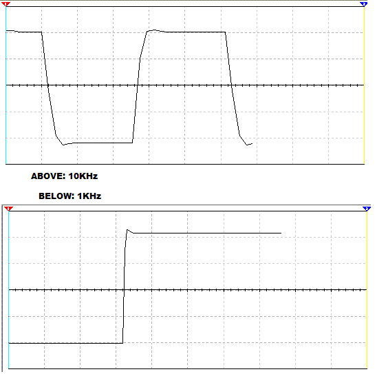

is that overshoot on the leading edge of the square wave.
Do 1kHz sqwave and zoom in to see. Indicates a lowish phase margin. Temporarily reduce r2 to 10r to remove most of the low pass filter action and see if the overshoot gets worse. Then try 10kHz sqwave.
How much does the sim say the distortion gets if you increase r23/24 to 200r? does it exceed Symasym? Does it get rid of the overshoot?
Plots for the 1K and 10K with R2 reduced to 10 ohm are below.
Distortion goes up to .003%, so no, not as high as SymaSym. No, still a slight overshoot on the squarewave at 1K.
