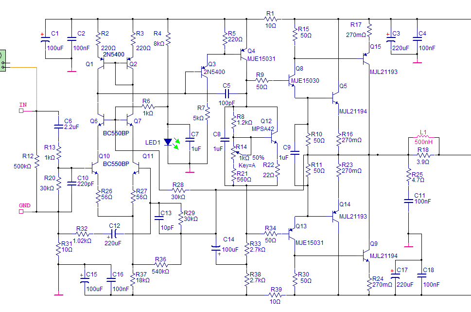

We'll put the diodes aside for the moment, as I think I have the problem solved.
Is it possible that by raising the current in the VAS, Q4 will not reach saturation? I have noticed that clipping is controlled above 20 KHz now that the current has been increased.
The addition of a resistor on the collector of Q13 limits the current in the VAS during clipping.
It's playing out very nicely on the simulation right now.
I will post an updated schematic shortly.

Okaaayyy....... This is a bit embarrasing, but we have all been getting ahead of ourselves here by a long shot.
One thing that hasn’t been mentioned yet (I am a bit guilty here too) is that it is NOT rail clipping which will cause the VAS current to skyrocket – there must be somewhere for the excess collector current of the VAS to flow.
Current limiting of the VAS is only generally needed if the output stage is also current limited with a clamping circuit (which typically diverts the VAS current to the load). In the basic unprotected “D.Self” topology such as yours, it really isn’t necessary.
Q4 will saturate of when the output voltage rails out in the positive direction, but the Q6 will still only draw from the VAS the small base current it needs to maintain the peak output current through the load.
That’s why your amp is working fine in simulation. If your output stage was I-limited, and was driven to "clip" at a lower output voltage into a excessively low impedance load, then that would be another story.

MJL21193 said:Here it is. Less is more maybe. What I have is ~11mA through the VAS, increases to 23mA with +3Vpp on the input (total 6.38 Vpp). Less than 2Vdc at the base of the drivers (both positive and negative).
Low distortion across the board.
The VAS given that it is an 8A device is not the issue at this point anyway.
Let me give you this to think about, what is the power dissipated in the 1K that you put in the collector load? Remember I suggested a 5.1K.
Answer this: what is the max current in Q13 during clipping?

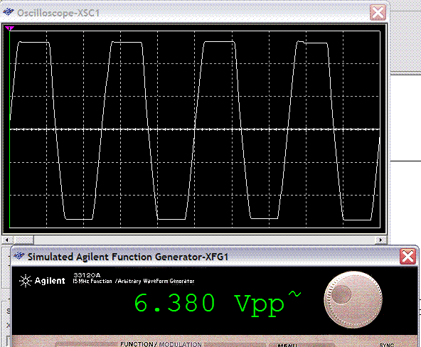

With the input signal increased by 3 Vpp to 6.38 Vpp, current through Q13 measures as 16mA. 3.38 Vpp input (and below) 2mA. I wasn't looking at Q13, my mistake.
I'll change R22 to 5K.
Pete, what is your theory on the clamping action I'm seeing now?

R21 looks too high to get the output biassed to any sensible current. Maybe around 300r.
The cascode driven by r28 looks interesting. Did it show on the sim?
I don't understand R36. That would seem to modulate the voltage on the LTP tail, changing the LTP current with output voltage. As output goes positive the tail current reduces and as the output goes negative the tail current increases. Seems odd?

Hi Andrew,
I am getting 97mA quiescent current through the output devices with the trim pot R14 set to 50% and no signal on input. Is this what it should be? Around this amount seems to give the best results in the sim.
Details on the cascode are back in post #60. Much thanks to Pete (PB2) for proposing it.
The way I understand it, R36 serves a similar purpose as R28. Details on that are in post #58. It was "borrowed" from a schematic by jcx in another thread (see picture below). Once again, thanks to Pete.
With Vr14 set to 500r and r21=560 in series the Vbe will generate 1200/1160*Vbe across it.
If we assume that Q13 Vbe is high @ ~800mV then the multiplier has 1628mV across it. This allows about 200mV for the effect of r22.
If your sim is saying 97mA are passing then Vre is 97*0.27=26mV.
We can then calculate the 4 Vbe of the drivers and outputs as 1628-26=1602mV.
Let's assume they are all the same @ 1602/4=400mVbe.
Better assume that the real life Vbe will be around 600 to 650 mV and then calculate back to the value of r31 required to set bias to just above your maximum likely value. I reckon 300r gets you close.

I have done what you suggested and grounded the output. I'm seeing 95mA through Q4 at full output, but as I go higher, the current draw falls. Is this normal?
Shown is the reading at 2 Vpp above input sensitivity.
Are you reading that virtual meter, or looking at the time domain waveform? You have to look at something like a scope trace, and look at the VAS current at the positive max, clipped point. What I said earlier was very much worst case, and more real world. My sim drives 240 Amps into a short circuit, which would blow the bonding wires in the outputs, so it's not realistic, obviously the fuse would blow at that current. The 240 Amps causes a large drop on the .27 ohm emitter resistor causing the VAS to see less voltage and current. I think you're OK and the 50 ohm base stopper is helping to limit the current under worst case conditions.

Q4 (in the sim) doesn't saturate any longer. I have over-driven by 10+ Vpp with no bad behavior; voltage at the bases of the drivers (Q8 and Q13) remains less than +/-2 V.
There seems to be clamping with no clamp. Could it be the result of the increased VAS current? That's the only real difference between this configuration and the previous ones.
Here's a view of the output at 3 Vpp over driven at 20 KHz.
