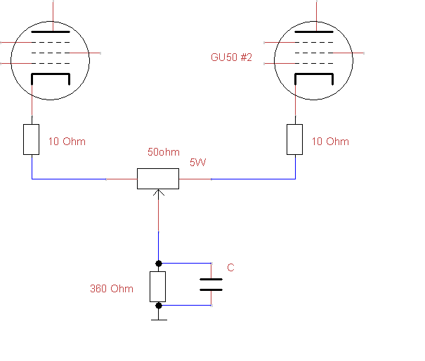

Since I want to use whatever I have in hand. I don't want to buy another OPT for more current. The OPT that I have are 3.5K and V/I = 400v/60mA = 6.666K. I therefore have to go PSE and it's good that I have more power too.
I know I can go auto bias for pure class A, but don't know how to balance the 2 tubes. If I go fixed bias then I push the amp into A2. Your suggestion ??

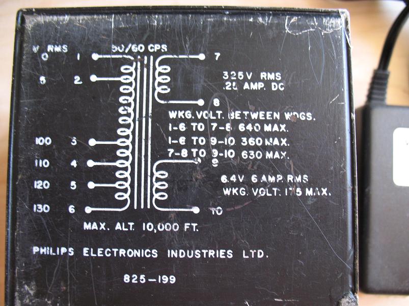

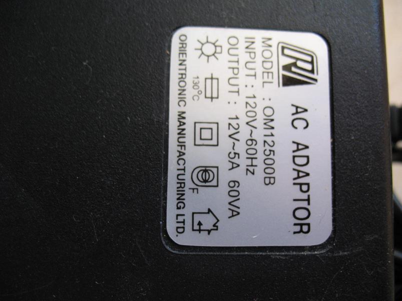

I just received my power transformer.
Nice PC, close to 6Kg. Hard to believe on the plate only 250mA.

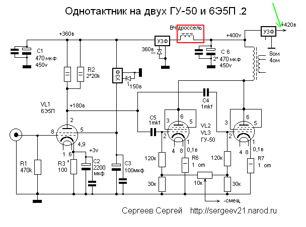

I decided I will build the Sergeev schematic. I'll build that amplifier.
All do he use 420V I have to go a bit higher voltage, my power transformer will give 450V under load even if I use power choke.
I think if I go with lower bias (must go lower because my power transformer do not let me to bias each tube 90mA). May be 65mA/tube.
Someone sell a nice Hammond choke 500mA 1000V on the forum, if I can get one that will be enough for both channel.
From the schematic I'll remove the choke and I will use it somewhere where I pot the green arrow, or between the PS caps. So I can use one choke for both chanel.
I hope that not a problem.
I have 8 tubes 4 sockets, the driver tubes etc.
If I get the power choke after I need only the OP trannies, I can start test her.😉
Greetings Gabor

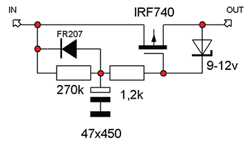

What is called UZF on schematic is actually a source follower, with 360V Zener on gate with capacitor in parallel. With such voltage stabilizer you don't need any choke.
Hello Wavebourn
If I go 450V plate voltage the 360V Zener still OK?

You will get something like 358 Volt after stabilizer with 360V Zener.
Of course, if you remove it and use choke you will have higher voltage. But do yo need it for 6Э5П?

Here is the UZF someone advised to me but I have to check all the parts if there are up to the higher voltage so I can use it on the GU50 tubes.
