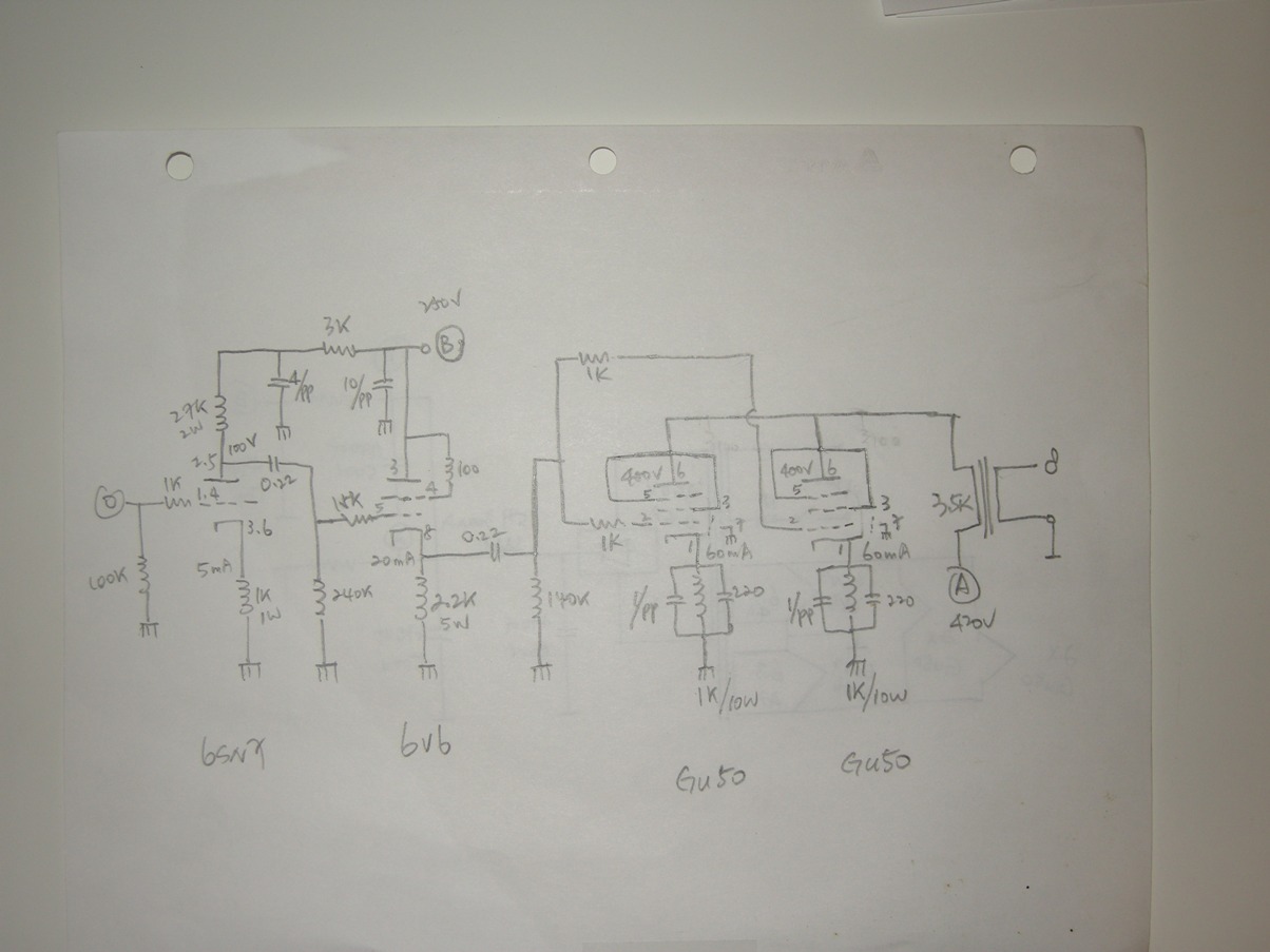

With 400V on anode don't be afraid to connect G2 directly to anode. It is not voltage that damages the screen grid, it is power. When voltage on the screen grid is fixed and voltage on anode goes down screen grid starts pulling more current and can be overheated and damaged. But when it is tied to anode it is safe to drive both anode and g2 up to 800 volts, in this case you have to watch for anode dissipation that must not go beyond 40 Watt. However, due to material used for anode it can dissipate 100+ watt shortly, but you can't run it in such regime for a long time.
Wavebourn,
Thanks for your advice. I've made correction on the schematic. Please take a look and comment.
Do I have to care ground the pin 7 ??
Will the drivers work fine ?? anything make change to improve ??

It looks fine. Pin 7 is screen between electrodes, it is better to ground it. Also, you may keep that resistors in screen grids as stoppers to avoid possible HF oscillations.
Wavebourn,
So I join pin 1 & 7 together and through the resistor to ground. Am I correct ???
Albert
I'm not sure that the CF will pull 20mA in this configuration. At 20mA the voltage over the cathode resistor would be 44v (20mA x 2k2) and the 6V6 will cut off..
Right.

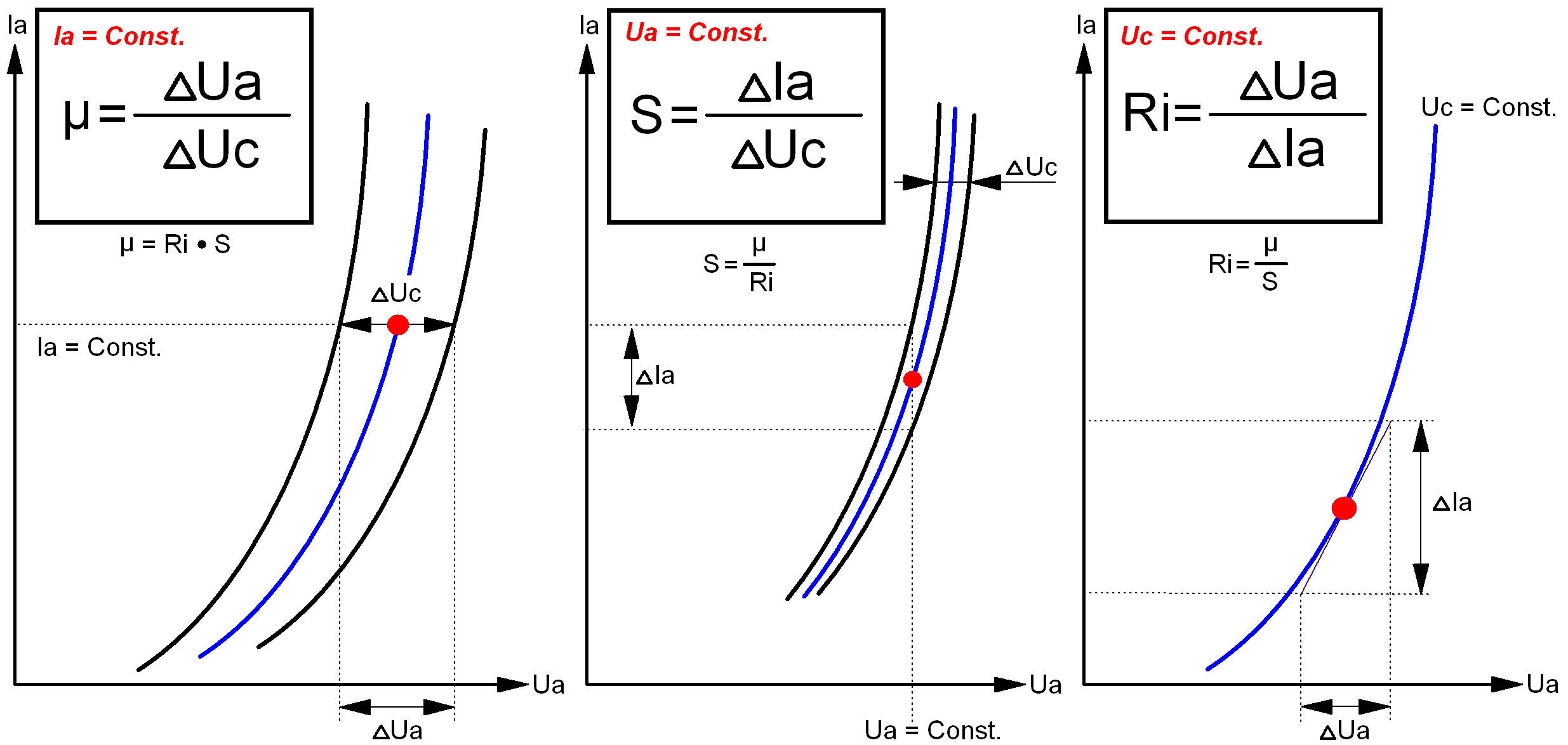

By the way, here is a nice picture related to your question:
Everything I find on the web equates the Beam Tetrode to the Kinkless Tetrode. I'll have to wait till I get home and can get to my books.
They managed to remove kinks by proper spacing of electrodes instead of the 3'rd grid.
About right handed triode, you are right. Higher Rp, lower Gm, but higher Mu. Lover voltage swing is needed to drive, but higher current, and output resistance is higher.
Using a 6V6 as CF before the GU50 is wasted when not directcoupling it like Artosalo did. Also a 6SN7 will not have gain enough as single driver.
If going for a pentode input it should be with something more linear and high-Gm than the 6AU6.
Lars,
Thanks for the suggestions. If I could replace the front end with a Mullard CV5311. I thought that will be better - gain wise. I have some 6au6 too, why a 6au6 can do a better job here ??
