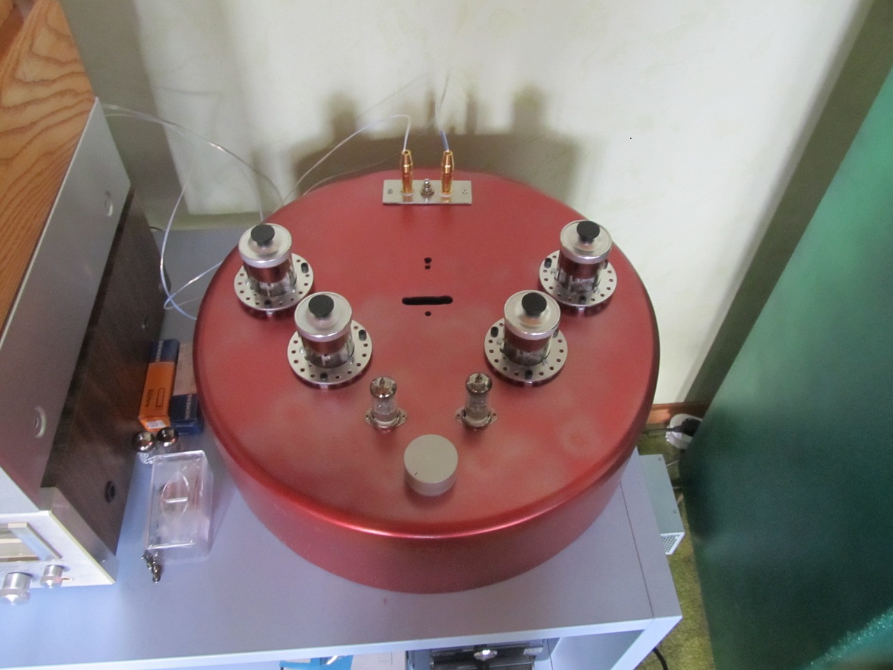

GU50 sounds much better in pentode then in triode. I have build several prototyps one of them is:
http://www.diyaudio.com/forums/tubes-valves/204148-my-little-se-gu50-2.html
First I run in tride - than I change to pentode - I put around 250-255V to grid2 and connect grid3 to Catode. Now it sounds much better. The mids and highs are noticeably better. I bias the GU50 0n around 50ma.
The last project I build is PSE version: ECC81 in SRPP (with B+ around 400V) and Rk 380Ohm - Interstage cap (jantzen Audio Superior) and negative bias for GU50. I set Bias to around 45mA for each tube. The OPT is custom build from my friend - 3500 primary and 8 seconday. I get around 20W of clean power and frequency response from 10Hz to 45KHz. Without any feedback.
Some pictures of my last prototype: (I move power trany from top to external case because of hum it produced)

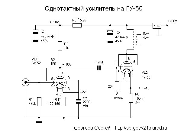

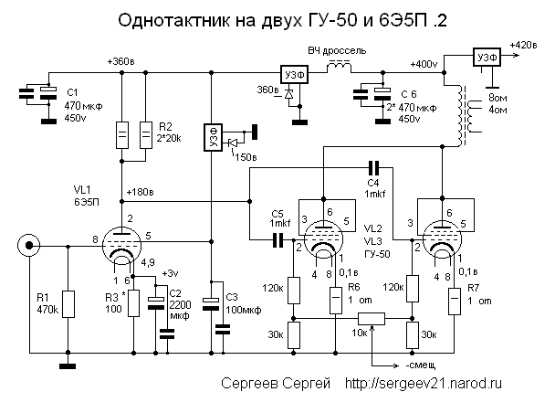

Hello
Thank you very much!

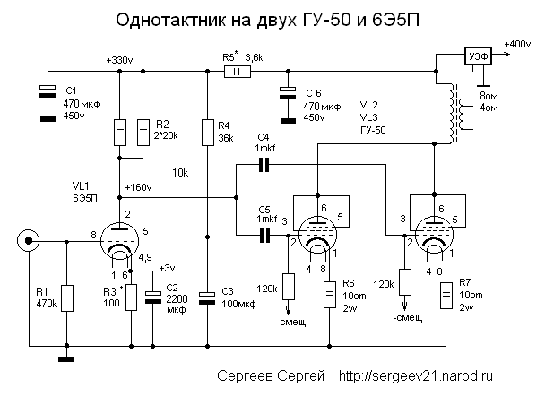

What do you think about these schematic. I like these a lot.
I can give you the website if you interested.
Ãëàâíàÿ ñòðàíèöà.
He get 7W high quality sound with one tube and 14W with two GU50!
Al do I would like to see the parallel GU50 schematic you built for your friend..
Greetings Gabor

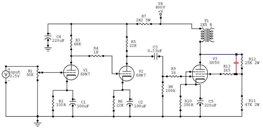

Interesting build!
Very odd time-constant on the GU50 bias circuit though - a 0.1uF capacitor feeding into a 25k (ish) bias circuit, I wonder if they get much bass below 400Hz?
Also the PCB gaps for 400+ volts isolation look a bit optimistic to me.
Looks like the SRS 552N is the beautiful sister version of the GU50, still cheap but quite rare. Didn't know that existed at all..
Here is my construction. It gives 15 W with low distortion.
This circuit works well with 811A and 807 as well. All connected as hi-mu triode (g2+g1 together) and in class A2.
Very neat design. Smart idea to ditch the two triode stage to use a pentode - eliminating a coupling capacitor.
You mean the direct connection between 6N6P cathode and GU50 grid ?
GU50 needs 6 to 8 V positive bias voltage and draws grid current too. Some 8 to 10 mA at idle.
6N6P will supply this, so DC-connection is a must.
If I built this today today, I would replace 6N6P with some NFET, IRF-820 or similar.

No I meant that in my integrated amps I need two gain stages in front of the GU50, but you have used a pentode instead ;).
The CF/SF is a good idea for A2, and very easy for the previous stage to drive but a mosfet is tempting yes. The GU50 takes a lot of grid current - I guess that's because G1 and G2 are both driven?

The first schematic was my inspiration. I want to build my own design. I test for driver D3A tube (in triode mode) with B+ 400V, Anode resistor of 23,7K and Catode resistor of 100R (I am not sure - I never write what I use). It sound excellent. Than I test 6C3P with the same Anode resistor of 23,7K and Catode resistor of 270R. It also sound excelent and finaly I test ECC801S in SRPP mode and I leave my telefunken ECC801S in the amps and now I am developing PushPull.
I took that first schematic and I change:
- the driver section (I use different tubes)
- the interstage caps I use JA Superior 0,22uF (one of my favorite)
- on the GU50 I connect the 3 grid to catode and I put to second about 250V
- my OPT have 3500 Ohm primary (very good build) and 8 Ohm secondary
- my PS is build from 100uF (first cap) - chocke (1,5H) - 1200uF (second cap)
- the only thing I should change is power trany - because of hum or I should build external power supply

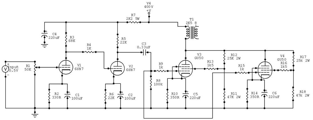

Can I use these transformer for ............
Hello
Can I use these transformer for parallel (each channel 2 tube) GU50 plate supply?
325V 250mA POWER TRANSFORMER for TUBE AMP AMPLIFIER HAM RADIO KT88 EL34 6L6 | eBay
Please let me know.
Thank you very much.
I know I need another transformer for the bias but what can I do.
I ask because these local sale and the shipping does not cost $$$...
Even if I can use it for 1 tube each chanel I would be interested on it. If (the online translation from Russian to English was correct)I understood the power tube biased close to 100mA..

Hello
I got that transformer from EPay, all do will give higher anode voltage than 420V I will see what can start with.
If I can get from 1 power tube 7W clear power that would be enough.
I have the sockets and tubes for parallel set up to but with these transformer I can"t go 90mA/tube.
Also I read octal tube as a driver like 6SN7 would be better choice. Actually I have both driver tube at hand any advise, experience welcome!
Here I found a schematic with that driver tube but I have to study what I can do with my power transformer.. I have a 6H 200mA choke I want to use that for these project.
Also I have a 12VAC 5A transformer and 12VDC 2A PS for heater.
I don't think I need to bias the power tubes to the max to get the best performance.:)
If you can help me which way to go from here with advice etc so I can purchase the right OP transformers.

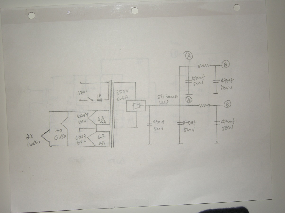

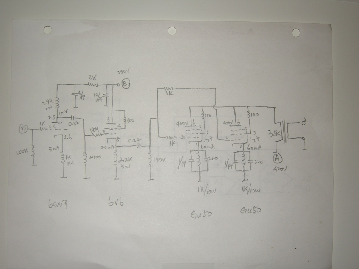

PSE
Being a copy cat for too long and now I want to try out something with I have learnt. Since I have all the parts in the schematic below and try to build something from scratch. All numbers in the schematic are what I'm aiming at. Please do give valuable comment and see if the design would work or not
Albert
I only hand draw the schematic and hope you'll see it.
With 400V on anode don't be afraid to connect G2 directly to anode. It is not voltage that damages the screen grid, it is power. When voltage on the screen grid is fixed and voltage on anode goes down screen grid starts pulling more current and can be overheated and damaged. But when it is tied to anode it is safe to drive both anode and g2 up to 800 volts, in this case you have to watch for anode dissipation that must not go beyond 40 Watt. However, due to material used for anode it can dissipate 100+ watt shortly, but you can't run it in such regime for a long time.
