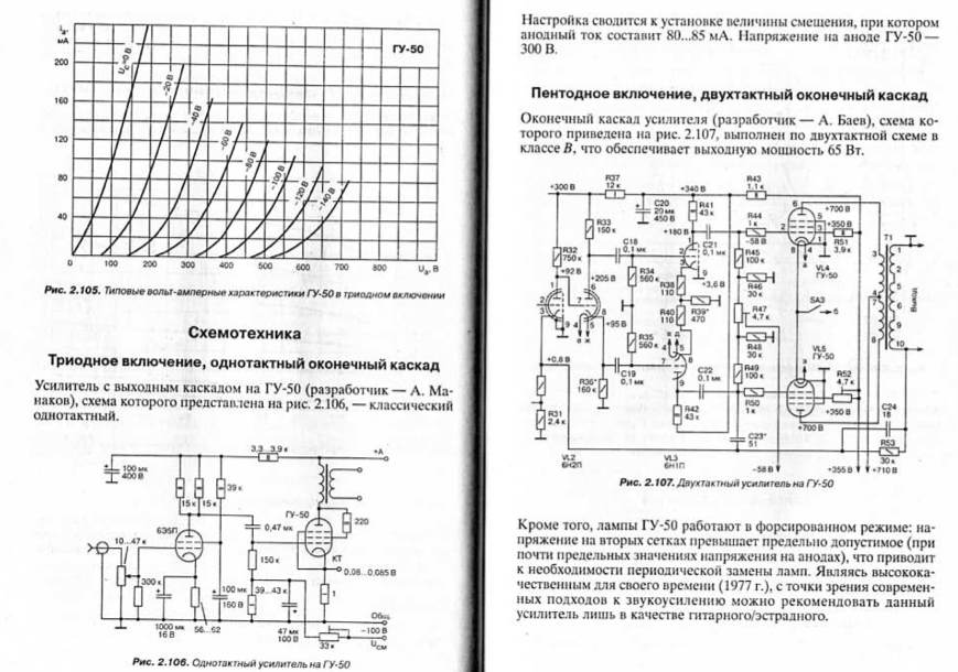

Translating GU50 specs
One of the hardest things I find with using the GU50 and working out circuits is my lack of ability to read russian .
I've attached a couple of pages of GU50 specs - could some kind soul please translate the words under the curves traces, and tell me how the tubes are connected up in each instance?
This would make planning bias circuits etc vastly easier and would help I think a lot of people take advantage of these awesome tubes!
Thanks in advance!
Thanks in advance!

Thanks for the info and the links.
My russian is rusty however, and google translates the first graph text into:
Removed the CVC PG-50 for different stresses safety net. It turns out interesting picture.
When 0V:
From the russian I can see it's the RY50/GU50, but is the CVC/BAX the G3 pin?
So that would make the graphs for cathode at 0V, G2 at 250V and G3 = 0V at the top (conventional), then the 2nd pic is G3 = 0V, then G3 = 10V etc.
I'm assuming that Ie (backwards e) is the G2 screen current (Ig2)? And Ee or Ug3 are the voltage at grid 3 (Vg3)?
I read a page recently where they connected a pentode's G3 to the cathode only via a film capacitor and said it sounded much smoother and softer - have you come across that trick? (DECWARE - The Hazen Mod)
Interesting to see if it works.. I guess that G3 will float to a voltage it feels happy at and for all AC signals will stay at they voltage...

No ВАХ means Volt-Ampere-Characteristic.
Yes, graphs show pentode mode for different G3 values. The last graph is for triode mode when 2 top grids are connected together to the anode. But he did not have possibility to test on positive grid voltages for complete picture, unfortunately. A1 mode for this tube is waste of power, in triode it should work in A2.
Also, if to connect all 3 grids together you may get a nice right-handed triode (similar to high voltage BJT transistor).
Yes, it would be nice also to experiment with positive voltage on G3, while G2 is connected to anode. A2 may not be needed at all.

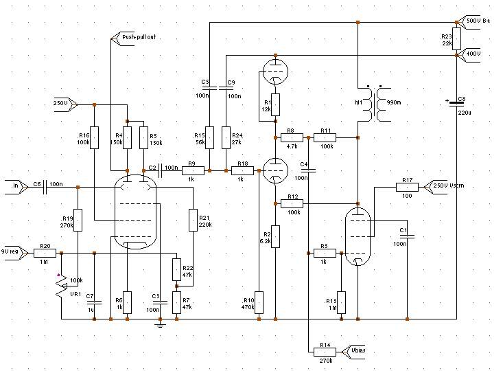

This is the latest sketch of my amp design, it's all rather subject to change and tuning but seems to be the most interesting I can come up with currently:
The front is an 6AR8 tube, which then splits into both sides of the PP amp, of which one side is shown here.
There is a neat feedback point at the 6AR8 beam deflector 2 (BD2) but as the 6AR8 is common for both push and pull that could only be utilised from a transformer winding, which I do not want to have inside the feedback loop as I consider them too slow and phasey.
So here the idea is that a combination of DC Schade feedback and DC feedback to the SRPP(ish) stage create a stage where all feedback avoids capacitors. the SRPP(ish) stage may use 6n6p or 6n2p tubes, the 6n6p allow more grid voltage (less gain though) and therefore more effective cathode feedback as the cathode resistor is bigger.
The transformer shown is half of the OPT primary - i.e. the 'push' of a push-pull. Also shown are a couple of B+ correction feedback paths. The issue with these common cathode output stages is that when the GU50 draws current the rail will sag, which may result in non-linear compression. Therefore the power rails are fed into the amp at just the right levels to correct the output.
The 500V B+ corrector feedback works like this: falling B+ reduces grid voltage of the driver, which allows the driver anode to rise switching on the GU50 a bit more, causing the correct voltage over the primary to be maintained.
The 400V driver stage corrector feedback works by allowing a dip in that rail to cause the driver grid to fall, making the anode rise to compensate. These can simply be tuned for hum nulling for optimal value.
The 6AR8 also has a deflector tuning pot - like vertical position on a CRT - to null out any static magnetic fields - it is adjusted until A1 - A2 measures 0V on a multimeter.
Any thoughts? (I know about the G1 gu50 bias error on the diagram!)

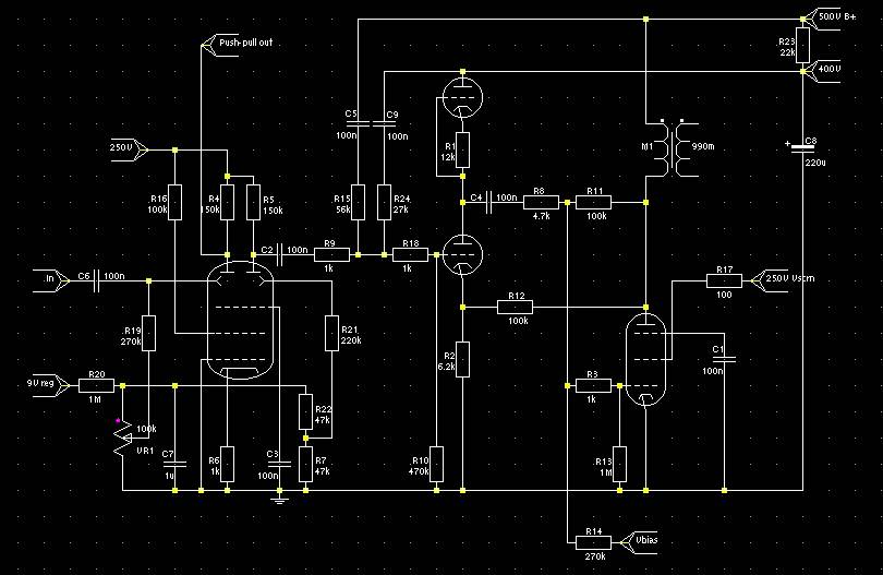

I couldn't understand the schematic before I invert the black and white, I don't know why. White background and black symbols are OK for me
Sorry it's my ancient drafting software from the days of X windows.
I constantly want it to be black on white too
Maybe I should fix that...

Here it is - a proper viewable version
I've been meaning to invert the colours for ages!
