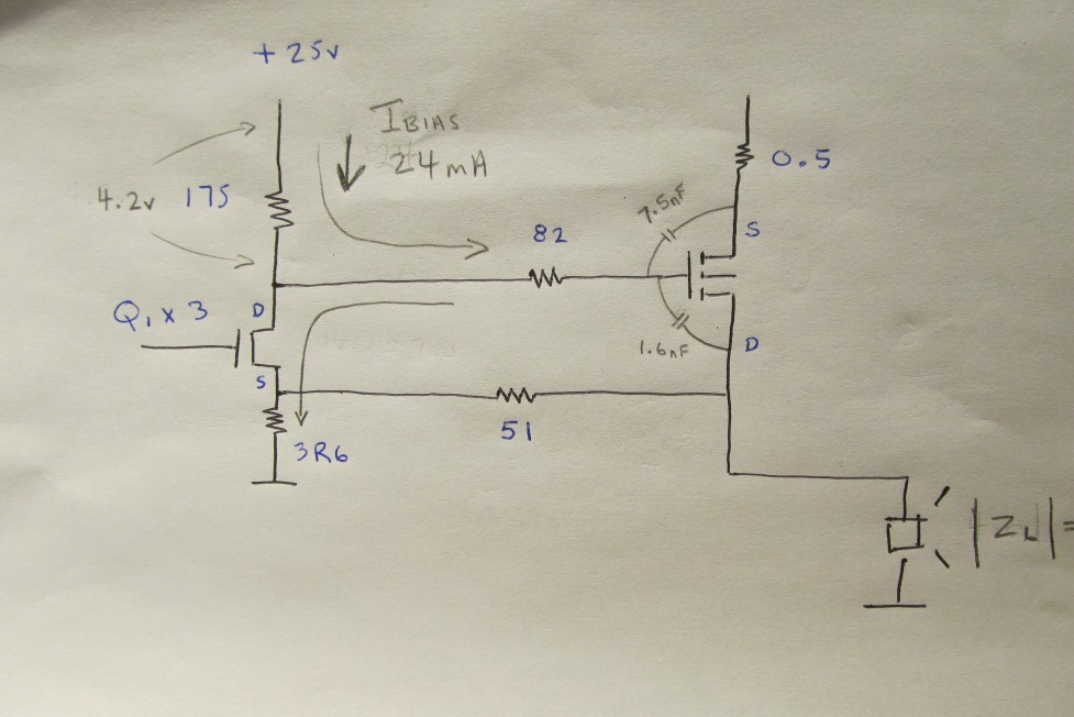

Here is the simplification of the prototype - there is plenty of poop to drive the "Bricks."
Today I read up on Miller capacitance, Gate Charge curves and all sorts of stuff
but IMO its the 0.5 source resistor that is holding this amp back.

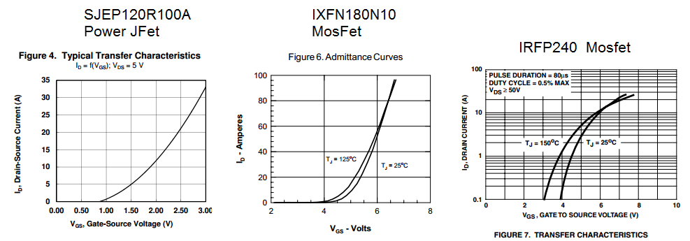

transfer function
I may be mistaken, perhaps the fact that two of these graphs are linear and the last is logarithmic is tricking my eye, but all of these IXYS HiPerFETs seem to have a transfer function which is more like that of a JFET. This may have something to do with the alleged amazing soundingness (not a real word) of this Mosfet. This seems the same for smaller Mosfets, like the ones in TO-247 packages, in the HiPerFET family. I guess you could drop it into an Amp Camp amp without any other modifications to see if it has promise in that circuit as well. It has 1k ohm from gate to source with a single 2SK170 in follower mode. I have always wondered about the 2SJ109 in the J2 if some trick is needed to make the JFETs share the load. There don’t seem to be any source resistors perhaps the fact that there are two matched 2SJ74 is sufficient to make them share the load relatively equally.
Disclaimer – I am not looking to build an F5, I may build an amp camp when the PCB comes out.
The last logarithm will trick the eye, but the IRFP240 will start pooping out
at 20A and the other parts continue their square law trick to higher currents.
Please bare with me - its been more years than I care to admit, since seriously looking at analog.
I've been trying to find an equation that describes |Zout| of the F5.
for a MOSFET
r out = 1/ (lamda * Id) = 1/gds = d Ids / d Vds
that's great - but without a family of curves how do you get d Ids / d Vds ?
For the F5
Zout = Rs + 1/gds but there are 2 output stages and also F.B.
so I think |Zout| = (Rs + 1/gds) / (2 * F.B.)
Is this right ?

without curves and specific data , it's inevitable that you must do some measuring
so - either measuring xconductance of mosfets (Papa's papers 0n FW site - Mosfet Testing ) or measuring output impedance directly
for last one , to save my fingertips , just click on this :
info and calc : Output Impedance
online Java calc : Measuring input impedance and calculating output impedance calculation calculate amplifier amp total loudspeaker speaker microphone resistance resistor bridging matching test load loudspeaker source resistance - Why input impedance is in parallel and
