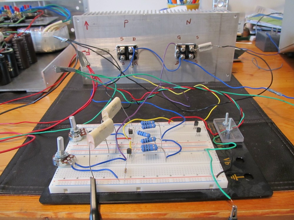

Gentlemen,
Thanks for pointing out a Shorted Turn.
Is this the problem ?
Shorted Turn - is a closed loop around a magnetic field, which can get a massive current induced into it 😱
Can a magnetic field induce a current in aluminum and stainless steel ?
However, could the magnetic field induce a current in the ferrous washers - which would then be conducted by the aluminum loop ?
To be on the safe side - I should break the loop.

first tell us just one thing :
check with ohmmeter do you have electrical contact between base plate of PSU and that upper Al plate ?
I know that I'm boring , but - as long is there possibility that you have starved PSU , there is no point in any sonic evaluation
Yes. the resistance between the case and the plate was 0.
As a short term solution - I removed one of the bolts.
Long term solution - probably make a single plate for each donut.

Here is my test set up
H/K 7600 CD player ==> Musical Fidelity v3 tube buffer ==> F5 Amp ===> scope & 10" Tannoy
changing one variable at a time
1) paralleling up the input jFET's increased the bass, dynamics and the music moved more forward.
Unquestionably, this mod is a keeper with the Gamut style MOSFET's.
2) The source resistors are presently 0R51 - I don't have 0R22's.
But from previous tinkering, I know there will be more bass if this value is lowered.
3) The 4 F.B. resistors were always 50 = R5 // R6 and 50 = R7 // R8
4) I moved the bias up to 1.3 Amps - I think it sounded more alive ???
Notes
When the bias was increased to 1.3 Amps - the ripple on the supply rails increased to 90 mVpp - not good
The amp is very thermally stable - when I switch it on, the voltage drop across the 0R51 source resistor is about 0.64 v
1/2 an hour later its 0.70 v
Switching on and off the F5 is very well behaved - no thump - no output hitting the voltage rails.
No output relay required.
92,000uF per channel should throw a 10" Tannoy around like there is no tomorrow.
But there is no bass.

when I wrote halve source resistors I meant on input Jfet's resistors
that way you'll keep right current through all input jfets , and better drive of outputs
also - to keep CLG in ballpark , that's why I wrote to halve feedback resistors too
