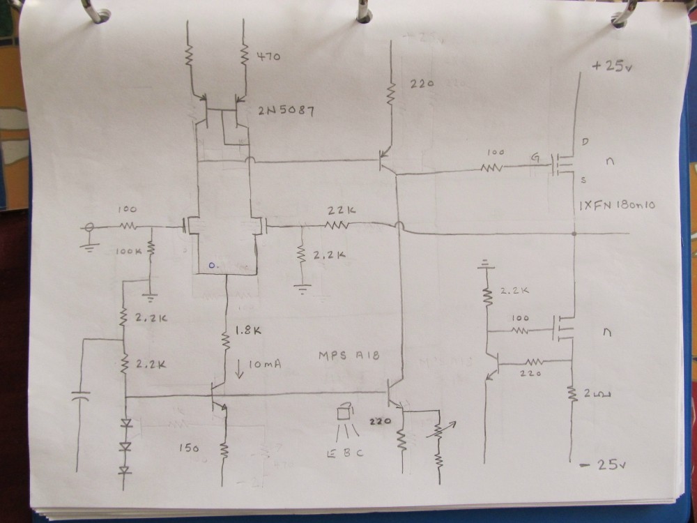

I am tweaking an F5 Amp and using IXFN 180 n10 and IXTN 170 p10p power MOSFET's.
http://ixdev.ixys.com/DataSheet/98546.pdf
The channel resistance of these is less than 0.012 ohms - that's not a typo.
Have lowered the current detecting resistors R11 and R12 to 0.1 ohm
and changed resistors controlling the current limiting bi polar transistor appropriately.
Have prototyped these MOSFET's in Aleph style amps and the F5 biased at 0.4 amps.
The sound is jaw dropping.

I prototyped an IXTN180n10n in a Aleph style amp with a single 2N5087 or a j177 jFET driving them.
The sonics were jaw dropping.
This version of the Aleph may have sounded so great because a current source was used in the output stage,
which improves the linearity of the MOSFET.
However, if I recall correctly, a 30 watt Aleph is biased at 3 amps, so it dissipates 300 Watts just sitting there.
This is beyond reason - so I did not build an Aleph.

A number of years ago, I read this artical by N.P. where he basically
takes the ideas from an Op Amp and builds it using discrete transistors to make a preamp.
DIY Op Amps
It soon became clear that this pre amp could be changed into a power amp if large MOSFET's were used.
But I didn't like the idea of trying to match numerous IRF240 MOSFET's.
Then I had heard about how great the Gamut D200 mk3 power amp sounds and they used 2 power MOSFET's per channel.
So I prototyped this amp biased at 0.4 amps and it sounded amazing.
The current sources for the first 2 stages could be improved.
Without the current mirror the amp sounds warmer.
Output protection needs to be added.
However, a 30 watt class A amp is biased at around 3 amps.
It soon became clear the power dissipation was unreasonable.
The amp would dissipate 300 watts just in idle ... this would be a space heater.
BEFORE the Turbo F5 was released, I though I would increase the output of the original F5
by adding the IXFN180n10 power MOSFET's.
- Help with F5 with Gamut style MOSFET's
