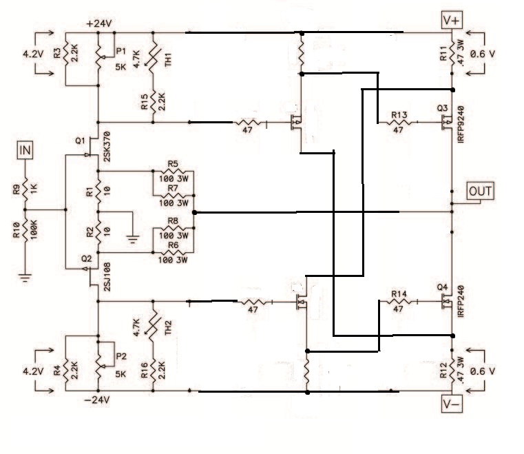

When the bias was increased to 1.3 Amps - the ripple on the supply rails increased to 90 mVpp - not good....
It's exactly as it should be. The important thing is: do you hear the noise/hum through the speakers ? You shouldn't. And if you do - fix you wiring.
If you want to significantly improve the ripple figure, go active - I had great results with capacitance multiplier:

Back, briefly, to the shorted toroid discussion: Because there are two out (actually I mean IN phase) of phase toroid (from current in loop perspective) in this layout there will be no current if both transformers have exactly the same primary turns. It's still not a great layout idea, the original one here, that is. Turn one of the cores over and you'd likely see smoke in a minute. There'd be no way to miss it.
when I wrote halve source resistors I meant on input Jfet's resistors
that way you'll keep right current through all input jfets , and better drive of outputs
also - to keep CLG in ballpark , that's why I wrote to halve feedback resistors too

I 1/2 'ed the value of the source resistors for Q1 and Q2.
So R1 = 10 // 10 and R2 = 10 // 10
This made a significant improvement to the dynamics and bass.
The F.B. resistors were keep at the original values of 100 // 100 and 100 // 100
The trimmers became overly sensitive, so I'll need to re-adjust the value of the drain resistors for Q1 and Q2.
The mid range sounds very dynamic - but there is still not enough bass.

BTW: A typo that may be on F5 Turbo V3.
Should R26 read 10K ?
for these Gargantua's - how about introducing follower stage ?
Zen and Juma,
You are right, the Ciss = 12.6nF of the monster MOSFET's needs more drive current.
So I've just tripled up Q1 and Q2 - Huge improvement !!!
With the tripling up of Q1 and Q2, there was a significant reduction in harshness.
Now Mozart Piano Concerto No.20* is starting to sound good.
Rather than a follower stage driving these monster MOSFET's,
I'm wondering if a darlington or complementary pair will work with Q1 and Q2.
Where a jFET, with a lower gm, is used to drive a Bi Polar transistor.
A second option, is there a MOSFET's with a transconductance around 20 mS ?
Does that exist ?
Still equates to ~9 pairs of 240/9240.
Your right, for a IRFP240 Ciss ~ 1200 puFF
However, Juma said he had great results with 2sk2013's which have Ciss ~ 170 puFF.
No doubt - the sonics of the monster MOSFET's has improved with more drive current.
So for Q1 and Q2 - I'm wondering if a jFET ==> BJT darlington or complementary pair work.
Or is this old fashioned ?
that will need some major redo
it was made , off course , but that will be different amp
in case that you have virtues of Jfet input (and believe me , there are some virtues ) , best way is to introduce follower stage ( mosfet or bjt , but mosfet as first choice ) with , say , 10 times current of input stage
easy peasy ...... or little more complicated - whatever you choose

Zen,
To point out - in an Aleph style amp, a single j177 or 2N5087 had plenty of juice to drive a IXFN 180n10 monster.
The selection between the jFET and PNP was simply a matter of sonic taste.

whatever you choose - poison is yours
even if I can't agree that one tiny Jfet (or bjt , with same Iq ) is able to properly drive that brick on output
while yuo at it , you can try something in line with this - I didn't calculate source resistors for buffer stage , but I had on mind (as I already wrote ) 10 times greater current than in input stage
