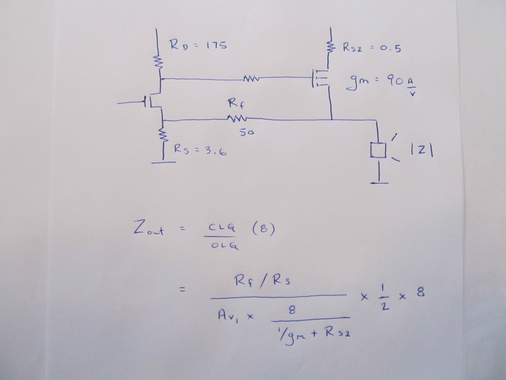

Looking at Mr. Pass's equations, for MOSFET with a high Z output stage (common source ?)
To lower Zout, the real options are:
- decrease the output source resistor
- increase F.B.
- or find a MOSFET with a low gm
Minimizing Zout is a real balancing act.
The "bricks" have a gm = 90 A/v,
So I'm thinking of going back to an Aleph style amp - but biasing it at only around 1 amp - but minimizing Zout.
I dropped the Aleph style amp only because of the power dissipation and heat.
Having a current source at each stage, has some great advantages.

without curves and specific data , it's inevitable that you must do some measuring
so - either measuring xconductance of mosfets (Papa's papers 0n FW site - Mosfet Testing ) or measuring output impedance directly

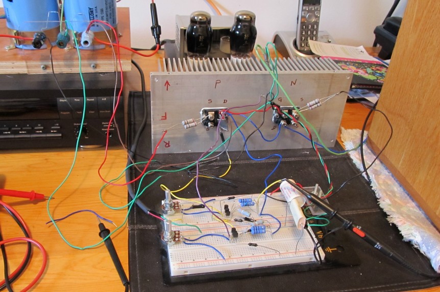

Yes, I was thinking of connecting some output resistors to the F5, measuring the change in Vout and then plot a load line.
But the Zout equations really help to understand the amp.
You could also parallel more output transistors. However, lowering the current through each output transistor to keep the efficiency up also lowers the transconductance for each one, raising the total output impedance. No free lunch. I've been playing around with this idea myself recently. I suspect I'm not telling you anything you don't already know.

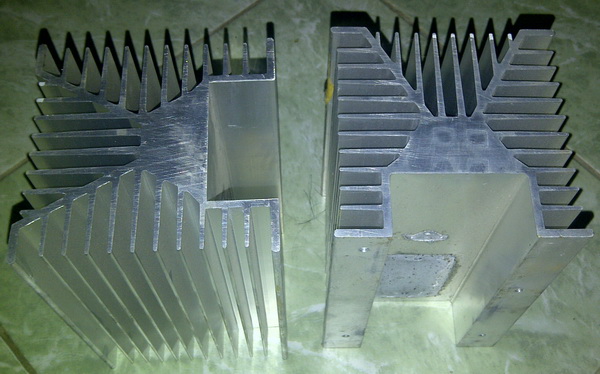

Recall you have access to n channel devices only - so one option is building a Class A Aleph style amp.
But for a Class A amp, having large heat sinks is critical.
Minimum they will need to be 4 (h) x 8 (l) x 2 " (t) 100 x 200 x 50 mm
Can you get a hold of heats sinks like this ?

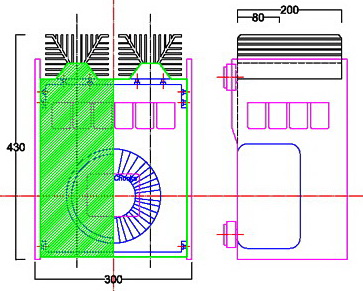

Yes, I have 4 nos, 1860cm2 each heat sink block; I intend to build Class A monoblock unit like this 😀Pointed,

The Heat Sinks look Great - I have a correction to make - between your 2 MOSFET options.
IXYS IXTN 15N100 and Hitachi PM 50502C
Vgs(th) ...... 2 to 4 v .............. 2 to 4 v
I cont@25 .. 15A .................. 50 A
gm (typ) ... 28 A/v .............. 40 A/v
Qg (max) ... 280 nC .............. not listed
Ciss ........... 8nF ................ 10.3 nF
I would suggest the 15N100, since Qg will be lower.

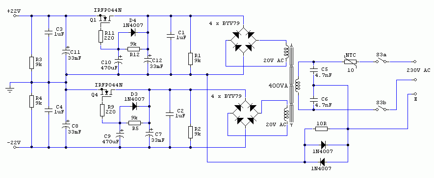

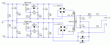

4) Solid State Power Amplifier Supply Part 1
Except the article has 3 serious omissions
- the author should have included discussions on simple soft start ideas to control inrush current.
- a discussion between case earth and circuit ground is missing.
- the idea of star grounding is missing.

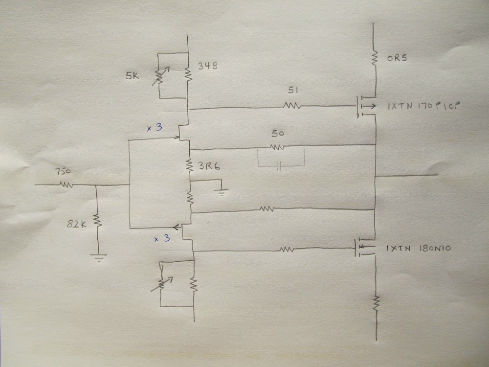

Here is the schematic of my modded F5.
Its very thermally stable and reaches full bias in about 15 minutes.
However, the high value for Zout is holding this amp back.
Mr. Pass's equations, to calculate Zout, indicate the options to lower Zout are
- decrease gm of the output MOSFET's
- increase F.B. - which will make the amp more thermally unstable
- decrease the 0R5 source resistors - which will make the amp more thermally unstable
As GL has alluded to, it seems the typical method to lower Zout is to parallel a bunch of MOSFET's in the output stage.
But that means matching MOSFET's - I'm not thrilled about this idea.
I need a Free Lunch here to lower Zout - any suggestions ?
Thermal run away occurs because Vgs(th) lowers with an increase in Temperature.
Vgs(th) lowers about 1.5mV per oC.
Other than a thermistor, is there a way to thermally stabilize Vgs ?
Choosing the right thermistor, or a network to correct it's suitability is important for that theory to be sucsessfull. 😀
