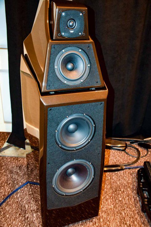

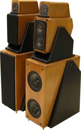

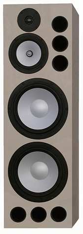

Help which 10" woofer I chose or buy SB29nrx75-6 or Alcone AC10HE ???

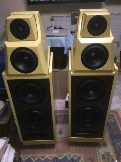

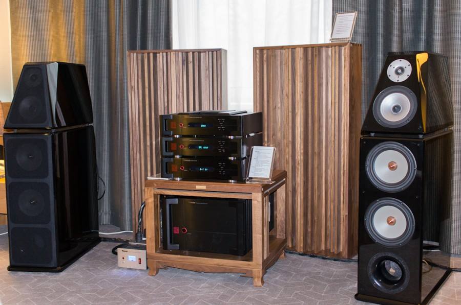

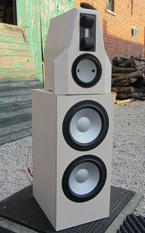

Separated enclosure VS one piece enclosure
Time to put together some plan.
I have two option (as you can see the pictures) the two woofer in separate enclosure the mid and tweeter on the top in a smaller enclosure
Advantage - easier to move it around (may be sound better because the mid and tweeter separated from the bass resonation)
Disadvantage - much more work extra two enclosure
Does it worth the extra work (will improve the sound that much the separation) :D
Please let me know your opinion :)
If I can get the 8x4 feet Baltic birch I can leave it 4 feet tall if the 4 speaker get one enclosure (less cut)
If worth to be separated the 4 feet only for the two woofer out of the sheet of Baltic will be too tall (plus the small enclosure on the top)
I want to order some Baltic birch outside from Toronto, if they deliver it better to be cut into size easier to carry or move it around.
Also if they cut it more cut more possibility for error when more cuts needed especially if I can not be there when they cut it........
I do not own a table saw only a Milwaukee battery powered small saw. :eek:
Thanks for the advise

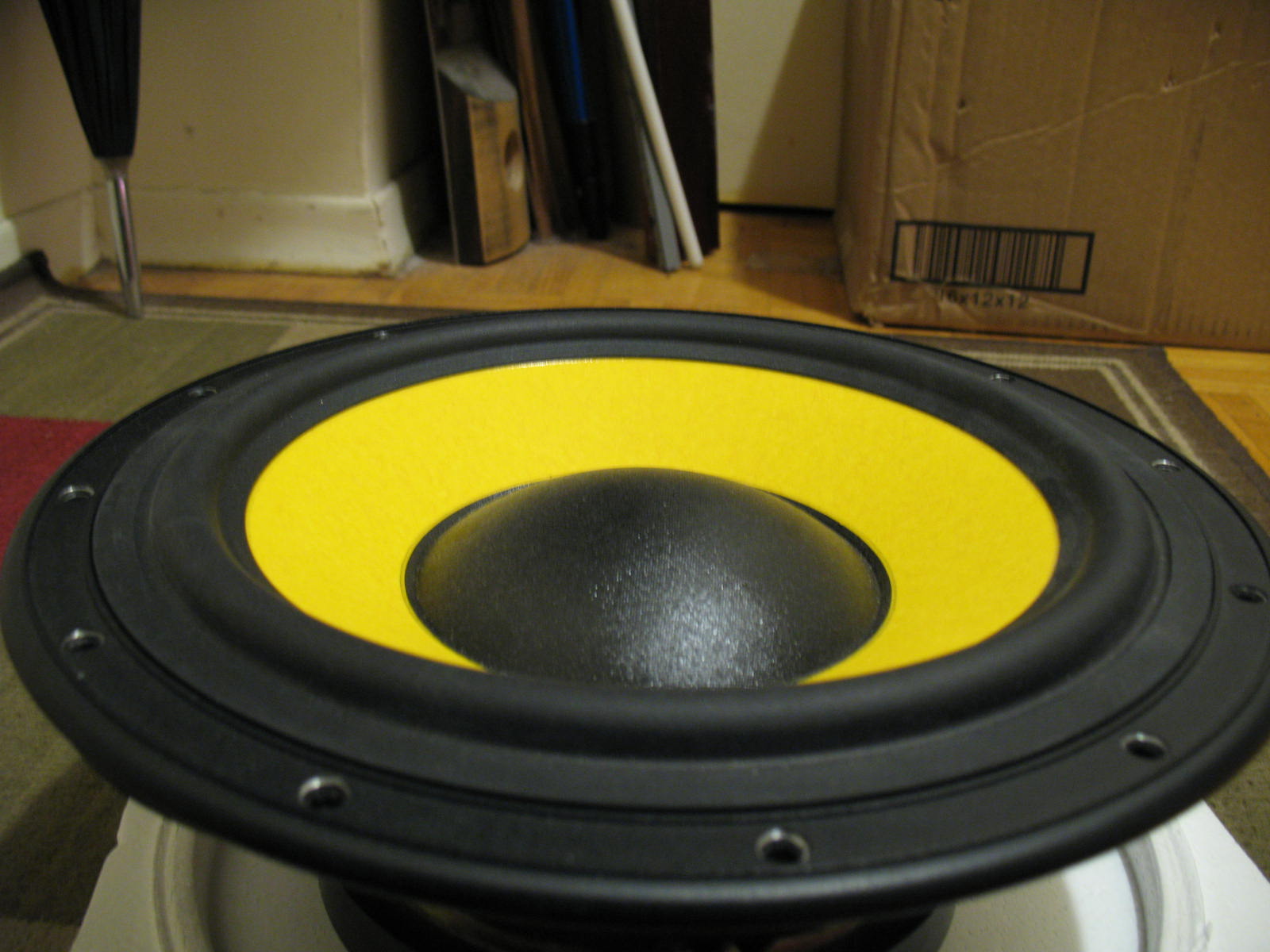

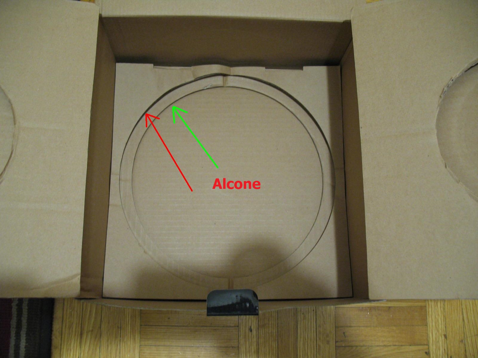

65L
Relative -3 dB Point 30.83 Hz
Relative -6 dB Point 27.09 Hz
Relative -10 dB Point 23.59 Hz
Port Diameter 7.5
Port Length 20
Number of Ports 1
Tuned Port Fb 28.2 Hz
That is the factory tune advise to these Alcone woofer. 65L tuned to 28Hz (F-3DB)
I have to tune it around 30Hz to match Hi -Vi F10 woofer as close as possible. Unfortunately the Hi-Vi woofer a bit weaker than the Alcone. Unfortunately I'm no longer able to use the (my favorite) simulator I used to use. That was so special when I increased the volume box eve 1 or 2 litre I could see the fine effect on the curve. I can not find a sim. which work similar like that. I must tune these 2 woofer together as close as possible.
So I will go with 2 woofer per side, still not sure how I power the two separate or from the same amp. First I build the enclosure.
After I will try to get the best option to drive them. If I drive each woofer separate I must use exact the same amplifier on both driver otherwise will act as a subwoofer, sometimes to much bass some times to little. You know what a mean. If I connect the two woofer together with one crossover I get 3.4 or 3.6R DC witch roughly 4 Ohms AC. I still I use my 8 Ohm Gorlich mids and 8Ohm tweeter. So on the end I end up with a 4R speakers (not all amplifier happy with that) What can I do one 10" woofer (what I own) does not produce satisfactory bass. The Alcone anodised alu cone with the Hi-Vi Kevlar paper composite it produce a pleasant sound character. Not clinical or harsh. I tested the 2 Alcone together or the two Hi-Vi and the best option to use 1+1 per side. Even if I would own one more pair Alcone I would go with the 1+1 woofers.
It would be great if I could tune both woofer 30Hz or so( Hi-Vi advise 33Hz and Alcone 28Hz) Alcone tuned to 30 or 31Hz still nice. Now I can play with the mentioned simulator to try to bring out the best compromise from both woofer,

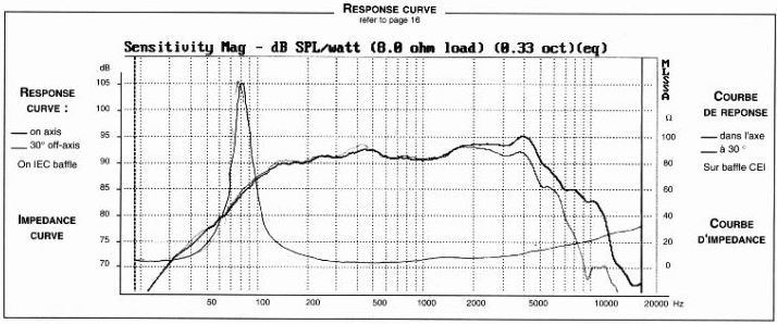

Gorlich Podzust question
It is been a while since I posted here. (Was sick, etc)
It is time for this project materialize, but before I build the enclosure I will have to clear some facts about the Gorlich Podzust driver I want to use for this build.

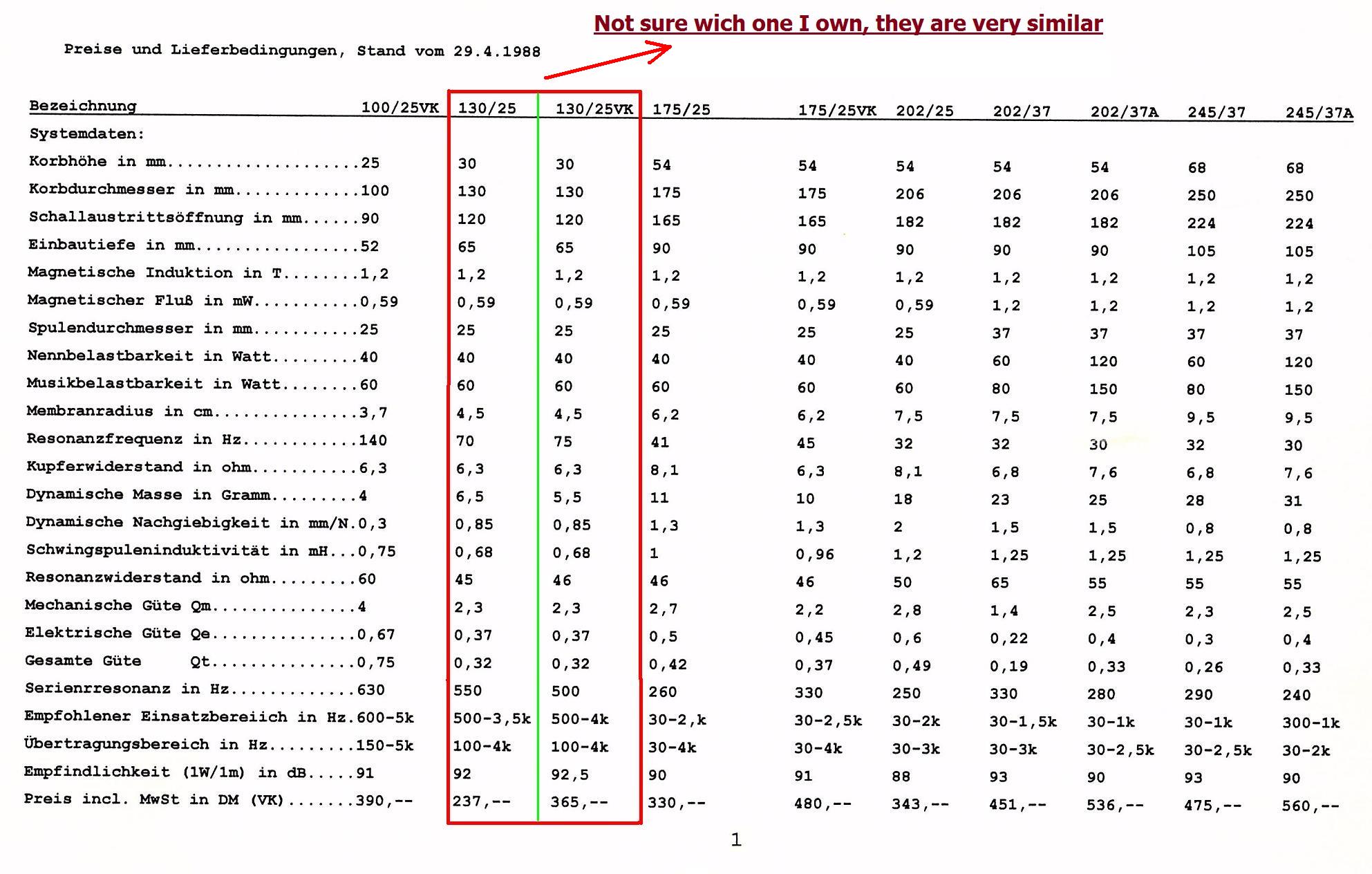

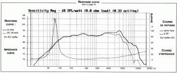

The first question

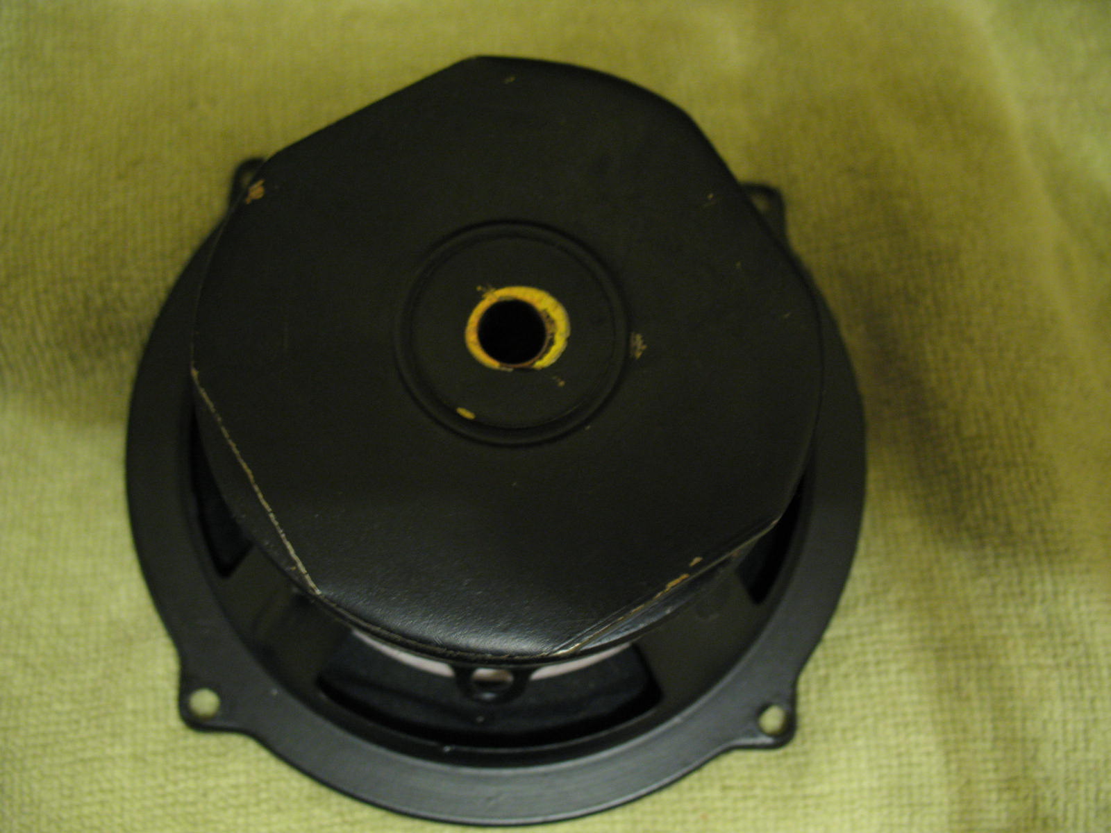

Does this driver provide enough midrange from 200 or 250Hz upward?
Still not sure crossing point I will pick.
Please see the attachment for the datasheet about the Gorlich drivers!

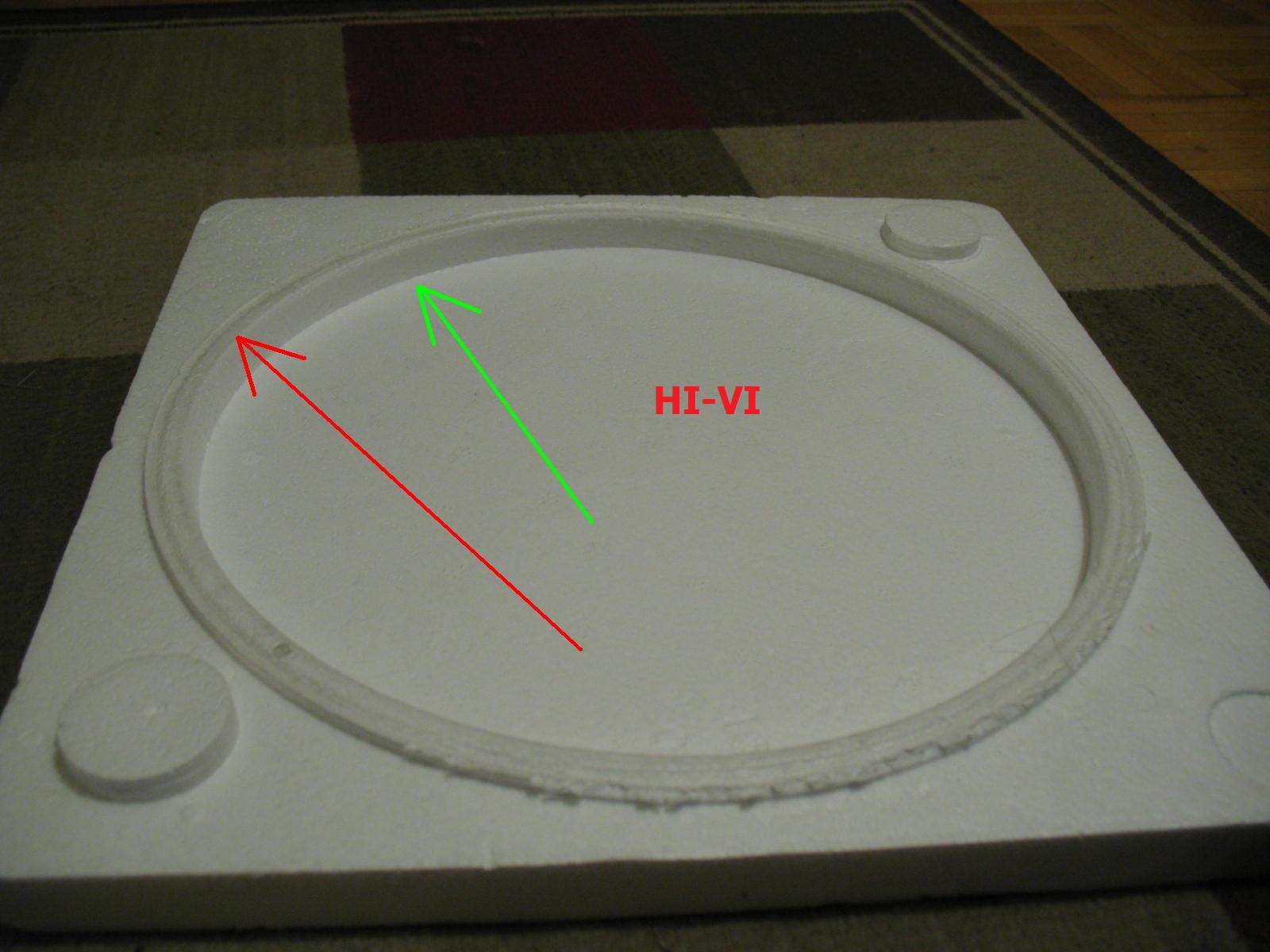

To be honest I really don't know which one is it out of the two (marked with red)
The second question
Even do the driver has 70 or 75 Hz I am not sure if I can cross it as low as (between) 200 & 300Hz?
There is some notice in the German language that I do not understand.
Why this is important?
Once I build the enclosure for a 5" driver very likely I can not use a larger 6.5" driver.
I see with the 2x10" Woofer people use a 6.5" mid-woofer, I don't know the actual driver size if it matters?
I want to mount the tweeter as close as possible to the midrange.
Also if the 200Hz crossing point to low for this driver I have to use something else.
I would love to use this because of the sound quality but I can not compromise or used it in a frequency where the driver distorts or suffer.
Can someone please take a look and advise me. Wery likely I will build an enclosure similar to this but keep the drivers in the center.
Please remember I will use one Alcone woofer and one HI-VI per enclosure (separated from each other) to avoid the (too much) metallic sound.

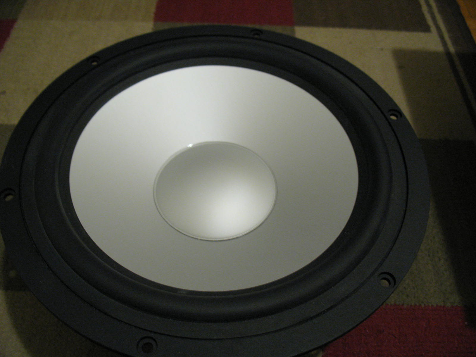

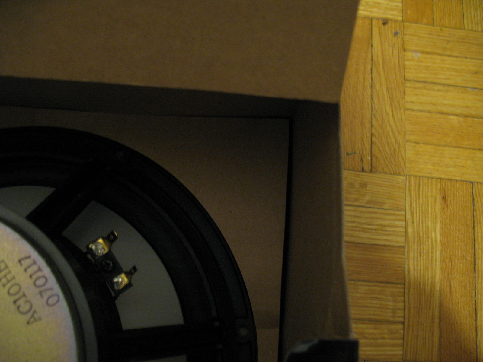

I tested (not in the enclosure, only on the carpet floor) the two Alcone and one Hi-VI and Alcone and I prefer the second option.
Yes I like aluminum cone drivers a lot (I use a Visaton AL130 driver for every day listening)
One of my favorite driver series the Visaton AL!!:)
Thank you for your reply and advice!:):)
The abbreviation 'VK' (= "Voll-Konus") refers to the fact that the diaphragm consists of a single conical piece of the membrane material - so there is no dustcap. This design makes it difficult to center the vibrating unit (diaphragm, voice coil, etc.) in the air gap of the magnetic circuit, and as a result such drivers are more expensive. But also they are said to perform better (not so sure whether this always turns out so clearly in measurments, though ...).
In any case these two types can be easily recognized by their different appearance (--> diaphragm).
The table doesn't give any info about voice coil length and height of the air gap. So one can only guess as to the SPL capabilities at the lower end of the operating range.
However, with great certainty both are usable (for HiFi usage) from at least 300 Hz upwards when built into an appropriate (closed) enclosure.
Thank you kceenav:)
Based on your explanation now I know which driver I own.
I will attach the picture of the driver.
So this can provide 92.5db that should be more than enough for the mentioned purpose.

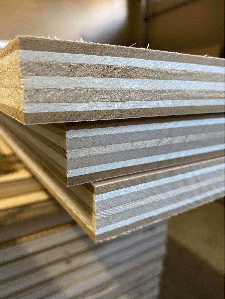

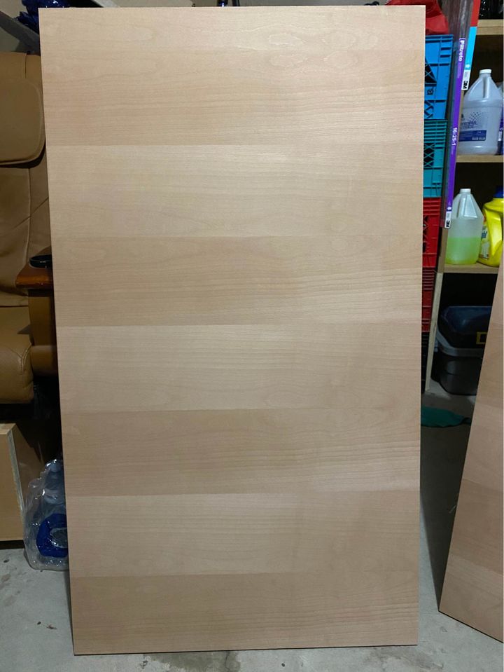

Just purchased some material for the enclosure.
5Pc 1" 48x27 size & 1Pc 3/4" 48x27 size (cost $100 with delivery)
That material should be enough for a pair of speakers (outside, will buy some material for braces, etc).
I will build a separate enclosure for the woofers and mids and tweeters.
Thank Inductor for the advice!:)
It is a Canadian red oak veneer on both sides A1 grade material 1-inch oak plywood for the woofers and 3/4 for the midbass drivers and tweeter.

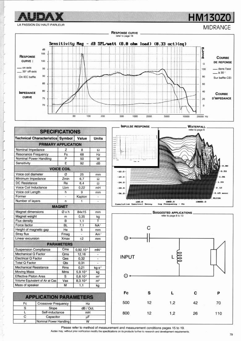

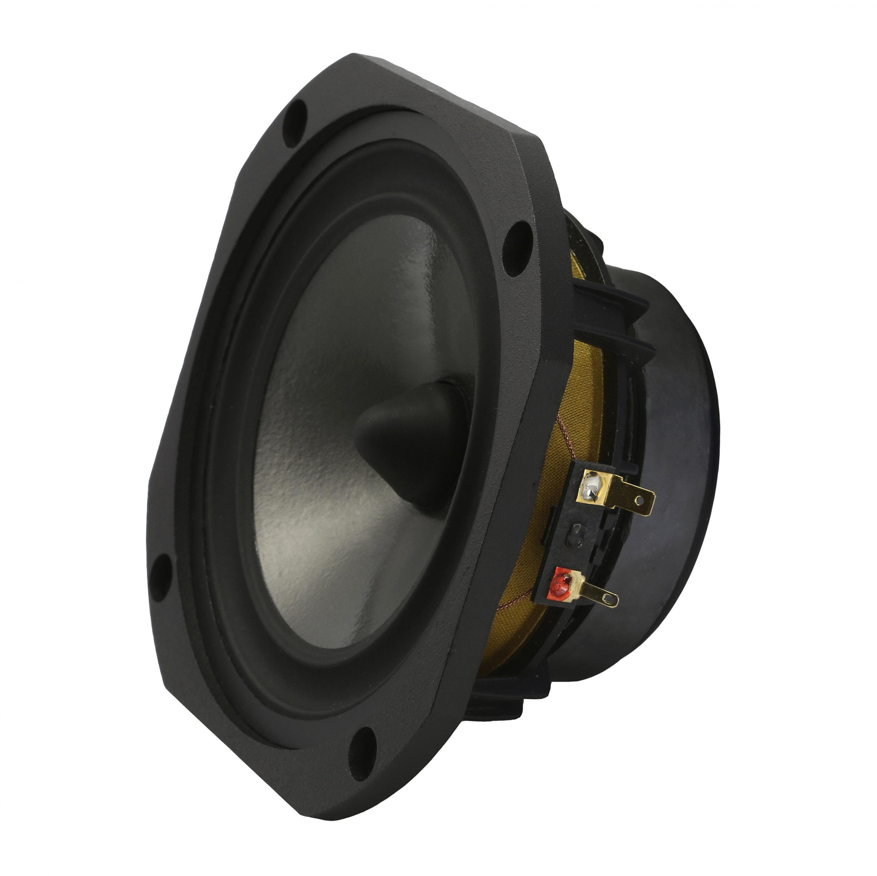

I plan to purchase (if I can get) a pair of Audax MH130Z0 Aerogel cone mid-range to match it with the mentioned Gorlich Podzust midrange.
Their sensitivity and other parameters are very close of course I will separate them in the same enclosure.
In a short sentence, I will use two pairs of midrange drivers to match the impedance of the two woofers.
Also, I learned better to use two smaller sized midranges with lighter cone than one 6.5" or 7"driver.

So right now for this project, I have to hunt for a pair of the mentioned Audax midranges. :)

Yes, something like that.
The woofers should be in separate (divided) enclosures. Something similar like in the pictures. For an idea!!
The Alcone in 65L tuned to 28Hz
The HI-VI in 60L tuned to 30Hz
Both stunned with BR ports.
For the midrange, I would go with the Gorlich only IF that would provide enough midrange or couple it with the Aerogale, or go for a single pair Scan-Speak.
I read your comment somewhere (an old post) about the Aerogale and I got second thoughts about it.

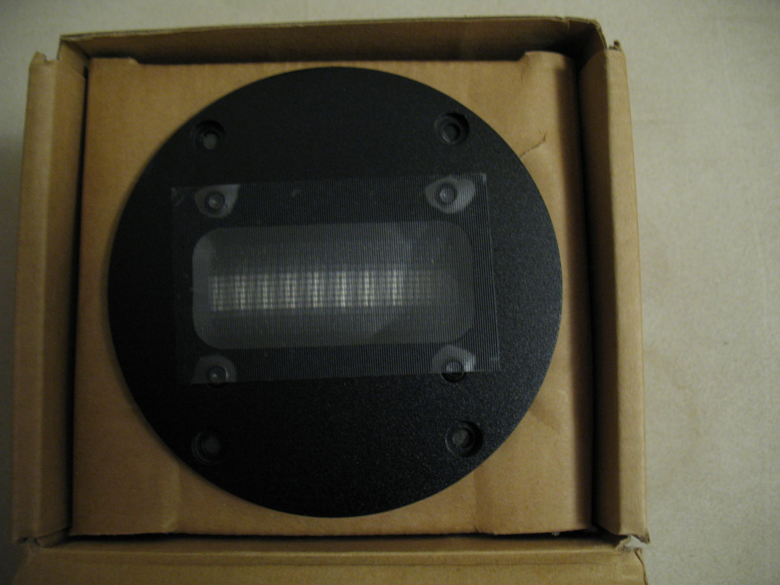

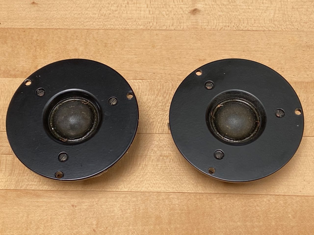

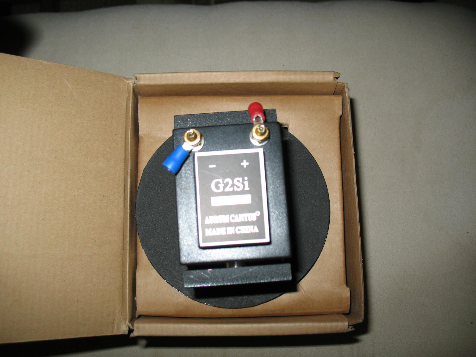

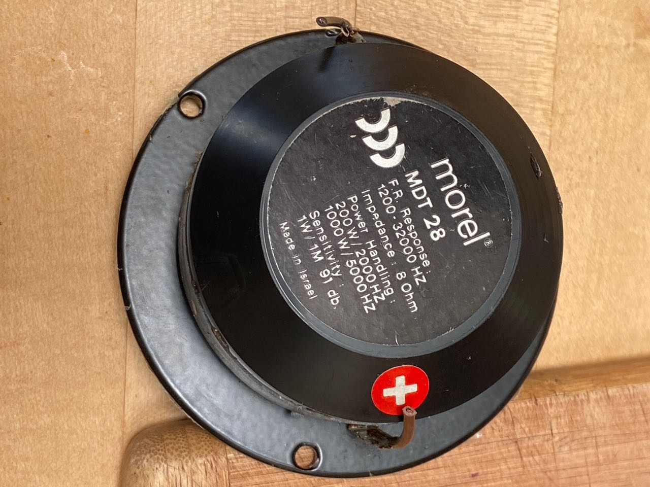

For Tweeter, I have at home a pair Morel MDT-28 and a pair Aurum Cantus Ribbon G2Si one of those (latter I will upgrade it to) Scan-Speak Revelator if I am not satisfied with the one I have.
I am 51years old tweeters sound always was acceptable most of the time from a decent driver. As long as not too metallic as much it hurts or uncomfortable. Soft domes my favorite, mostly.

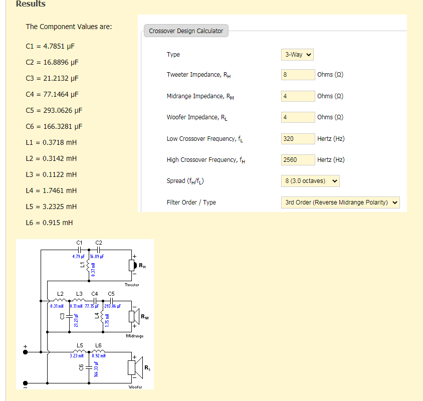

My plan to use this type of enclosure with separate woofers (separate mid drivers and tweeter see the picture).
Crossing points from 320Hz low point, 2560 high crossing point.
See the attachment.

I forget the Morel picture.
I got brand new domes in the box (original) I will have to replace them.
It has a pleasant sound.
Forget to mention if the Visaton AL130M midrange would be a bit more sensitive I would buy a pair to couple it with the Gorlich.
I use their brother AL130 in bookshelf speakers and I love it a lot.

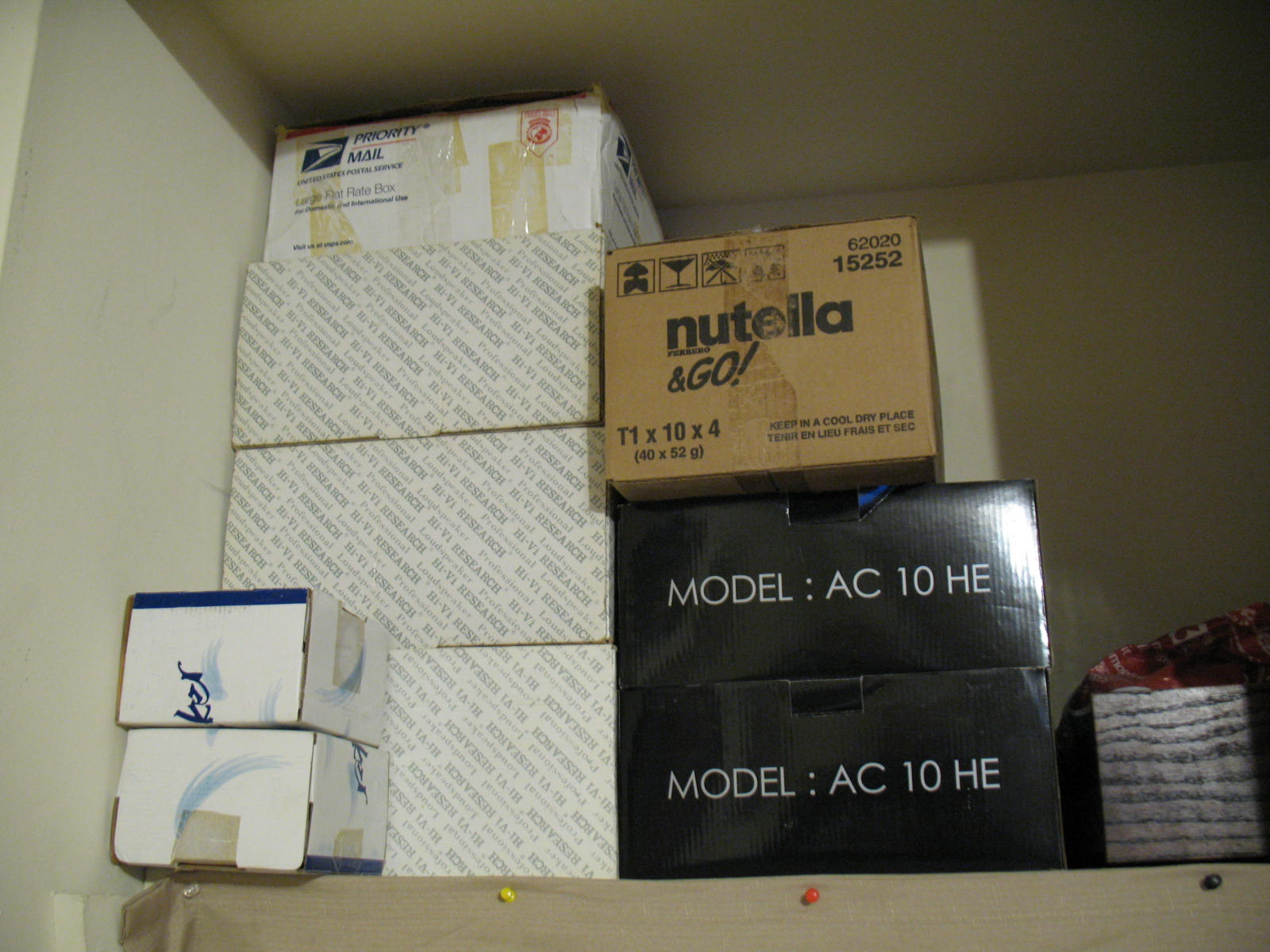

I saw the driver got damaged because was stored with the magnet at the bottom from the weight of the polypropylene cone.
They do have the factory styrofoam and gives some support under the rubber surround (from the original packaging).
When I received the Alcone drivers from Europe I did some extensive free-air listening tests with 2 Alcone's, 2 Hi-Vi's, and one of each, and I prefer the third option.
I am not totally against the aluminum cone drivers (sound) only if it too much (too metallic, makes me tired, annoying, etc) last 15 years I mostly listening to Visaton AL130 DIY speakers.
Of course, that can change when they are mounted in their enclosure but based on my previous experience not very likely.

The rubber surround has "some" support from the styrofoam when stored magnets up from the original "factory" packaging. Better than nothing or store it in sideways unless I rotate them often side to side.
I am aware of what you say!
My friend in Budapest rebuild drivers, voice coils, reform, etc.
He always advised rotating the driver even in the enclosure once or twice a year because of the gravity. I will take a look tomorrow and will post some pictures.

Those Alcone speakers are built and tested. One can be ordered as a kit from Germany. All Alcone drives.
Alcone Lautsprecherbausätze: Cauchy 2
Another built by a DIY member (friend) from Belgium.
More sophisticated with top quality midrange and tweeters.
My RefSpeaker
They both use 2 pair bass.
Greetings :)
Magnets up or magnets down it's the same thing. The weight of the cone will always be acting, under gravity, in one direction or another. Proper packaging for a driver shouldn't touch the cone/surround *at all* otherwise it will push it in. You store the drivers in their boxes in the same orientation they will be used in a speaker, vertically, so no sag, either in, or out, can happen.
I promised I will check the drivers, yes they were stored for a couple of years at the same place without ever moved.
I did check them and I do not see any visual damage or deformation, etc. They are in a good condition.
Yes, the packaging supports the rubber surround while the speaker's frame sits on the packaging at both speakers while the rubber (surround) supported also.
The HI-VI (YELLOW CONE) and the Alcone silver.
The Alcone I rotated with the magnet opposite side how it was stored until now.
I will attach some pictures.

I also tested the Gorlich Podzust drivers because someone in the US sells the mentioned Audax drivers NIB but it just too expensive with the shipping and import duty. I wanted to be sure.......as much as possible.
The sound is excellent (lovely) and much louder than the 4" titanium cone 89db full-range Tang-Band. I do not think I will need a second driver to get enough midrange.
