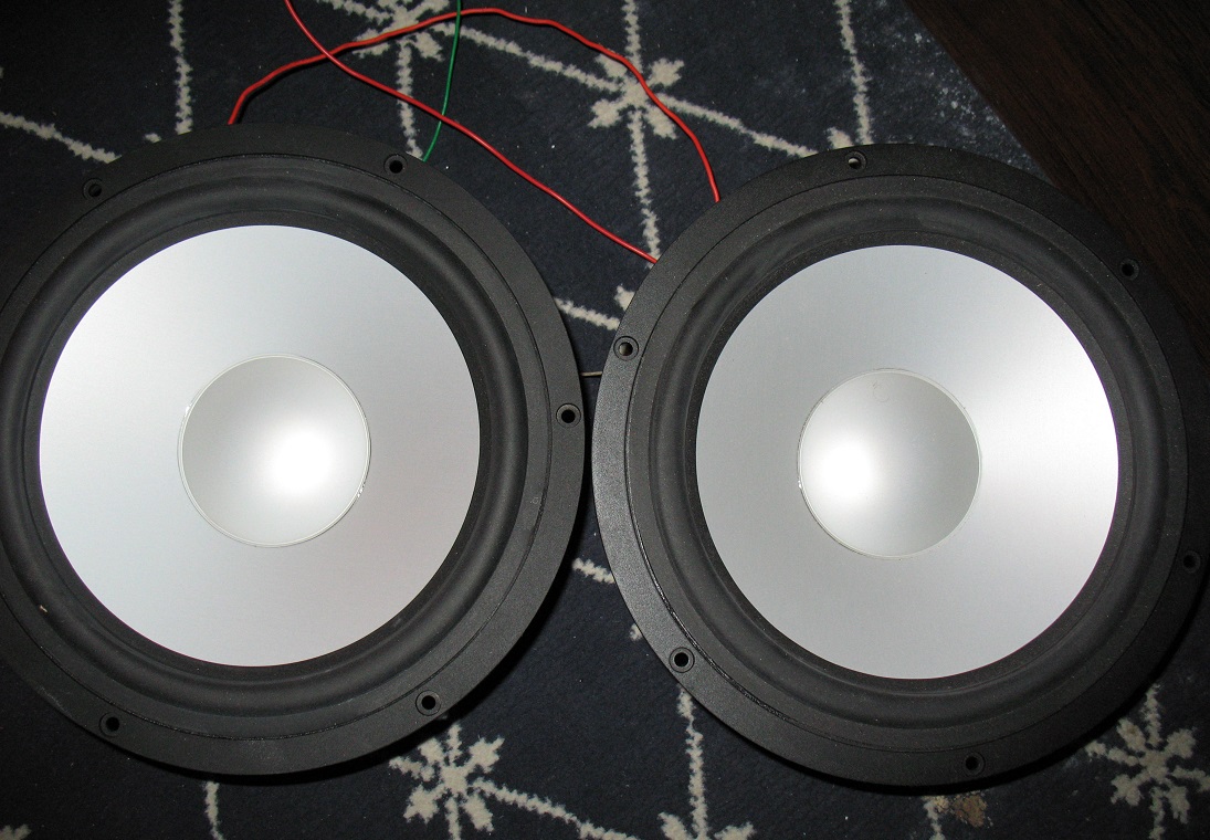

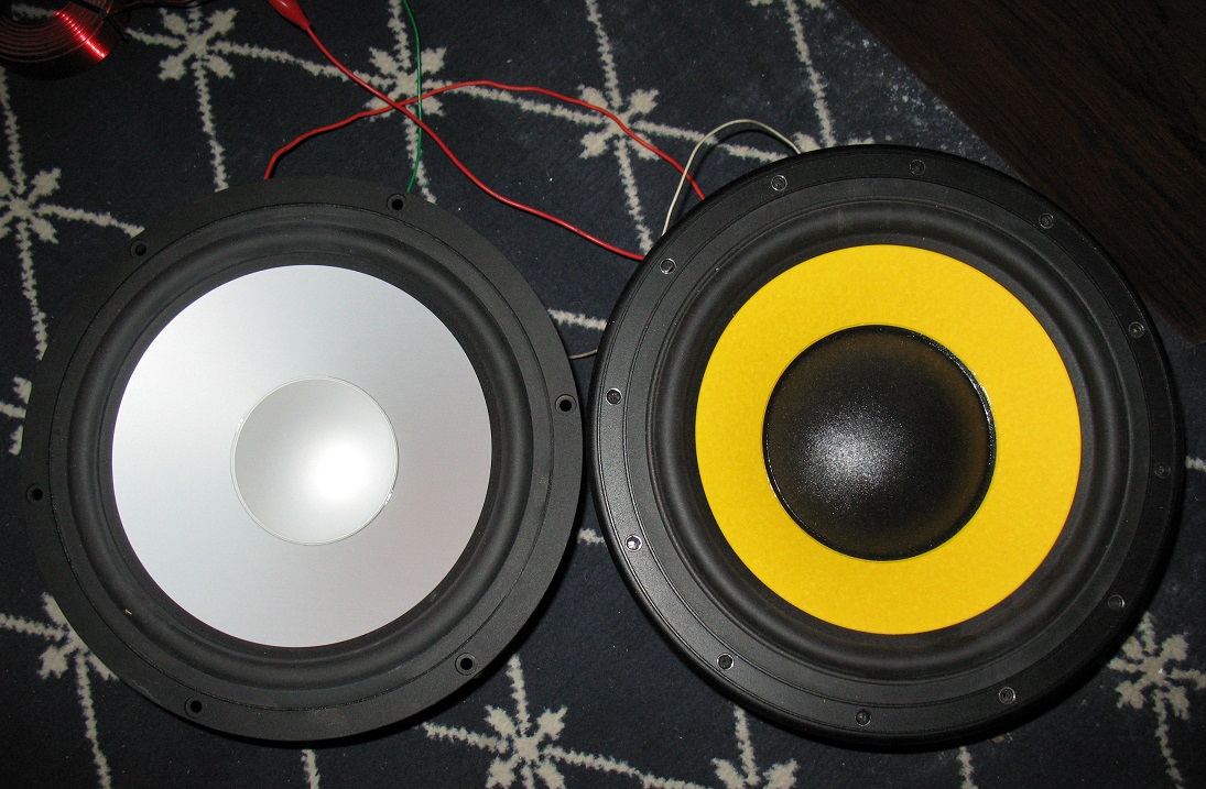

Back to the speaker, I do have problem with that Alcone woofer, I do not hide that all do several people like it.
If I hook up with out the enclosure just on the floor with a 4 or 6 or 8 mH coil I really would love to get much more punch more low end.
The Hi-Vi has more punch but not my cup of tea.
I'll reduce the enclosure volume for a final test..
In case the 10" woofer does not deliver I will try to save these enclosure, is a well built double walled cabinet.
I do not give up these project , may be I'll build another enclosure and I double up the Alcone woofer if I do not find better solution.😀😀

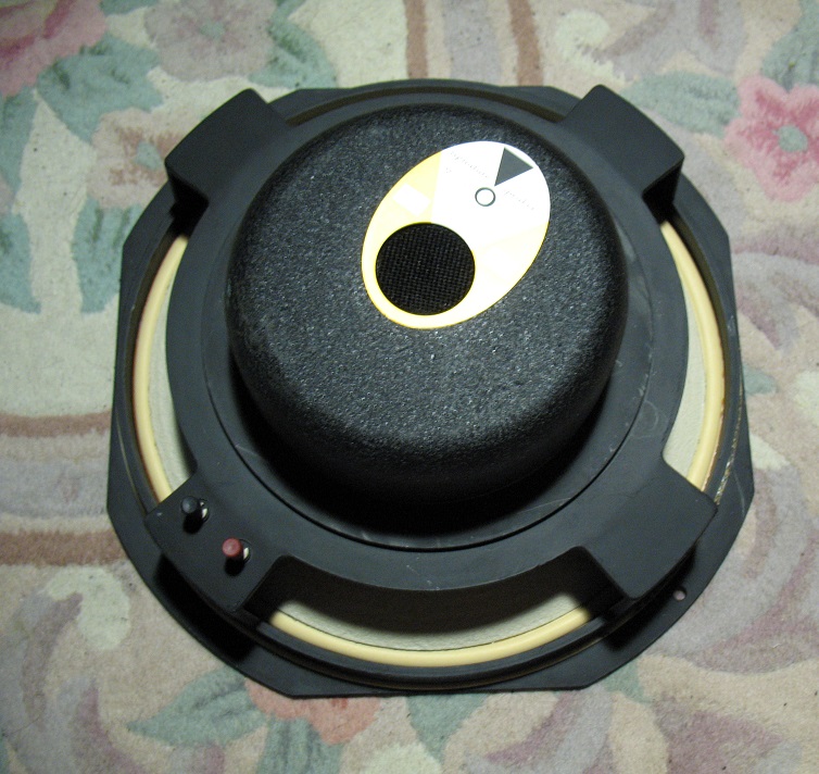

Or as a finnal solution I do have 16" old alnico JBL what I like very much (I do not find the T-S parameters) I use it as a woofer😀😀😀
Greetings Gabor

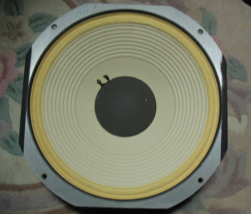

Soon I reduce the size of the enclosure (when the weather warm up a bit so I can stay outside, to work on it) I keep thinking on backup solution to
That JBL probably will be one😀
It is very loud, will match the 92db Gorlich Podzust mids .
It has the bass even in free air what I'm looking for, it gave me as much bass if I place the driver to the corner like the Alcone from the enclosure
The sound quality good enough.
Before I thought I'll sell these JBL woofers or the whole speakers but now I hold on for a while
If someone has the JBL T/S parameters that would help a lot...
Or other option double the Alcone like these guy did. In that case I would end up 4 Ohms speakers 😕

http://www.jblproservice.com/pdf/thiele small parameters/theile parameters.pdf
(note: VAS in L)

Thank you inductor for the info on JBL!
Based on the data the JBL not bad at all, I do keep them until I finish these project.

Look at these Hi-Vi F10 what also own
Not to bad based on the data still the low end not my cup of tea (soft and rounded)

Out of curiosity I run a simulation on the JBL LE 14A woofer I own
from 90L tuned to 33Hz F-3 not bad at all
With room gain that is nice.
Only problem I have with those JBL need new surround. The orig white looks very hard, not rotten just way too hard.
That can mess up the small parameters badly.
I can do it but it look like need a special surround.
I will see it, until that I do some listening , I'll compare it with the Alcone and Hi-Vi

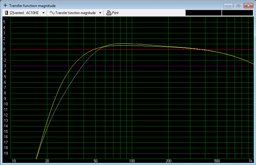

re:"About the SB drivers (woofers) they told me if I do not want headache better to stay away from them" - for what reason? SB has a good reputation.
The AC10HE driver sims OK in 75L, if you want more slam, tune the box higher (but not too high otherwise you'll get a huge peak).
What's the sensitivity of your mid drivers? It may be that they're masking the woofers if they have a higher sensitivity than the AC10HEs...???

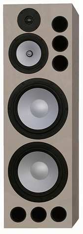

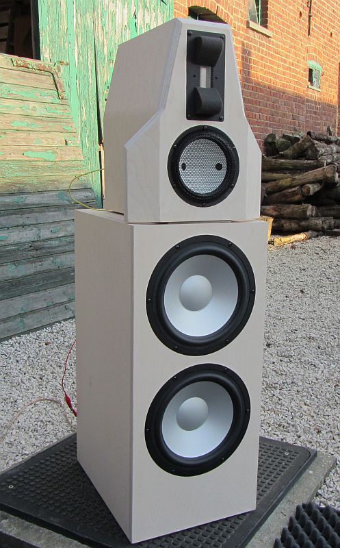

5. You need to match that with satellites (pair) and you are building a pair of speakers (subs). (Did you mention them ? please state the #post, thanks.)
Hello Inductor
Sorry I just missed that question! My apology.
I have a pair Gorlich Pozust mids in a 6L enclosure and a pair Morel tweeter will be in a separate smallel 1-2L enclosure.
Those will be on the top of the woofer
Now that separated enclosures I don't know if I can call satellites probably yess.
Reason I chose to build these way
To separate the mids and tweeter from the bass resonance
To line up the drivers center point - woofer a bit forward etc.
The last reason
(from the beginning of these project I had the feeling and some of my friends wrote and told the same)
3 way speakers tend to give a lot of extra problem to DIY-ers compare to 2 ways
To me most of problem show up at the bass region,
Well controlled, precise deep bass must, NOT SUBWOOFER BASS!!
Many of my well expert friend never ever give a thought to build 3 way speakers,
Some of them built and build speakers for decades and sell them
To go back to the reasoning, last reason
these way I can replace the woofer enclosure if it need to, with out need to rebuild the whole speaker.

Yesterday I compared the JBL with the Hi-Vi (soon I'll do it with the Alcone to)
I have the feeling I'll not go after the JBL! Way to big driver.
Al do has nice upper bass and nice extension up in the mid area that is not what I need in these project.
If I where to buy the woofer today I would probably use 2x8" 4R /each side so no way to go with 14" drivers.

75L BR enclosure
See att. simulation he made
White from 75L BR, yellow 110L BR.

At first I thought I will sell the HI-VI F10 woofers and get one more pair Alcone
So I made a listening test with the two Alcone woofer connected parallel (unfortunately I will get 4 Ohms) with a 4mH inductor.
Sounded better but still a bit thin at the low end
After I thought let make a test with one Alcone and one Hi-Vi connected the same way.
I do love what I heard!
The Hi-Vi has a bit more weight and warmer al do a bit round the low end
The Alcone a bit cold, thin but the same time precise
The two woofer complete each other very nice.
So that is what I plan to put these two woofer in one speaker of course separated enclosure
The Hi-Vi at 60L BR tuned to 31-32Hz the Alcone 65L BR tuned to 31Hz.
Again the two woofer enclosure will be separated from each other.
The question remain I will connect them to give 4R or or 16R?
