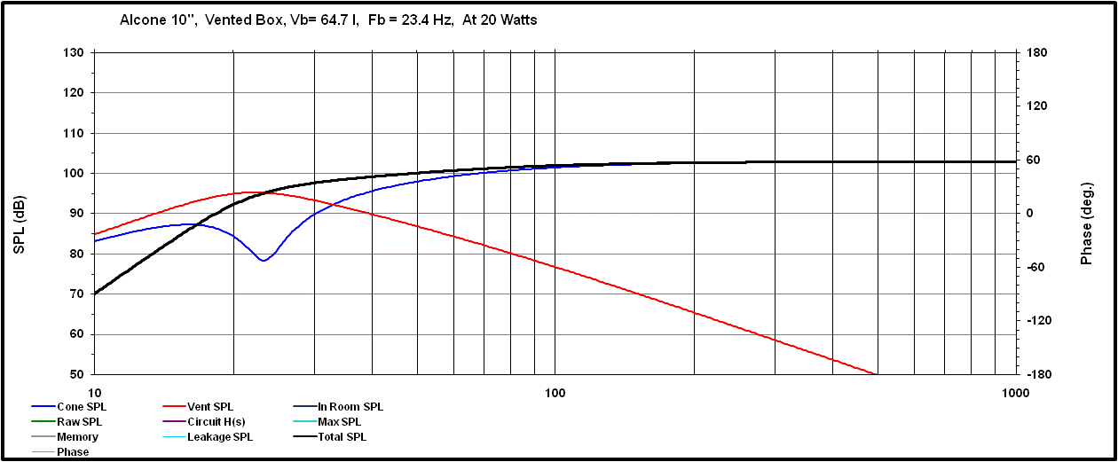

The 65L enclosure req. based on my simulation and Alcone advise that to.
It was a mistake to go up 75L but I'll resolve that issue
12" woofer is useless to these enclosure, to big but has other problem to that is why I'll newer go there

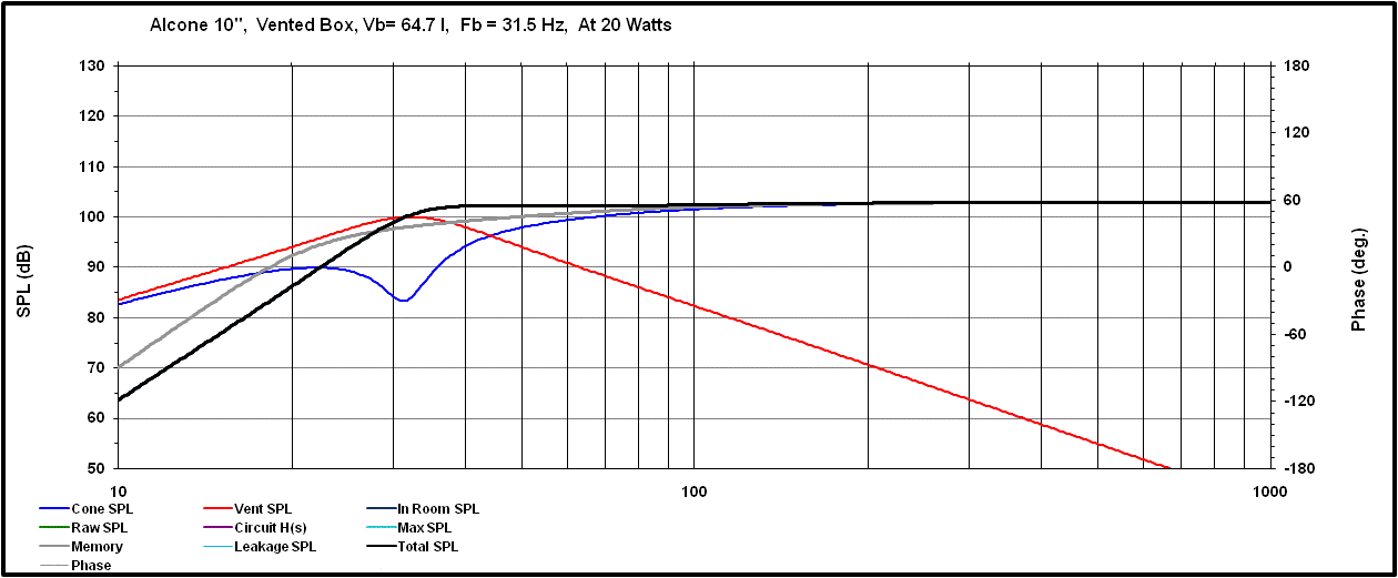

OK one think left, set up the enclosure 65L, tune it to the factory advise and let the woofer burned in.

Until I do not adjust the enclosure to 65L and tune it to the factory advise frequency I can share any concrete.

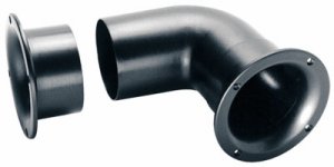

I have both side flared port tube, was sold as a 3 inch diameter tube but the opening end almost 6 inch.
Length is between 12-13 inch..
I do not use that port tube how is it now. Only use the mounting part (because I already cut the hole for that), the rest I will replace it with 3 inch drain pipe or what ever tube I will find at Home Hardware store.
I want to bent it 90 degree done inside the box like that Visaton port tube (picture posted on the previous page)
If I only can get 40Hz these woofer must go- no kidding!!!!!!!!!

Based on the factory simulation ( if the speaker data is correct) from 65L enclosure f-3 28Hz
After my sim result the best will be if I tune it to 31Hz, look much better if is tuned to 31Hz.
That enclosure tuned to 31Hz almost perfect for the Hi-Vi to (for test)

Is not Peerless India, made after some Germany design in China or Taiwan.
Very popular in Germany like the Monacor and some other European country. I ordered mine from Germany

Hello
These is my port tube
https://www.solen.ca/pub/index.php?...eau1=1&niveau2=2&niveau3=47&s1=2&s2=2&s3=&s4=
I really want to mode that, keep the mounting side (because the hole already cut) and use straight tube (not flared ) but bend it 90 degree like the Visaton on the picture attached.
If I remember well I need 22cm from the 3 inch tube plus I ad extra 1.5-2cm for the one side wich remain parabolic.

use Lv 6" instead, you will hear more bottom end. Grey line is your estimated current port tuning.
I do like these sim result!
And in these enclosure tuned like that I can test the Hi-Vi to (just in case)
