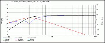

I will tested around 50L (That was the orig size of the enclosure for the Monacor 8" driver) I can separate there easily.
I'm confused a bit🙄

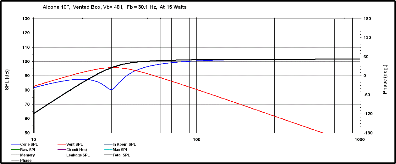

One of your sim result very nice from the 48L is really nice, the 30.1Hz tuned
The other from the 47.9L is unacceptable (I mean I do, or I will not finish these project)
I think out of the two the second is the correct sim result based on my sim result.
If you are able to open the data **** so you can see the factory sim from 65L F3 28Hz is very nice.
Port tube 9Cm diameter 270 long..
Please roll done to the bottom and you can see how nice.
If you can see that you will understan whi I push the 65L size cabinet.

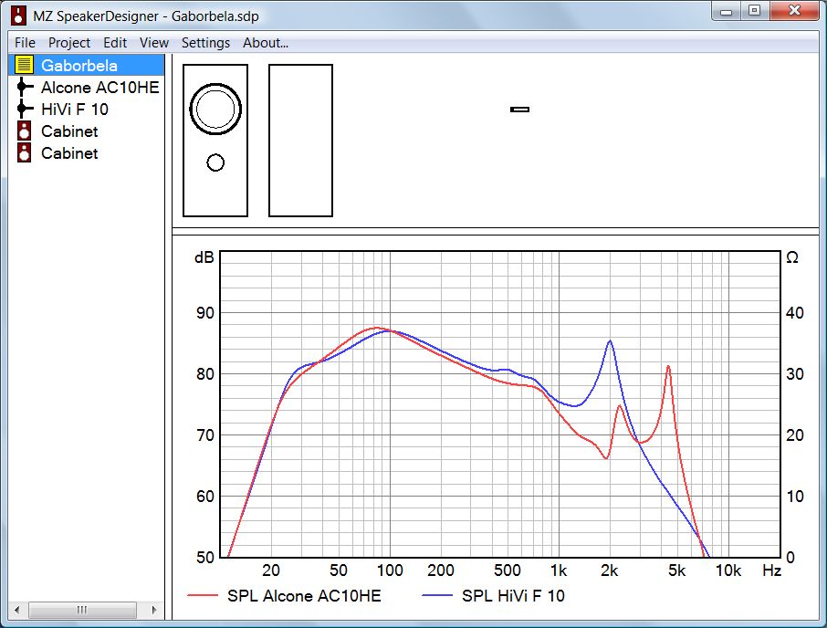

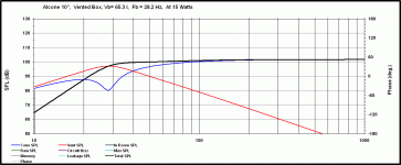

It's not the enclosure that's wrong, but your test setup is:
  • Tuning frequency of 27 Hz (vent 9 cm x 27 cm)
  • Woofer coil of 8 mH
  • Woofer not screwed in tight
Attached a simulation of your current test setup. Really no deep bass, just a peak at 80 - 100 Hz. Reducing the box volume to 50 liters does not help for sure. But proper vent tuning (9 cm x 13.5 cm) and removing the woofer coil would do. Then you get the red curve from post #13. F3 is around 35 Hz, not quite 30 Hz but fine anyway IMO.
65L
Relative -3 dB Point 30.83 Hz
Relative -6 dB Point 27.09 Hz
Relative -10 dB Point 23.59 Hz
Port Diameter 7.5
Port Length 20
Number of Ports 1
Tuned Port Fb 28.2 Hz

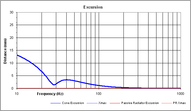

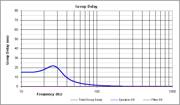

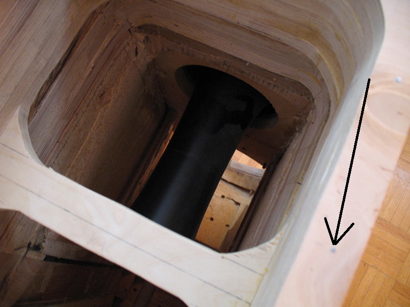

  • When I wrote something wrong with the enclosure I mean with the set up, actually the port tube I got is very bad
    The enclosure inside only 20Cm wide
    The port tube both end almost 13Cm and 29.5Cm long
    That tube in the center of the enclosure slow done the air movement a lot.

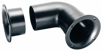

    I have to get some other port tube, only problem the 9Cm tube size very rare.
    You gave me 9Cm, on the factory data they gave me also 9Cm.
    Gan I go with 10Cm (actually 4")??
    Also I would like to use 45 degree tube like the attached picture.
    For two reason
    If I can't find tube like that in that size I will use water drain tube 4" type.
    I will cut it and bend it to 45 degree (slow curve)
    The req. lenght to long to go with straight port tube.

Experience with port tube
Do someone tested different type diameter port tube at same enclosure.
What do I mean?
For example
Here I need 9Cm diameter 27Cm long port tube for star + fine tuning
I have to up to 10Cm a bit longer tube or go 8Cm shorter tube. Need to be calculated the lenght precisely.
9Cm not available, specially not in the size I need
For 10cm I can use the plumber's 4" PVC pipe, also has bigger selection in the store from these size.
8Cm diameter I can order that Visaton I attached plus ad to the lenght some more the get the right size.
My question bigger diameter tube VS a bit thinner.
10Cm VS 8Cm.
My flared tube cost $32/each, not cheap at all, NOW I can not invest $$$ to test all tube on the market just to tune up my box.
If you got some experience please share it with us.

the 65L cabinet looks good, i would use it.
the GD still acceptable, what i didn't see is the xmax, prob 6-8mm?

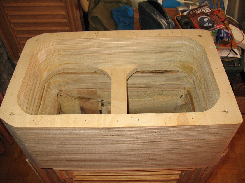

Now I have extra 10L in my enclosure, the bottom just screwed up, I didn't glued yet thank God. Easier to work with.
Someone advise to use sand bag to feel up the extra room. Sand bag is good but if I use cloth bag the send will end up all over in the box. In plastic bag the sand get hard almost like the rock. Also if ever I move the box it would give a headache.
Other option
1) I can separate 10L and feel up that place with sand.
2) Or I just cut of that 10L
Out of two option which one would be better?
The sand in the bottom of the enclosure do it have some dumping effect or just add some extra weight next to feel up that 10L?
I used send in speaker stand with good result but never tested in the cabinet.
Any advice on these please🙂

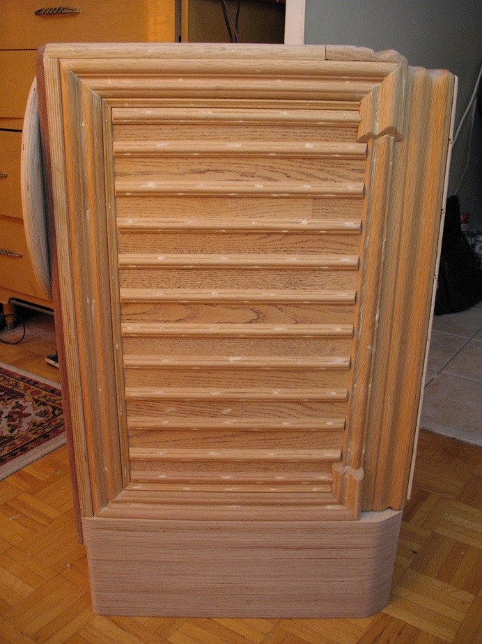

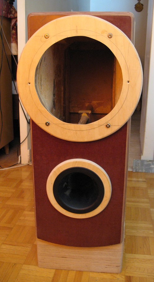

Hello
I want to let you know I didn't gave up these project, at least not yet.
I'll cut of 10L from the enclosure, make it 65L.
Unfortunately I have to wait until the weather will warm up a bit. The bottom of the enclosure was extended by Baltic birch (thank God the last two pieces I didn't glued yet so easily I removed that.
I need to remove 4 pc more but those are glued and full with nails and 4 screws each sheet of wood.
I have to take it out from the apartment and use chisel to take of that 4 sheet.
I attached some picture from the woofer enclosure.
You can see what I'm writing about.

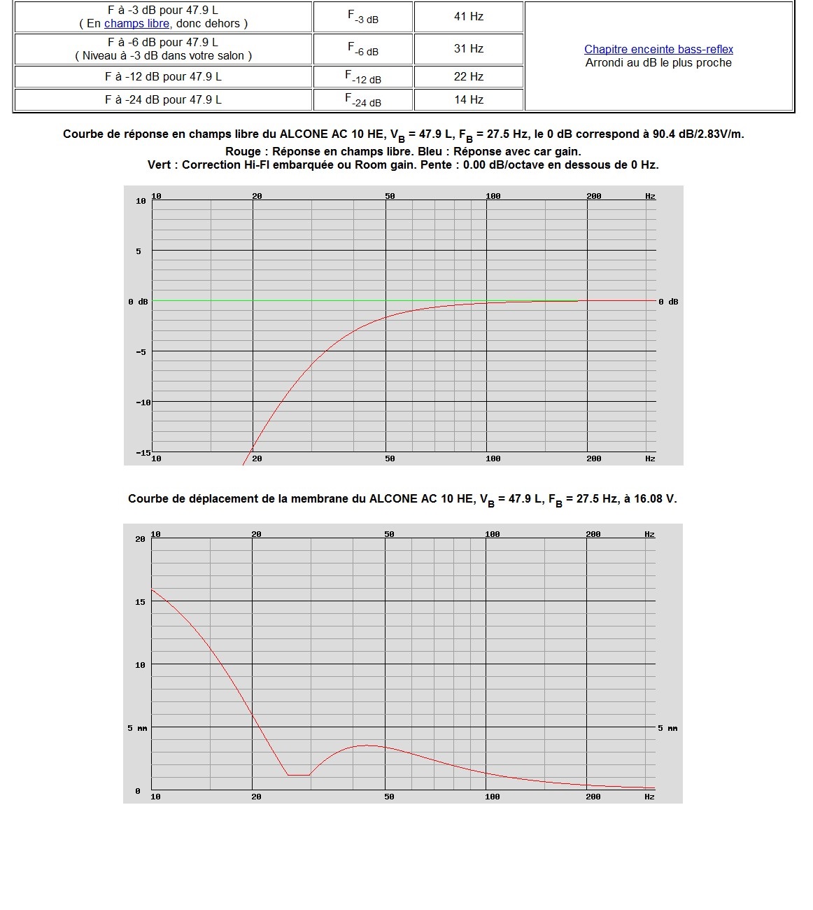

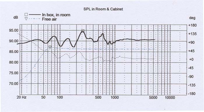

What is hard to understand to me at 20Hz almost get 90db.
1W/1W 88db, that is possible?
I know with room gain we always get +3 or more db based where we place the woofer. Close to the floor, corner etc.
Why I'm interested on these I know my enclosure to large for these woofer.
In case I would go under 65L (what is the adwise from Alcone) and after I'm not satisfied I'll be in big trouble.😱
i agree with sreten, the dotted line is LT
The dotted line is the free air, that sure, you can reed it please look at the last pic. I posted.
The other line is in the enclosure with room gain
Only tuning I (read about) find here (at least how I understood) the port tube.
May be I miss something or I lose something when I Google translate it from German to English.

OK I found it and yes he wrote about some type of equalizer.
Next question that is a active device or that is how he just set up the crossover
If I can guess I would say some active device because with out to me incredible to achieve that result even if we count the room gain.
The blue line (dots mixed) is the free air result
The continuous line the result he got with the room gain plus tuning and equalizer he use based on the mark on the simulation
Another line (just dots) I really don't know what is
By the way I did look around on his website and found some equalizer which look like these

About 20 years a go built another 3 way project, I used a 12 inch Monacor woofer in 75L enclosure and had the same issue.
I famous speaker producer guy SONIDO (Istvan Varga) even he gave some aid and marveled how shy the bass. I threw out that enclosure and sold the drivers.
I afraid on the end these project end up like that.
Look like bigger than 6.5 inch driver I run into trouble for some reason.
Greetings G
