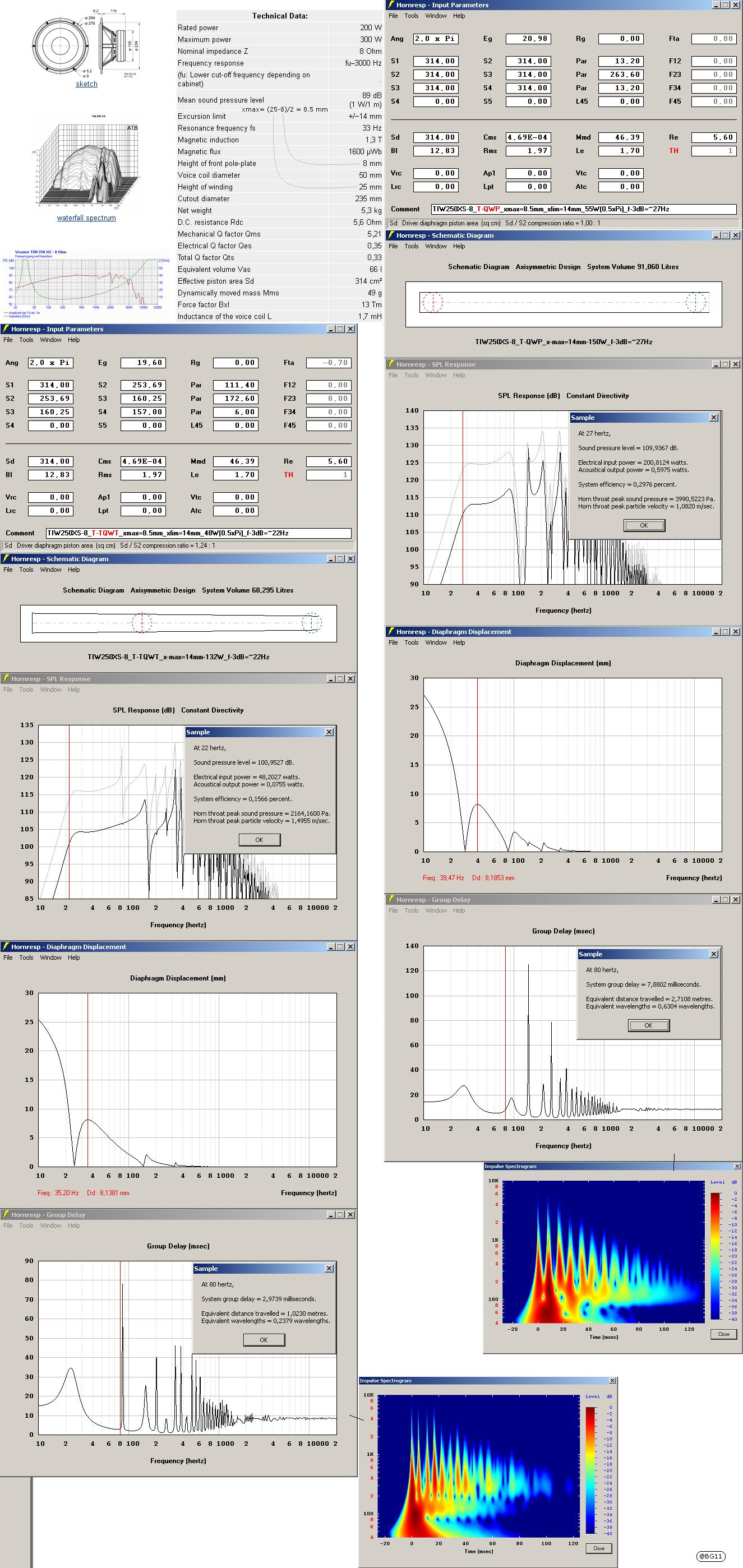

I would pick the Visaton driver at first hand for mains but not in a ported box as this driver is excellent in a closed box when Qtc=~0.5-0.6 and use the same driver in real subs (2 or more) where the extension below ~50 Hz can be fully be exploited when placed near walls/corners:

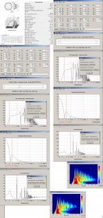

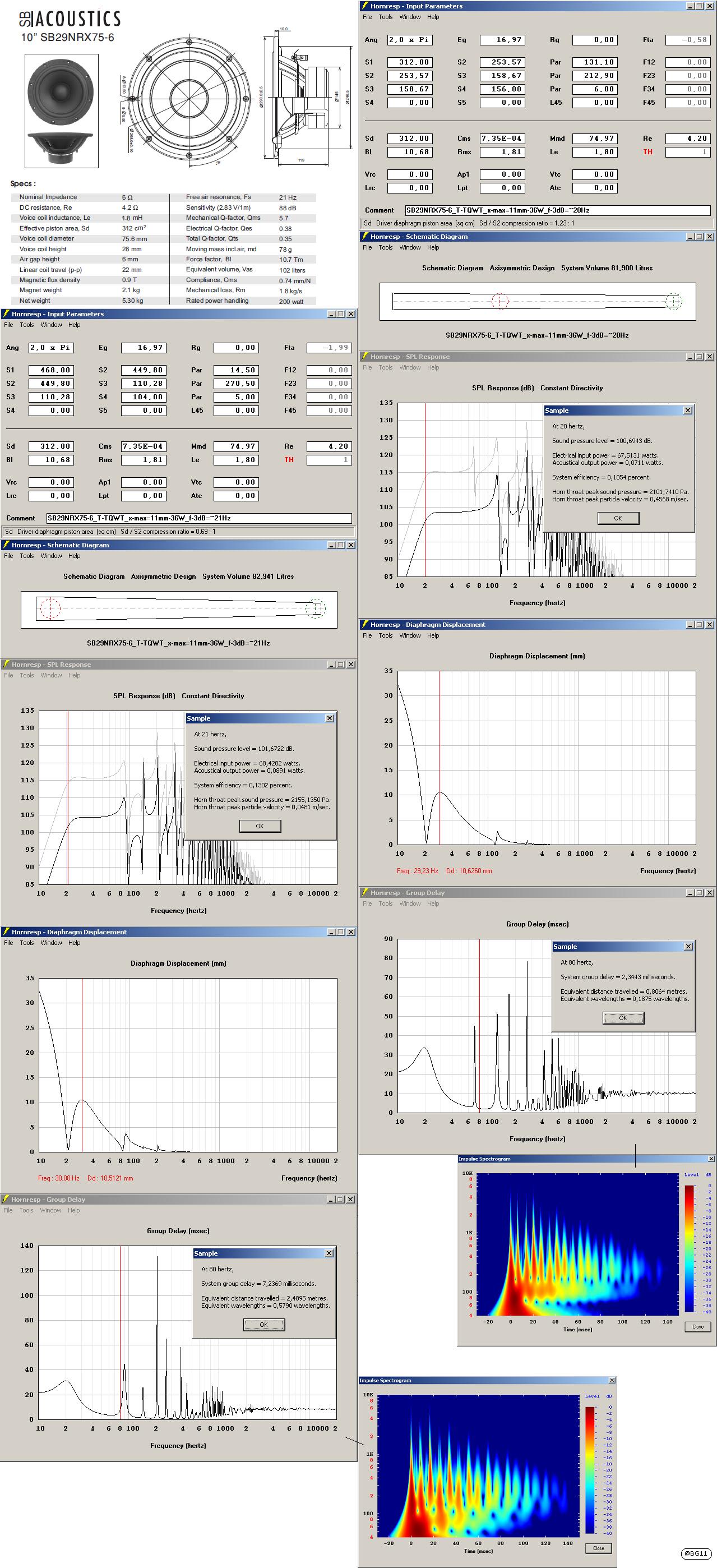

Pictures of modeled sub's :
b🙂
Hi Gabor,
b🙂

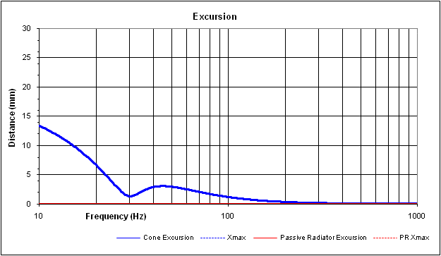

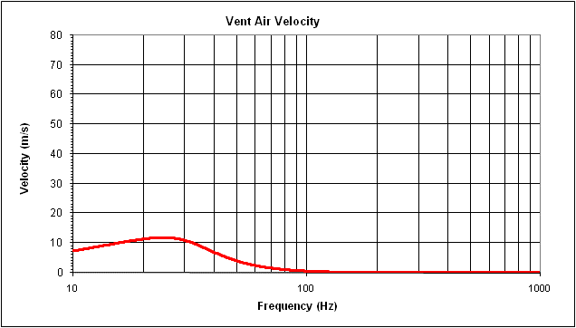

bjorno, if I was you I would divide that figure of the Visaton "Excursion limit +/−14 mm" by 2 so that I would use it for the (comparison) simulations you have presented above. Usually is good to work/use T/S parameter Xmax so that it gives a good standard between different manufacturers (and we don't call them layers afterwards). I know some don't like standards... or make their own.😉 As Î said I have some doubts about what that parameter is about. And not saying your sims are not "nice" or inacurate. Again, I would say Xmax=7 mm until somebody proves me the opposite. Thanks.
http://www.bcae1.com/speaker.htm
Speaker
Hi Inductor
Good point, 😱 I really did a mistake and you are quite right.
I've earlier compared this driver with one of my favorite drivers and found it is very similar in performance ( quarter-wave enclosures) :The 7" Wavecor-SW178WA01 for which I used Xmax = (16-6)2=5 mm and for the Visaton (25-8)2= 8.5 mm but for an unknown reason I forgot to do use x-max= 8.5 mm in my new simulations.
The limit 14 mm is IMO good to use for 1 Hz safe excursions when no protective low end HPF is present.
I will post a new simulation using both 8.5 mm and 5 mm as reference later this evening.
Thank you again!

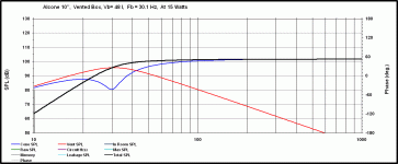

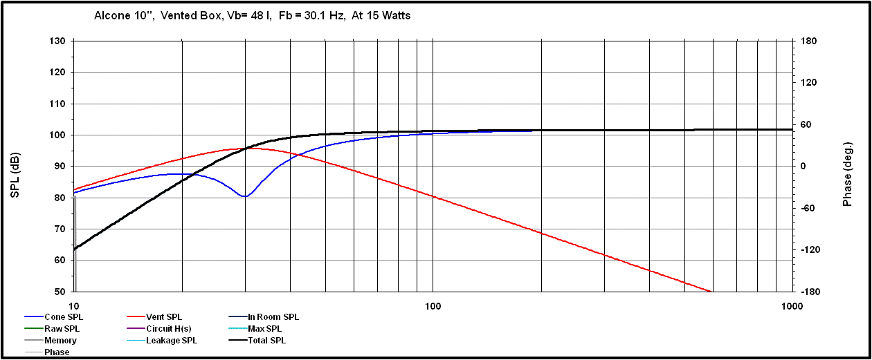

The woofer filter of a passive 3-way is very tricky. Even adding a single large coil already messes up the frequency response of the woofer completely. The peak at 80 Hz can be cured with a series LCR in parallel to the driver. But then the impedance most likely drops to 3 ohm or less. An active woofer filter avoids all these problems.
Attached a simulation of the Alcone AC10HE in 75 liters.
Here is the Alcone data but better if you open the original, PD file.
There you can see for BR they advise 65L..
Also D'Appolito first buid was 65L with these woofer.

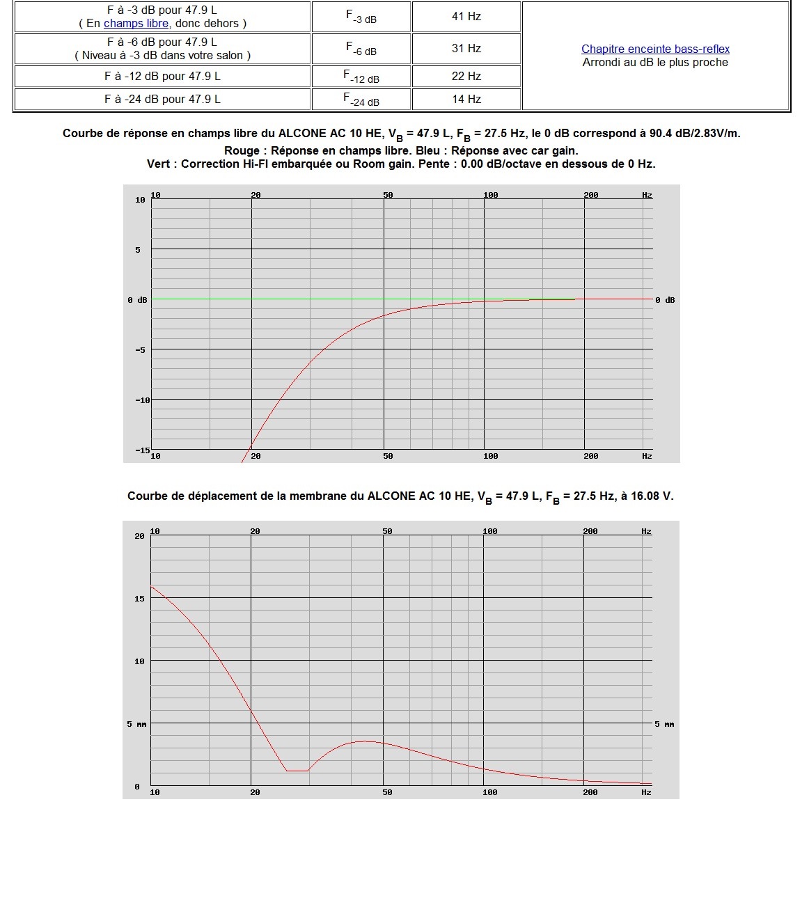

I would start with WinISD as its free It suggests for the Alcone needs 46 Liters and a port of 33 cm long with 10 cm diameter giving a -3db of around 40Hz, or a box about 25 Liters sealed with a -3db of 60Hz. I would go for the latter.

From what I remember enclosure is to large for the Alcone 10", giving it a very low Q, instead of optimal, with low bass extension (?) with weak and delayed lows.
I will read/check it later, for the full thread and simulation. But I remember the above problem being an issue here for this speaker, taking into account the enclosure being made and the money available, as local availability (or price) and the specs needed. The right tuning must also play a role here...

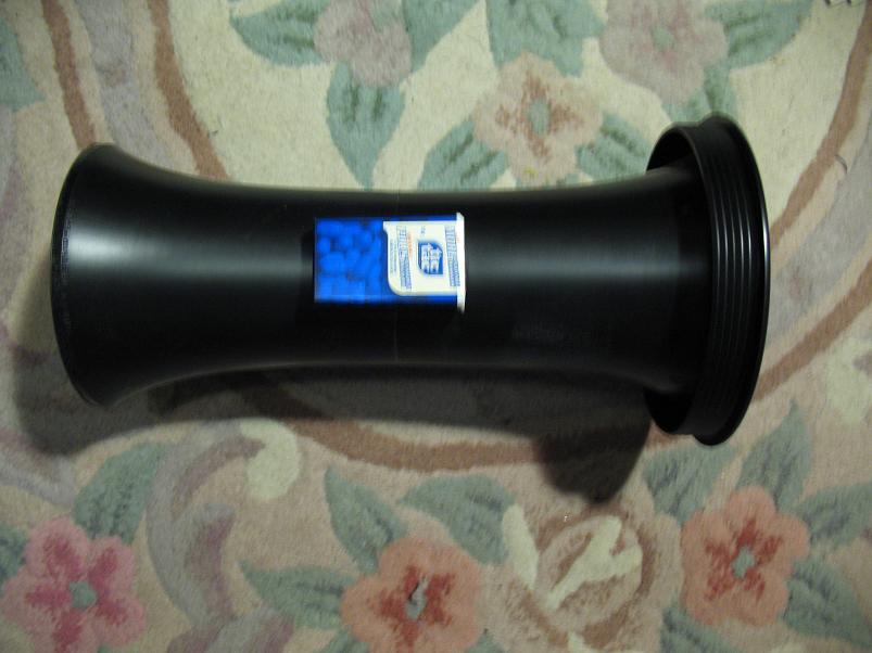

I agree with you tuning is very important, In my case the port tube is no good
29Cm long and 12cm at the openings both side.
I can't cut it because I don't know how to calculate the flared type precisely.
I have to buy a 3" type adjustable port tube.
The enclosure was designed for a 8" woofer! Because of that I believe noth wide enough for 10-11" woofer specially with these huge (large diameter) port tube.

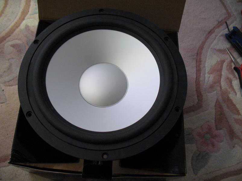

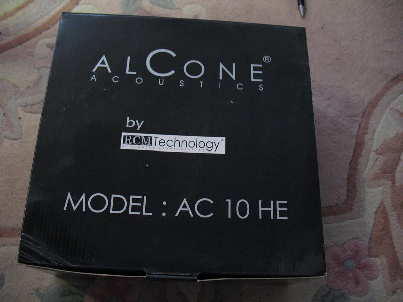

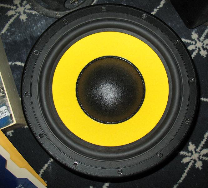

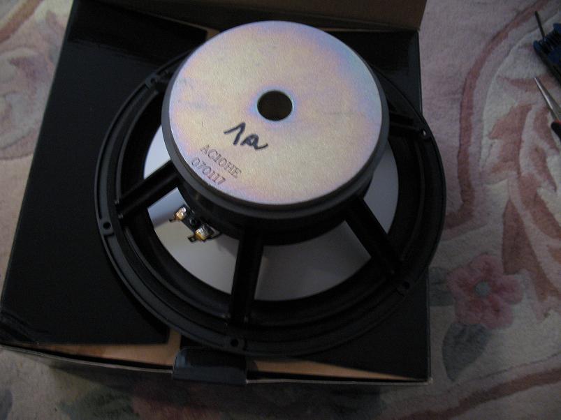

Some picture from the Alcone and HI-VI reasearch F10.

Consider this just as a starting point simulation for the optimal alignment of the Alcone AC10HE, before you use a different type/size enclosure or complex alignment.
ALCONE AC 10 HE, VB = 48 L, FB = 27.5 Hz
Port size int.diam./length: 7.4 cm/30 cm
This is a different alignment already for the same driver with a +2L (50L) enclosure and notice how the extreme low frequencies drop to F-12 dB/25 Hz (previous 22Hz) and F-24 dB/16 Hz (previous 14Hz) with F-6 dB/31 Hz being the same for the two different enclosures/alignments.
ALCONE AC 10 HE, VB = 50.0 L, FB = 33 Hz
Port size int.diam./length: 9.4 cm/31 cm
If you want to use/try this alignments with your box just drop some phantom volumes inside like 1 or two pillows to bring net down close to figure. Then bring the inside diameter of the port close to the 8/9 cm mark, with some kind of wool felt/foam like in the example.
You just need a good 40W amp for this driver.

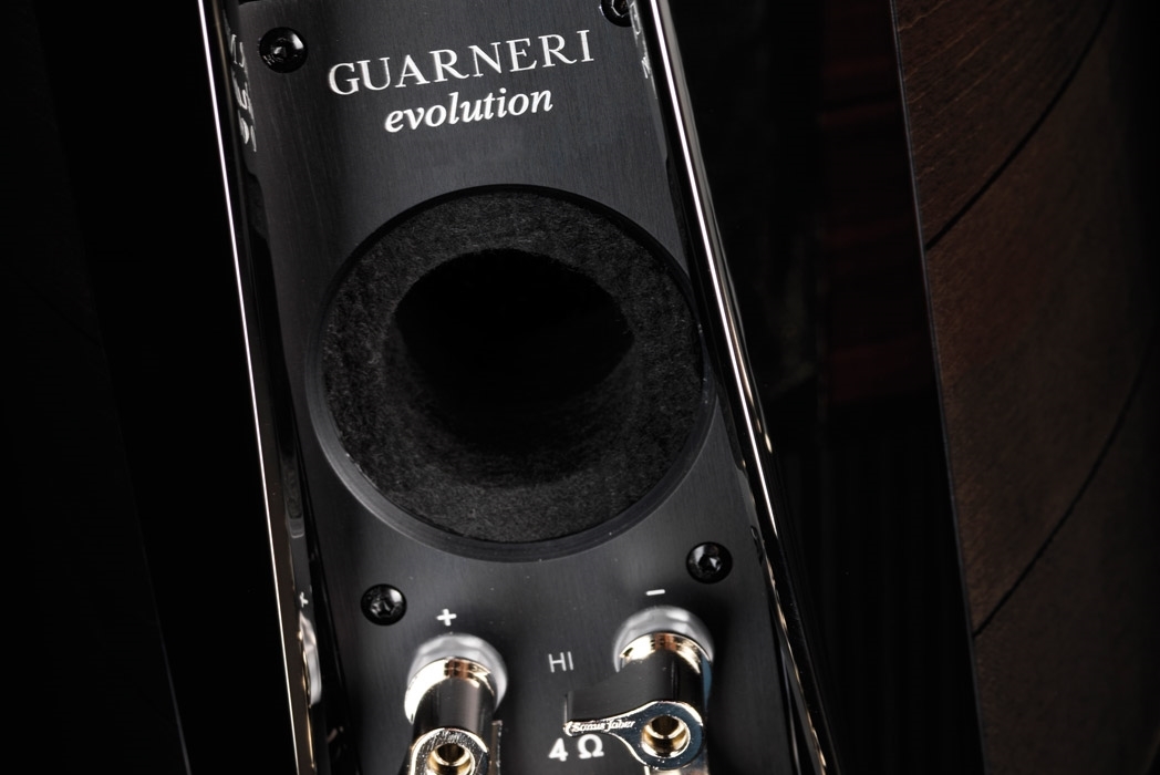

  • PORT - para-aperiodic vented system - Luxury loudspeakers Guarnieri Evolution - Cópia.jpg

48L
Relative -3 dB Point 37.08 Hz
Relative -6 dB Point 29.99 Hz
Relative -10 dB Point 24.93 Hz
Port Diameter 7.5cm
Port Length 25cm
Number of Ports 1
Tuned Port Fb 30.1 Hz
you will get to 30hz in room 🙂 hope that helps
