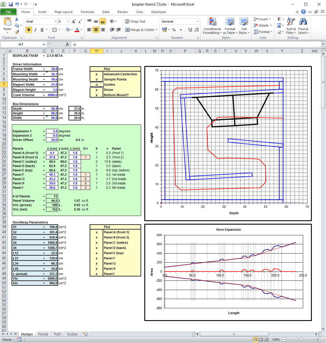

OK, I picked up a couple sheets of 3/4" baltic birch. They measured out at 18mm. Here is what I am planing on going forward with. (unless anyone sees any glaring mistakes)
The spreadsheet's expansion graph suggests that you've got a bit of an error after the first fold from the mouth, where that section is a bit too narrow. This may throw off the results a bit. If you increase the height of the TH slightly and lengthen the second internal panel a bit, that should reduce the error. The alternative is to set the external dimensions that you'd like to use and rejig the internal fold until all expansion errors are minimized as much as possible.
Thank Brian,

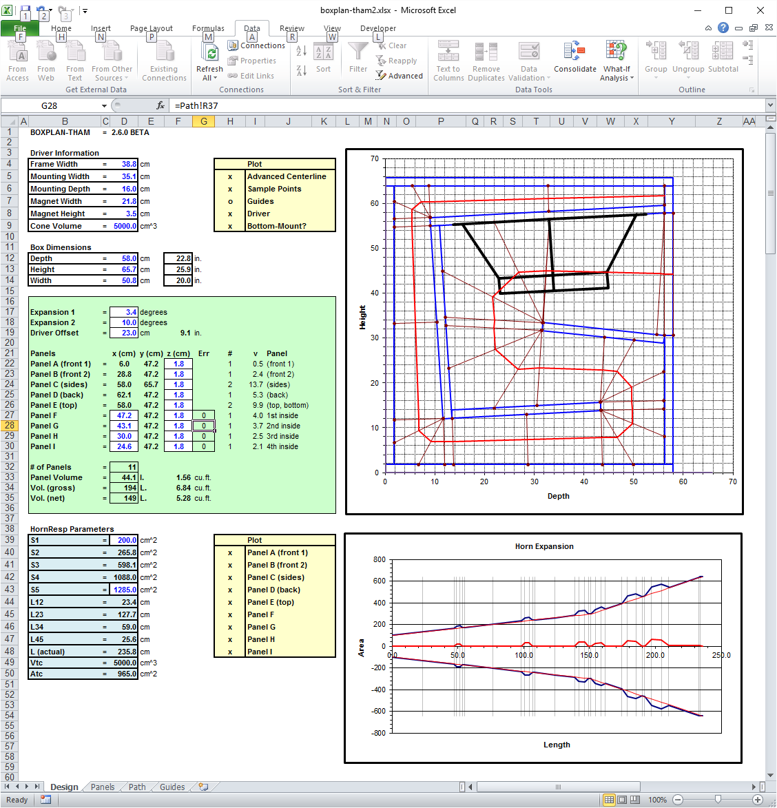

I made the cabinet a bit taller and adjusted the fold slightly. How does this look?
You've still got a bit of an error in that part of the expansion - now it's too large, LOL.
Here's a layout that minimizes the errors. You'll notice that I've adjusted a few entries in the spreadsheet to get this. In the Horn Expansion graph, the error line (read) is now almost completely flat (not counting the little bumps which signify where the bends are). This should be the solution to look for, unless you deliberately want to leave part of the horn larger or smaller than required for the sim.
However, have a look at the external box dimensions - 22.8" x 25.9" x 20". If I was starting with this, I'd adjust the dimensions to 23" x 26" x 20" (or maybe 22 x 27 x 20), then adjust the expansion curves and panel lengths for panels F, G, H and I to restore a smooth horn expansion.

On a whim, I've decided to update the spreadsheet to change the layout of the A,B, F and I panels a bit - basically changing how they're joined to each other to provide a smoother expansion at the horn's mouth. I've also changed it a bit to allow adjustments directly to panel A and panel B, rather than calculating from S1 and S2. I still have to go through the spreadsheet to check for errors, but the results look promising:
