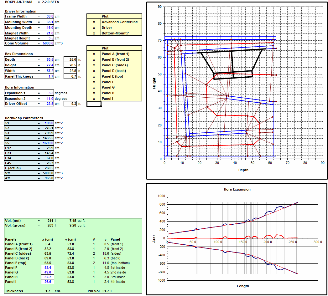

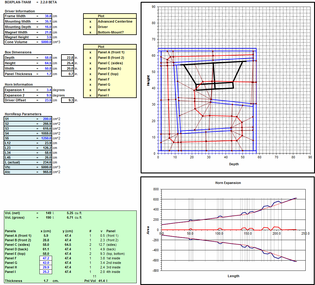

Ok, here's a minor update that keeps the top and bottom panels the same width as the internal panels. This makes cutting them out a lot easier.
BTW - what's everyone's favourite cut-sheet program? I think it would be interesting to see how close this design is to a single-sheet one.

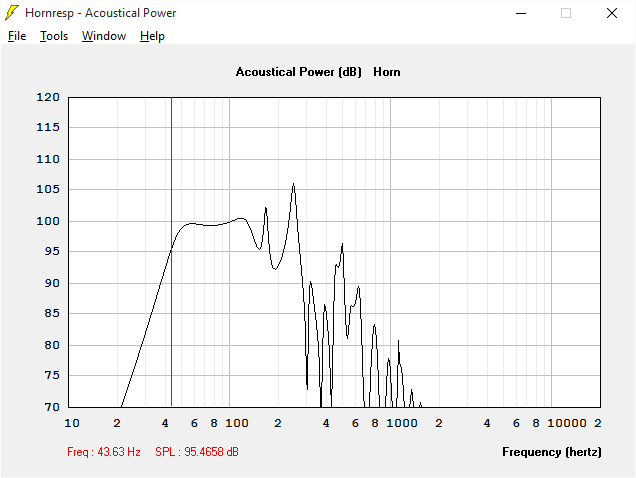

WTH?! For some odd reason I go back and start comparing sims THAM15, SS15, and this design and there's not much difference at all. I mostly used the PA385 but tried a few others. Basically all are 95db @ 40Hz. WTH? Maybe HR updates? Prior to this, Don's design clearly reached lower the THAM15 or SS15... It's clear by his post that Don's intent was to go lower than SS15/cubo too and my memory matches Brian's comparison in post 12 (4 pack 10db more at 40Hz) Am I losing it, can some one check this out?

That's not too surprising - LF efficiency is primarily a function of the box volume.
What you've got to look at also is the delta between the 40 Hz point and the passband, and also where Fb lies, as that defines the usable low-frequency limit of the design.
I don't think the SS15 can be correctly sim'd in HornResp anyway. It's got two expansions between S3 and S4, according to the PDF of the layout. HornResp allows for only one.

I designed a version of this that is a bit more exponential with a wider mouth and it sims better in the upper & lower end.
The design layouts on here also seems slightly exponential, not conical, is it for the same benefit?

Nope - no joke. Parabolic expansion is the best match for what happens when you 2D fold a horn up into a box (two sides parallel, two sides at an angle, at any point along the expansion). That's why most of the sims here are set to use PAR (for parabolic) expansion.

But if you mirror the parabolic curve sides around the y-axis center you get closer to your box in 2d, is this what you mean?
Yup. In any case, because of the dimensions involved, the parabolic curvature is very slight, and look almost like straight lines in the sim.
