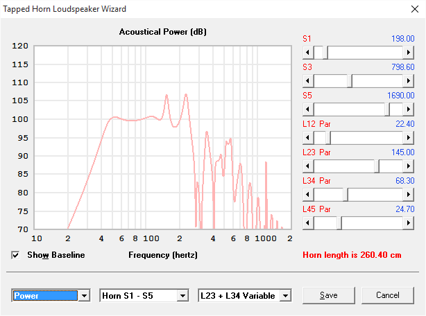

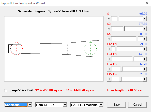

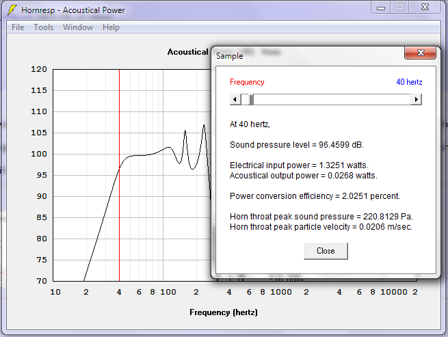

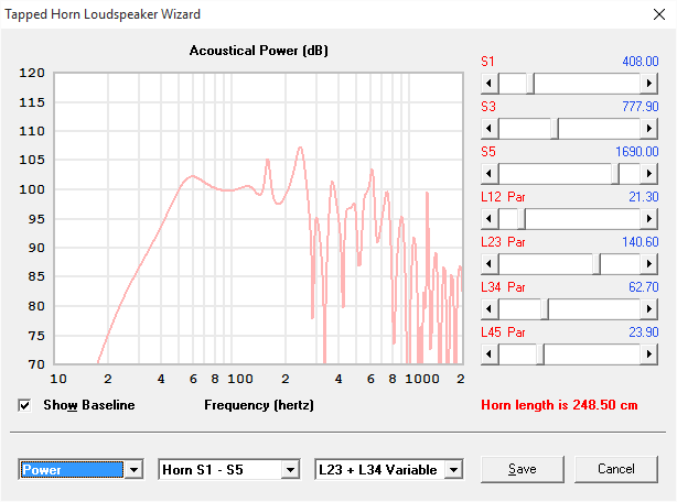

I have simmed a couple of drivers in the past.
Large view
The drivers in the above sims are cheap (100 euro) and very expensive (480 euro)
I settled with the Oberton 15B500, you can get them for 100 euro if you buy more than one. You can use a 400 euro driver for 4 or 6 db extra. But the tham15 shines in multiples. You should build at least 4.
In a stack of 6 (3x3), you can reach 140db in the 40hz - 170hz The dip and peaks in the upper bands are virtually gone. With some EQ tweaks you can reach 250hz. They are lightweight and small and easy to transport, in comparision to a TH18 for example.
if you add extra side panels with handles cut out, and put wheels on the back. I find the tham15 pretty modulair and have a small footprint in the storage. Check out my gallery for handle option.
