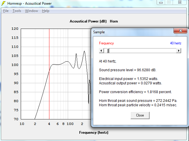

What's this POC5? That reminds me, I need to sim a few other drivers in the POC3, I like that design.
It's another "proof of concept" design I'm working on, using what I learned from the previous POCs, i.e.
1. It won't be an "underdamped" (HornResp) alignment. It's been suggested here that designing for some ripple in the HornResp sim would result in a better response. My experience has shown it to be not true, at least as far as my preference is concerned. POC#2 had over a dB of sim'd ripple at the lower end of the passband, POC#3 had less than half a dB, and POC#3 sounds MUCH better.
2. No major suckouts between 100 Hz and 200 Hz. Again, sounds much better.
3. Slowly rising response from lower cutoff frequency: This seems to be feature of many pro audio subs. My last POCs were designed for a flattish passband. This one will have a slow rise instead.
4. Cone correction. This was not included in POC#2 and POC#3. It worked well in POC#4, so I'm going to use it in POC#5
The sim shows where I am at the moment with the design. I have to work on it a bit more. Box size is a bit too large (I'm shooting for ~150 or less) and lowest resonance frequency of 42 Hz (so I'm giving up a bit of extension for SPL).

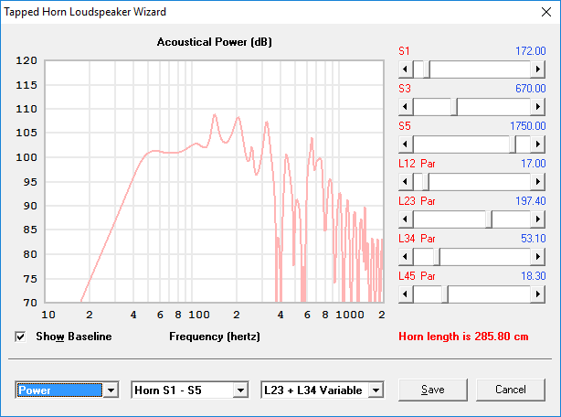

Looks nice! PA box? Hope progress goes well. Struck out on different drivers in POC3... That said, threw a 15TBW100 in your 2.2 design in this thread and I will be a SOB, it hits 97db @ 40Hz. Gets LOUD too. 130db to xmax/87V. 6db over my KS loaded with LAB15-4... 😱
Why cut off the low end like that?
The whole point of a cabinet this big is to get useful loading down to around 40Hz. Stopping at 70Hz is, IMO, a waste of a lot of potential. You could tune to around 70Hz and gain a lot of SPL and make the cabinet much smaller to boot. Sure, the THAM15 will work like that, but its like using a big lorry (truck, in the US 😛) to move your food shopping. Sure, it'll work, but you could do so much more with the THAM15.

Thanks Chris, But the tham15 is 'small' in my eyes and i was thinking of stacking 8 or so per side where four/or 6 of them do bass and 2 or 4 of them do hi-bass mid-bass. They have different drivers, one more oriented to lower bass duty and one for upperbass mid duty.
Like you said, you can do much more with tham15 😉

In any event, with Brian's POC5 (rising response) it might be possible to achieve both decent low corner AND mid bass response. Seems to me that cone correction really helps the mid bass.
I agree Zwiller, I have Community TFR64 horns but I was fiddling with the tham15 sim and seeing it can somehow be useable to 250hz or so maybe I can do half/half with the same bin and some EQ. I quess I have to test it in practice and do some measurements.
