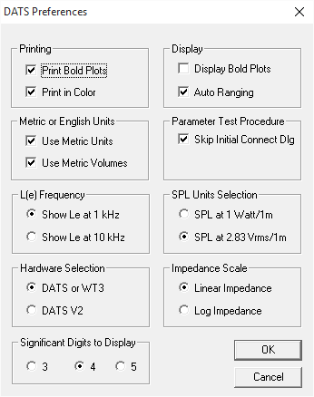

why does DATS list (10khz) next to LE? Isnt this suppossed to be measured at 1khz?

just seems odd, and would explain the seemingly consistent "lower than normal LE" I've seen posted.

DATS can be configured to display Le at 1kHz or 10kHz under the "Preferences".
I use the 1kHz setting for subwoofer duty.
there we go. mind reposting the LE value for 1khz?
I can tonight.
