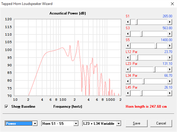

Since this is my thread, can I ask a (another) dumb question? Can anything be done to change the slope of low knee/F3? IE anyway to manipulate this design to get above 90db at 30Hz? No need to model or change anything, mostly just curious. From the HR wizard lengthening L34 helps. Not sure if that basically screws the entire design up or not.
Bedtime for zwiller :drink:
Fb for this alignment is just above 40 Hz. I wouldn't be concerned with anything below that, as it's likely to be accompanied by more distortion too.
If you really want to get more output @30 Hz, you'll need to reduce Fb without losing efficiency, which means making the box larger, and perhaps quite a bit larger, than it is right now.

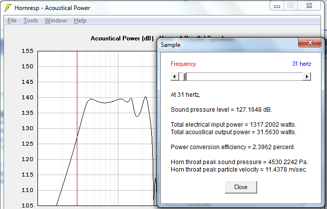

This is now simming much like Don's and a 4 pack is loud, flat, and digs quite low. 127db @ 31Hz BTW 😎 If you get the drivers on sale and eek out 4 cabs from 5 sheets of ply, you are talking 140db to 40Hz for well under 1k, more like $800 and alot easier to move for one dude...
Although I am more than happy where we stand and plan to build one, I would be curious if we could get creative later on and get F3 lower via cone correction/longer path with S1. I still think there's some magic there.

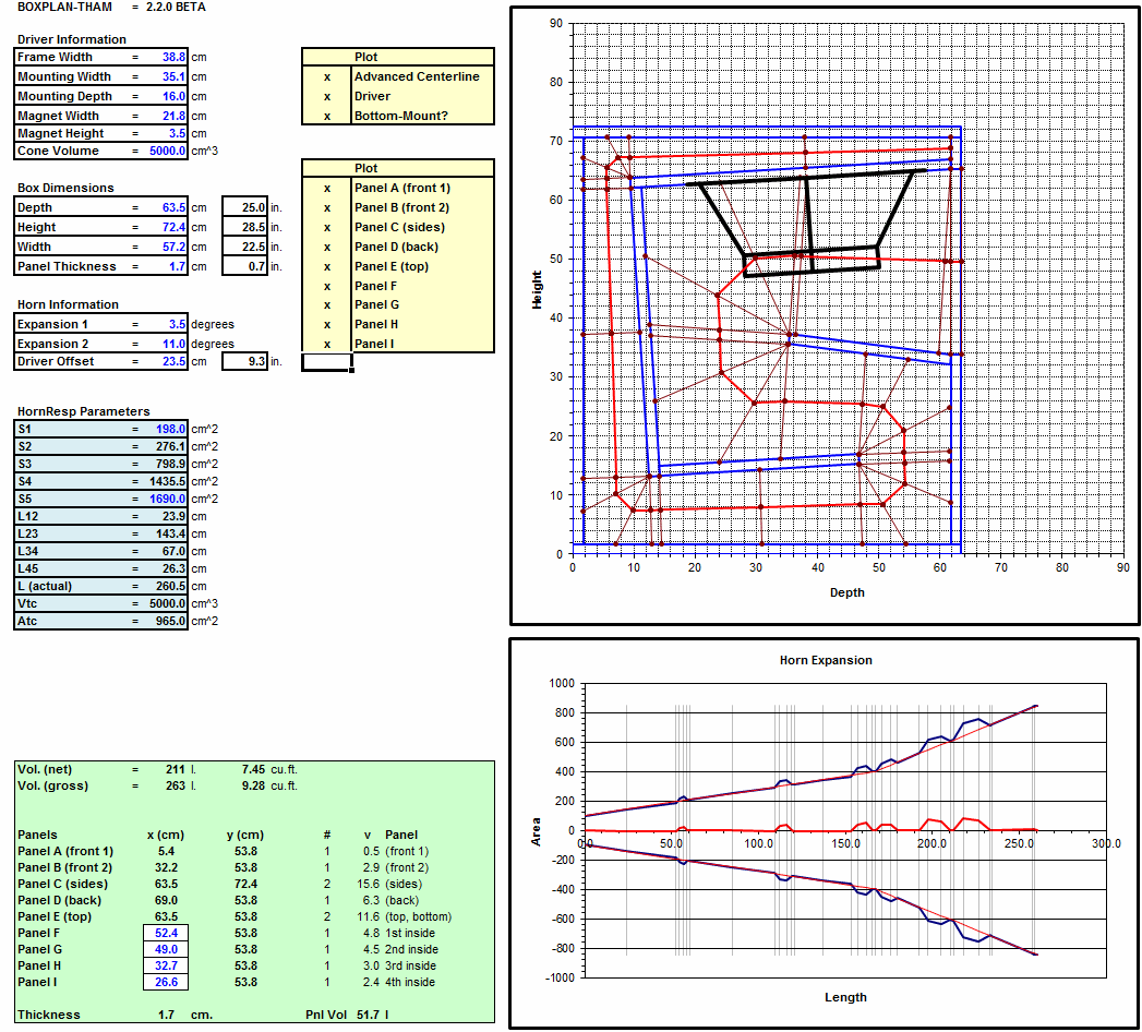

Just a few things:
1. There are two "THAM2" designs discussed in this thread - Don's original design, and my tweaked designs. My design has a higher CR (about 3:1 at S2) than Don's and the size is slightly smaller (it's shorter, and slightly wider). See illustration below. Don's version might be more suitable for drivers with lower motor strength.
2. AFAIK, none of these designs are tested.
3. I've assumed 5000 cm^3 of cone volume in my analysis. The actual volume needs to be calculated or measured. HornResp provides a tool to do this. The sim should then be adjusted accordingly. While it's Ok to under-estimate Vtc, over-estimating it will lead to a higher CR than expected and lower output in the passband, and you probably don't want that to happen in a PA bass bin build.
4. I've used the PA380. Given this design, I'd most likely opt to go with the PA385, or another driver with a sturdier cone instead. The PA380's cone is fairly soft, and it seems more suited for 2-way or 3-way tops rather than subwoofer duty (says the guy who deployed them for the latter purpose, LOL). JBL/Infinity folds over the edges of the cones for their car audio subwoofer drivers, which stiffens them up considerably - it's strange that this feature hasn't shown up in high-power PA subwoofer drivers yet, as it's a simple but very effective solution.
5. 17mm ply is assumed for the build. If you use something different, the design will have to be adjusted. And that's the beauty of having this design described by a spreadsheet - it makes those adjustments a lot easier 🙂
6. The mouth is fairly large wrt the driver, which is a good thing. As the mouth size decreases, the impact of the driver's volume is greater, and could account for the drooping response at the upper end of the passband in the measurements of the original THAM, which has a smaller mouth.

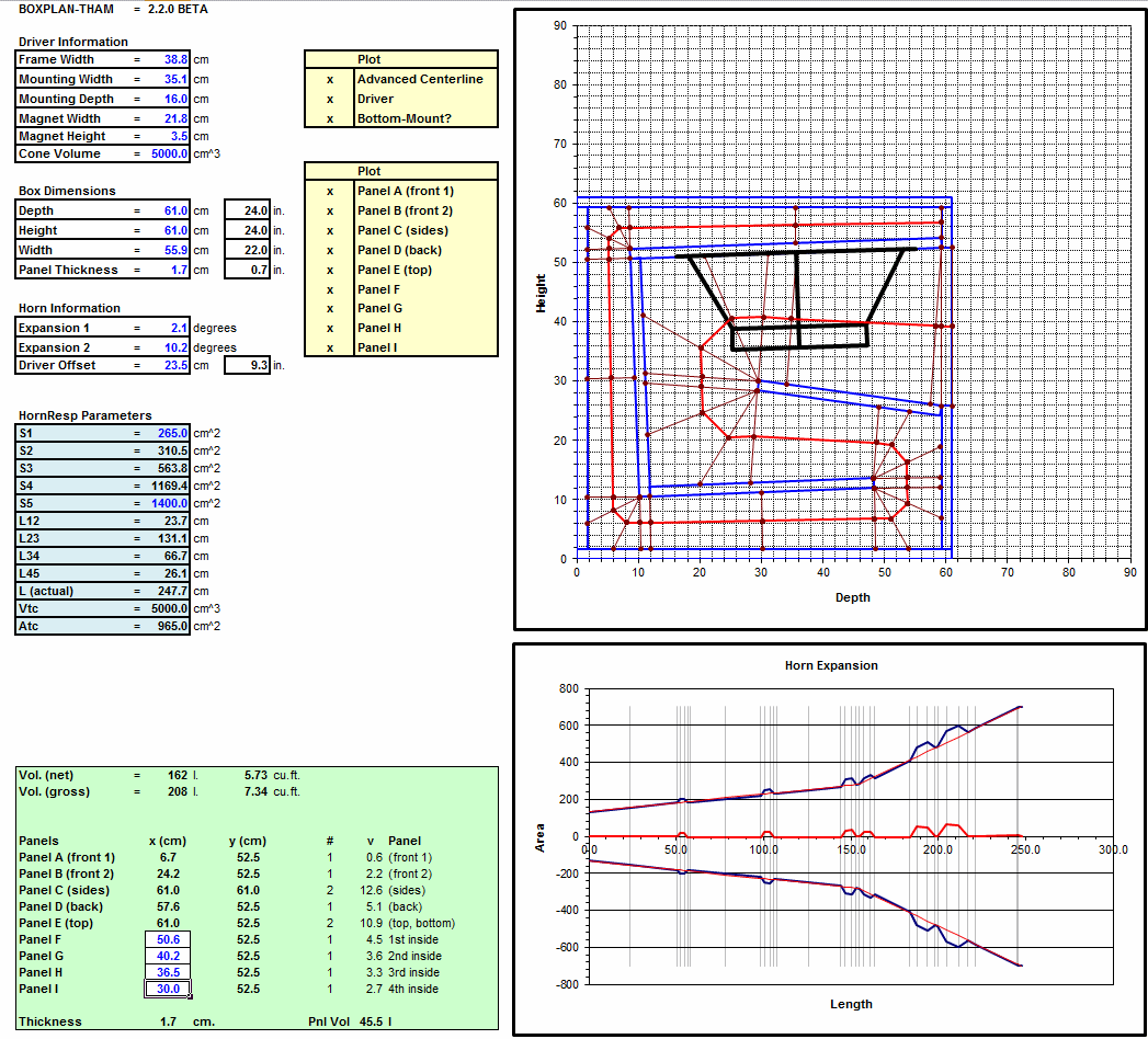

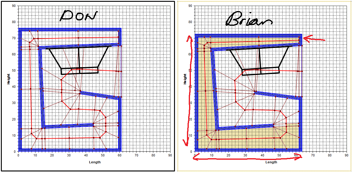

Ok, here's a minor update that keeps the top and bottom panels the same width as the internal panels. This makes cutting them out a lot easier.
BTW - what's everyone's favourite cut-sheet program? I think it would be interesting to see how close this design is to a single-sheet one.

I'm wondering how much Don's design can be "squeezed down" to approach the 187L volume of the THAM15?
Here's something I came up with that's partway there. Box volume works out to 208L. The response is sloping upwards, but I'll bet that the measured response will show less of a slope, if any at all, because now the driver's size is likely going to start to have an impact. This design also has an Fb of around 42 Hz, so a mild boost can be applied at or slightly above there to flatten the passband. Box dimensions work out to 24" x 24" x 22", which is pretty small...
I'm going to try to see if I can get it down to 190 L tomorrow, without sacrificing too much of the response.

Brian, thank you again. Specifically the same width panel change. I think this makes construction a bit more forgiving too.
