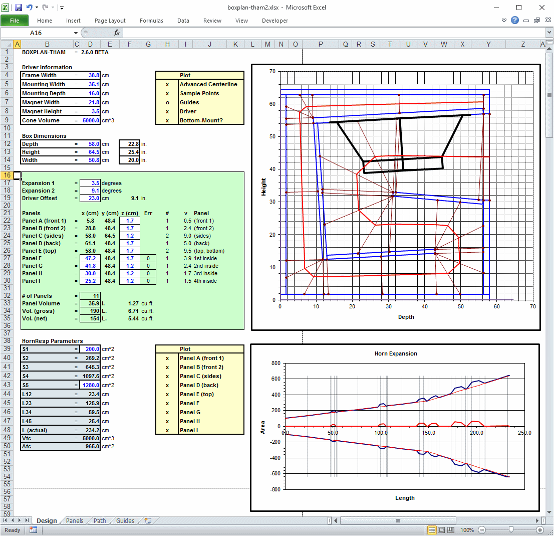

The beauty of using a spreadsheet for this is that you can easily change the panel thickness and adjust the layout to compensate.

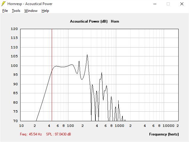

Now, if I am following most of this correctly, martinsson basically got 100db at 46hz with the THAM15 at 190L so surely he can get 100db at 40hz with increasing the THAM15 cab 42%, right? 😀
Anyway, here's where I'm at now. The above and THAM15 is 190L, SS15 is 228L, KS is 350L, XOC1 is 460L (wow, didn't realize it was 100L over KS). In any event, Don's is in between at 260L. I was hoping to get something in between the popular compact and big cabs.

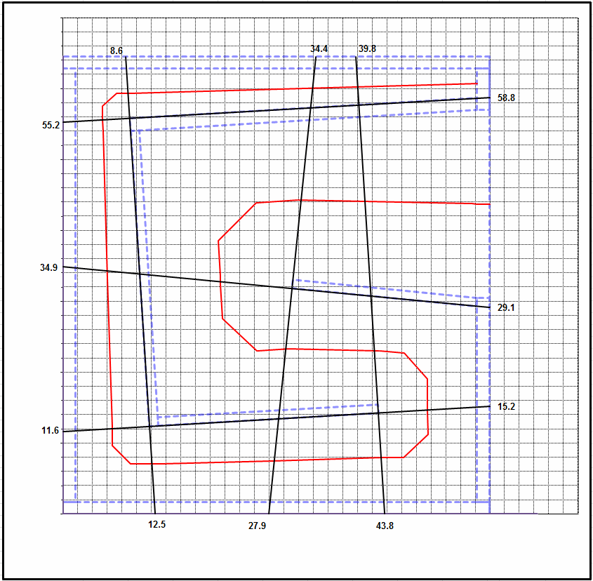

...and here we go - a modified layout using 17mm panels for the top, bottom, front, back and driver baffle, and 12mm panels for everywhere else. Same external volume, but now we have a bit more net volume to play with.
It should be possible to get even more internal volume by replacing the back panel with one that's 12mm thick, if you're brave enough to do so 🙂

I was using system volume in HR schematic diagram but just checked it against the 190L sim and it is 145L... Is this internal or ?

Hmm... I just realized that my spreadsheet is missing the "guide lines", which makes laying out the panels during the actual build a lot easier. You basically cut the side panels out, draw the guide lines on it, then start fastening the other panels using those guide lines as, well, guides 🙂.
Oh well, next version coming up in an hour or two 🙂

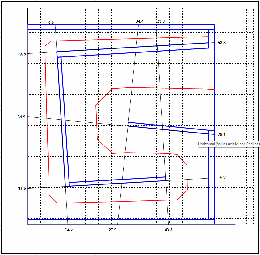

...and here are the guides. This is for the last version discussed. The spreadsheet will automatically recalculate them as the layout is changed.

That's a start, now how about the complete drawing in side view with even mm's, as per international standard, although I realize it is at an early stage, but remember, this, given the same constraints as the THAM15, should be even "mm" and "deg", this is where it gets tricky, no disrespect intended, at all, quite the opposite, I like this a lot, that's why I'm coming across as a bit of an obstruction I guess, it's all well intended, designing a good cab without this in mind is a lot easier.
That would defeat the whole purpose of my activity here, to provide a spreadsheet that allows some flexibility in the design, and can run on almost anyone's PC. I'm not interested in producing something that's static and inflexible, like a full CAD drawing which can't be modified unless you have access to a CAD progam, and it doesn't spit out the corresponding HornResp parameters anyway. 17mm panels not available? Adjust the panel thickness in the spreadsheet, adjust the lengths and volumes until you get a smooth expansion curve again, then the corresponding Hornresp parameters given in the spreadsheet in your sim to see what the results would be like. Want to see what the results would be like if you increase or decrease the size a bit? Same approach.
Also, the spreadsheet avoids the whole "degrees" thing by providing guide lines - basically you cut out the side panels, draw in the guide lines as indicated in the spreadsheet, then use those guide lines to lay down the rest of the horn. The spreadsheet also gives the dimensions of all the other panels that need to be cut, and their quantity. My previous spreadsheet like this even included a table that automatically laid out the steps to take in the build, something I might include in this one as well at a later date.
Again true, but this eliminates all builders without HR & / or CAD knowledge, if you strive for a simple "build and enjoy" design this might be asking to much, not all potential builders out there are as "damaged" as us populating this forum 🙂
But that isn't the target audience of this spreadsheet 🙂. It's targeted at those who might want to tweak an existing design to get better results with a particular driver, panel thickness or even box dimensions.

I would like to give it a go if it is available, out of curiosity, can you set the angles? and panel lengths? or is it a folding that adapts to a certain volume constraint ? either way it's very impressive.
I've attached a copy of the latest iteration of the workbook. Everything in blue on the "Design" spreadsheet can be changed. If you make any changes, then your aim should be to remove any discontinuities in the horn expansion graph (you can use the "Err" figures as a guide - try to reduce these all to zero).
