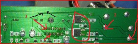

Can you make sure on that... pin 4 sounds wrong. Any laquer on the PCB can make it difficult sometimes to get a reading as it's an insulator.
That middle pin is coming in at 0.53V, really pushed hard to make sure connected as well as possible
You sure 🙂 0.53 volts
and pin 11 is at 10 or 11 volts. That pin is opposite pin 4
Pin 4 sounds wrong in that case... would expect -10 or 11 to match the volts on pin 11
Mooly just checked again, and whether is 4 or 11, one of them has that reading, I checked the other chip at the same spot, same 0.53V and same high voltage on otherside, light got brighter and little crackles came from woofer when fiddling with the other chip...

Something odd going.
Normally the opamps will run on a -/+ supply just like the main power IC.
It appears the negative rail is missing and I can't make out from the piccy where it goes or comes from.
You mentioned another board. What you need to do is switch off and trace on ohms pin 4 from the opamp and see where it goes... if it connects directly to the other pin 4's on the other IC's then trace from there. I would expect to see another part of a power supply somewhere to provide these rails perhaps with regulators.

Anyway the clue now is the missing rail on pin 4. Try and find where that is derived.

On the first piccy you posted where I labelled points 1 and 2 if you look at the PCB print from those large caps there is a spur running off to the left of the piccy along the top of the board. Think there's another spur running below it from the other cap.
They dissappear off the piccy at the left, but these will go to the regulators for the opamps etc so that's your clue... trace the -30 volts and see where is goes on that spur.

Have a look at this picture... I'm guessing the -30 volts goes to what I think will be a PNP transistor where I have marked A B C. I also notice the print "looks" discoloured... and you smelt burning.
What we will never know now is whether there was ever a problem with the output stage, or exactly what has happened. This front end is isolated in a way from the power stages, whatever happens there shouldn't affect this part of the amp. So all we can do is put right anything we find.
Can you measure the DC volts on A,B, and C. If I'm guessing the circuitry right from the picture then I would expect,
A. -12
B. -30
C. -11.4
Assuming I'm on the right track from the piccy then the glass component is a zener diode of 12 volts rating. If you measure the volts across the one next too it then that should also have +12 volts across, with +30 on the middle leg of the transistor and around +11.4 on the lower "leg". I think the transistor and probably zener are zapped... failure of the transistor would destroy the zener... however if there is -12 volts across it (point A) then it's OK. That leaves you with a zapped regulator transistor. Did it jump or was it pushed ? the only way to know is repair and see what happens with the possibility there may be a problem on that rail thats seeing the regulator off.
