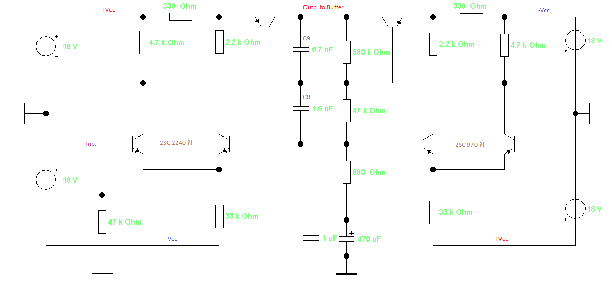

First of all, I would correct the time constants of the RIAA negative feedback network, which are quite misaligned.
The following deviations are present -6.145%, +1.634%, -2.153% in relation to the normalized three frequencies.

The deviations mean
in relation to the reference level at a frequency of 1kHz, the fundamental tone becomes more prominent; all in all, a relative band of +/(-) 0.61dB to -/(+) 0.18dB remains. In between lies the present dimensioning, mathematically.
This is actually still within the limits. The optimum ratio of C9 to C8 is 3.6... for R29 to R28 is 11.77... with 75µsec = R28 * C8 and 3183µsec = R29 * C9.
Perhaps the nice 5100pF and 1500pF cylinders were selected, measured in each case, so that in combination with the original carbon film resistors (tolerance +/- 5%) they are in the alignment of +/- 0.5dB.
Decisive resistors have already been exchanged and the two 36.5kOhm guys replaced with 500µA current sources / sink. If you change too much now, you might as well set up a new design with a slightly modified topology.
What else can you say? The fun factor and the joy must remain, on the one hand hard emperie and knowledge, on the other hand the famous snake oil. Both are perfectly fine.

Illustrating numbers, quick shotI did however match the 51.1k and 665kOhm as close to the schematic as possible when replaced with Dale-resistors.
C9 = 5.1nF
-> 624.137kOhm, 1.4166nF, 52.944kOhm
C8 = 1,5nF
-> 50kOhm, 5.4nF, 589.463kOhm

For the brave I'll add a quick thought,
the standard E12 series and the elimination of frequency compensation around Q6 & Q5 were leading thouhts.
How to approximate C9 and C8 remains an open question. But under no circumstances would I dismantle this beautiful EQ now.

@hbtaudio thanks a lot for the insight. I can't do this math, so very interesting indeed.
DIY is so much fun, but I'm always afraid of destroying the sound that made me solder the unit in the first place for further performance. It happens i go all in, but not always.
That said, I really like the sound form the Acurus RIAA, and thought that some small adjustments would raise performance, and keep the basic signature. And so it did.
I meassured the Vdrop across the 36.5kohm before pulling these to 468μA, and adjusted the CCS accordingly to 470μA. So quite safe investment with the CCS for now.
-But, looking at your calculations, the swap of four components would be interesting and easy to try, but I'm a bit confused how to read your suggestion:

"C9 = 5.1nF
C8 = 1,5nF
-> 50kOhm, 5.4nF, 589.463kOhm"
If I understand correctly, if C9 remains 5.1nF, then the following circuitry should be ~624kOhm, ~1.4nF and ~53kOhm. Correct?

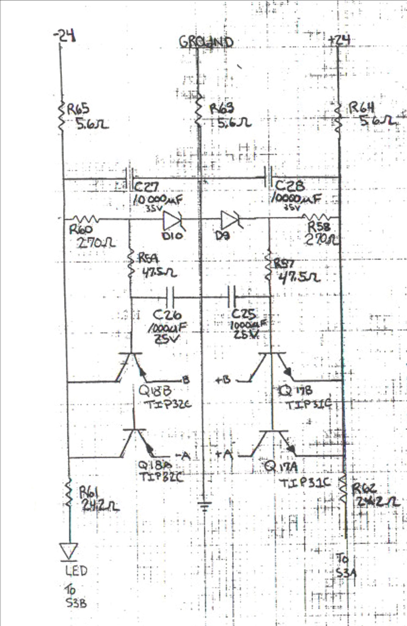

@hbtaudio For a brief moment i thought it was "Ken Early Audio" speaking behind the username. He would write exactly in the same manner. Something like; "Keep things in perspective, why do it need overkill, when a more straight forward solution is right around the corner"
I've owned a build of his. The most musical preamp I've had to date, yet so simply build within specs. Respect
Hi. I just stumbled upon a 47k in my neighborhood here in Norway and I’m thinking about doing some mods like some of you have done.
A question.
A read somewhere that the IPS and Ingot power supplys are the same but with larger capacitors in the ingot.
10000mF I think it was.
Is that correc? Has anyone tried that?
A question.
A snapshot from the Aurum Ingot PSUA read somewhere that the IPS and Ingot power supplys are the same but with larger capacitors in the ingot.
I included the full schematic of the Aragon Aurum to get the full picture off the PSU, including the CRC stage.
