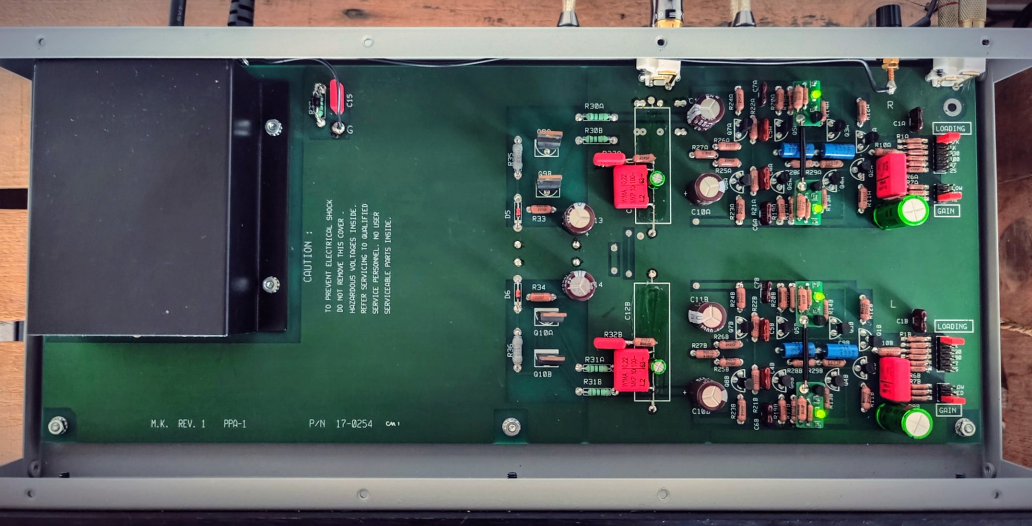

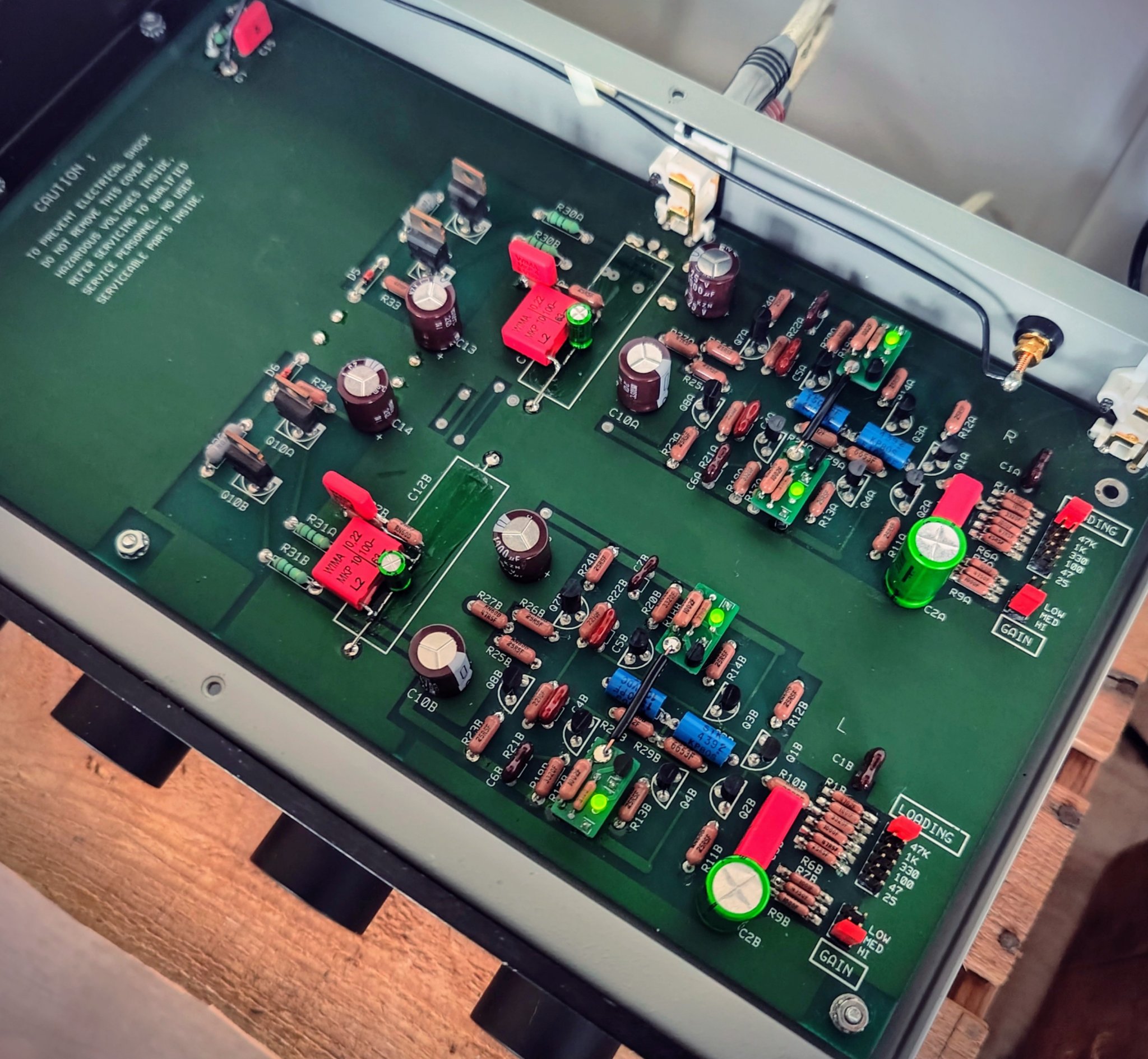

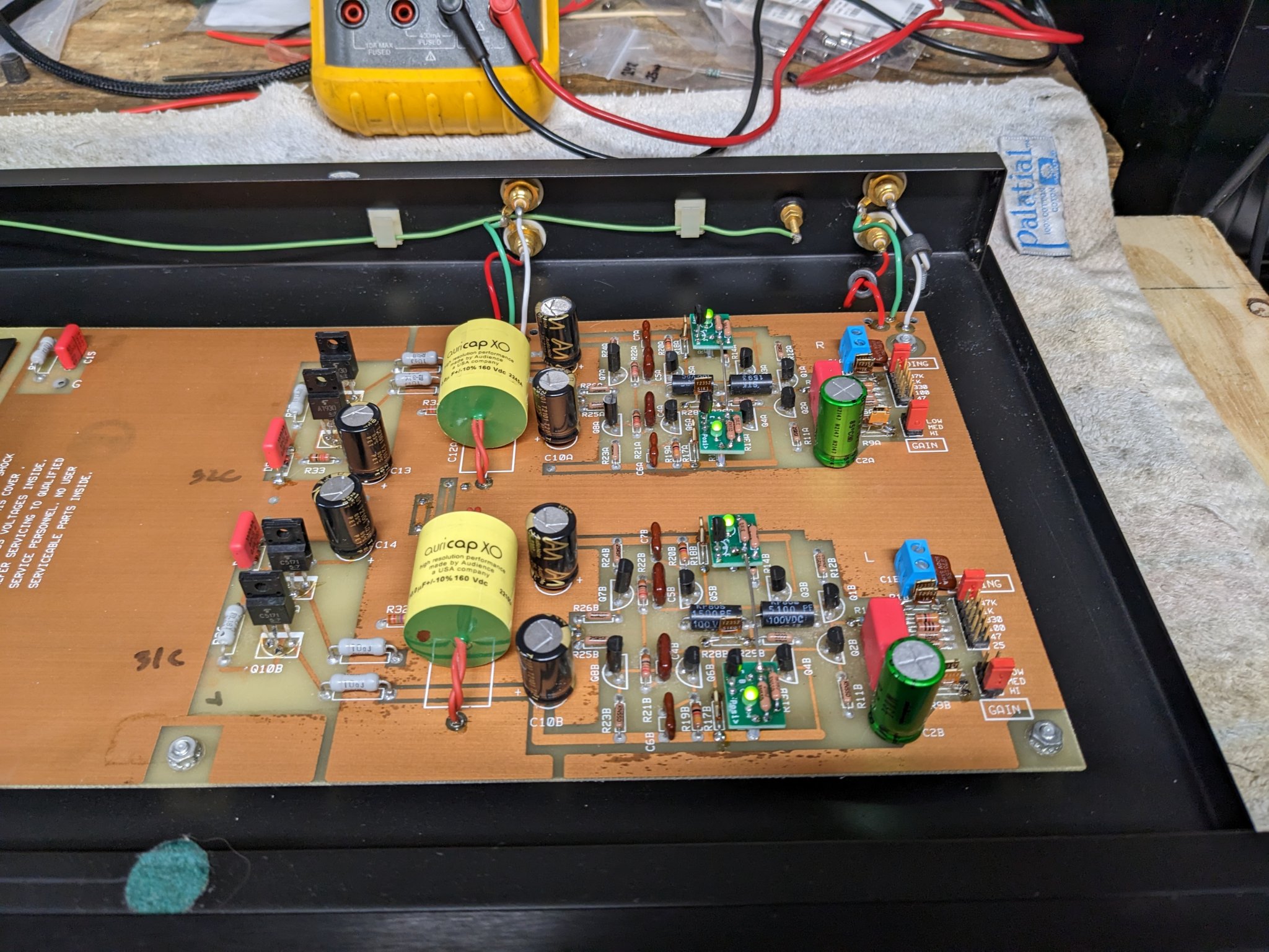

Okay, I am not a DIY'er but I know someone who is and I figured people may be interested in seeing what the esteemed Kevin Chambers has done to my unit. And apologies to @mondialfan ahead of time if I have lost something in translation. I'm sure he'll point out my mistake(s).
This particular unit was not operating, and I picked it up for cheap ($175 IIRC) which gave me some headroom to add fancy parts. Had the seller ship directly to KC.

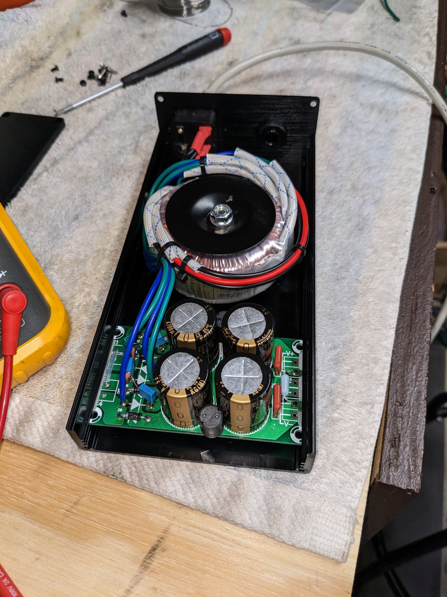

Turns out the original plastic Aragon power supply was kaput in one channel, so I had Kevin work up a custom unit to pair with the 47K (Bonus: This can work with any Aragon unit that used the 3-pin XLR power connector, including all Aragon preamps).
Kevin's custom supply uses a 30VA transformer and we went with premium Nichicon KG audio caps in the PS since this is basically an "all-in" build.

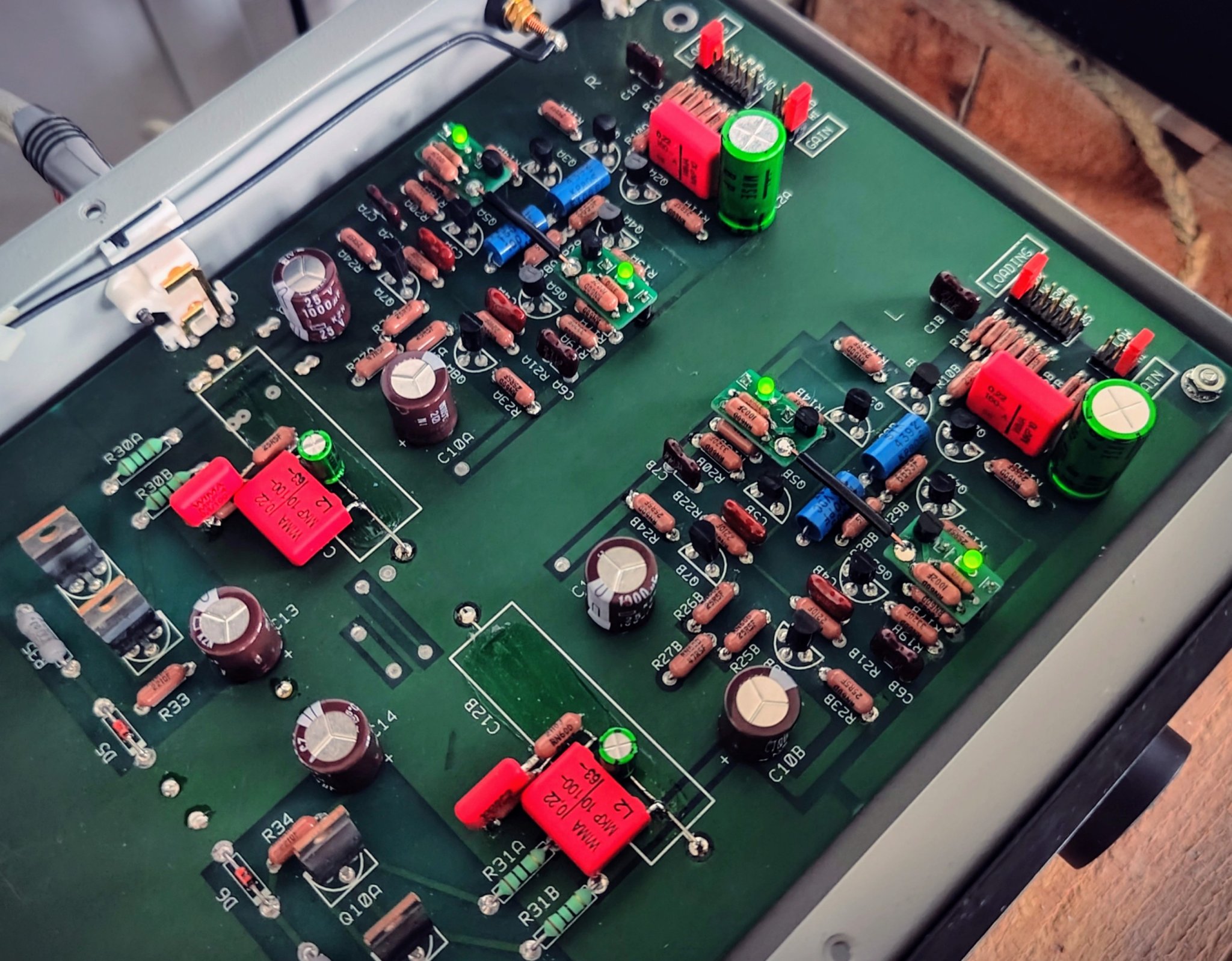

While the 47K comes with really good 1% Dale resistors, a way to raise the bar was using Z-Foils, which we (he) did in many places. We upgraded the coupling caps and most everything in the preamp (except for the RIAA stage, which Aragon spec'd pretty nicely).

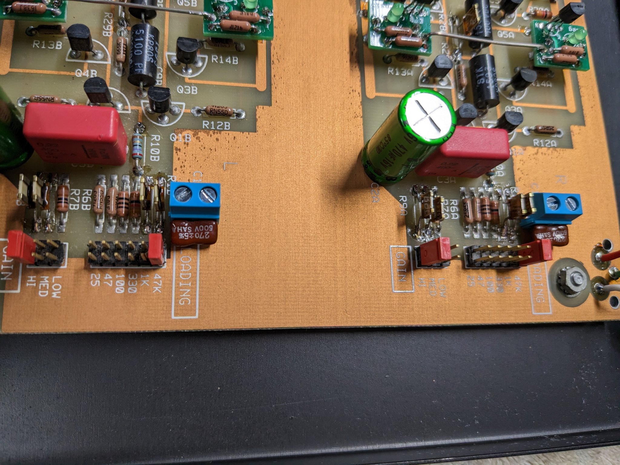

Now I am still learning about turntables and cartridge loading, but the original 47K design as a single 270pF capacitor. Kevin mentioned that he thought he could come up with something more precise, so here's what he came up with...
He decided on a 2 terminal mounting block (the blue colored ones in attached pics) for the cartridge loading capacitor. The original 270pF mica caps are loaded in the terminal blocks for now. The blocks will allow me to take off the cover and, using a small screwdriver, loosen and change the loading capacitor out to any value I choose or remove it altogether to run a cartridge unloaded with only the wiring capacitance as a load capacitor. (It's hard to see the Z-foils but they're all in there).

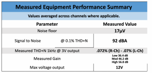

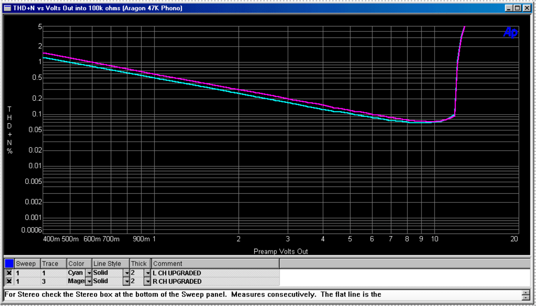

As far as the rest of the upgrade work (In addition to all of the capacitors and resistors we used), Kevin ended up installing higher performance transistors into the voltage regulator circuit and adding additional film bypass capacitance to the regulator circuit as well to improve its performance. He also used a set of his current source boards for the differential input circuitry and had to customize them for the higher current used in the 47k phono.

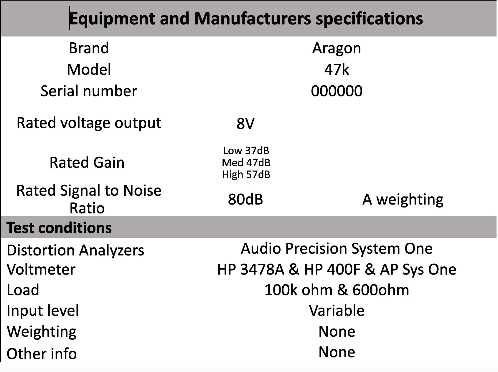

Overall, Kevin felt like it should make for a very nice unit. Based on the new specs and how it measures compared to the original factory specs, he is 100% right. Measured signal-to-noise ratio has been improved 12dB! This paired with my very quiet Performance DC turntable (90+ dB manufacturer specs) should hopefully make for some incredibly black backgrounds.

Not to rip up an old thread, but thought I wanted to share my build of a restored P10 and might inspire others🙂
In this unit I replaced the 1A diodes with 2A ultra-fast soft-recovery in the PSU and skipped the 5VA transformer in favour or a 10VA. This is the maximum that'll fit beneath the internal metal lid and require some drilling to the PCB.
The 3.300uf e.caps are replaced with 105°C 4.700uf Vishay MAL-series. All 1000uf's has been changed to the better spec'ed Chemi-Con KNZ.
I've used Dale RN55D/RN60D throughout in the circuit, only resistors that's still untouched is the 2 watters..
I've pulled the foilcap and replaced with Nichocon Muse and a 0.22u Wilma MKP10 in parallel. This was due to the internal PSU, and I wanted as low distortion as possible in a sensitive circuit, so the big yellow had to go. Sound wise I cannot hear the difference between the 10u/.22u vs the foilcap.
Looking at the Aragon preamp-series they all have a zobel filter at the output and anti-parallel diodes at the ground lift witch non of the Acurus (or Aragon 47K) had. I added both in this unit.
On top I skipped the R15/R16 and replaced them with constant current sources to the diff-section.
Its an excellent sounding unit.
