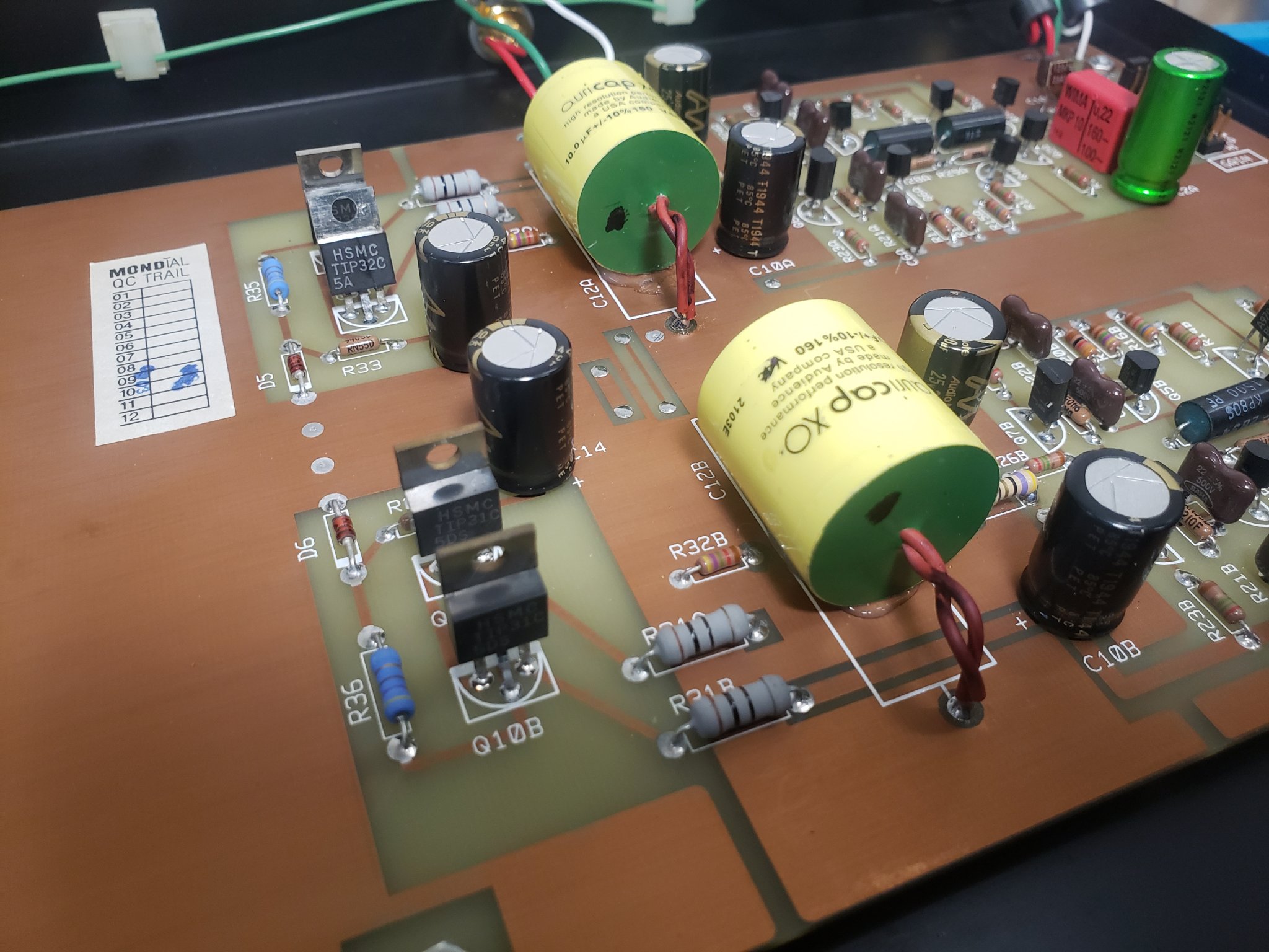

I hope you aren't including the 470uF C3 in the 1200uF 'upgrade' -- you know that'll lower the low frequency roll-off by something like an octave and a fifth. May not be the wisest choice.

No worries Rick. Yes I'll do that. Yes. I am keeping the C3 at the OEM 470uf value. Thank you for checking me on that though!(response to post 40) Bless you and your compatriots -- a noble effort keeping the boutique capacitor factories in business.

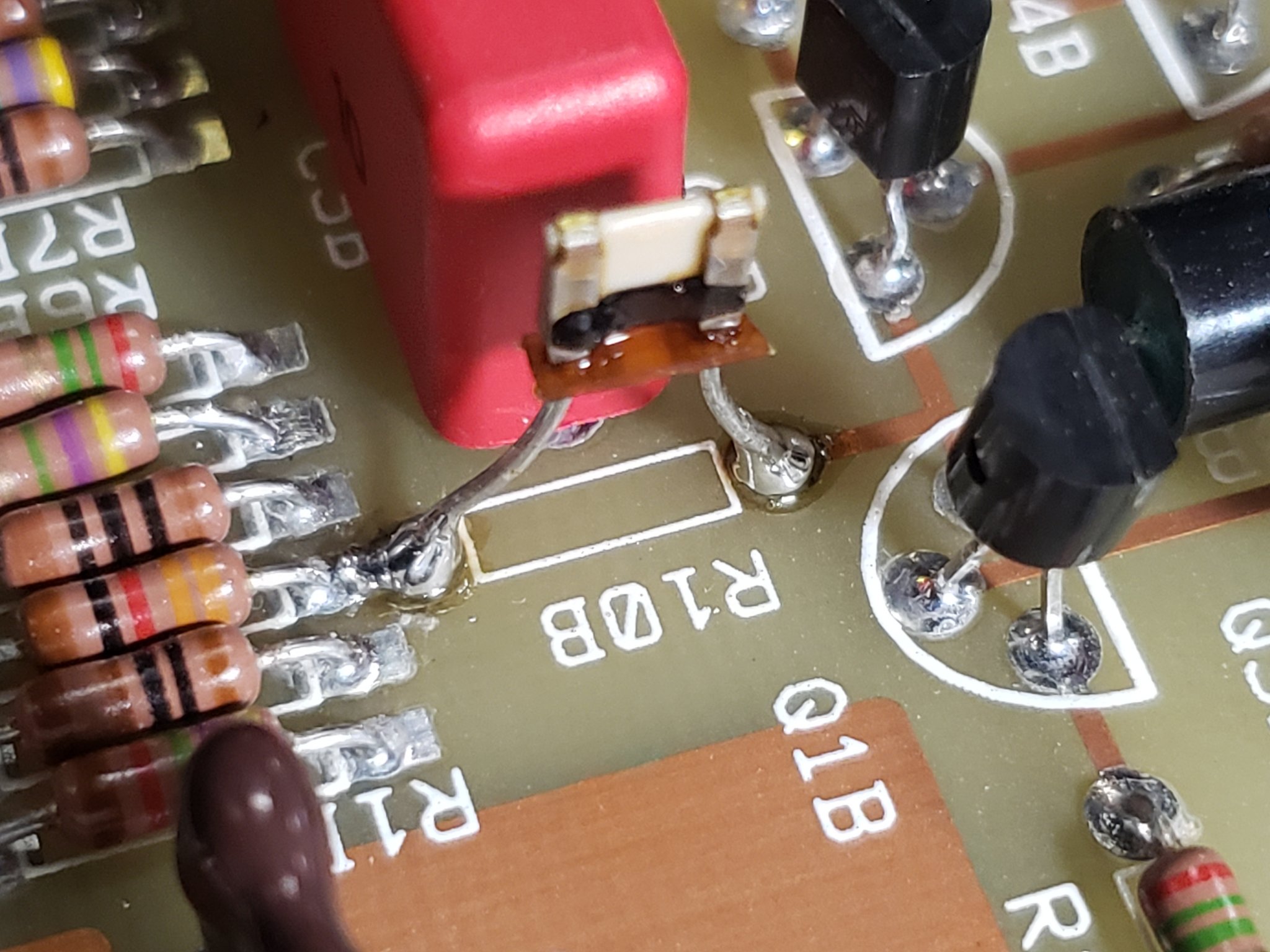

In contrast, R10 is the first resistor in series and IMHO a carbon comp vs a Vishay Z-Foil in this position would greatly impact the overall sound of the circuit would it not?
The overall sound? Are we talking Johnson noise, or something subjective? As the value is 25 ohms, the Johnson noise is going to be very, very low as the resistor value is so low. Now if it were a 2 meg resistor, absolutely, changing that to something low-noise would likely be audible… but the noise of a 25ohm resistor is going to be so tiny regardless of composition it will be totally inaudible.
Am I missing something?

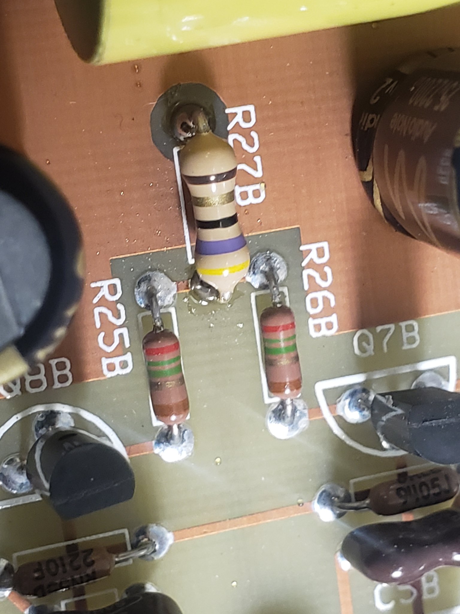

Its the best quality (for this application, that I could find) because it's a USA made Metalized Polypropylene capacitor to replace the 30 year old oem polyesters and conforms to modern standards of testing and construction, including MIL-C-55514A and MIL-STD_E method 103B testing. Additionally, Audience has been making capacitors for over 20 years now. They are well accepted and reviewed by thousands of users and I appreciate the attention to detail such a taking the time to mark the outer foil of capacitor.
Moreover, I don't consider them boutique or do I consider the price exorbitant. One could easy blow more on a McDonalds meal (or two) for sure then a couple of XO Auricaps. Your comments are ridiculous.
We're talking about a $100 or so in parts cost to upgrade a phono stage purchased used for couple $100 bucks to make it comparable to new phone stages that now cost thousands of dollars. I hardly think that is a "wast of money" grin. Look, if you think your few NE55xx stuffed in an Altoids box with some disk caps is all your ears and time is worth then go live the dream.
So, to summarize. I finally completed the said mods a few weeks ago (things move slow around here). I'm overwhelming pleased with the outcome. One should consider this before dropping $$ on a Parasound Halo JC 3+. What was immediately noticed after the modifications was an overall increase in transparency and dynamics to music. A noticeable congested sound was removed and there is simply more "there" there. I have two units one modded, and one OEM, to easily compare. Additionally, the unit should be good for another 30 years. Two .01 Solen film/foils were added as bypass caps to the XO, and of course all big power supply caps and the IPS were upgraded. In retrospect, If I was to do anything different i might utilize a 2w AMRG at R27 in place of the 0.5w Audio Note Tantalum. I also noticed that the metal cover (inside) covering the power supply caps as well as the capacitor at C3 tend to be microphonic but only as a signal is active. One can verify this by tapping on the lid and the capacitor while playing music. It doesn't seem to do it while muted or no signal present regardless of gain. Here are a few pics. I've also documented the mods on you tube to help anyone who would like to try the same/similar. Happy Audio.
