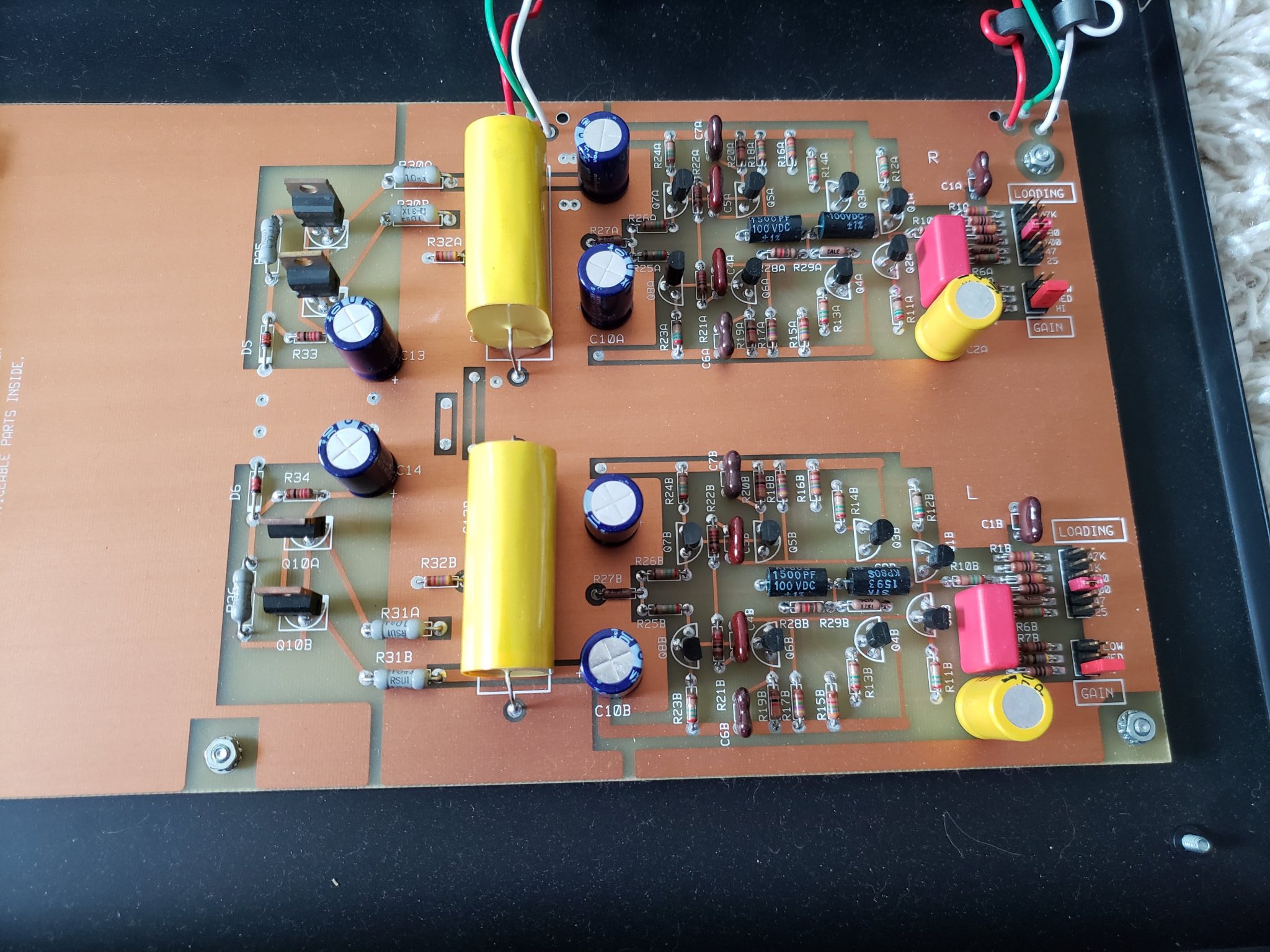

Respectfully, Why would C1 and R1-6 impact sound quality (other than the possibility to induce noise into the circuit) as these all go to ground? 🙂
That's why I suggested that you study the "voltage divider" concept.
In fact, they will all have a substantial effect on the sound of the cartridge, because the signal voltage
at the preamp input depends strongly on how those parts interact with the cartridge's internal impedance,
through voltage divider action. Why else would there be a range of choices for the cartridge load resistance?

This is a discrete op-amp with RIAA feedback. Everything has a role to play, and there are reasons for each value. Perhaps you need to read about op-amp internal operation. Your discrete op-amp is symmetric, but that is not necessary and a mixed blessing. If you just want to make a phono pre-amp, pick a decent op-amp and add the feedback network, input resistors, and maybe the output build-out resistor. If you use a bipolar supply, the output cap is probably not necessary. The "signal path" in any amplifier is a series of current loops where the decoupling capacitors are just as important as the transistors. Each transistor is part of two current loops.

Hi Steveu, Thanks for the reply. I probably should read up on the internal operation of op-amps however the Aragon 47k is fully discrete there are no op-amps in the unit. I understand that "generally" everything in the circirt "makes a difference" my orginal question I posed to the community (I'll re-phrase) is "which (in series) resistors/capacitors (outside of the RIAA) are most likely to impact sound quailty in this circuit?" Let me give an example, The first input resistor R10 is RN55 1% dale metal film. If we replaced this resistor with lets say an old Allen Bradley style carbon comp resistor It might not be the best choice as carbon comp resistors can be a bit noisy right? And, since R10 is very early in a low level circuit one would then assume all that noise would be increased by the later gain stages (bad right?). However, if we replaced R10 with TX2575 series Vishay Z-foil (a resistor known to be exceptionally low noise and very transparent) we might gain in the overall sound quality and reduce the overall noise in the circuit. I'm really puzzed why no one seems to be getting this. 🙄This is a discrete op-amp with RIAA feedback. Everything has a role to play, and there are reasons for each value. Perhaps you need to read about op-amp internal operation. Your discrete op-amp is symmetric, but that is not necessary and a mixed blessing. If you just want to make a phono pre-amp, pick a decent op-amp and add the feedback network, input resistors, and maybe the output build-out resistor. If you use a bipolar supply, the output cap is probably not necessary. The "signal path" in any amplifier is a series of current loops where the decoupling capacitors are just as important as the transistors. Each transistor is part of two current loops.

So... for those who care. I've selected and received my components/parts for the Aragon 47k upgrade. Shout out to great people at Part ConneXion.
In summery I decided to make this upgrade non-exhaustive. In stead of repaing ALL of the resistors with Z-foils I'm just doing one pair. Here is list of changes in case you acquire one these incredible phono stages and wish to the same. I really consider this vintage of Aragon the "Shindo of SolidState".
Other then caps replacement to the outboard IPS power supply the following updates will be applied to the below pic of the stock/OEM board
1.) The two big 10uf yellow polyester output/DC blocking cap/s.... things.
-upgrade to MPP AuriCap XO, (10uf same value). I chose the AuriCap because it was the best quality cap that would fit in the same OEM footprint/area without looking ridiculous.
2.) Two big power supply caps (not shown) will be replaced with CDM381LX of same value.
3.) 6 small electrolytic caps will be upgraded to Audio Notes with increase of 1200uf per cap. Because I can.
4.) C2a and C2b ( the two yellow upright NP electrolytic will be replaced with MUSE NPs of the same value (green cap)
5.) The input resistors R10a/R10b will be upgraded to Vishay Z-foils of same value.
6.) The final resistors before the output caps R27a/R27b will be upgrade to audio note tantalum resistors. My choice here to is to add just a touch of warmth to the sound and avoid overly sterile sound.
