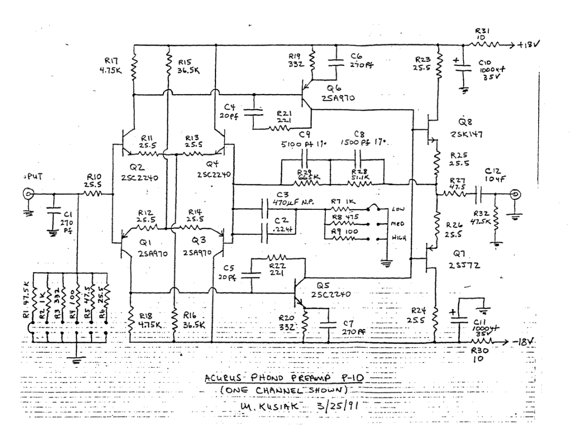

Help me understand this circuit. Aragon 47k/Acurus P10 Phono Stage
First of all, I would correct the time constants of the RIAA negative feedback network, which are quite misaligned.
The following deviations are present -6.145%, +1.634%, -2.153% in relation to the normalized three frequencies.
Sorry - but there are even more screws that have been tightened incorrectly. Of course, this only means that this phono EQ must sound fundamentally different from other representatives.
Without stepping on anyone's toes, because the PCB looks really nice, there's still room for basic improvement!

The deviations mean
in relation to the reference level at a frequency of 1kHz, the fundamental tone becomes more prominent; all in all, a relative band of +/(-) 0.61dB to -/(+) 0.18dB remains. In between lies the present dimensioning, mathematically.
This is actually still within the limits. The optimum ratio of C9 to C8 is 3.6... for R29 to R28 is 11.77... with 75µsec = R28 * C8 and 3183µsec = R29 * C9.
Perhaps the nice 5100pF and 1500pF cylinders were selected, measured in each case, so that in combination with the original carbon film resistors (tolerance +/- 5%) they are in the alignment of +/- 0.5dB.
Decisive resistors have already been exchanged and the two 36.5kOhm guys replaced with 500µA current sources / sink. If you change too much now, you might as well set up a new design with a slightly modified topology.

Is it a true story that Dan D'Agostino is the mastermind behind this phono EQ? I've liked the topology since the days of the Elektor SUPRA from 1982.
For the brave I'll add a quick thought,
the standard E12 series and the elimination of frequency compensation around Q6 & Q5 were leading thouhts.
How to approximate C9 and C8 remains an open question. But under no circumstances would I dismantle this beautiful EQ now.

@hbtaudio thanks a lot for the insight. I can't do this math, so very interesting indeed.
DIY is so much fun, but I'm always afraid of destroying the sound that made me solder the unit in the first place for further performance. It happens i go all in, but not always.
That said, I really like the sound form the Acurus RIAA, and thought that some small adjustments would raise performance, and keep the basic signature. And so it did.
I meassured the Vdrop across the 36.5kohm before pulling these to 468μA, and adjusted the CCS accordingly to 470μA. So quite safe investment with the CCS for now.
-But, looking at your calculations, the swap of four components would be interesting and easy to try, but I'm a bit confused how to read your suggestion:
(Quote)
"C9 = 5.1nF
-> 624.137kOhm, 1.4166nF, 52.944kOhm
C8 = 1,5nF
-> 50kOhm, 5.4nF, 589.463kOhm"
If I understand correctly, if C9 remains 5.1nF, then the following circuitry should be ~624kOhm, ~1.4nF and ~53kOhm. Correct?🙂

That's right,
I just wanted to illustrate the puzzle game.
Basically, there is nothing wrong with this product. What prompts us now to pick up the screwdriver and soldering iron? This question keeps me busy from time to time.
A defect (or a fundamental fault) is quickly repaired and explained, so it can't be that. In my eyes, two essential points remain. 1) I like the circuitry and the overall feel of the device. 2) I don't like the device or the product for reasons that aren't defined in more detail. In this case, I fiddle around with all sorts of things until I am reasonably satisfied. But often it is point 1, I am satisfied and perhaps even a little in love with the design (of the circuit). But now I have a fully developed product (with a certain number of units per year in production) without a superficial defect - what now?
In this case, I can't identify any defect or shortcoming. Yes, perhaps the well-known problem of the puzzle with the component values around the equalization network, but: should every manufactured device receive a special combination of suitable, measured components? Nobody can pay for that. As a manufacturer, I am therefore faced with a problem: I need a robust circuit and an acceptable alignment in order to survive and be able to produce at all.
I assume type 1 is getting to work. He wants to embellish his love a little more. What can he do if everything is actually in order? He can ensure better working conditions, slightly improve the power supply unit and replace various components with higher quality ones.
That's all you can and should do.
As a metalworker, you could of course think about various improvements to the housing or, as a designer, about the external appearance.
But there is very little potential for improvement on this device. The developer has done a great job. If you go too deep here, it is advisable to implement your own circuit.
Ultimately, it is a puzzle.

+12dB is huge, expressed as a ratio your SNR is now four times better than before the repair. In other words, the noise must only seem half as loud to you.
In the first post I wrote that there is room for fundamental improvements. Should I therefore go into all the possibilities that can be exploited and justify them (because without factually correct justification, we are only moving in the realm of voodoo or snake oil)? I don't think that would be helpful.
I have seen the power supply circuit on the net somewhere. Well, that could actually be implemented "differently". But for what reason? The present equalizer is not bad and I don't want to hurt it, i.e. tweaking must be well thought out and sensible. You shouldn't go beyond a certain point.
Apart from a repair,
there is only one reason for a new, better power supply unit (PSU as an example), namely to have developed and built it completely yourself.
The phono pre has a certain requirement profile for its electrical supply, if this is fulfilled, more is a luxury - "better working conditions for our love".
Perhaps you also have a personal prejudice against a certain implementation, which could also be a driving force.
