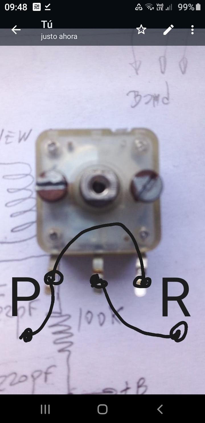

Ok. Thus return to previous value. And reduce the anode load resistor (100K) to its half, 47K.
My bad. Crystal fell out of its socket. I have -6.6v now with 27pf... should I continue and try with 22pf? Or even 10pf?
Plate is 102v now.
Should I reduce the anode resistor anyway?
I'm a bit lost with the gang... if I short both ends of the little gang (common and osc) I will short the gang, you ment the big end? Or maybee osc with big C?
P: plate. R: decoupling resistor.

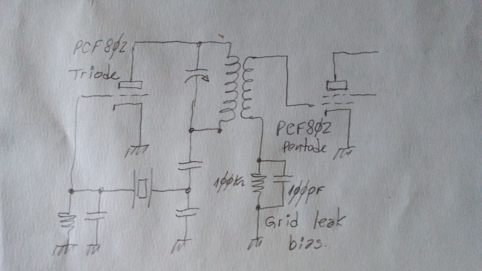

Ok. With care, take the tank off the cicuit. Make two new holes in the plastic tube diametraly opposite with those you already have, the same way. Thus, with the new wire make a secondary winding introducing the new turns between the older ones, same # of turns.
o O o O o O o O o O
Inner of the coil.
o O o O o O o O o O
O : Gross wire
o: thinner wire
(Never I dreamed making ASCII ART here)
Thus we will have a single tuned RF transformer tightly coupled. Coupling is a measure of the percentage of the magnetic line forces inside the primary that can be tranfered to the secondary. Usually it is identified with the letter K.
0<K<1. This means K may be between 0 and 1. Close to zero is a light coupling, like your receiver to the transmitter antenna. Your K will be strong, close to 1.
But K never is zero nor one.

Ok. That's the idea. The tank will be plenty of RF energy and we will borrow a bit of it to be given to the pentode. The secondary will be transfering the energy to the grid. It will act as a simple half way rectifier. As the load resistor and cap are grounded, the level of RF at this lower end will be low and the DMM happy.
Reactions: diy1995
Ok, so I remove the resistor and capacitor going to the pentode's grid, right?
As a certain amount of energy in the tank will be lost in the pentode's grid, the figures previously took may fall: triode's grid bias and plate voltage will be a bit lower, plate current will increase and the gang may requiere a different position. Because of the inductive and capacitive coupling in the tank, the gang may need to find anorher different value. All this is also a normal condition.

I made the modification. Now I had to connect the big C with small C on the gang because grid voltage would not go pass -2v
Now there is a fine line between working or not working. I have to set it just right... triode's grid voltage is -6.20v and pentode's grid voltage is -6.80v.
