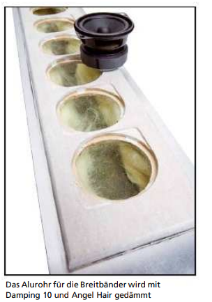

Also for alu profile, it say i should damp with 10mm behind array drivers and put glasswool on sides, to create a cavity for speaker array.
Rest of tube they fill with something called sonofill, which is some polyester mashup
In guide they said they closed off top part of tube, and bottom can be closed off aswell but they left it open.

For the aluminium you could use glass wool in place of the polyfill and close it off if you want better health. If you believe the open end would make a difference, try that first. You could close it later if otherwise

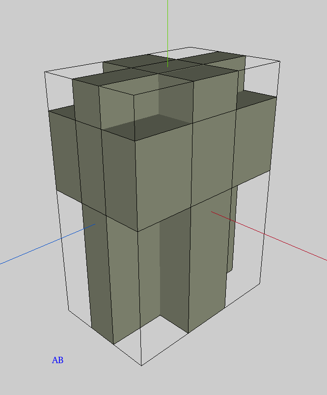

You don't need glue if you arrange them in a certain way. Below is a suggestion for a good concept but you may not need to get so fancy.

For alu tube, il just jam it in there, maybe glue thicker felt fabric to back side of alu.

For alu tube, place a thicker felt behind array drivers, and put glasswool on side and bit over felt to create a cavity in picture.
Rest i will fill with glasswool but loosely packed.

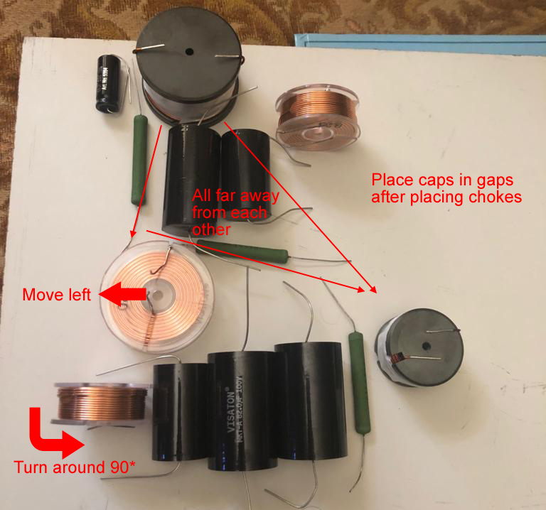

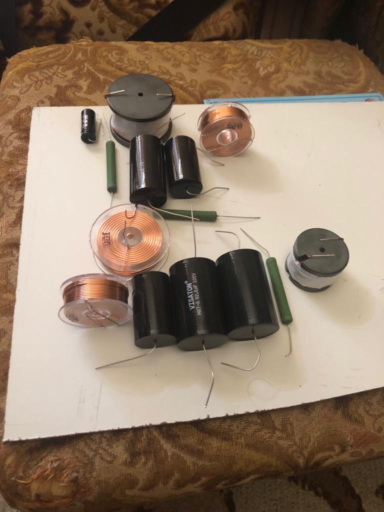

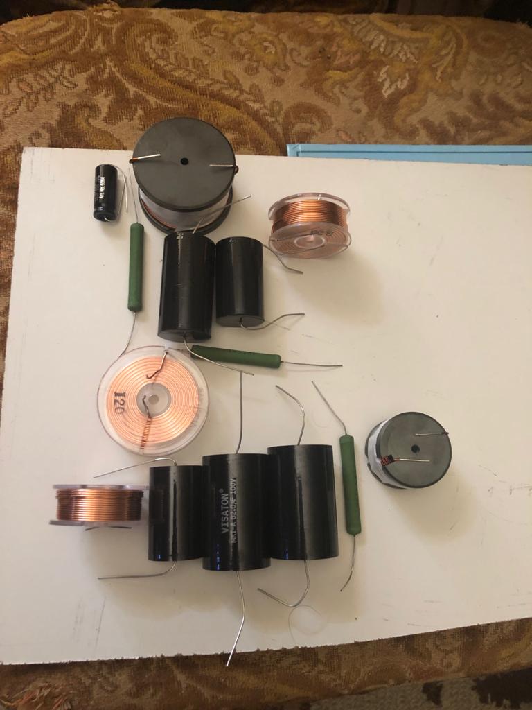

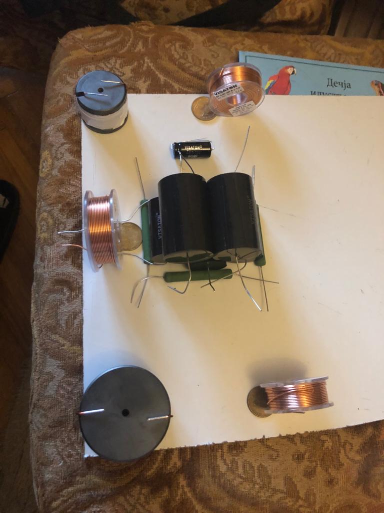

Oh, my God, what are those, ferrite-core inductors? What saturation current rating? Or are they just air-core ones on plastic former?
Transparent ones are, well, air cores.
Grey ones are ferrite.
Smaller one is pure ferrit FC
And bigger one is LR, aka mushroom inductor.FC 3,9 mH
Ferrite coils with tinned wire ends.
Technical Data:
Height 31 mm Diameter 40 mm Wire diameter 0,9 mm Internal resistance 0,5 Ohm Saturation current 6,1 A
This was by design.LR 3,3 mH
Ferrite coil with tinned wire ends. Very high power handling, low loss due to the low internal resistance.
Technical Data:
Height 36 mm Diameter 56 mm Wire diameter 1,32 mm Internal resistance 0,25 Ohm Saturation current 12,1 A

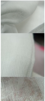

Better to just loosely cover the back of the driver with cheesecloth or similar like the pioneers did as it will change/limit the insulation's broadband effectiveness unless very open weave, which of course defeats the cover's purpose.

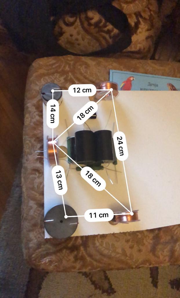

Correct, see this page for placement of coilsBut I think the bottom left inductor needs to be turned around, see picture.
I did actually wanted to find cheesecloth or something similar, but cant find it anywhere. Any substitute comes to mind ?

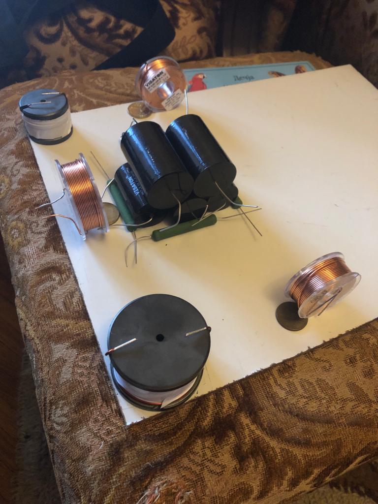

I rearranged XO
Saturation currents are probably sufficient. But I think the bottom left inductor needs to be turned around, see picture.
What about saturation currents, i dont know much about them, do we need certain amps or we want less ? What is the endgame here ?
Try cotton, gauze like, material called "tetra pelene". Available in every pharmacy, DM, Lilly stores. Buy 1 piece for testing. It's cheap and ubiquitous.
Assuming Amazon in Britain or other Euro country isn't an option: What to Use If You Don't Have Cheesecloth
"tetra pelene"
Interesting! A search only returned an incredible number of businesses selling Tetra diapers. 🙁
