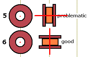

Hi Danny, that's some nice information there. But don't you think that the flux paths are equally orthogonal in both Fig. 5 and Fig. 6 on Mr. Gravesen's website that is, "out of table / towards screen (90*) in Fig. 5" and "out of table / parallel to screen (also 90*)" in Fig. 6 ? Hope you understand what I'm saying. Thanks for the link.

In case of 5 and 6, imagine the flux as a line through the core donut hole.
In case of 5, the left coil has a vertical flux line, the right has a horizontal flux line that goes through the left core, the flux lines are crossing.
For 6, the right has a horizontal flux line that doesn't go through the left core, the flux lines are not crossing and also not parallel.

danny_66 said:.. the flux lines are not crossing ...
So it's not enough if the flux paths are perpendicular, they should not be crossing each other, got it, thank you very much!
