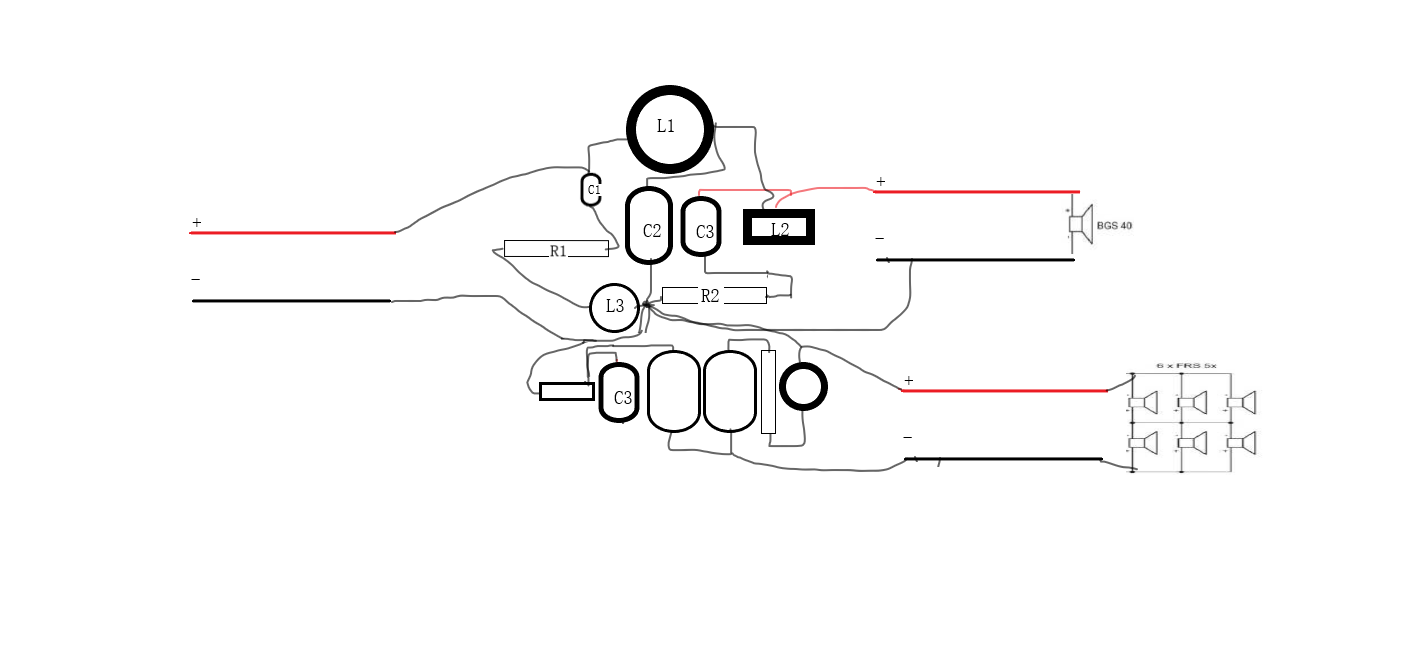

Regarding crossover, from what i understand, if i want to split LF and HF sections to run on two amps, it can be done. If i want to run it as single unit i will just need to bridge the terminals ? Or there is more to it and entire redesign is needed ?

For crossover, i was more curios if what i currently have could be used for active crossover, without changing parts ?
Yesterday i started making some layouts, im thinking of using some plastic/wood board, drill the hole for leads and layout components on top of it and do the wiring on bottom side (Use leads as much as possible and little bit of copper cable for places it cant reach. Leave crossover boards near amp for more aesthetic look and easy service/upgrade.
Active crossovers maybe made from opamp circuits at very low power as they operate before the power stages. However, passive ones consist of LP and HP filters matched to the impedances of the woofer and the tweeter respectively.
I think your idea of connecting the woofer and tweeter separately to the amplifier is known as bi-wiring, while the term that pertains to active crossover is bi-amping. Be careful not to mix these up.

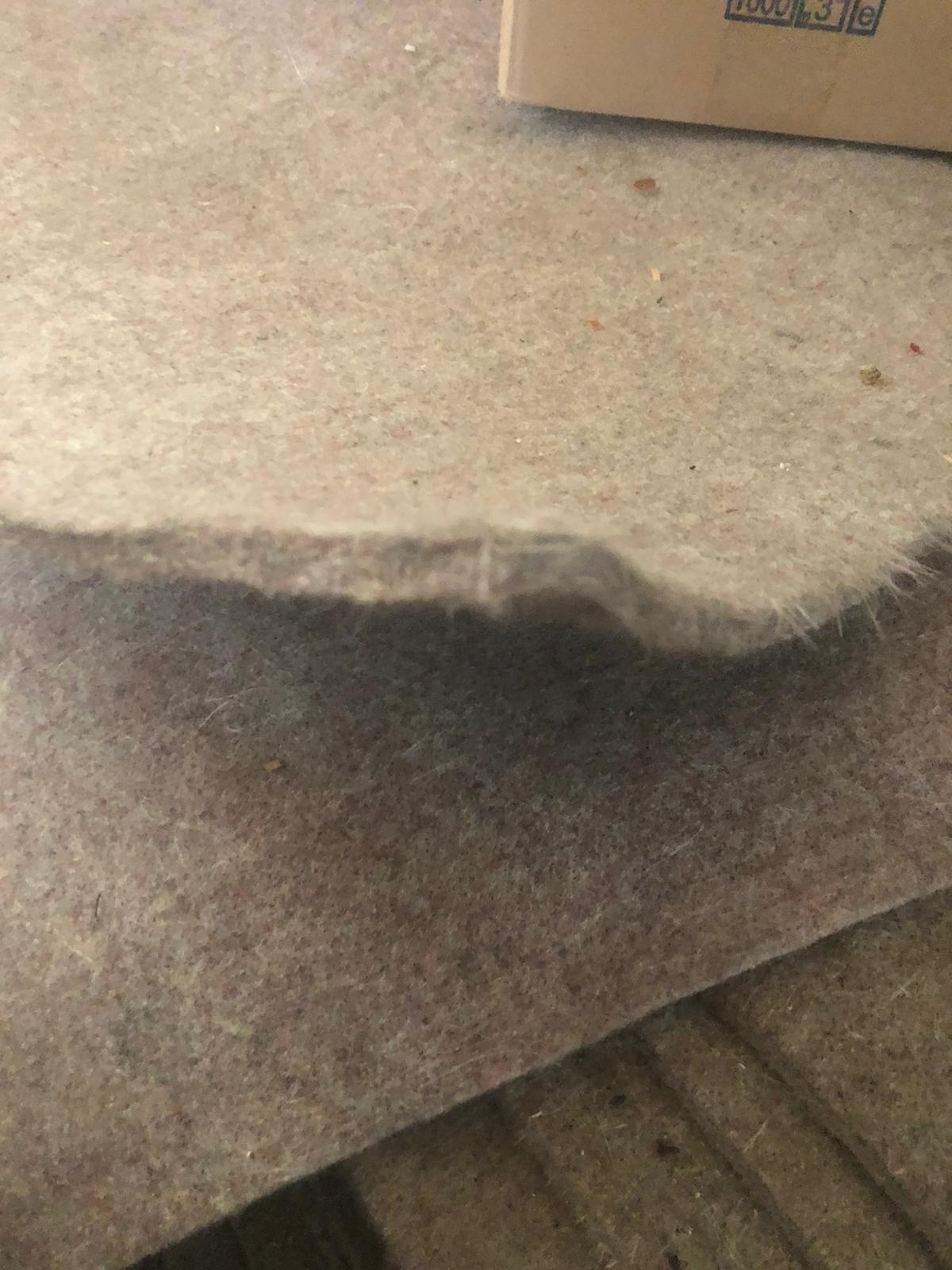

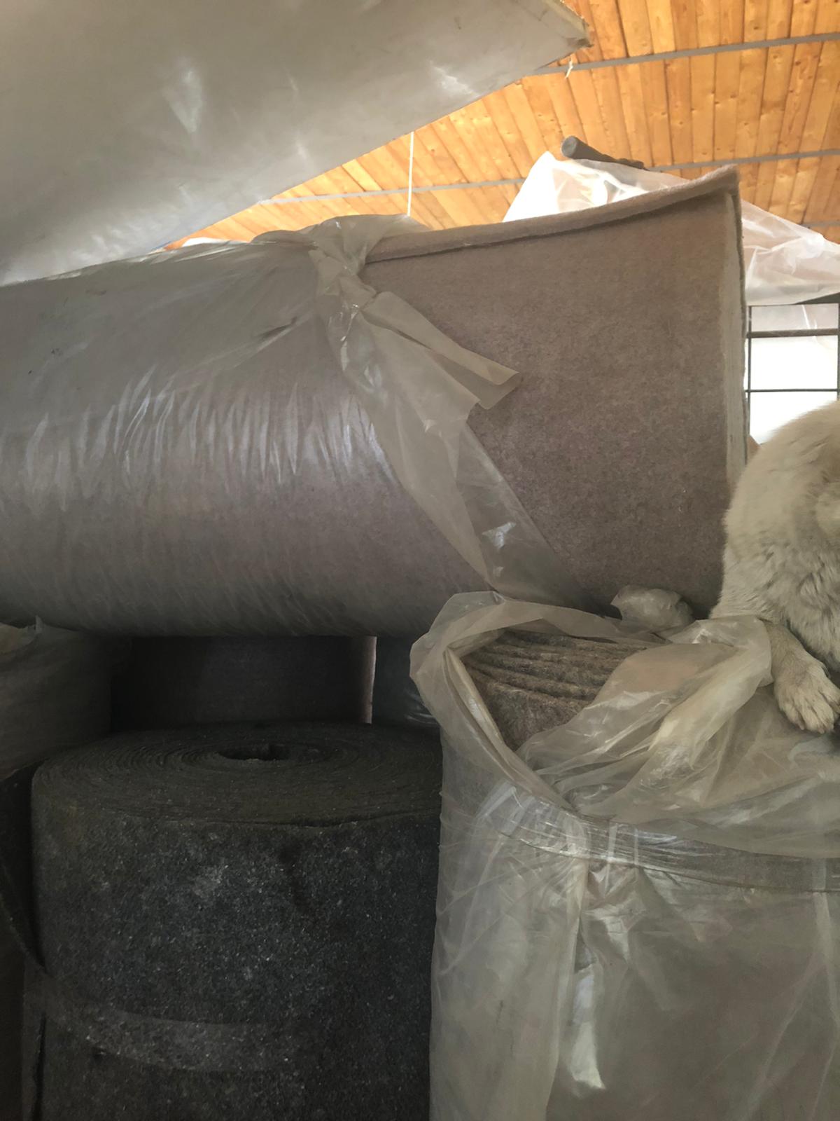

Ok, so wood panels arrived,
I was looking for damping material, there is 50mm glasswool
And guy also showed me this much denser fabric, its more dense and heavier, but thickness is around 10mm. I think he said its used for isolation for concrete or something.
Should i go with denser and stack it for 20mm ?
Maybe get both this and glasswool, and maybe make a sandwich fabric-glasswool-fabric ?
There is also this more lose 0.5mm fabric available aswell and is similar to the first one, its just bit lighter and less dense.
