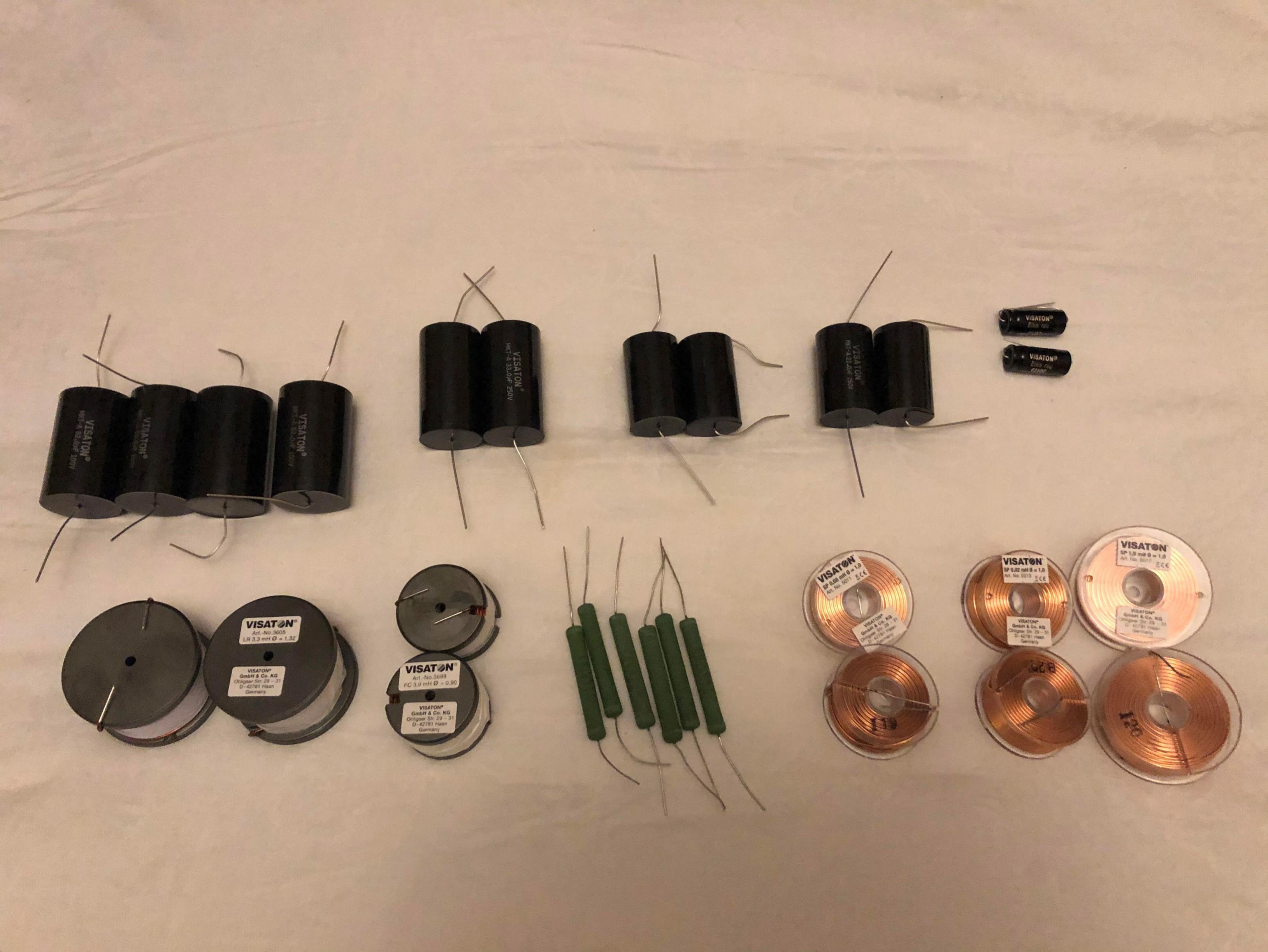

Second, holy moly, if someone told me finding Alu profiles will be hardest task i would laugh. But i found one company that have 100x40mm dimension, but thickness is avaible in 2.5mm and 4mm, but in project its 3mm. Should i get ticker or slimmer profile ?

Alu profile is a resonate chamber for 6x array speakers. On profile, there will be a cutout where wooden 9mm baffle will be placed which will hold small speakers. Alu profile will be open on both top and bottom side. Entire profile will be filled with glasswool or some other damping material, added extra where baffle will be.
Since the chamber is laden with glasswool, the 2.5mm aluminium should be alright, I guess.
