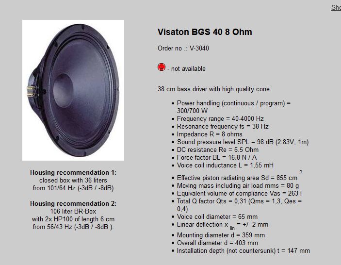

Isn't Xmax calculated as (voice coil height - pole-piece height)/2, which in BG-40's case is (12mm-8mm)/2 = 2mm? Correct me if I'm wrong. I'm using the same webpage and data that you've given in post#1. Besides, the exact wording used is also "excursion limit", in place of "linear excursion".
You were right, Xlin is 2mm

Only the box volume matters, mostly. If you think it's going to get too big, you could make a less deep (thin) box with a wide baffle area to get the same volume rather easily (since you're not using horns etc).
110dB is at 20W (2mm Xmax) and a 1m distance. For doubling of distance, reduce the SPL by 6dB. I must say that this is what the software (WINISD) shows and is subject to the accuracy of the driver parameters. DrZoidberg, I suggest you download something similar (if you haven't) so that you could try different ideas before doing anything.
