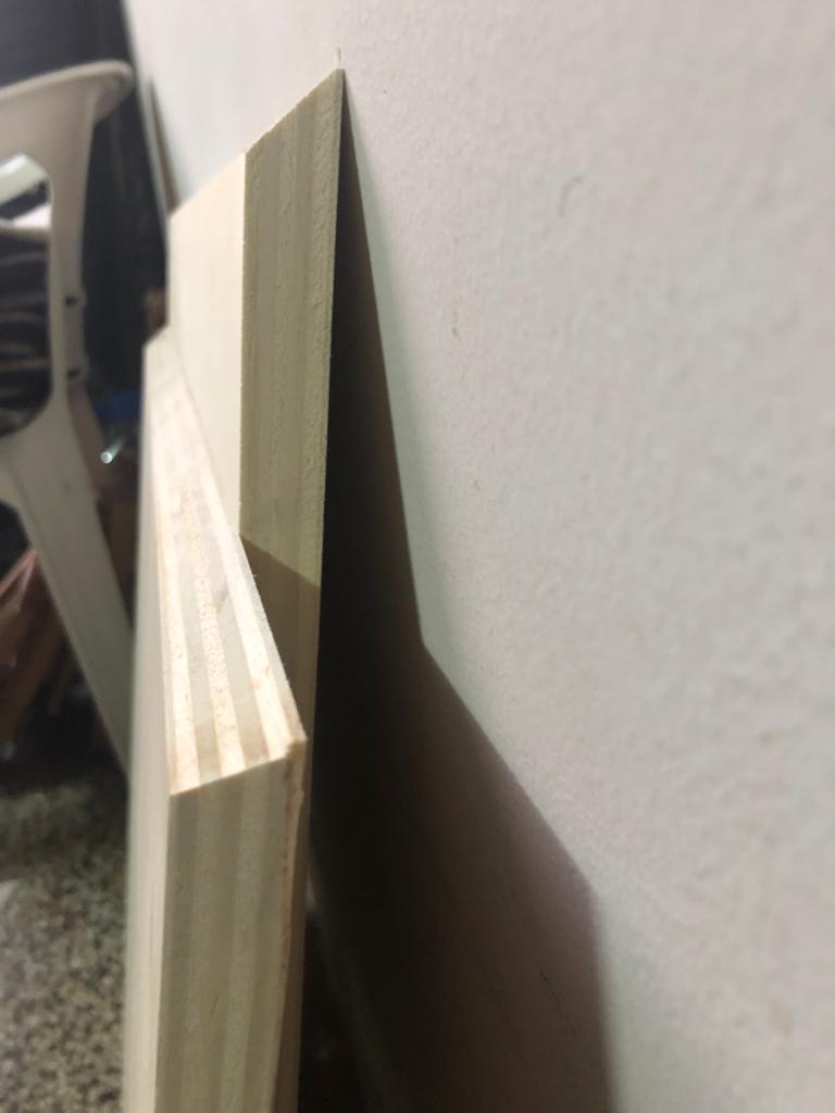

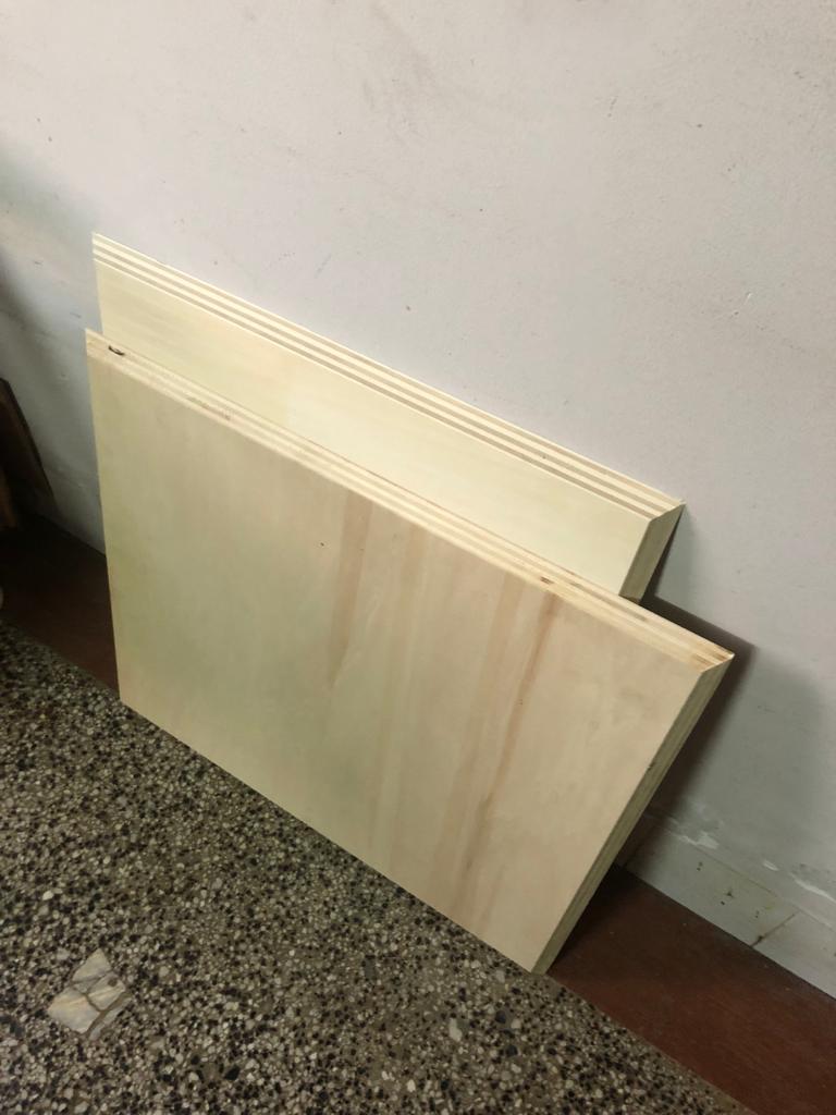

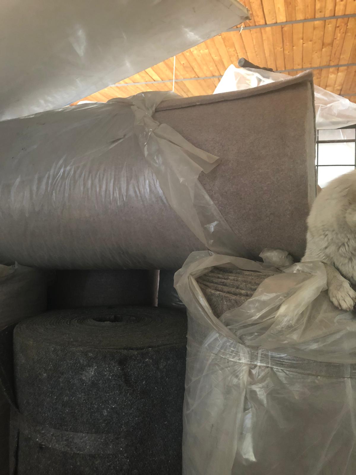

Ok, so wood panels arrived,
I was looking for damping material, there is 50mm glasswool

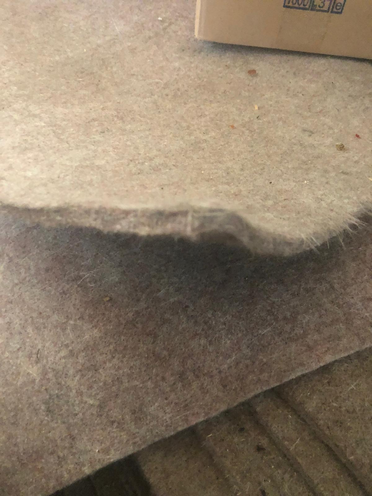

And guy also showed me this much denser fabric, its more dense and heavier, but thickness is around 10mm. I think he said its used for isolation for concrete or something.
View attachment 960851 View attachment 960852
Should i go with denser and stack it for 20mm ?
Maybe get both this and glasswool, and maybe make a sandwich fabric-glasswool-fabric ?
There is also this more lose 0.5mm fabric available aswell and is similar to the first one, its just bit lighter and less dense.

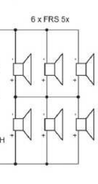

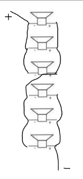

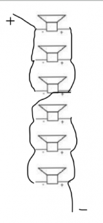

You can connect them any way you want, preferrably so they get even drive, but end up with an impedance that suits your amp.

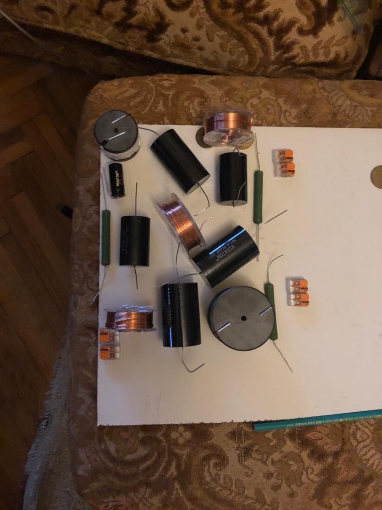

Thats the thing, i dont know much about it, is the layout i drawn ok ? If so il go with it, its the "easiest" layout so far

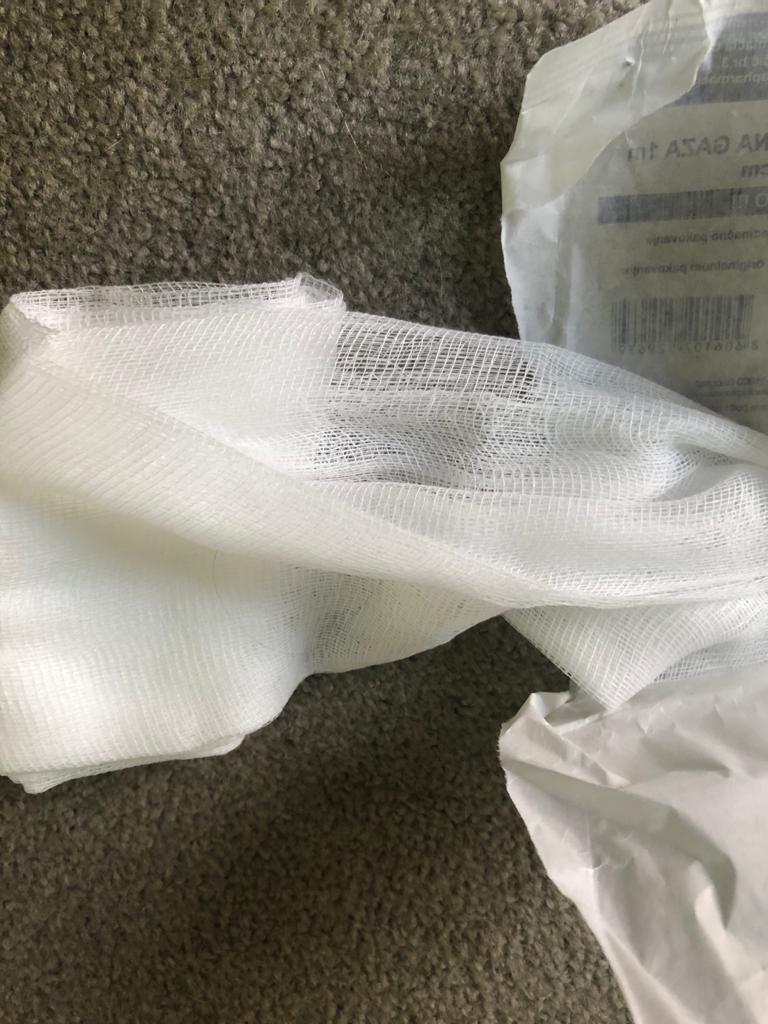

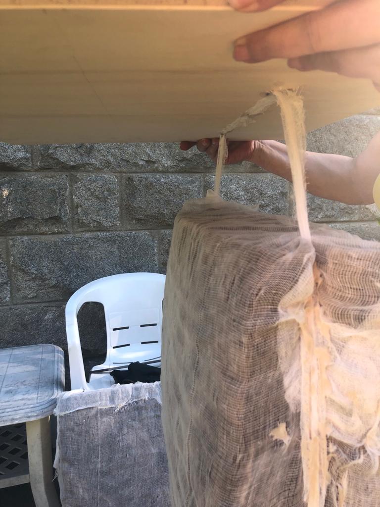

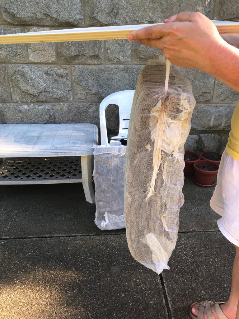

When you say suspended, i think of rolling bunch of glasswool and wrap it around. I bought some gaze, which has less denser holes, but still will hold insulation. I tie one end and other, and there i leave a a bit to be hang, somewhere in middle parallel with woofer. Im thinking of just rolling bunch of gaze and gluing it to the top board of cabinet. Kinda like a giant pendulum inside cabinet
EXACTLY!

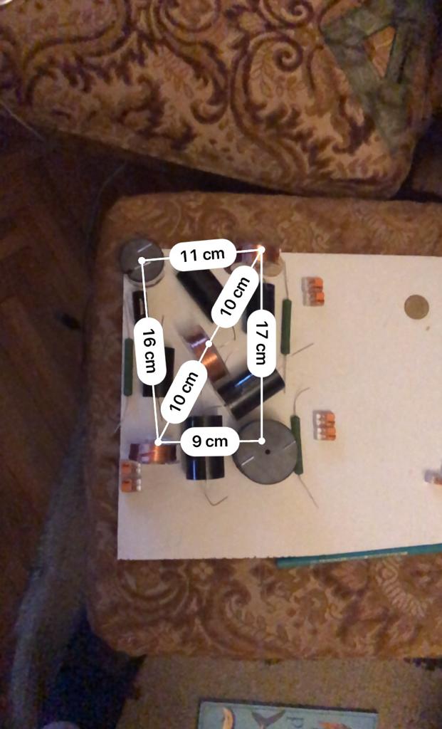

Here is the final XO layout
Whatever works! ) I kept the XOs in a separate box to have easy access for tweaks and/or outright replacement with the speaker leads permanently attached at the driver, XO and at the amp to limit the number of connections to just the one.
Here is the final XO layout, i think distances are good, i used all the space inside, for a nice 10x20cm board.
I think the diagonal inductor maybe kept straight (45* to right side) without any problems. Its flux lines don't cross those from others anyway. The distances look OK.

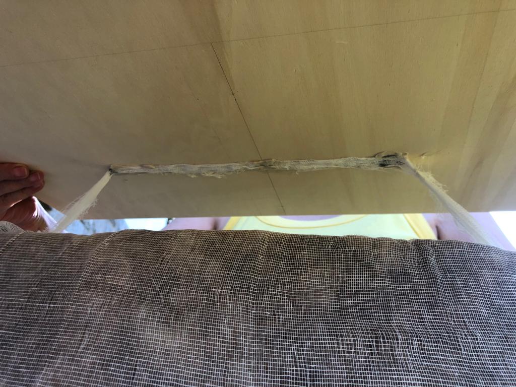

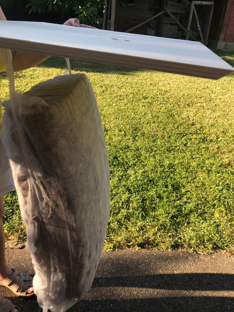

Here is the top board, i will do damp pendulum tomorrow, i will go with around 500x500mm or less depending on wool cut. Thickness is 50mm, and i have 300mm backspace.
Im thinking to sandwitch two cuts and wrap it with cheesecloth, you can see density, it will hold it nice.
