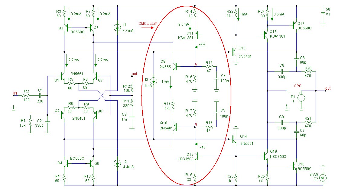

Hi Olivier,
Okay, let's try to explain that CMCL thingy. Below you see a simplified circuit with only the main components of a CMCL (and TMC of course ;)). Our aim is to stabilize the standing VAS current in a well controlled manner. This means that sum of the (absolute value of) top and bottom VAS should be held at a constant value. As we have no direct access to these currents, we are using a copy of them (see Q11 & Q12) and look at the collector currents of these copies instead.
Each of these (copied) currents creates a voltage drop across R16 respectively R17. Now the sum of these voltages (i.e. the voltage between A and B) is proportional to the sum of the VAS currents: V(A,B) = (|Ic(Q11)| + Ic(Q12) ) * 470
This sum in turn is sensed by Q9, Q10, R13 and converted to a current Is.
Is = ( ( |Ic(Q11)| + Ic(Q12) ) * 470 - 2*Vbe ) / 6k8
The higher the VAS currents, the higher Is.
Is is subtracted from the VAS inputs via the current mirrors. But without a constant reference current, which is added to the VAS inputs, it shouldn't work as the VASes are completely turned off. Therefore I've added a reference current I3 = 1mA. So Is is compared against I3.
Is = ( ( |Ic(Q11)| + Ic(Q12) ) * 470 - 2*Vbe ) / 6k8 = 1mA
( |Ic(Q11)| + Ic(Q12) ) * 470 - 2*Vbe = 6.8
( |Ic(Q11)| + Ic(Q12) ) * 470 ~= 8
|Ic(Q11)| + Ic(Q12) ~= 8/470 = 17mA
|Ic(Q11)| = Ic(Q12) ~= 8.5mA
Simple, isn't it?
Gegroet, Edmond.
BTW, C4, C5, R15 & R18 define the unity loop gain frequency and phase of the CMCL. ULGF = 500kHz and the phase margin = 90 degrees.
The DC loop gain is quite high, about 47dB, so disturbances from imbalance etc. are highly suppressed.

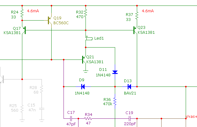

Furthermore, I've changed a lot of components and even deleted a few.
- The emitter Rs of the VAS and of its copy should be equal (33R)
- The cacodes deleted, as they give more distortion instead of less. (don't ask me why, please). See CMCL_07_No_Cascode.cir vs CMCL_07_mod.cir
- The emitter Rs of the LTP doubled and the compensation caps halved (in order to maintain the same ULGF=1.1MHz) In this way the LTP has less work to do.
- Modified the CMCL stuff so that the VAS current is lowered to a more safe value: 4.6mA
- Changed the over current protection of the VAS. Now the preceding emitter followers as well as the VAS-copies are also protected.
- For best HF PSRR C7 resp. C8 should be equal to C17 resp. C18 (47pF).
- For the driver stage I've used two pair of KSA1831/KSC5303 instead of only one pair, just because I was too lazy to look for more appropriate trannies that can handle the power dissipation. Please, look for them by yourself if you don't mind.
But that's not all. You also might consider to replace the input trannies by KSA1831/KSC5303 types. These trannies allows more more dissipation and have a much higher Early voltage. So (slightly) less distortion and no need for input cascodes at all.
Groeten, Edmond.

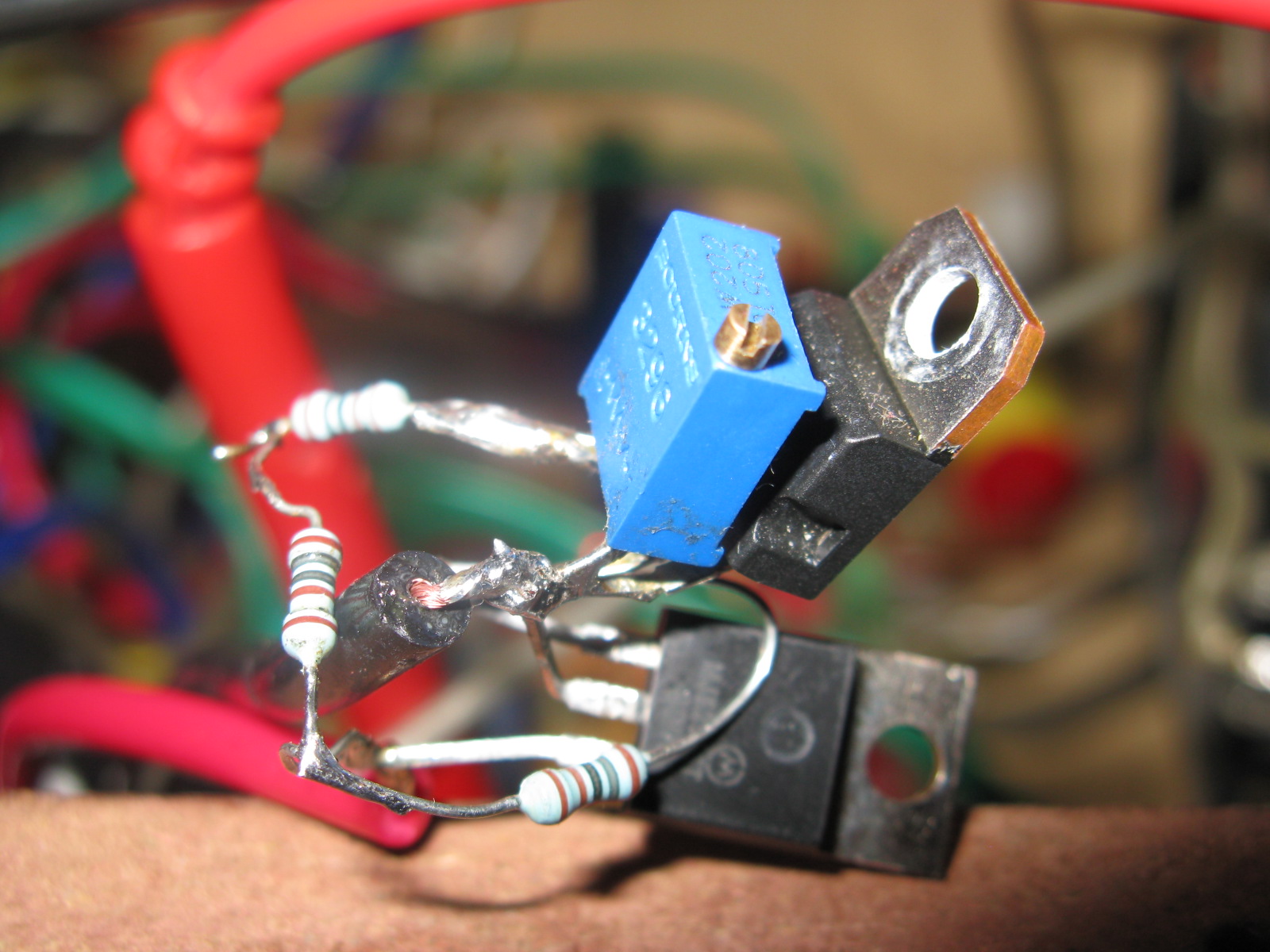

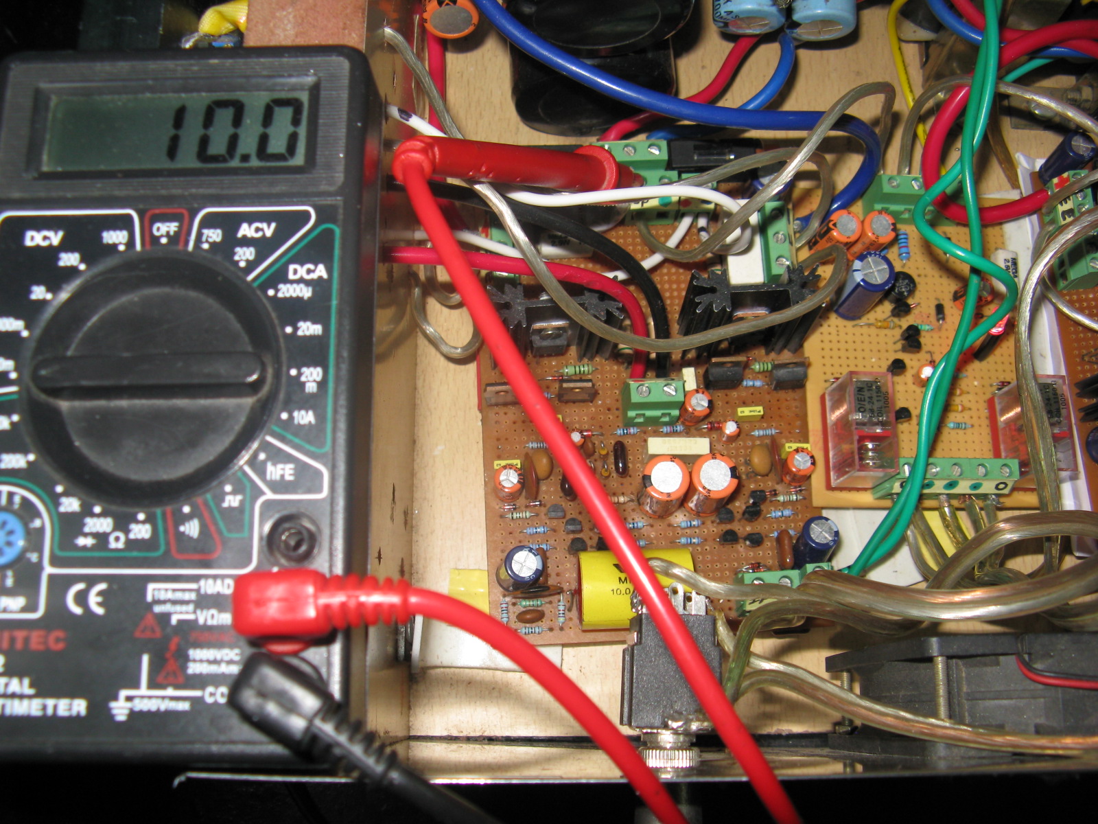

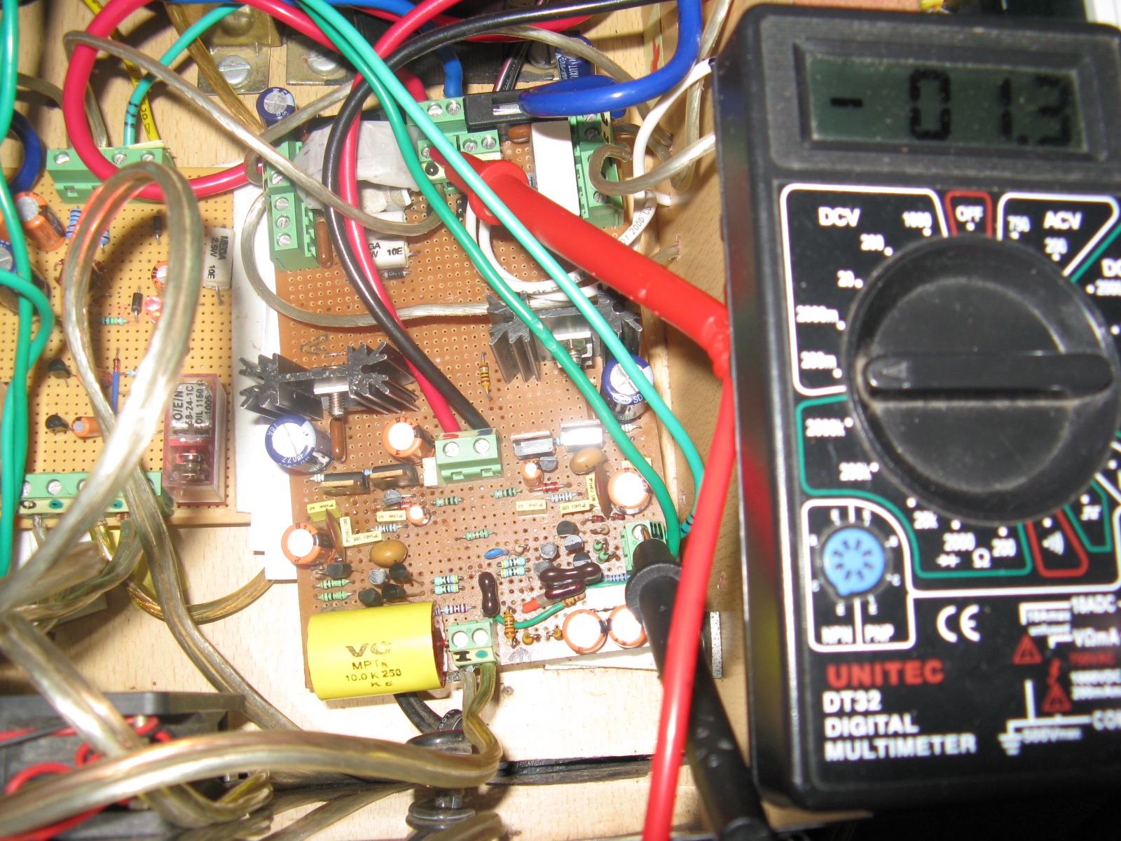

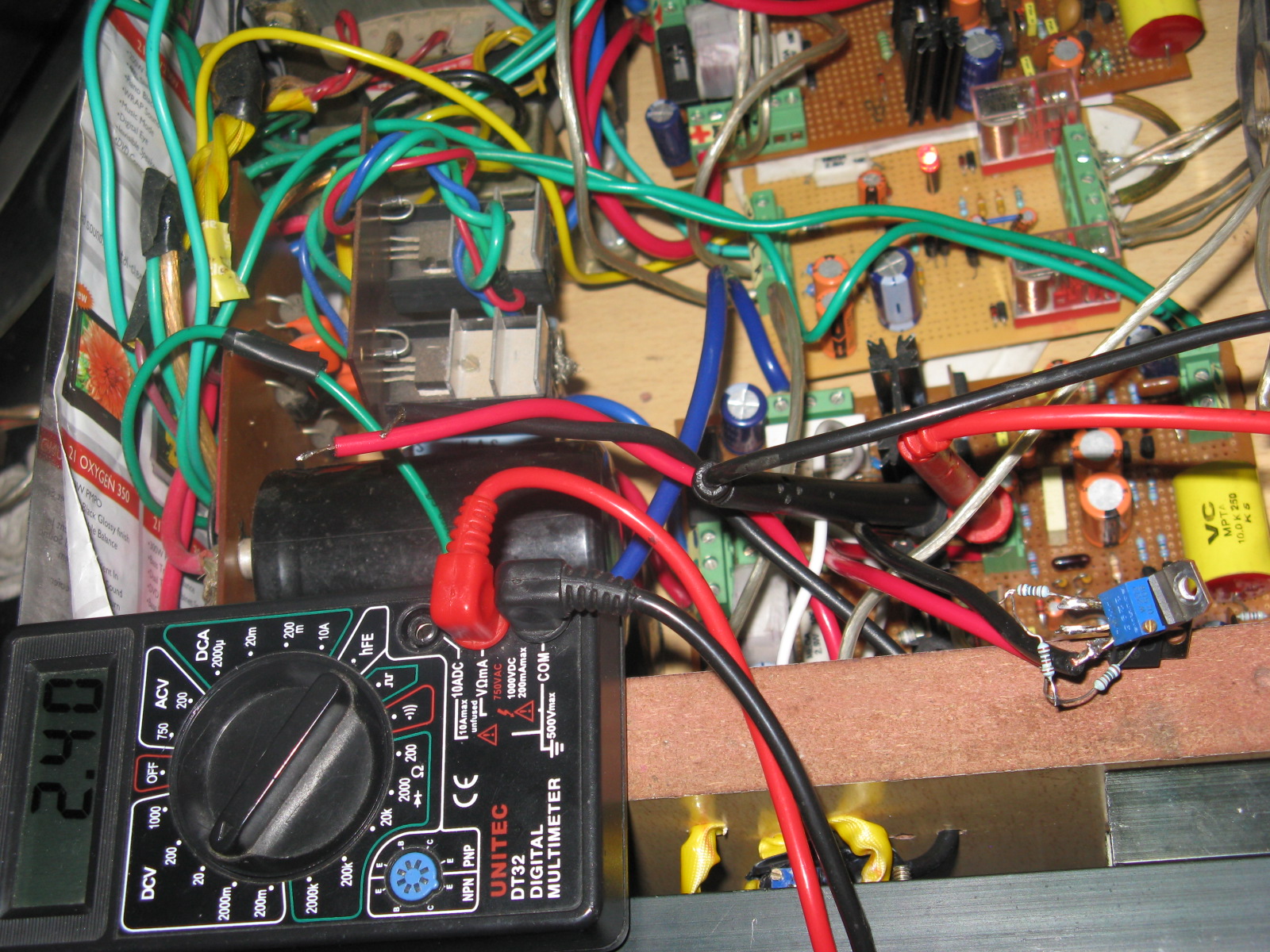

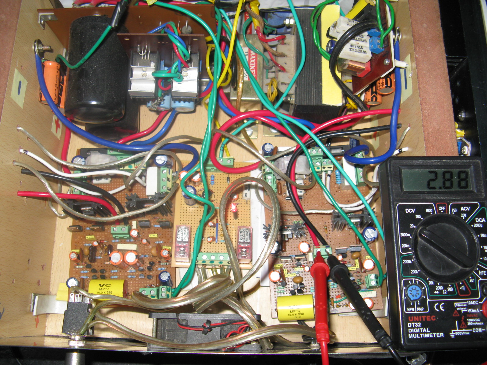

I am back with more success!
I have completed the second power amps on universal PCB with better performance than the first board!
To be short both amps don’t oscillate and are not tolerant to components or hfe variance!
Both amps tone/sonic sounds identical and I find absolutely no difference in listening test.
It is my favorite sounding amp so far.
1st amp> has DC offset of 10mv
2nd amp> 1.3mv
1st amp> uses MPSA42/92, TIP41/42, output triples and MJ15003/4(for now 2 pairs)
2nd amp> uses BC546/556, TIP41/42, TIP35/36, MJE15030/31, output triples and MJ15003/4(for now 2 pairs)
(input sensitivity is same for both)
MOST important: Vbias has the normal cyclic variations when driving speakers (period of 30 minutes),
1st amp> varies from 2.40v to 2.88v (not good) but will tame this in the next weekend for sure
2nd amp> varies from 2.88v to 2.92v (good)
I have made a list of bad ideas which I tried and din’t work so learnt a lot and willing to try out new ideas soon.
Small NOTES for those wanting to try it out:
1> Always test your amp with low cost O/P device like 2N3055/MJ2955.
2> If connections are all fine but o/p heats or oscillates try increasing CDOM caps (if this Miller cap is too high then O/P will stick to half of +/- Vcc.
3> Don’t compromise on quality for dominant pole caps, first choice silver mica ( but I am using ceramic for now).
4> If the op stage is destroyed then replace the driver stage as well (domino effect).
5> If Vbias Iq is unstable, simplify VAS stage.
6> Test the amp completely and not just with Vas stage and closing the fb path.
My amp oscillates only when I lower the value of Cdom too low, so I stay put at 100pf and 1nf for 2 pole.
If I have 100 & 500pf it oscillates, if I want to use single pole I would go for 90pf or slightly lower. The power supply is +/-31V
I am yet to complete 2 more power amps which will drive my HF professional compression drivers,
For some more weeks these 2 amps will be on test bench and driving inexpensive 4 Ohm speakers and I am enjoying the music and getting good ideas to try out.
I have actually modified the circuit to get Vbias stability from the one publish in the Randy Slone’s book, if you are experienced you can make out from the photos and underneath the board I have power resistors 0.33E/5W and 2 tiny transistors to protect the VAS.
The reason I am using the output triples is that I am driving ancient O/P transistors in a EF. (also implementing feed forward circuit to Pre-driver stage as in Leach’s amp) Without output triples the amp turns on more smoothly, absolutely no thump. (though I am using turn on delay I measured the o/p)
I have few more experiment to complete and I am positive I will be able to lower the dc offset further for the 1st board.
output triples are really not necessary and I may remove it later after I try out few things.
I am not using 1 or 2 diodes in the fb path, the much better one is implementing bi-polar caps.
2 pole compensation is useful and I have tied them to ground. (if tying to Vcc then the resistor value may need experimenting)
Since I am doing all this on universal PCB I can’t afford any error with any of connections including op stage point to point connections or the temperature sense Bias transistors with it’s own circuits mounted on the OP Heat sink. So as I assemble I make sure it is 100% correct and I don’t find it taxing at the end to thoroughly review it.
Though I have solid experience with PCB design, layouts and ground routing, I am assembling this circuit on a universal PCB as I just need 4 power amps for my home and there are so many talented guys in this DIYAUDIO forum that I get my ideas from and willing to try it out myself which can never tire me out and it is all possible with the prototype board.
This design (dual differential input stage with current mirrors) is real stable and not dependant on High beta device. You would be surprised to see my videos (all more than 9MB) when I test it for the first time, there are thin wires (.6 mm) flying out everywhere (near the EI transformer, power cable, IP stage) but still it stays stable with no hum/hiss or any noise.
Slones’ super symmetrical current mirrors I/P stage are fantastic at the end!
The only loss I had so far while testing is one pair of blown op stage (2sc5200/2sa1943) & drivers, but this was at the beginning when I blindly tried out Slones’ design which dint have stable VAS current.
There is no components on the board running warm, the drivers used to run gently warm but after i put 100E as a base resistor I can barely feel the warmth. (I will remove this resistor soon)
This is fun and keeps the mind concentrated!
Till then bye and wish success!
Keep up the humor:)

Hi Olivier,
I finished experimenting with Vbe multiplier,
The 2 transistor version (Sziklai pair) goes very well with my amp, the Vbias variance is absolutely not there. I have tested for an hour with medium power music, it stays 2.39 to 2.40V . There is no instability with this feedback loop - Vbe multiplier even when I was doing the test the way shown in the photos.
I implemented this on my power amp board-1, on which Vbias used to drift , though the drift was due to poorer transistors (TIP41/42C) configured as output triples. After implementing this without any modification to the amp the variance is controlled tight.
Sharing Notes:
1>Do not go too low with the resistors (less than 200E) high voltage turns up everywhere in almost all components. (but voltage across Vbias E & C will show zero)
2>BD 139/BD 140 not satisfactory
3.Strongly recommend Sziklai pair- Vbe multiplier for Slones Amp
Two accidents happened while testing, usually I am very careful but this happened late during midnight)
While testing the VBe multiplies the entire negative connecting wire (Collector of 2nd pair) was not connected to the Amp!
The O/P transistors heated rapidly and could hear the transforms jerk BUT THIS AMP SURVIVED!! (strange the 5 A fuse dint die)
The next one was, I was testing all this on real one pair power output transistors and the other pair emitters removed, one of this wire slipped and shorted with Ground, again nothing happened it Survived!
WOW ! Are these transistors Mj15003/4 indestructible?
Smathias

Hi Edmond,
I adapted the schematic on a few points. First of all, I reduced Iq VAS down to 7mA approximately. I implemented TPC and TMC setting one resistor to the correct value while the other is raised to 10Meg. In reality the non serving one won't be soldered onto the pcb. I included your clamps also in the VAS. I kept the cascoded VAS and I kept the protection for VAS Iq in the cascode leg. Maybe that can still be changed, I kept it there because otherwise we need to keep a resistance in the emitter leg of the VAS amplifier Q's which in turn loads the IS with input impedance, but since the CMCL requires a resistor there too, it's another ball game. I'll see that later.
I modified slightly the routing for the rail voltages, which is not of concern in the schematic, but just to remember me later when doing the pcb. I also inluded a second set of decoupling caps.
Implemented the Zobel network.
Included some caps around the Mosfets as you can see. However I copied this from other schematics and don't really know their influence...I believe it must be RF rejection related....
Adjusted rail potential, but this doesn't matter.
Some questions however :
- why did you install C22 and C23? They seem switch-off capacitors to me, but do L-Mosfets suffer from switching distortion or is this to be versatile in case of changing to BJT's? Or is it something else?
- You mentionned searching for good Driver transistor, well I found the KSA1220 or 2SA1220 but except for better power characterisitcs they are not as good as the the KSA1381 or 2SA1381. If the latter are just used to drive 2 Mosfet stages this should suffise no? No use for changing to heavier drivers right?
- I notice that 1KHZ THD is really low : under 4u%, but at 20KHZ it rises to 800u% which is not bad but it is a big raise anyway, so looking deeper into it I see that the raise is primarily due to higher order harmonics like the 11th and 13th for instance...Of course this is over 200KHZ does it really matter? What is the source for this? Vbias induced high order harmonics?
- I worry about the nyquist stability Vout (before Zobel) compared to Vin inverting differential input show a phase lag of nearly 200° where the magnitude (amped) becomes 0. However if I compare the phase lage between Vin diff + and Vin diff - it is 0° all the way and around the magnitude zero point the lag shows a downward spike going to -50° ... what counts as nyquist stability???:flame:
See plots
I still need to incorporate a protection circuit for the OPS ! What do you think of it? Simple VI limiter? Single slope? dual slope? multi slope?
Damn its late i go to sleep
Greetz
Olivier

Hi Edmond,
Hi Olivier,
With 7mA the PD is still quit high. Why not reduce it to say 5mA? You don't need that much current.
If you don't mind to blow another bunch of trannies, just keep the protection there.
But I strongly advice you to change that. See the schematics below. This time I've done it in a slightly different way: instead of sensing the emitter resistor of the VAS itself, now the emitter resistor of the VAS-copy is sensed. Same results of course, but the schematic (and probably the PCB as well) looks a bit 'nicer'.
I modified slightly the routing for the rail voltages, which is not of concern in the schematic, but just to remember me later when doing the pcb. I also included a second set of decoupling caps.
Okay.
I'm not sure whether they are really needed, though it doesn't harm. Better safe then sorry
You are right. They are switch-off capacitors. Maybe you don't need them in case of laterals, but certainly in case of vertical MOSFETs and BJTs.
The trouble with this kind of topology is that the driver turns the MOSFETs faster on than off. Those capacitors partly cured the problem. But if you like to do it really nice, then use 'split' drivers, i.e. the 'top' respectively 'bottom' MOSFETs are driven by their 'own' push-pull driver. Then you don't need those caps at all, which creates another problem in return. See also my next comment
- You mentioned searching for good Driver transistor, well I found the KSA1220 or 2SA1220 but except for better power characteristics they are not as good as the the KSA1381 or 2SA1381. If the latter are just used to drive 2 Mosfet stages this should suffice no? No use for changing to heavier drivers right?
But two MOFETS pairs (in particular laterals) isn't enough. Four pairs is far better. However, in that case you will need indeed a more powerful driver. That means two pair of SA1381/KSC3503. But instead of using them simply in parallel (as show in my previous schematic), it's even better to use the same number of trannies in the aforementioned split driver approach. The only thing that complicates the design a bit, are the two bias generators needed for the push-pull drivers (two more trannies)
First, the THD sim is very inaccurate, mainly as a result of poor modeling of the lateral MOSFETs.
Second, as already pointed out, THD will rise considerably with frequency: with 3rd power!
(or 18dB/octave). So this increase is not bad at all.
BTW, if you don't like this behavior, the only thing you can do about it is increasing the distortion at lower frequencies. Although propagated by some alleged audio gurus, this is of course the most stupid thing ever.
See plots
You can't assess the loop response in this way. Please use the method as shown in: CMCL-global-loop-gain.cir
Greetz
Olivier
Of course you need some kind of protection. I would recommend a simple current limiter. No VI limiter, as the positive voltage feedback tends to destabilize the limiter.
One more thing, the voltage clamp in my previous schematic is totally wrong. I don't know how and why this happened. Probably during a redraw/cleanup. My apologies for this gross error. Below are the correct circuits (with and without cascode).
Next time I will show you an example with split drivers. That will take a few days as many other things have to be changed as well.
Groeten,
Edmond.

Edmond,
I lowered the VAS Iq down to 5.7mA now. Same THD anyway in the sim.
No problem to change the location of the VAS protection from the Cascode Leg to the VAS leg. I would like to know if it is really a good idea to put it on the copy of the VAS Iq? It should work since it is a copy, but what if a failure causes the VAS Iq to climb sky high AND also destroys the tracking circuit between the VAS Iq and its copy at the same time ... it won't protect right? The same is true the other way around but basicly it might be better to be safe on the real VAS Iq instead of its copy...right or wrong? One could protect both too but this might be an overkill ... ok I moved it there anyway ...
I didn't understand the explanation about the drivers I guess. Let me tell you what I read : Slone connects the sourcefollowers L-MOSFETS directly to the VAS stage, this explains maybe why the VAS Iq is so high!? He uses those famous 2SD669 and 2SB649 which are hard to find and also hard to get spice models for! But ok, apart from that is it not good to drive 2 times 2 mosfet pairs with those 2sa1381 like in the last circuit i uploaded yesterday? each driver pair only needs to feed a dual pair of mosfets...? Is going to the burden of pushpulling drivers and dual vbias worth the results? Our circuit is already becoming a factory ! :) As for the switchoff caps ... I have to admit this ops stuff is going over my head but I am happy to hear your propositions for the next step in this...
Increasing LF THD just to create an illusion it rises less at higher frequencies is really stupid !
I will check the phase stuff with the other method you told me and you know if things are stable or not
Wouldn't a simple I limiter restrict the amps power too much?
I will change the clamp circuit , but are you using tunnel diodes now? Gee Edmond, this circuit is becomming complex ... you should pattent it :) If it works :))))
I'll post the modified circuit soon...
for now bye bye
Olivier
Edmond,
Hi Olivier,
You made me thinking, thanks! Initially, the protection was only meant against excessive large input signals. In that case it doesn't matter which VAS is protected; the VAS itself or its 'clone'.
BUT in case of a component failure, it's indeed far better to protect the VAS itself. Imagine what would happen if the bias generator is blown to an open circuit? Bye bye OPS!
I didn't understand the explanation about the drivers I guess. Let me tell you what I read : Slone connects the source followers L-MOSFETS directly to the VAS stage, this explains maybe why the VAS Iq is so high!? He uses those famous 2SD669 and 2SB649 which are hard to find and also hard to get spice models for!
If you input a 1V (2V pk-pk) square wave, the gates (4 pairs) needs some 100mA (peak) drive current. Only a heavy industrial VAS is capable to supply such large currents. So, don't listen to Mr Slone, please. You better listen to Bob Cordell, as he once said: 'it's crazy to not use a driver'.
That's right. It's becoming fairly complex. If you ask for quality, you have to pay attention to every detail. Hence the increased complexity. There ain't no free lunch.
As for the switch-off caps ... I have to admit this ops stuff is going over my head but I am happy to hear your propositions for the next step in this...
Indeed. This is quite a complicated matter. In short, if the amp is subjected to a large HF sine or square wave, the voltage across these caps will increase. As a result, the bias of the OPS will increase too (we don't want this). But at the same time the standing current of the driver stage will decrease. It's the latter that might cause serious trouble, as at low currents, gm and fT decrease also, which causes (in some cases) instability.
Interestingly, if the circuit includes the OPS, the THD increase is far less pronounced. As for the attached circuit, only 46 times from 1kHz to 20kHz. Probably, this might be explained by the fact that the OPS is the main cause or distortion (hence a less steeper rise with frequency), though I'm not sure.
Yes, indeed. But I don't know a better solution. I opt for stability instead of economy. This DIY, you know. ;)
No?! the BAV21 is just a high voltage diode (200V).
Gee Edmond, this circuit is becoming complex ... you should patent it :) If it works :))))
Yes it works (CMCL), see the PGP amp.
In Europe, patents are way too expensive. In this niche market you will never earn the huge investment back. :sad:
Me first. :D
for now bye bye
Olivier
