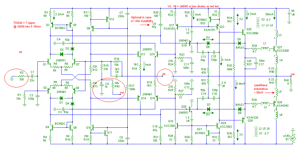

When i do an AC analyses what are the nodes to track?
Vout/Vsource? but this includes the input condioting circuit...
Vout/Vdiff non inverting node
More importantly to check nyquist stability?
PH Vout - Vsource? i guess not since input cond circuit is out of GFB-loop right?
PH Vout - Vdiff non inverting input? seems more logical
PH Vdiff inv input - Vdiff non inverting input? could also be because in the end the ph between those two must be tracked right?
But i would guess Vdiff inv input is same as Vout only smaller in amplitude (voltage divider for feedback)
It seems not the case in simulation

Question : what is the gain peak on the bode plot i allways have?
Hi Olivier,

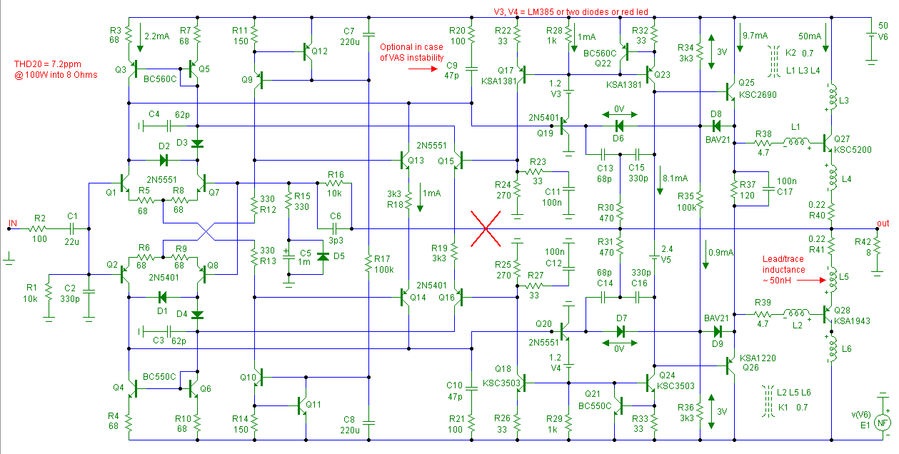

Here's the file of version-2 (remove .txt). I've also added a low distortion Baker clamp. THD20 is slightly increased from 7 to 7.2ppm. In Belgium this is called 'klein bier', isn't it? 😉
As for Bode plots, I prefer to look at the global NFB loop (by breaking the loop at the red cross). This kind of plot is more revealing about stability issues. The dip at 116MHz is due to the lead inductances of the output devices.
Regarding the gain peak in your plot, sorry, I don't know what caused it. Perhaps instability of the VAS. Just find out by trial and error (using different models etc.)
As for TMC vs TPC, TPC causes not only overshoot, but also slightly more distortion (8.5ppm). Please forget TPC, it's so outdated.

Edit1: C3 & C4 improve the HF PSRR.
Edit2: In order to reduce the power dissipation in Q17/18, you might increase R22/26 to 68 Ohms and R24/25 to 470 Ohms.

I just ran an AC analyses on your circuit without touching anything. Your unity gain occurs at 10MHz while the phase shift is already -260°. The gain at -180° is still 13dB this is @ 5MHz. Is this stable?
Anyway who wants a -3dB HF rolloff starting @ over 800KHz ? Isn't that way too high? I would assume 160KHz more of something safe or do you reduce it later with extra input conditionning circuits?
Hm I will ask Mr Google about Baxandall
The only reason I can think of about the gain spike I get at around 100MHz is the presence of many 'poles' on the plot because they are related to the Q's (Cob's?) which are alll the same and in a simulation there is no spread in values so they all fall together. If I am right 'poles' in a bodeplot causes the gain to fall 20dB/decade. 2 poles would cause a further fall of 40dB/decade but at the position of the poles they will cause a gain peak before the rolloff starts. If there are 3, 4 or more poles very close to eachother they gain peak can be huge. I could also be very wrong and its just a Spice phenomena ... or something else ...
I will get rid of the TPC. You call it differently, where do the letters stand for? I see it looks like TPC but the resistor is routed to the output and not to the power rails.
You use a 100 Ohm resistor at the input, why? BV does it also.

Gee Edmond, your Circuit is realy complicated. I am having troubles understanding... by the way did you built this amp in real life yet?
I will do my best to understand 🙂
That was the overall (and closed loop) response. This one says little about the stability. You have to look at the NFB loop, that is, break the loop where I've indicated (and take care of the DC operating point, for example, add one more NFB path that acts only at the DC level).
Anyway who wants a -3dB HF roll-off starting @ over 800KHz ? Isn't that way too high? I would assume 160KHz more of something safe or do you reduce it later with extra input conditioning circuits?
Indeed, 800kHz is a bit too high. Increasing C2 to say 1nF is one way, but not I'm not sure whether all pre-amps like this. Another way is to increase R2, but then you'll get slightly more noise, though probably 'klein bier'. And finally, Fc also depends on Zo of the pre-amp. Anyhow, a moot question.

The only reason I can think of about the gain spike I get at around 100MHz is the presence of many 'poles' on the plot because they are related to the Q's (Cob's?) which are alll the same and in a simulation there is no spread in values so they all fall together. If I am right 'poles' in a bodeplot causes the gain to fall 20dB/decade. 2 poles would cause a further fall of 40dB/decade but at the position of the poles they will cause a gain peak before the rolloff starts. If there are 3, 4 or more poles very close to each other they gain peak can be huge. I could also be very wrong and its just a Spice phenomena ... or something else ...![]()
I also think it's something like that. You can verify this by subsequently zeroing all the Cob's (CJC in spice) and see what happens.
Don''t worry, it only looks complicated, but the principles are simple. The CMCL comprises Q13... Q18, the rest is just main stuff.
I've never built this amp, but the PGP amp (see syn08's or my website) is also stabilized by means of a CMCL and, as it seems, also Xdsl drivers from ADI, see: What's wrong with this picture? 🙂
So it really does work.
E.
Edmond,
I found out my circuit has a dramatic phase shift behavior! I barely get phase margin ... i could never find a way to improve it ! but now it seems like raising the diff amp degen resistors solves the problem ... too bad this reduces thd performance too :-(
and a lot
and a lot
Cmcl
After some thoughts (and some glasses of beer), this is plain **. Regarding the schematic in post 79, the only thing that really matters is good Vbe matching (and thermal coupling) between Q16/Q27 respectively Q15/Q28. My apologies for the confusion. IOW, the simpler version can be made as good as the the more complicated version.
The 1st version senses the VAS Iq indirectly by monitoring the collector currents of emitter followers (Q19/20). Although it does work, it's not that accurate, as Iq also depends on Vbe matching of emitter followers.

This is how I've assessed the global loop response; can't get wrong:
Raising the diff amp degen resistors drop the OLG from 110dB to 90-95 dB
causing the thd to raise 5 to 10 x

Hi Olivier,
First, don't use that ****** TPC and you will see enough phase margin.
Furthermore, I've removed C6 and R14 and inserted a buffer (VCVS) between Vout and the NFB stuff. Please try the circuit below. ULGF = 925kHz and PM = 81 degrees.
