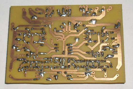

Hi Olivier.
I upload the circuit that I use, PCB (hand-made, one side 10x7cm) and capture of simulation.
Build the amplifier on protoboard, more easy to find the error or mistake.
Maybe you must begin to build the amplifier of 0%.

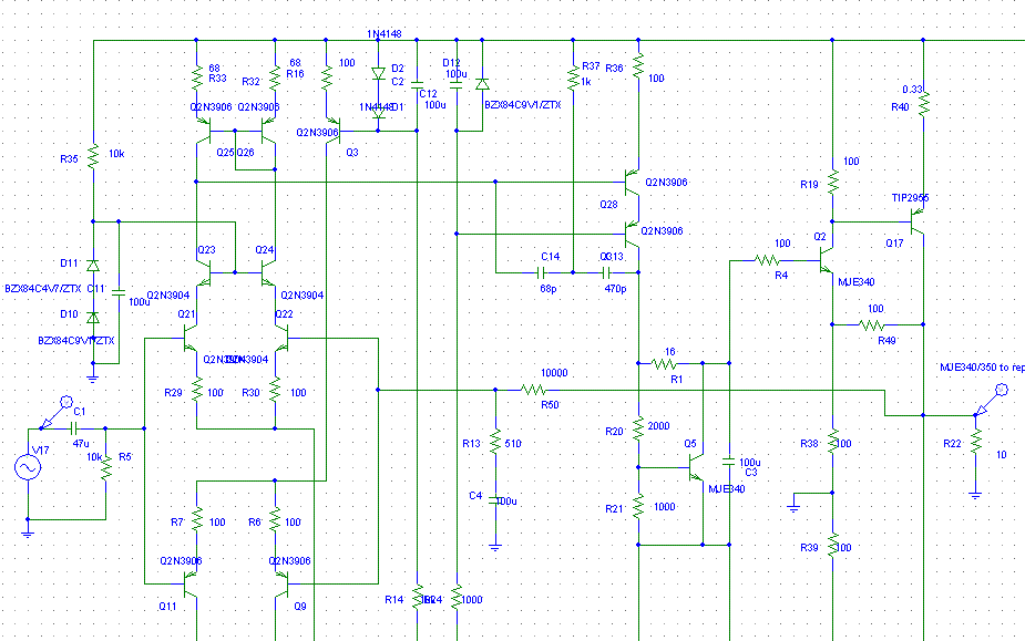

BV,
Yes the last posted schematic is the one that corresponds with the PCB layout in order for you to understand track layout.
I will dispose of it in the end. It will become like your modification or simply with resistor loads in the diff amp IS.
The components used are not really MJE340/350 (they are the best I find in the simulation library) but 2SD669 and 2SD649. Because my stock of them is running out I could only find NTE373 & NTE374 devices which should be near 2SB and 2SD...
By the way do you have good alternative?

Good evening everyone!
I would like to thank all of you for all the replies and valueble information!
I will give my amplifier project a new try. I will use the same topology but with this change : I will follow BV's approach. I modified the schematic accordingly. The schematic is added here in pdf format.
This time I count on all you guys help to critisize my progress ! That way I will correct the problems before I irreversable decisions are made 😛
I will go through this project step by step and give feedback every step of the way, so afterwards some of you can do the project without going through the trouble...
Hope you guys agree and support me...

Now step 1 is done, step2 :
- What are the first impressions of the schematic?
- Question : R17 and R18 serve to bias the zeners. Originallly they were both connected to the GND, but is this necessary or better to do it? Or can it be bound together without reference to the ground? Slone does it for R12 which biasses the diodes D1,2,3&4. Same counts for R17,18? The reason for leaving it with 2 resistors instead of one is because of the heat. Remember I will later use 75 to 85 V rail supply! Goal is between 250 & 350W into 8 ohms.
- Question : I lately see often cascoded input stages. Is this useful? What is the benefit?
-Question : is two pole compensation a good thing or not?
- Question : What about the feedforward circuit R14, C6? It is typically a Slone approach...
- R24,25 : Are used for measuring VAS Iq and should later on be used as current limitting sensors for protection transistors in the VAS leg.
- R26 is a 10K load which I could place or not while testing.
- Rout is a resistor I placed on BV's proposition to coop with probable scopeprobe capacitance problem.
- The collectors of Q11 and Q12 are connected to ground. Could I also connect them together and leave a gnd reference out of it? I am affraid they are not matched (Q11,Q12) and therefore the connection node will not be at 0V but e.g. +4Vdc which in return could cause less swing? Right or Wrong?
Your turn guys 😀😀😀

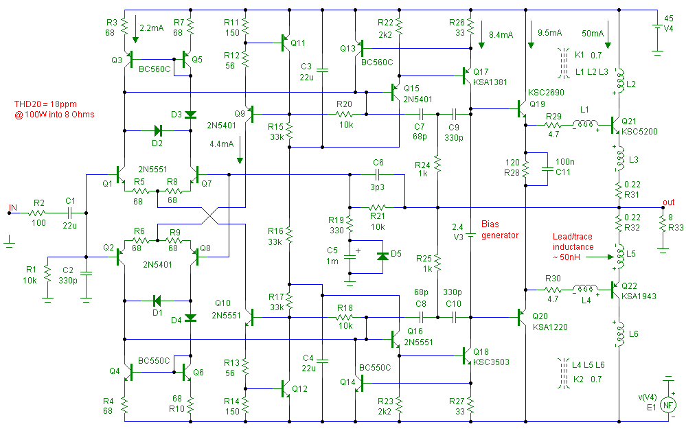

Nice try, but frankly speaking, it could be better.
- Question : R17 and R18 serve to bias the zeners. Originally they were both connected to the GND, but is this necessary or better to do it? Or can it be bound together without reference to the ground? Slone does it for R12 which biases the diodes D1,2,3&4. Same counts for R17,18? The reason for leaving it with 2 resistors instead of one is because of the heat. Remember I will later use 75 to 85 V rail supply! Goal is between 250 & 350W into 8 ohms.
It's better to do it your way. Avoid unnecessary connections to gnd, in particular if it is a signal gnd.
Not that much. It only makes sense if you strive for ultra low distortion (below 1ppm). But then a simple cascode is not enough; use Hawksford cascodes instead. In that case however, you will get other problems: it's not only more complicated but also prone to HF oscillations.
It's bad, because of overshoot and unnecessary loading of the VAS. Use TMC instead, i.e. tie (my) R24/25 to the output instead of gnd.
It's just optional. Generally, just for compensation of parasitic capacitances. See C8 in my schematic.
- R24,25 : Are used for measuring VAS Iq and should later on be used as current limiting sensors for protection transistors in the VAS leg.
That's okay. To be on the safe side is not a bad idea anyway.
No!
I am afraid they are not matched (Q11,Q12) and therefore the connection node will not be at 0V but e.g. +4Vdc which in return could cause less swing? Right or Wrong?
Due to mismatches one of the trannies will certainly go into saturation. But that's not all. The collector voltages should held constant in order to avoid a Miller effect from Cob.

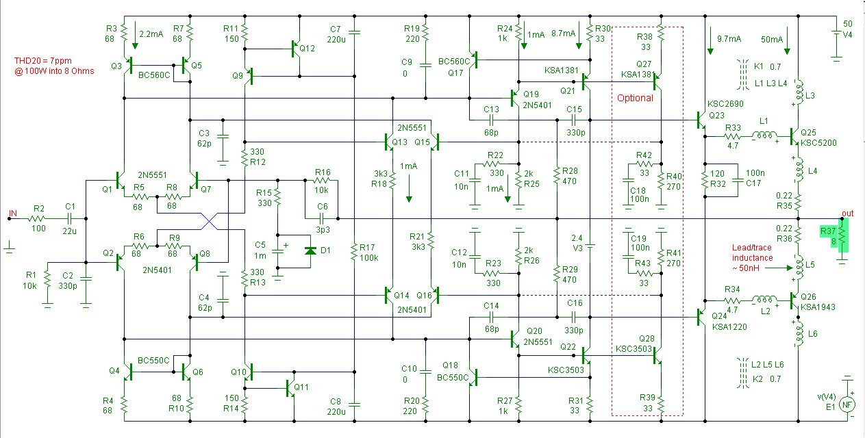

Below you see another approach how to define and stabilize the VAS current.
The inputs of the VASes are connected via 10k resistors (R18/20) to the bases of the current sources, which act as a temperature compensated reference (more or less).
At 27 dgrs. Ic = 8.4mA, increasing to 9.5mA at 0 dgr. and decreasing to 7.5mA at 50 dgrs.
By varying R12/13 you can tailor Ic according to your needs.
BTW, notice that the tail currents are also a bit temperature dependent.
As there's no feedback action between the emitters of the VAS and the current mirrors, the gain is much higher and accordingly the distortion much lower.
I've omitted the VAS cascodes as they hardly improve the performance. Probably because of the outstanding properties of the KSA1381 and KSC3503 (and of course due to the preceding emitter followers Q15/16)
E.

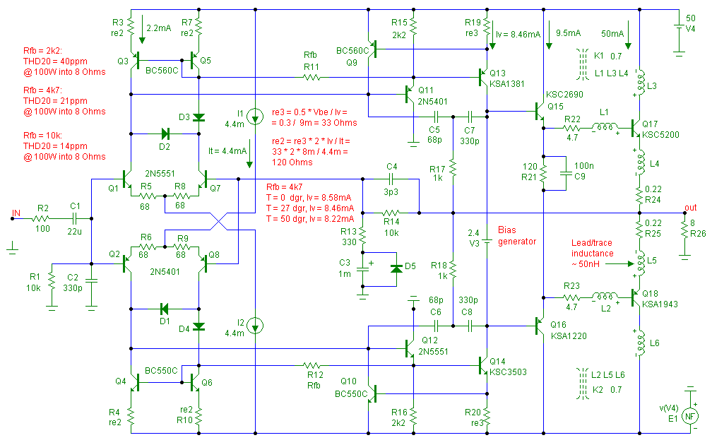

Hi guys,
One more example how to tame the VAS standing current. This one is based on BV's idea, i.e. local feedback around the VAS and current mirror. Consequently, it doesn't rely on the specifics of the tail currents sources as in my previous example. So you are free to choose any CCS you like.
In order to ease manipulation of the local loop gain, the VASes have their own emitter resistors (R19,20). Next, the emitter resistors of the current mirrors are chosen such that the voltage drop across them is the same as across R19,20 (see the formulas in the schematic)
Now we can put a feedback resistor of any value between the emitter of Q5 and Q13 (respectively Q6 and Q14) without disturbing the DC operation point.
In the final version I've put the FB resistors between the base of Q5 and Q13 (respectively the base of Q6 and Q14), as (for some reason) I got 6dB more loop gain at the same level of distortion.
There is a trade-off between DC stability and distortion: the lower Rfb the more stability AND the more distortion. So, what's the optimal value of Rfb? Hard to say, but at least we need a reasonable amount of (local) NFB, say 20dB. This means Rfb~=4k7. With this value the distortion is about 6dB higher than the lowest you can get, so it's not that bad a compromise.
E.

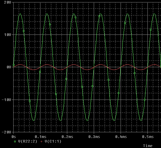

I simulated all day. Just a lousy rainy day as usual in Belgium, we are used to that 🙂
As you all know I started with a 100% Slone topology. The one that has an ill defined VAS Iq. Indeed its not working. Many have tried to find solutions to stabilize Iq. From what I simulated on the Slone circuit I got at best 0,0004% or 0,4ppm or 400u% of THD at 1kHz 50Vpp. The proof of being unuseable for me was the fact that if you do a sensitivity test on the CM left degeneration resistor the Iq in the VAS's dependency was 133 !!!!!!!!!!!!!!!!!!!!!!!!!
To make it work I implemented a modification Mr. BV offered. I simulated a THD of around 0,0012% or 1,2ppm or 1,2m% of THD. 3x times worse. But the VAS IQ was stable. The same sensitivity test showed 1,6 instead of 133.
Now I tried an own modification where the sensitivity is about 20. The THD is even better than Slone base circuit however I must say it might be possible I didn't optimize that circuit well enough to compare...
The THD is 0,0002% or 0,2ppm or 200u% at 20KHz 50Vpp. @1KHz 50Vpp it is : 0.00024% or 0,24ppm whic is worse than at 20KHz How comes?? At 50KHz it rises tot 0,004% or 4ppm.
Remember there is no OPS yet and the stage was loaded with 10MOhm
What did I do? Instead of creating a LFB around the vas legs and the right IS CM degen resistor I left the vas legs connected to the rail as the base circuit but i did bv's mod with the darlington Q legs. I then used a smal resistor in the vas legs to sense changes .... pff difficult to explain look at schematic, its better
I like the thd results and when R2 changes + or -1% the vas Iq changes from 17mA over 22mA to 27mA. Whereas slones circuit causes the same change of R2 to move the Iq from 0.1mA over 30mA to 63mA -> a 630x change ! mine changes only 1.6x !
You guys like it or did i overlook the basics here and i will go down in flames

The VAS input current is amplified by beta, causing a voltage across R15 (and R16), which is fed back as current via Rfb to the current mirror. So the FB factor (or local loop gain) is approximately beta * R15 / Rfb
If beta =100, Rfb = 4k7 and R15 = 2k2, then LG ~= 130*2.2/4.7 ~= 47 (33dB)
Notice that this local loop gain comes at the expense of the overall loop gain, hence more distortion.
