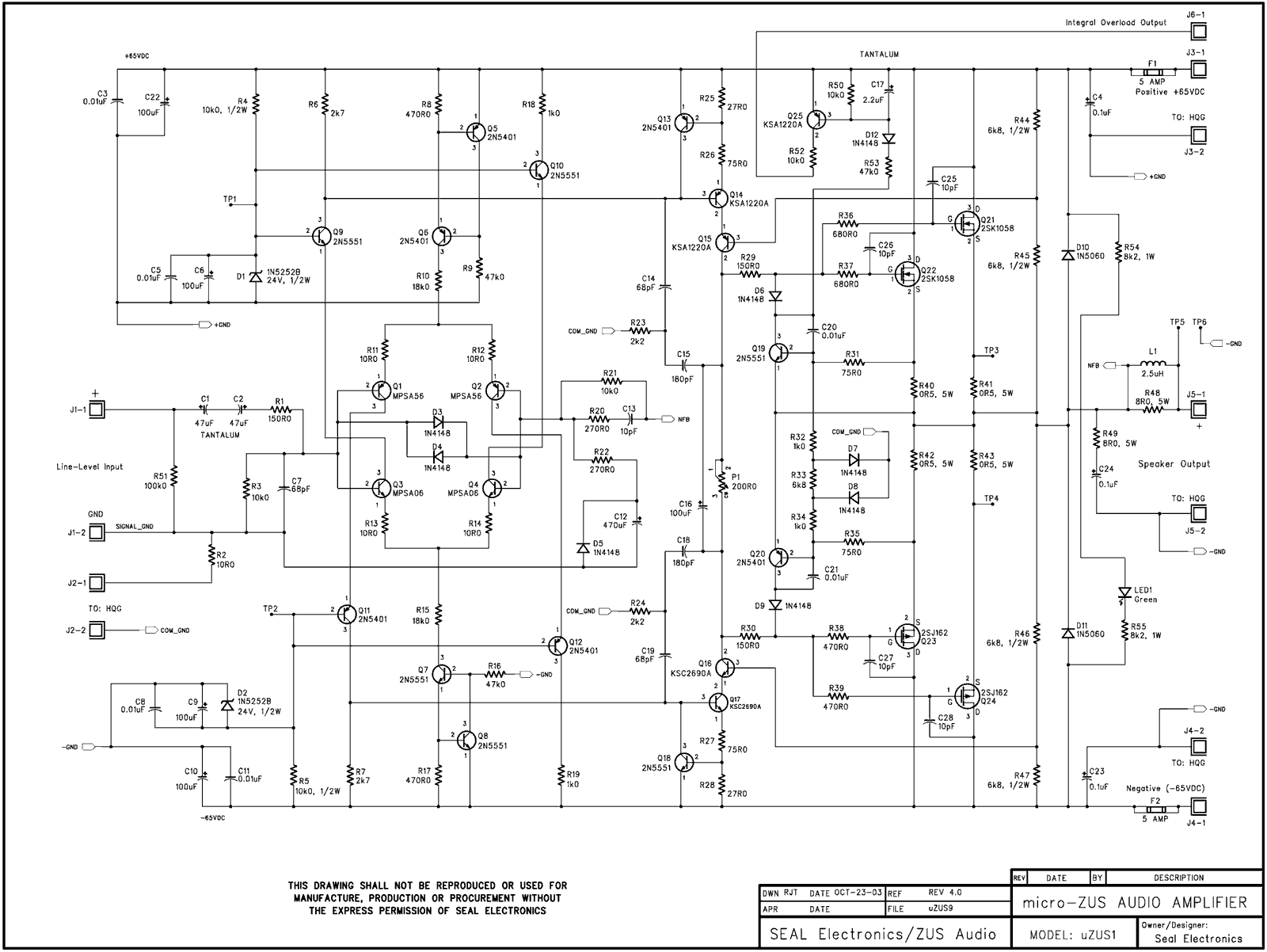

I have the Slones ZUS amp circuit. It's the famous TOTEM or how was it again. He uses no more CM in the IS (haha not good after all). He uses something strange which makes me think is cascoding the Diff Q's. Can that be? Do you have the schematic? If not let me know...
He uses Cascodes in the VAS but they seem biased by 2 stupid resistors and no more zener voltage ... why the fallback?
I don't have a copy, so I like to get one, please.
Sorry, I can't comment on this without a complete schematic.

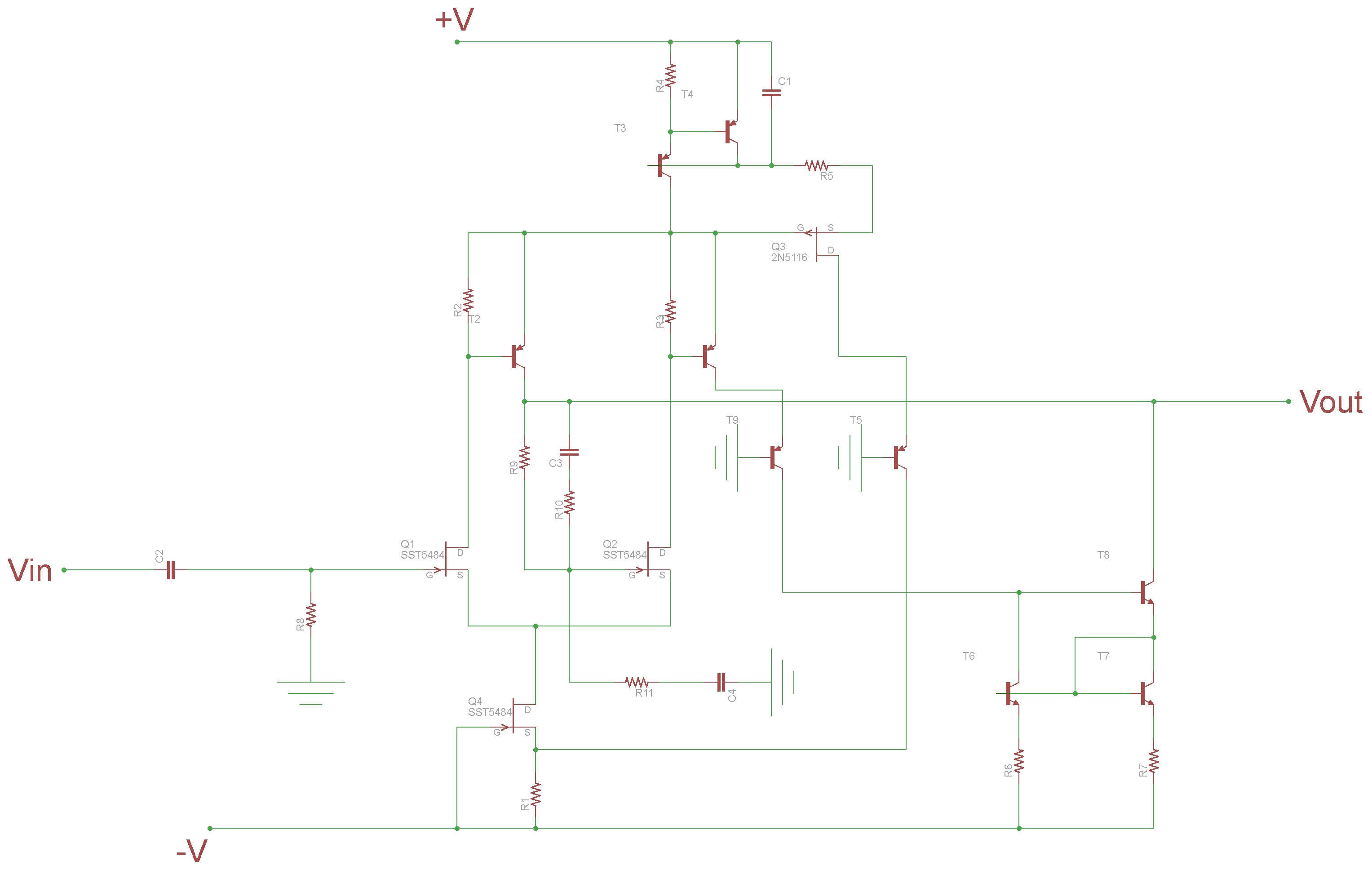

I had an idea one day. I was sitting on my porch drinking beers and it just popped in there...my head that is. I sketched out the circuit and couldn't see why it would not work so I slapped it onto a bread-board and to my surprise it did work. I've never actually simulated it, ha ha.😀 I've since taken it to a whole new higher level, but this is the basic idea I had for my CMCL bias. I was surprised there was no interest in it on the forum two years ago when I brought it up.
Edit> never mind the names of the transistors, I just randomly picked them from the library for reference.
BTW, the primary reason to use a cascode in the VAS is not to avoid 2nd breakdown (you will need high voltage trannies anyhow), rather to neutralize the Early effect and nonlinear behavior of Cob.
Yes, and it also allows you to use lower Vce devices for the current amplifiers. This opens up a whole new world of faster components with higher, more linear Hfe.😉

Well, J-fets are really awesome devices, IMO. I can't see how anyone doing electronic design could not see the benefits. The P-ch one is required, the others are optional. Since it is a voltage controlled device it doesn't affect the current from the CCS. The J-fet CCS is just simpler because being a depletion device it will self bias so you have just the one transistor and resistor.🙂
R4 sets the common mode current for both legs of the VAS. If the total current of the VAS turns on more than this set point, the voltage on the collector of T3 drops. This turns on more the P-ch fet which sends more current through R1, reducing the CM current to the sources of the input transistors. The VAS transistors turn off more to strike the balance, forming the CMCL. I used the source current from the P-ch to drive the ring of two BJT CCS at the top as a short-cut and to save parts.🙂 The differential VAS is simply loaded by a Wilson mirror.
Your schematic is unclear for me I will need some time to analyze it.
Looks like in this version of the diagram you posted Olivier73 thast the designer dropped the LTP mirror loads, presumably because of the CML problem. Having said that, Q10 and especially R18 serve no purpose. I would have returned R18 ro the emitter of th e bottom transistor in the cascode (and same for the other half of the circuit). This does improve distortion by about 20% or so - but, you need to be down at under 10ppm to see this.
A start
Edmond, and all the others too...
I attach a schematic with node voltages, currents, transient analyses, ac analyses, thd, dc temperature behavior of Iq VAS and some sensitivity figures.
The schematic is again the basic Slone topology, yes, the one with undefined VAS Iq including all features like : current mirrors, cascode, darlington, mirror image ...
To state clearly it is a IS + VAS only (no OPS attached).
The only difference with Slone is that the TPC is scrapped and replaced by a TMC principle. This to avoid getting Edmond angry
Because I have no printed version of the sensitivity analyses I can write some figures here :
The VAS Iq change rate compared to an
R1 change rate = +149 %/% !!!
R2 change rate = -112 %/% !!!
HFE Q1 change rate = -2.4 %/%
HFE Q2 change rate = +0.48 %/%
The other analyses are supplied in pdf.
The THD @ 1KHz full output swing and 10Kohms loaded VAS = 85u%
(to me thats 0.85ppm right?)
Now we all know this circuit is nice but can't work without having all the luck on your side. It's like plug and pray !
What I would like is to take this schematic as a base and then progressively introduce CMCL and other circuitry until reaching a practical design going to the pcb process...
What we want is to get the circuit workable without loosing on the THD too much !
Edmond, could you take a look if this start is good? What should we include next?
You will notice I used colours in the schematic to try to make it more readable. I also used Edmonds circuit as base so I left space in the schematic to incorporate circuitry like the CMCL etc.
I hope this is a fruitful start !
Bye for now

Hi all,
Hereby the progress so far :
1. implemented CMCL
2. implemented the Vbias circuit
3. Adapted the feedback capacitor to a large value
4. I placed series resistors in the Miller Comp circuitry
5. implemented the VAS Iq maximum currrent guard
Findings :
a) the closed loop AC analyses shows a better margin than the previous one. This could partially be induced by the fact I changed some minor values here and there to optimize some results. It was done trial and error like. On the other hand I inserted series resistors in the miller circuitry. I read that a simple CAP causes a POLE which in turn causes the phase response to lage 90° ... inserting a resistor also creates a ZERO which should give a 90° phase advance... if done nicely the could somehow negate eachother making the phaseresponse look better. I am curious to hear Edmonds reply 🙂 Will it be shot down or is it a good input?
b) the VAS Iq is no not dependant from R1 and R2 variations as before.
remember the ratio was about 150 %/% where now it is only almost 1 %/% !!!!
c) the temperature sweep of 50° caused IQ VAS to swing 30mA, well now it is reduced to less than 5mA !!
d) The distortion even lowered from 85u% to 8u% 110Vpp 1kHz!!!!!!!! However this must be due to the extended feedback CAP up to nearly 5mF ! Perhaps the thd of the previous circuit was also the same if the cap would have been set yet. As stated before there are also a sum of minor changes that iimpacted as well.
Could someone clear out why the feedback cap causes this change?? I suuppose because the OLG at 1KHZ is very depending on the LF freq response which is influenced by that cap ... ?
I posted other threads for OPS but no-one seems to care to answer !
Bye bye for now
Olivier

Hi Olivier,
I'm back from holiday and will have a close look at your schematics. But before starting my remarks, I like to know some details:
- What kind of OPS: BJT, lateral or vertical MOSFETs; how many driver stages (1 or 2).
- Maximum output power.
- Nominal and minimal speaker impedance.
- Separate and/or regulated and/or elevated PSU for the front-end.
Gegroet, Edmond.
