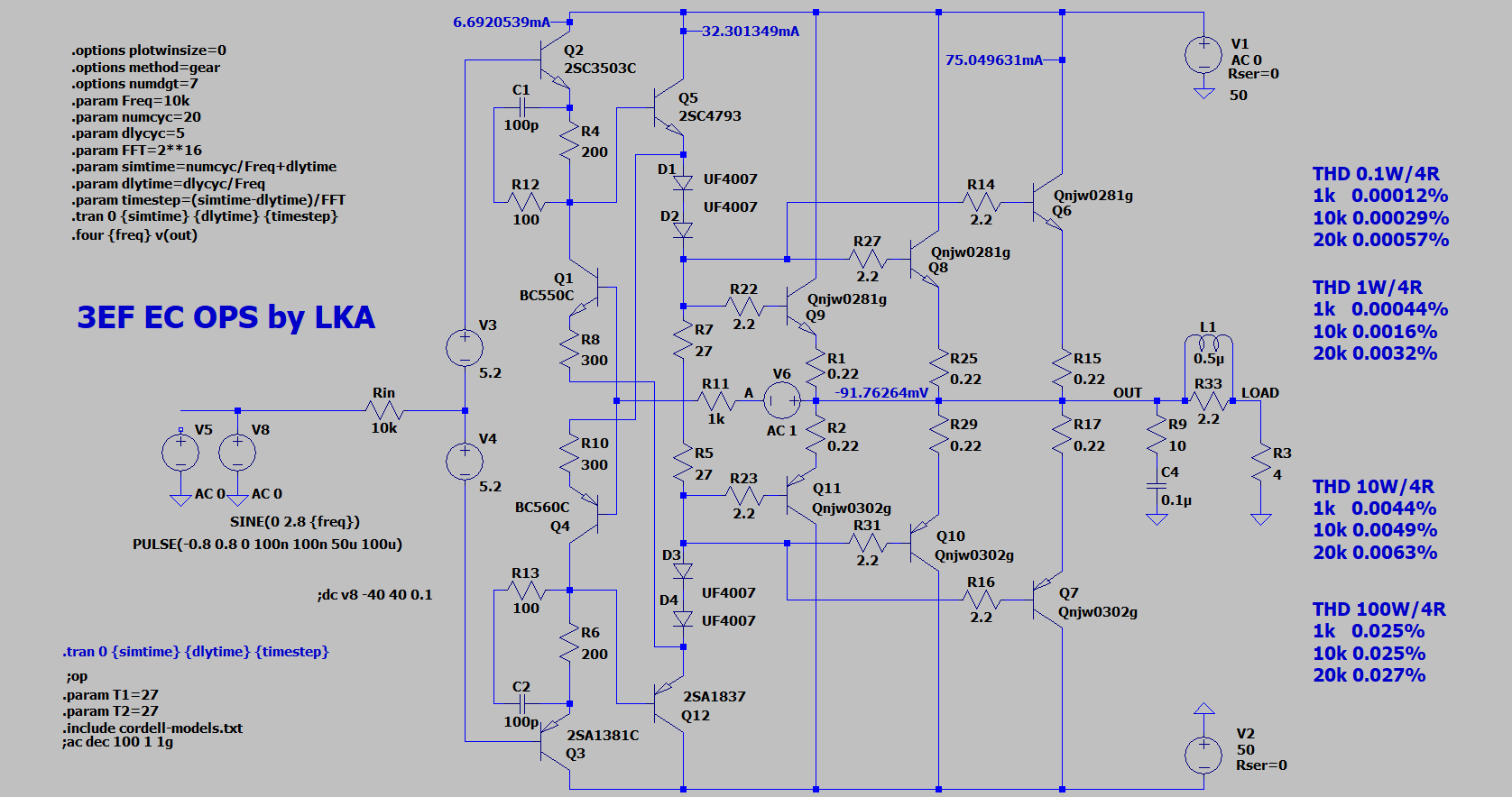

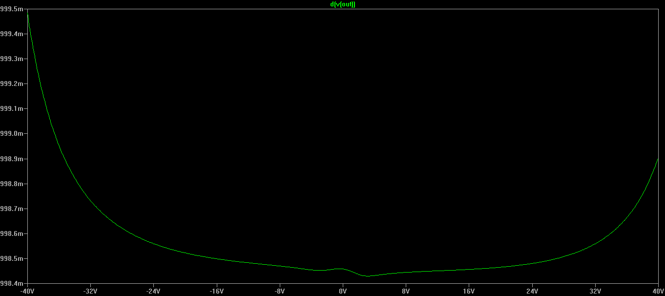

Btw, above is not HEC (Hawksford EC), K200 is a HEC implementation. Basically it is a 3EF preceded by a buffer stage. I compared the distortion profile with and without EC. Distortion reduction at low powers (up to 50W/4R) is significant.
IMO the 3EF EC is just one of the many variations on the HEC in posting #52, see image below, where effectively one resistor has been removed (1Gig) and one shortened (0.01R).
Around the lower Op-amp, gain from the minus input has been reduced accordingly from 1 to 1/2 et voila, there's your implementation of the 3EF EC.
I'm fine when you prefer to call this EC instead of HEC.
I didn't have the time already to look at the distortion at lower output voltages, I will certainly do, but I first concentrated on the reason why at 100W/4R the non EC buffer performed so much better as the 3EF EC.
Keeping all currents the same in the three stages, first thing I did was to replace the transistors by Op-amps.
This showed absolutely no difference at all in the THD, proving did you did a perfect job with the transistors.
Next thing I did was to replace the emitter follower of the second stage, and oh man, THD dropped from 314ppm to 6ppm, and especially H3 went from 309ppm to 1ppm, a 47dB improvement !!
So it's not the EC amplifier part but the second emitter follower causing the difference between 3EF EC and 3EF NonEC.
I'm still working on a work around for this, but a darlington did not give any benefit.
Keep you informed.
Hans

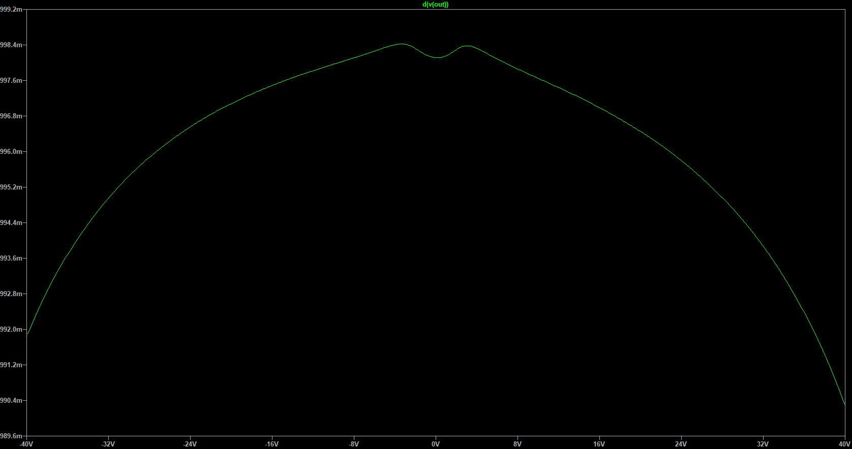

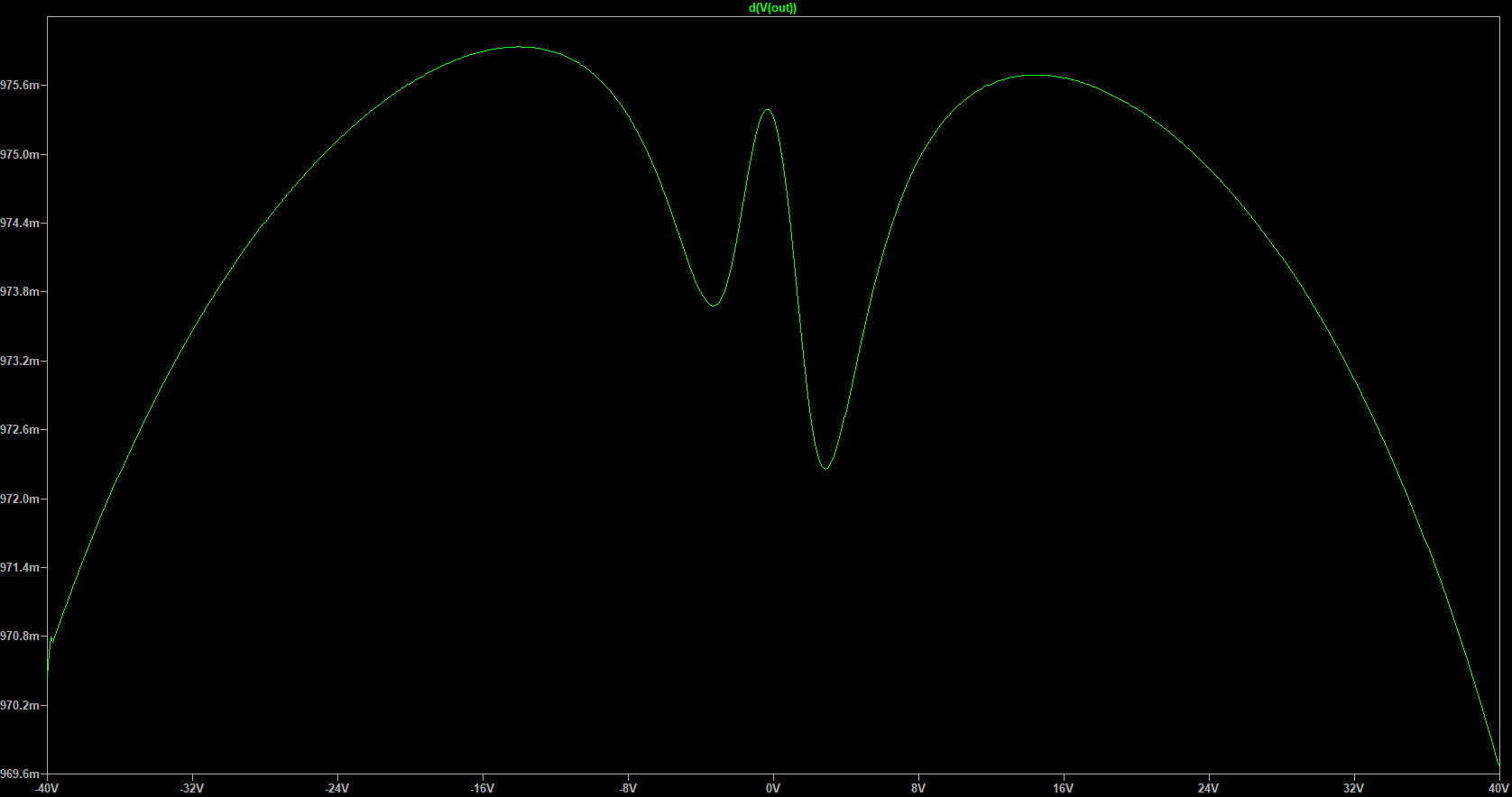

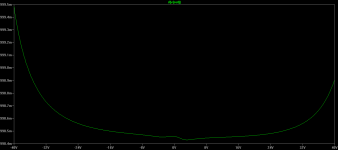

Wingspread simulation also shows that the most corrected region is the cross-over region. The gain variation at large signals is less when straight 3EF is used.
(referring to the schematics in post 57)

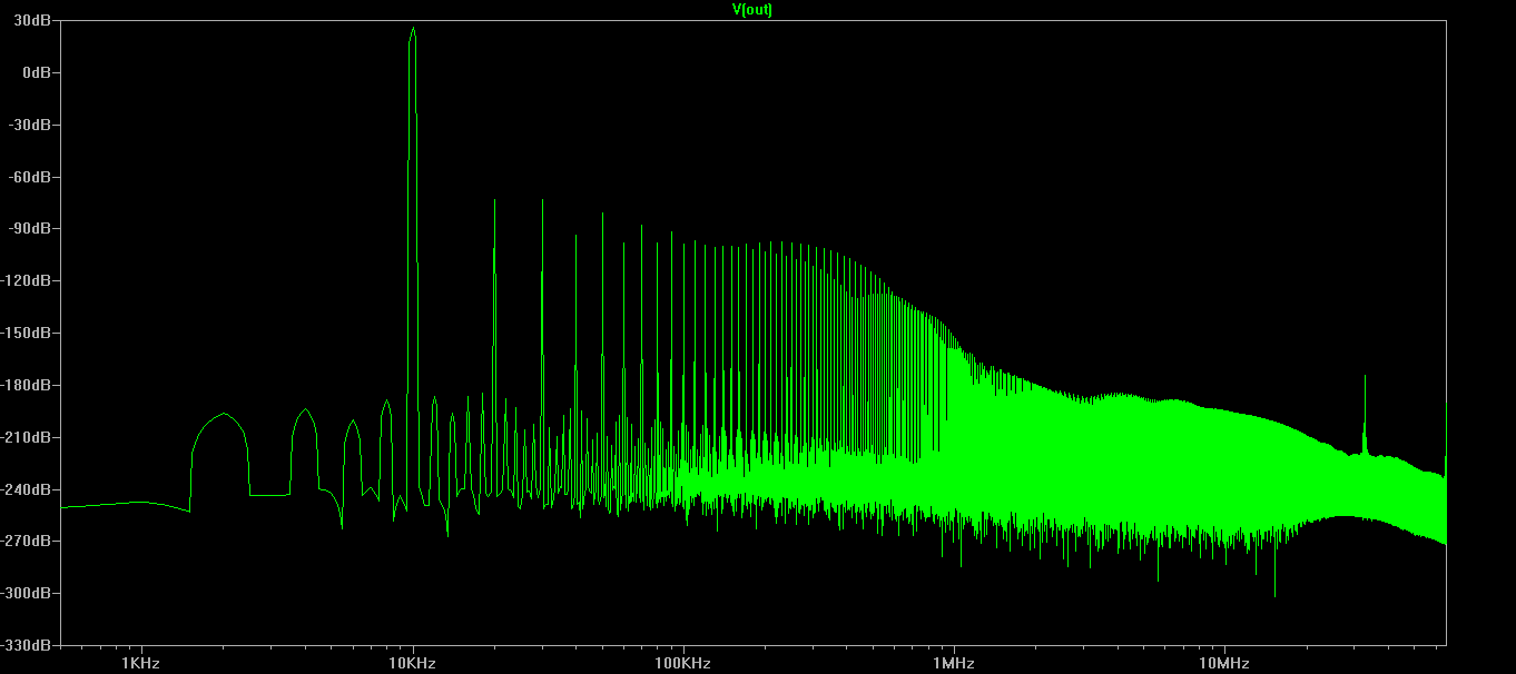

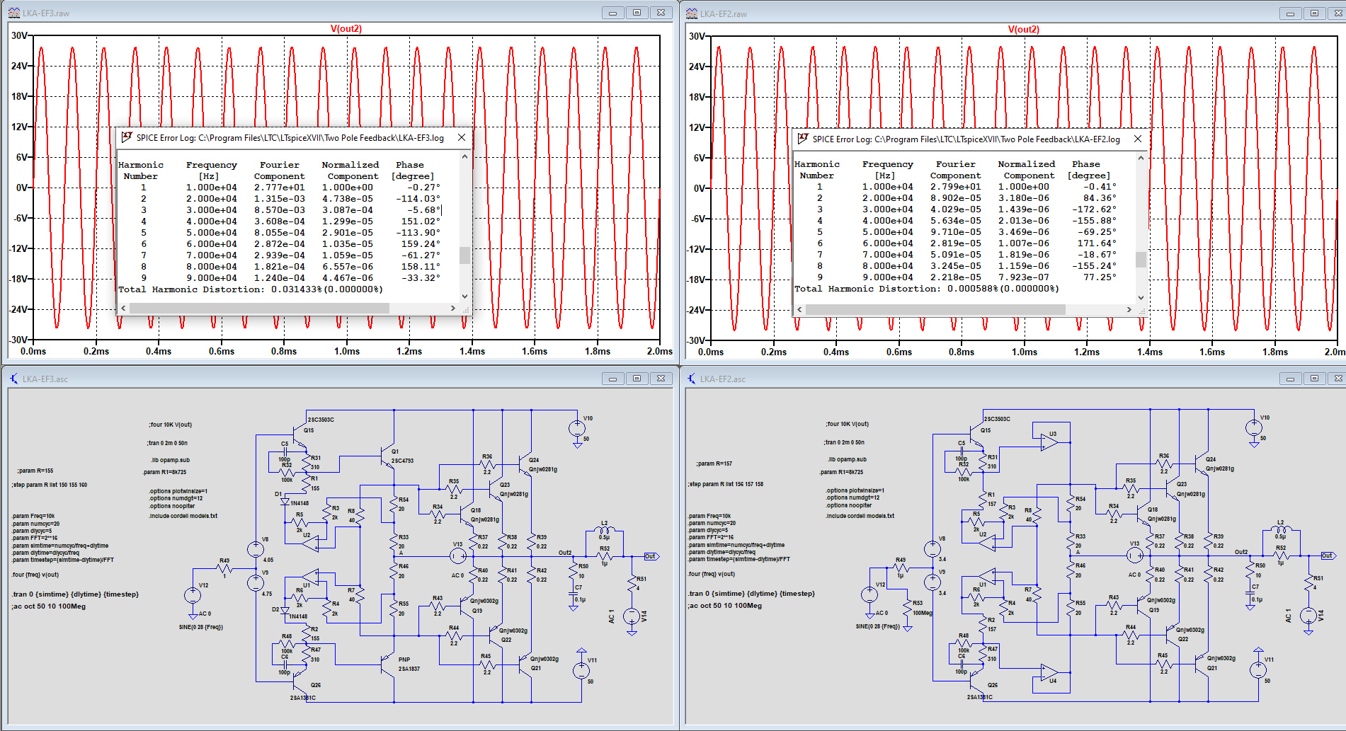

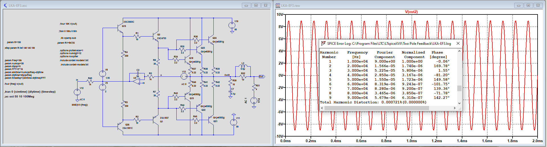

Low driving impedance is not mandatory (rather its "constant" value in audio band). Here input imp is 10k, corresponding resistors R4,R6 modified.

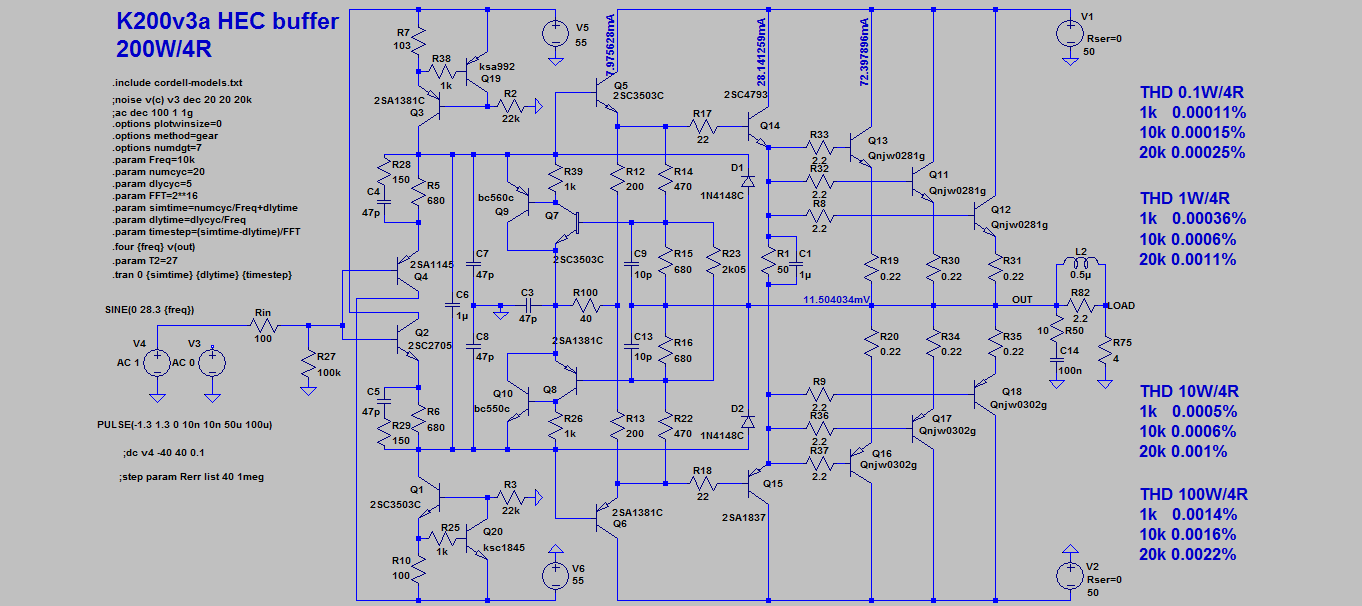

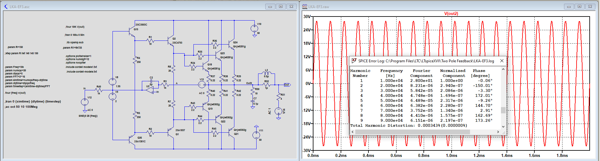

hans, why you do not try your error corrector post 52, using bootstrapped supply referenced on the output? With mine I get 0.006% with outputs biased 15ma/pair. A year ago , not knowing about Hawksford , I created an error corrector with discreet transistors for five TDA7294 outputs in parallel 200w/8ohm. Before all explode, it worked very fine. On my pad I have a working sketch, I'll post it tomorrow .
In the above EC implementation (and Cordell also) the error amplifier corrects the output stage only (not driver nor predriver). K200 implements error correction for the driver+outputs. The resulted distortion for large signal (100W/4R/10k) is 20dB better (equal H2 H3).

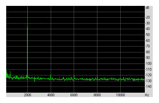

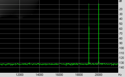

To show a glimpse of what can be achieved with FDR, here the measured IMD spectrum of 19kHz + 20 kHz @ 80Watt peak in 8R and the spectrum of 2kHz @ 100Watt in 8R.
Hans

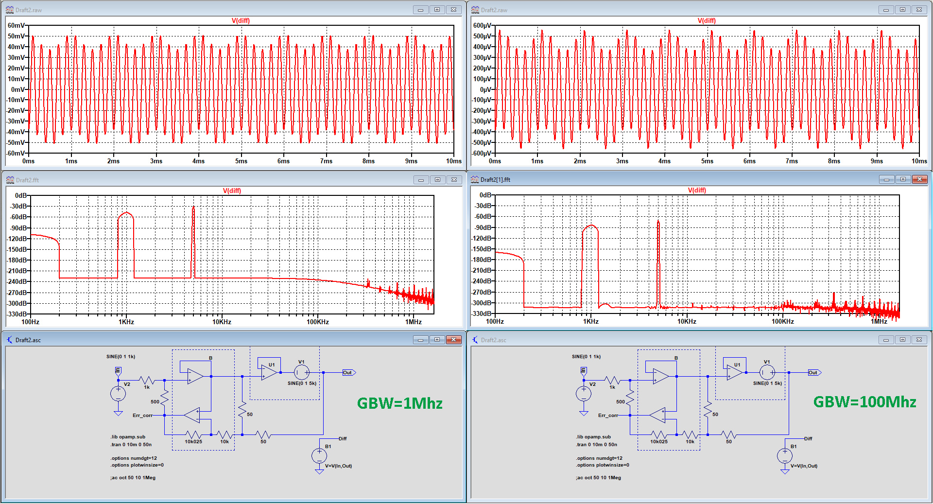

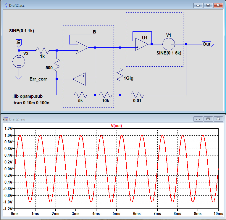

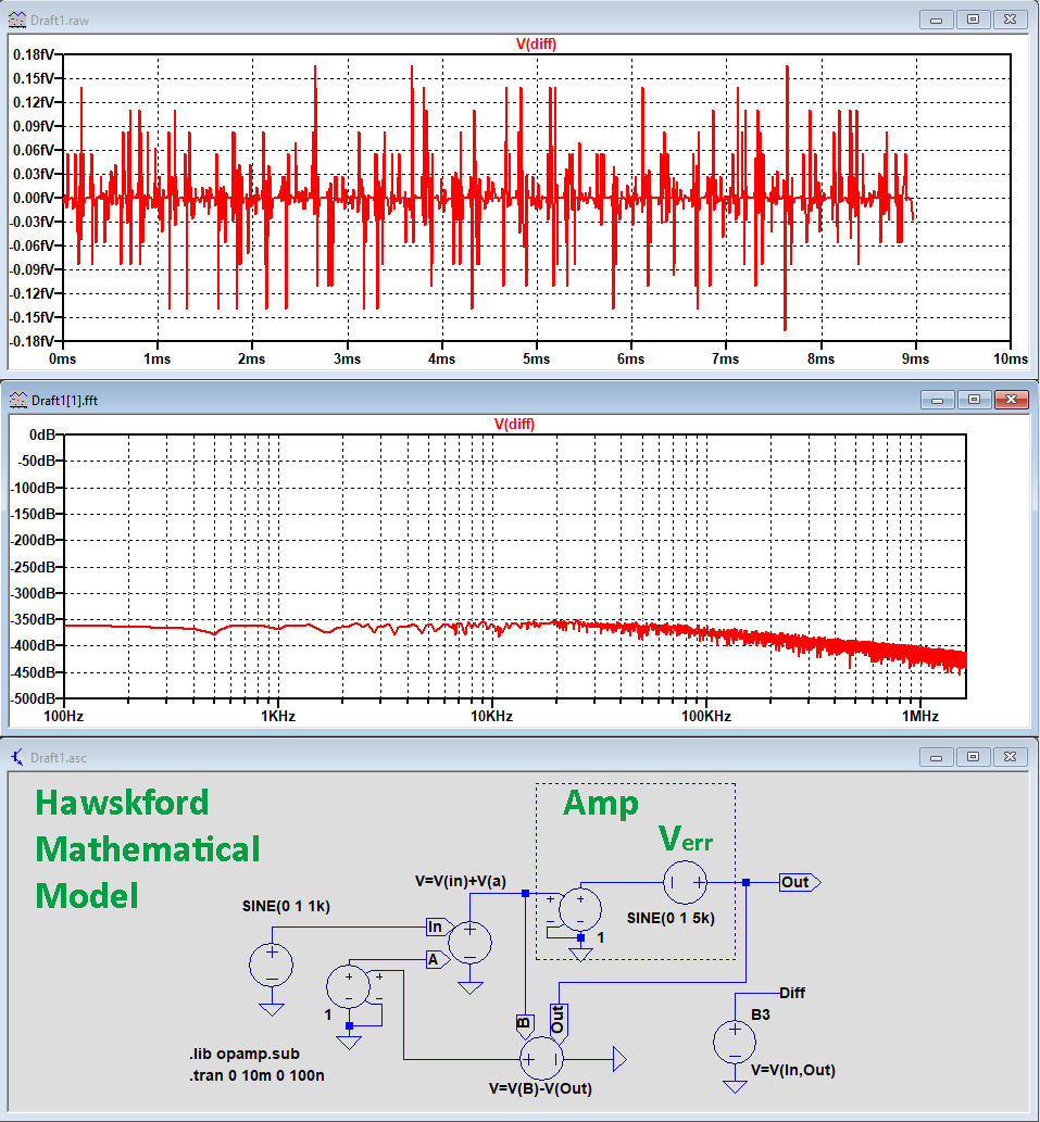

Jan,
Here you are as promised, the difference between In and Output of the Hawskford mathematical model and an implementation in two versions.
In the Hawskford math model, I only used mathematical functions, to avoid any frequency dependancy.
An can be seen in the first image below, In and Output are equal for the full 100% even though a Amp with 100% 5Khz distortion was used.
The second image shows the the result for an implementation with real components.
The GBW of the Amp made no difference in the error correction, the one used had a GBW of 1Mhz.
For the encircled active correction part, the two buffers that where used were having resp. a GBW of 1Mhz and 100Mhz.
That makes it clear that the achieved correction residue, resp. 33mV and 0.33mV rms, is directly proportional to the used BW of these components.
Hans

Exactly! Years ago I spend a lot of time calculating and graphing these issues in MathCad.
The short of it is that both the accuracy of your summing/correcting element and its bandwidth have a direct relation to the amount of error correction possible.
Say you have an error E at a certain frequency. If you want to decrease the error to, say, 1/100 of E, there are two requirements for the error correction element. You must have a minimum magnitude accuracy but also a minimum phase accuracy.
In this example, its magnitude accuracy must be at least 1/100 or 1%. Secondly, to have the required phase accuracy, its bandwidth must be 100 times the frequency of the E you want to correct.
So, if you want to decrease the distortion at 10kHz by 40dB, your magnitude accuracy of the ec element must be at least 1%, and its bandwidth at least 1MHz.
When all is said and done, that good old negative feedback doesn't seem such a bad deal anymore ;-)
Jan

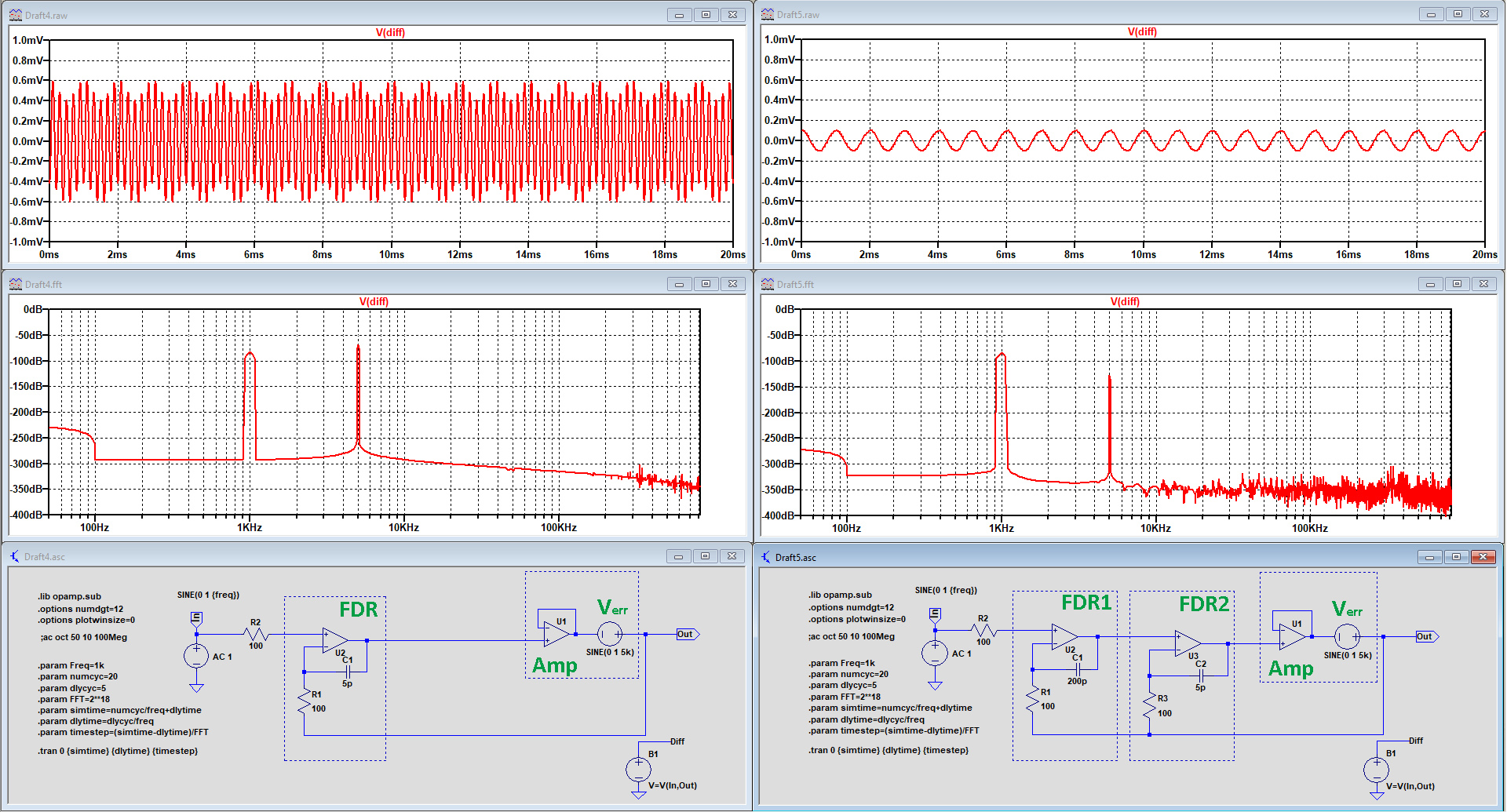

And just for completeness, here the FDR (Feedback Distortion Reduction) solution.
At first sight the performance is identical to the Hec topology version with 100Meg GBW amps in the correction, but there are a number of essential differences:
1) With FDR the correction takes place over the whole path from input to input, where Hec needs to start correcting somewhere within the Amp.
2) There is no need for tuning any component other than the feedback cap around the op-amp for stability reasons
3) Automatically the Amp's output offset is equal to the Op-amp's Voffset, no servo or whatever tuning will be additionally needed.
4) When even more suppression of distortion is needed, a second nested op-amp can be inserted, see the image at the right, where the 5Khz distortion has been reduced for another 50dB, and is no longer visible in the differential residue signal of Input minus Output.
Hans

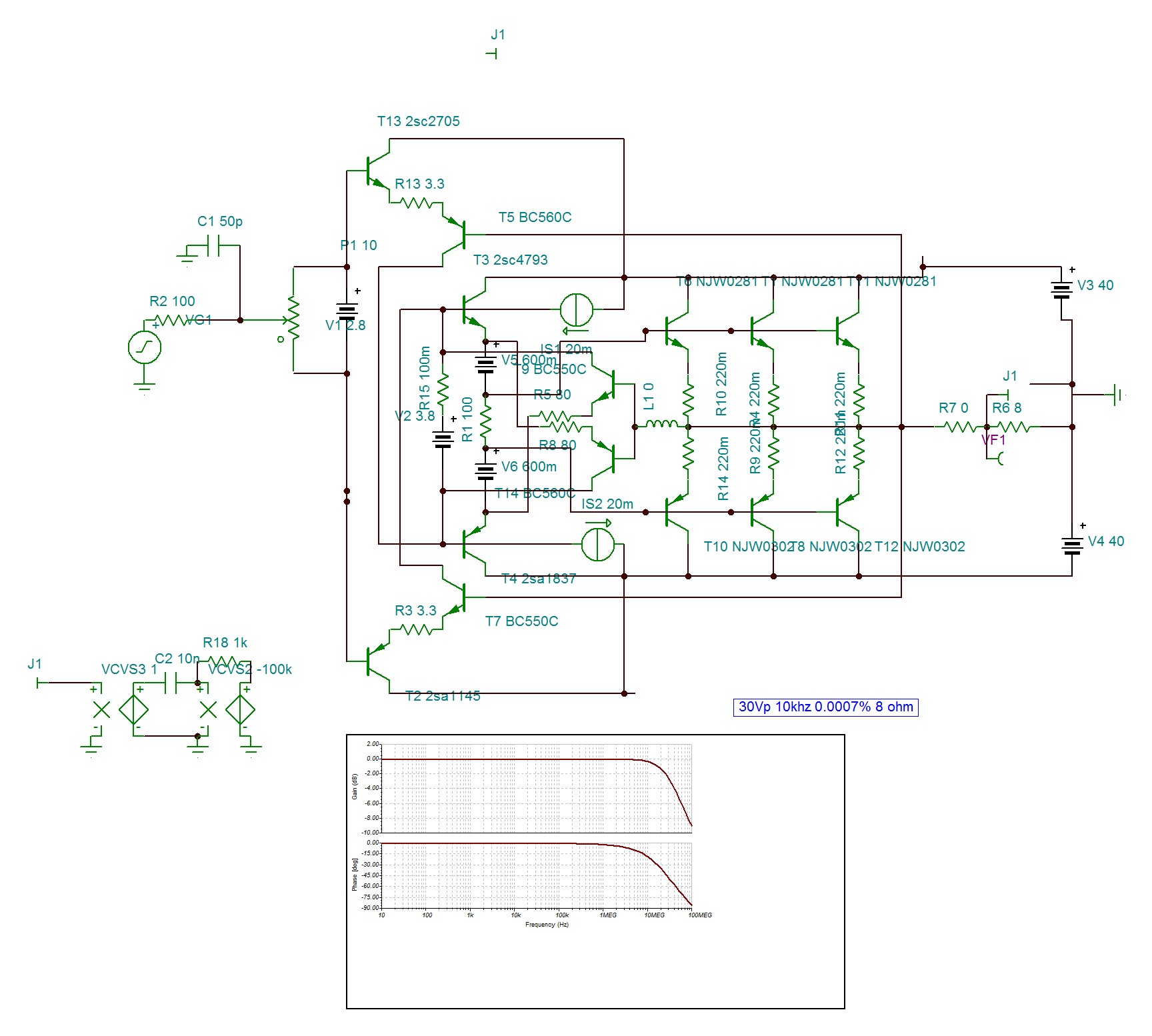

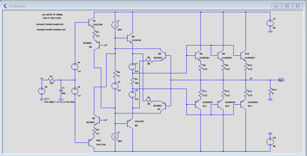

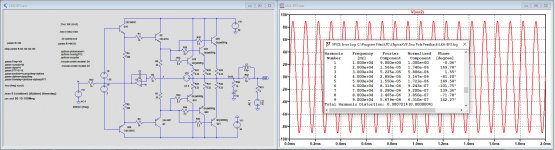

Rushed Hec
attachment.php
by Rushing, I get current addition of the Hec. This is a quick trial to see how it works. I get for 8 ohm 0.0007% for 30Vp 10khz vs 0.0065% for my opamp bootstrapped version.
May be CIR Pspice format can be imported by LT, see attached.
Hayk
